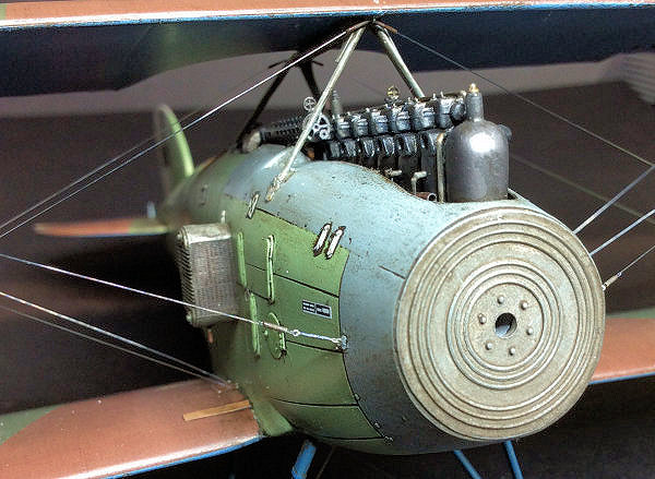

Hi all,
The rudder, elevator and landing gear has now been fitted.
I've also pre-rigged the various flight and control wires, prior to fitting the upper wing.
The lines are 0.12 mm diameter mono-filament with blackened 0.5 mm diameter Brass tube.
The turnbuckles are from the 'GasPatch' 1:48th scale series.
There is a slight bow one of the rear landing gear struts, which I need to sort out,
Mike
  • Thanks 2
Hi all,
During fitting of the upper wing both front struts of the fuselage cabane strut assembly snapped.
Looking at them it looks like they snapped cleanly and I think along stress points, possibly created during release from the moulds.
So rather than pin and glue them together, I decided to make replacement struts from Brass tube shaped around Brass rod.
Mike
  • Thanks 2
Hi all,
I've replaced the front cabane struts using profiled 1.4 mm diameter Brass tube with internal reinforcing 0.5 mm diameter Brass rod and 0.2 mm thick plastic card.
The remainder is the kit parts,
Mike
