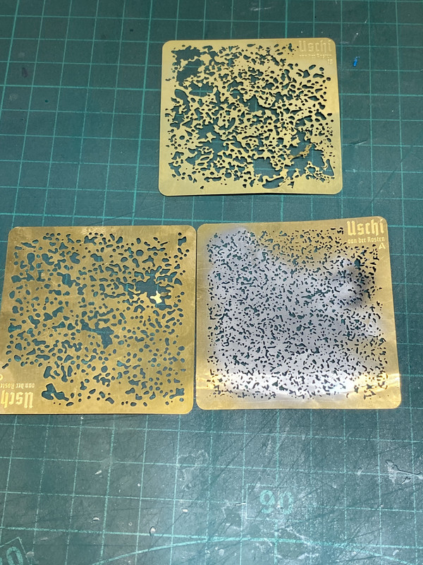

PanzerWomble Posted October 31, 2024 Posted October 31, 2024 I use the USCHI PE mottling masks occasionally , smaller and a bit bendy. Don't use them a lot but useful for adding "texture" I find automotive 3mm plastic masking tape is pretty good for basic lining , it's designed to flex around so works for hard edge cammo . 4

PanzerWomble Posted November 1, 2024 Posted November 1, 2024 @CANicoll Personally I don't put the stencil on the surface , I hold it off a bit and spray through 3
