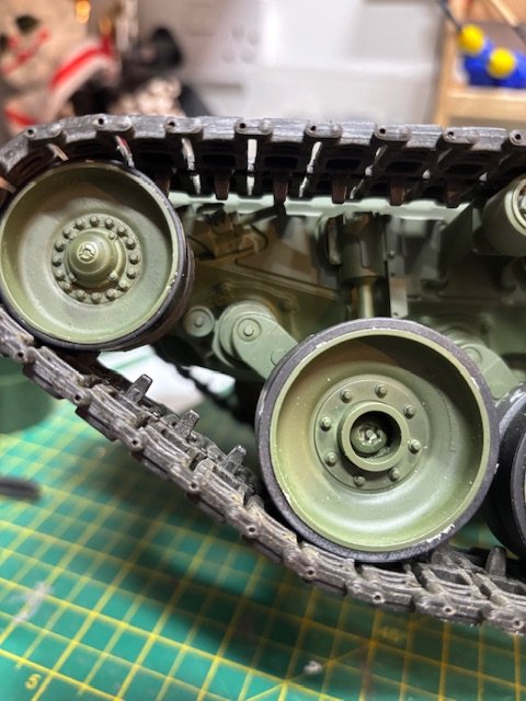

Recent Profile Visitors

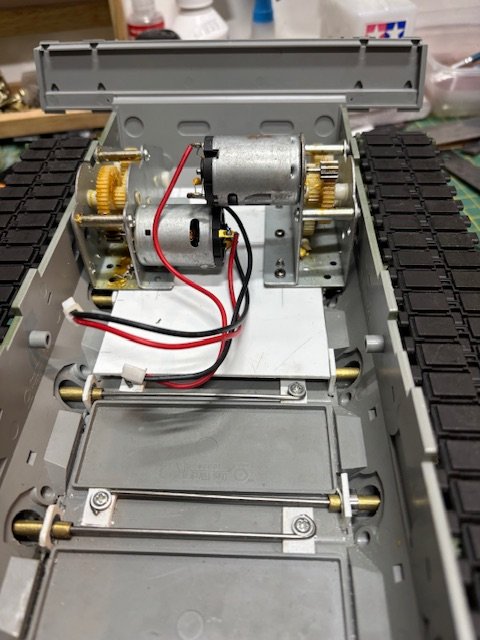

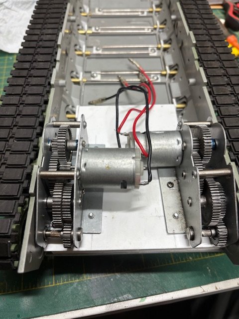

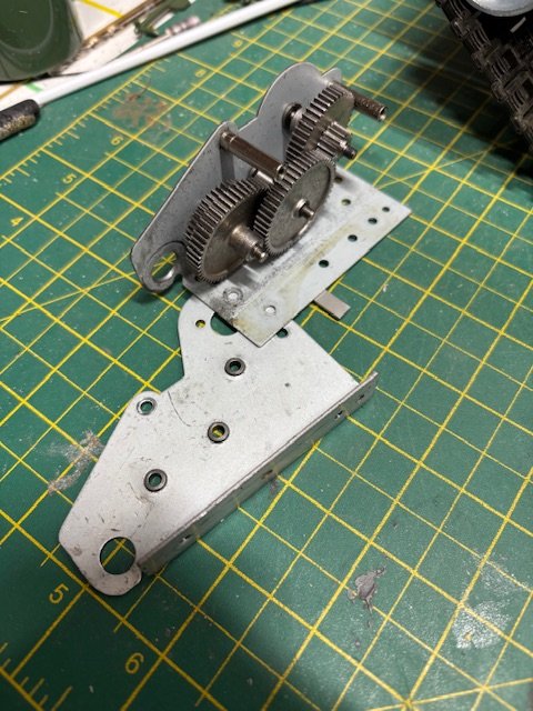

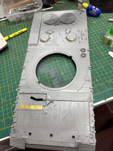

  2. After mucking around with other projects, and work, my mojo is back, so continuing on with this. I managed to get a working chassis from most of the kit parts. Some part, much as I would have liked to have used them were just unsuitable. I had to build up a couple of gear boxes to the correct specifications, and was in able to use the front idler. Motor installation mocked up. I can see it is to high. Idler assembled. New gearbox being built. And finally installed. Now the hull is working, it is time to build the rest of the kit. I am not adding to much of the smaller details to the upper hull at this time, as I still need to work out turret rotation.

  7. Next, the model requires working track tensioners. I had to compromise between scale fidelity, and a working solution. First job was to analyse the construction of the real tank. This has a two part hydraulic system, where a ram pushes against the pivot of the idler wheel. Analysing what was in the kit the I decided to cut the tensioner in half. The hydraulic part was filed out so two bolts could be installed. These were set into plastic weld to give an impression to hold them securely. These were then fixed with Super glue, and the two half glued together. Into the part that pivots and holds the idler wheel a nut was glued, and the surrounding area filled with milliput and a hole drilled for the pivot. A hole needed drilling for the axel for the idlers and to gain access to the bolt. When all was dry the two halves were fixed together, and the idlers attached using bearings over the bolt used as a stub axel. This was all allowed to dry overnight, and the two pats fitted to the lower hull with small screws and a turned washer robbed from the scrap Heng Long Leopard 2 hull. An enlarged hole was made to allow this to centralise, and spread the load.
  8. Further work on the lower chassis, in an effort to convert a Das Werk Leopard, 2A7v to Radio Control. This is for the return rollers and track tensioners. For some reason, Das Work have made the road wheels, sprockets, and idlers to rotate, but the return rollers are fixed. So I needed to ensure these could move. Below are the parts that have been used. The kit rollers and attachments, 3mm brass tube, and a 2mm bolt. First job is to drill a 3mm hole through the wheel mounting parts for the return rollers, and insert a sort length of 3mm brass tube. This was a tight interference fit into the hole. This allowed a 2mm bolt to be passed through the tube and screwed in to the roller. Whether this will be sufficiently strong remains to be determined. The fit of some of the parts is not as good as expected, and some parts required trimming. I am noticing some gaps in the photographs.

  11. First post on the site, so forgive me if it is a long one. I purchased a 1/16 Das Werk, Leopard 2A7V, and a Heng Long Leopard 2A6 chassis, with the intention of turning into an RC Model. I am hoping to install working lights, smoke and flash, recoil, HL TK7.1, working machine gun, ball bearings in the suspension, and wheels, with torsion bar suspension. First decision was to see if the HL hull could be used in its original configuration. The upper hull does fit, but some trimming would be needed. This would be incorrect, but a simple, working solution. The simplified HL, is not as well detailed as the Das Werk, and it also has incorrect suspension. The Heng Long lower hull will provide parts like return rollers, sprockets, motors, and track tension. Ball bearings were installed at the wheel stations. Brass and plastic tube was used to make a prototype suspension. 1.8mm spring wire was used.
