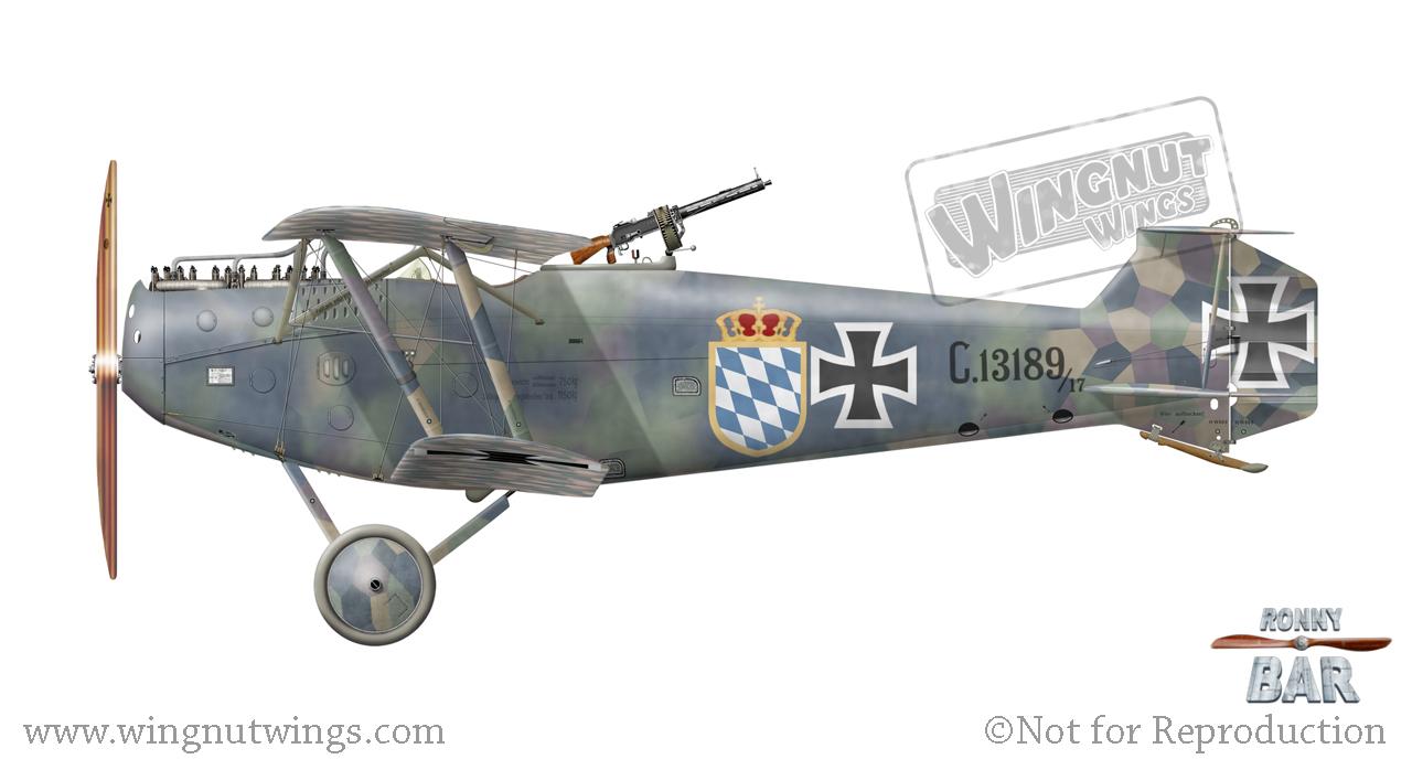

yes it is a matter of interpretation, but to help a more side by side comparison, here is the fuselage from the Britmod build
as i said, it looks cool, but is way sharper than the heavy mottle finish that WNW profile depicts
my take is that their profile is closer to the pictures in their instruction booklet than the model above, but then again he chap above isn't making 'my' aircraft...
i guess once I am brave enough for turnbuckle torture  :help: then i will have a spray and see how it looks?
