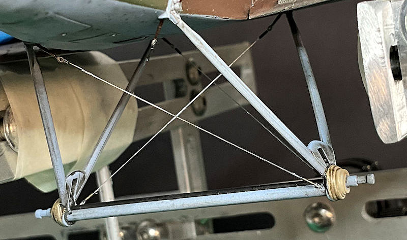

sandbagger Posted April 22, 2025 Posted April 22, 2025 Hi all, I'm waiting for rigging materials for the Pfalz D.VIII I'm building. So I thought I'd start researching the next model. This will be the 'Wingnut Wings' Rumpler C.IV (early), Serial No.8518/16 of Flieger-Abteilung (FA) 209 during 1917. (FA) 209 was an observation and reconnaissance unit and operated on the Western Front, including Verdun. During the early part of the war, Feldflieger Abteilungen (Field Flier Detachments), the initial observation units, typically had six two-seat aircraft, either monoplanes or biplanes. Mike 5

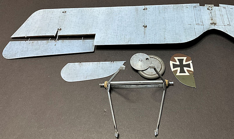

sandbagger Posted May 27, 2025 Author Posted May 27, 2025 Hi all, The pre-rigging stage is complete. A combination of: Gaspatch 1:48th scale metal Anchor Points and Type A turnbuckles. Albion Alloy's 0.4 mm and 0.5 mm blackened Brass tube. 0.08 mm and 0.12 mm diameter mono-filament. Next is to final fit the upper wing so final rigging can be carried out, Mike 7

sandbagger Posted June 2, 2025 Author Posted June 2, 2025 Hi all, I forgot to post photographs of the model being completed. However, here's a few of the rigging. I used 0.08 and 0.12 mm diameter mono-filament with 0.4 and 0.5 mm blackened tube. Turnbuckles were metal Gaspatch 1:32nd scale. I'll post the completed model once in it's display case. For now, it's onto the figures and accessories, Mike 4
