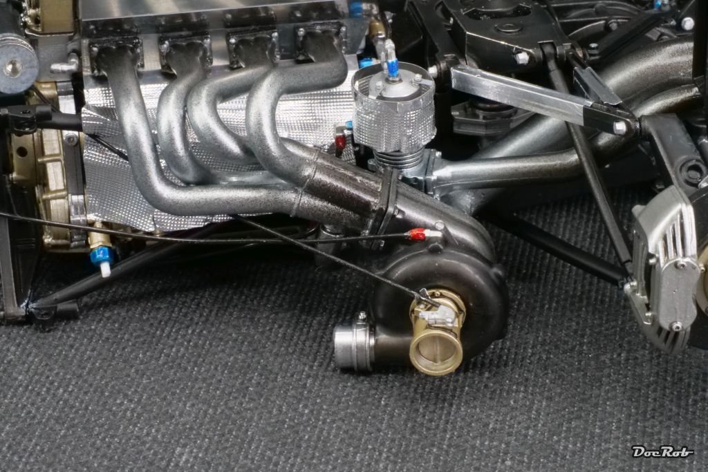

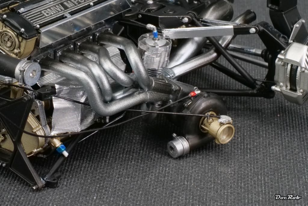

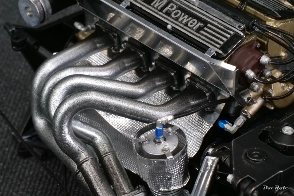

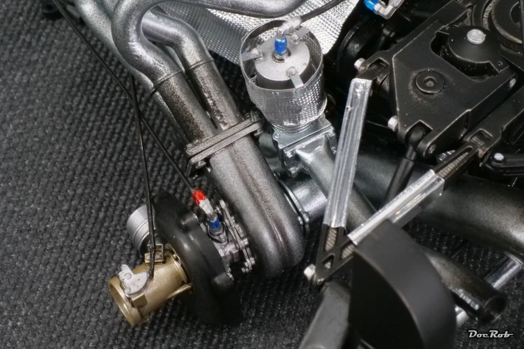

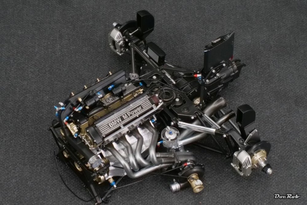

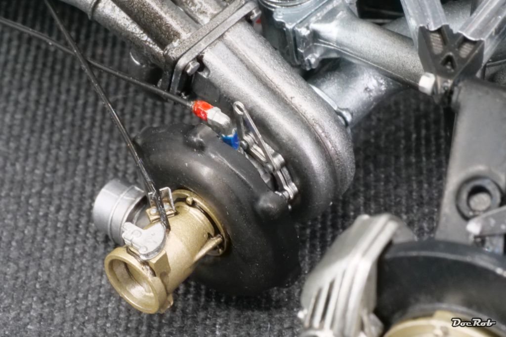

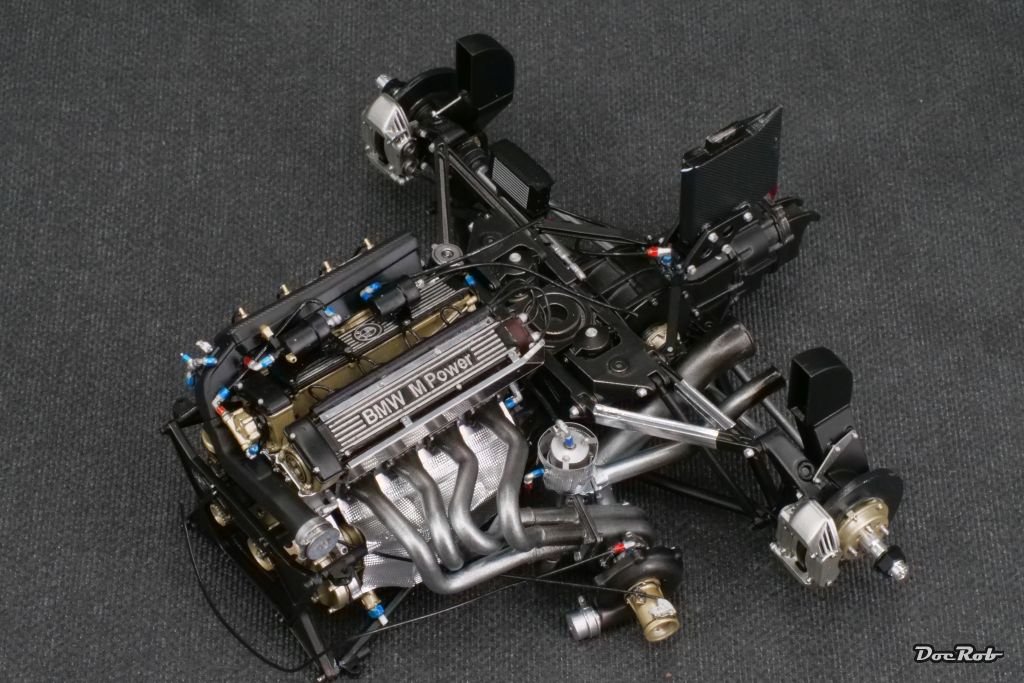

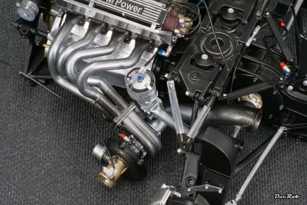

DocRob Posted 13 hours ago Author Posted 13 hours ago Phew, the real powerhouse of the BT52b took some effort to get right. I can only estimate, how hot the turbo gets when run to full power with all the heat shielding. I should have aluminum wrapped all hoses and tubes, but installation was difficult enough, so I omitted it. The exhaust manifolds, turbo parts and exhausts were painted with AK Extreme Metal stainless steel and accentuated with black smoke of the same brand and finally touched up with Alclad jet exhaust for a reddish brown shine like on my reference pics. The black cover of the turbo is a clear vac part, which I painted translucent black. On the original it is made from carbon fiber, but I was too lazy to decal it, as it will be hidden very deep into the car. I had difficulties to get good color reads off the pictures from the original engine. The embossed aluminum foil needs to be cut and glued to the PE parts. It needs a bit of fine tuning, but it was not easy to get the foiled parts in place. Specially on the tiny cylindrical pot on top it was tedious, with the microscopic three rivets to be placed there. Cheers Rob 4
FullArmor Posted 13 hours ago Posted 13 hours ago Impressive details. Did you embossed aluminum foil yourself or did it come with the kit? 2 1
FullArmor Posted 13 hours ago Posted 13 hours ago Those red and blue hose nuts adds extra color nicely. 1 1
DocRob Posted 9 hours ago Author Posted 9 hours ago 3 hours ago, FullArmor said: Did you embossed aluminum foil yourself or did it come with the kit? thank you FA, there are two types of foil included in the kit, self adhesive aluminum foil and self adhesive embossed aluminum foil, along a sheet with the paper templates to cut them. 3 hours ago, FullArmor said: Those red and blue hose nuts adds extra color nicely. The fittings you mention are beautiful, but also cause for some headaches. Many need to be drilled with a 0,8 mm bit, being only of slightly larger diameter than 1 mm. Sometimes, they are not that well cast and it is hard to find the exact middle point for drilling. The other problem is the manual, which often does not show, where the wire or tube leads to and there are lots of connections. Cheers Rob 1
BlrwestSiR Posted 4 hours ago Posted 4 hours ago Some incredible detail there. The foil adds another dimension.
