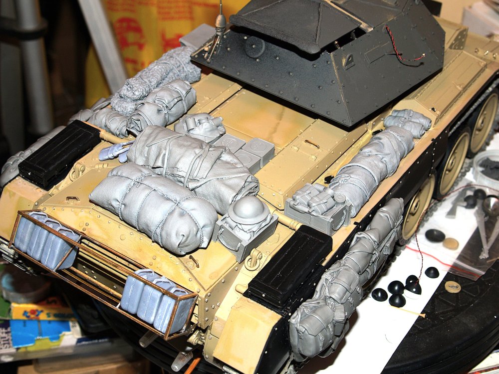

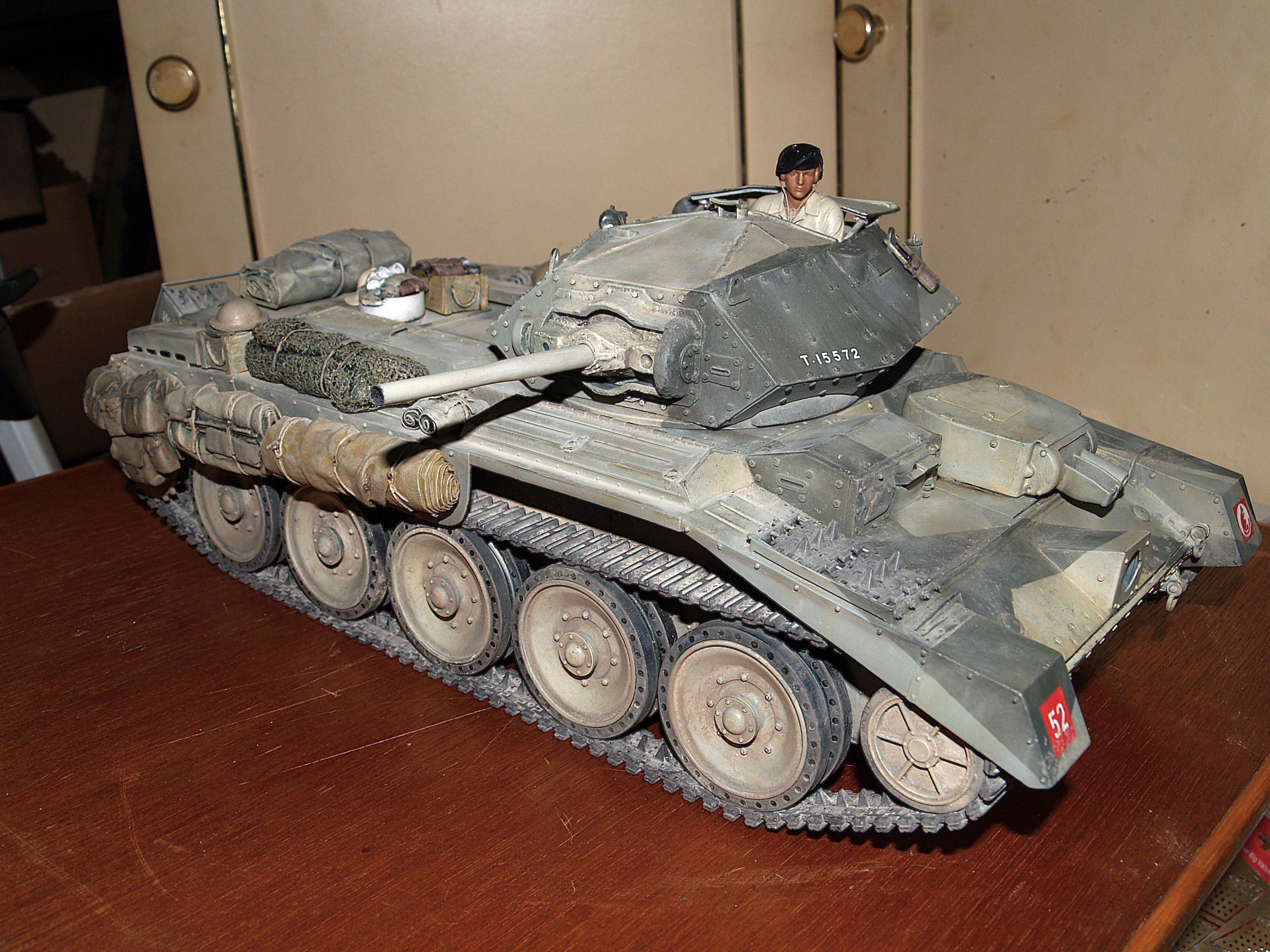

  1. My latest clanky thing , a Coolbank RC Crusader III (6 pdr ) Converted into an early Mk I ( 2 pdr ) , , ,The victim 😎 . . . and the crime 🧐 Plus some baggage to busy it up . . .

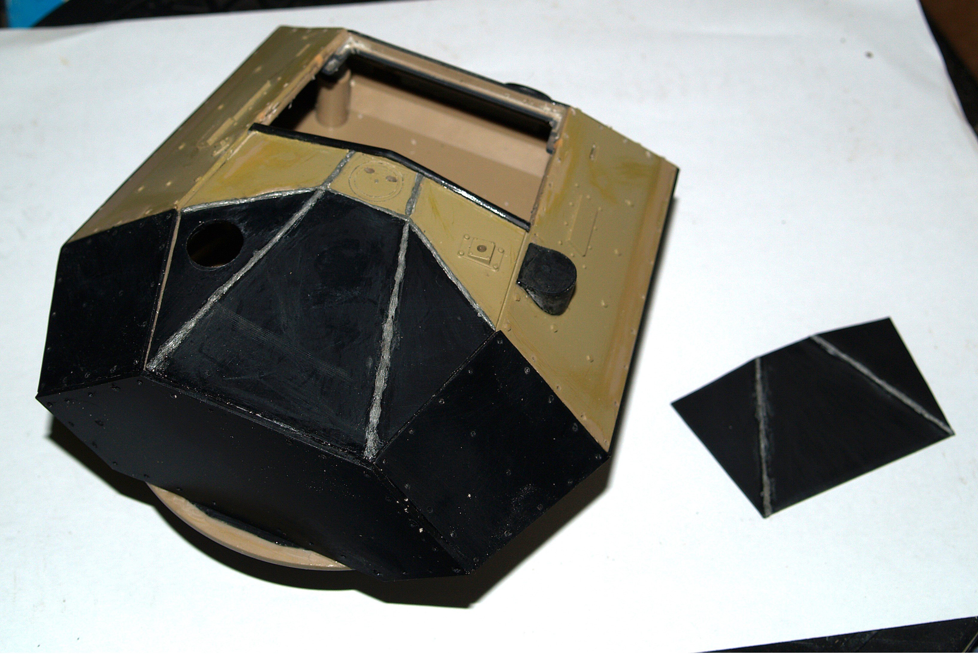

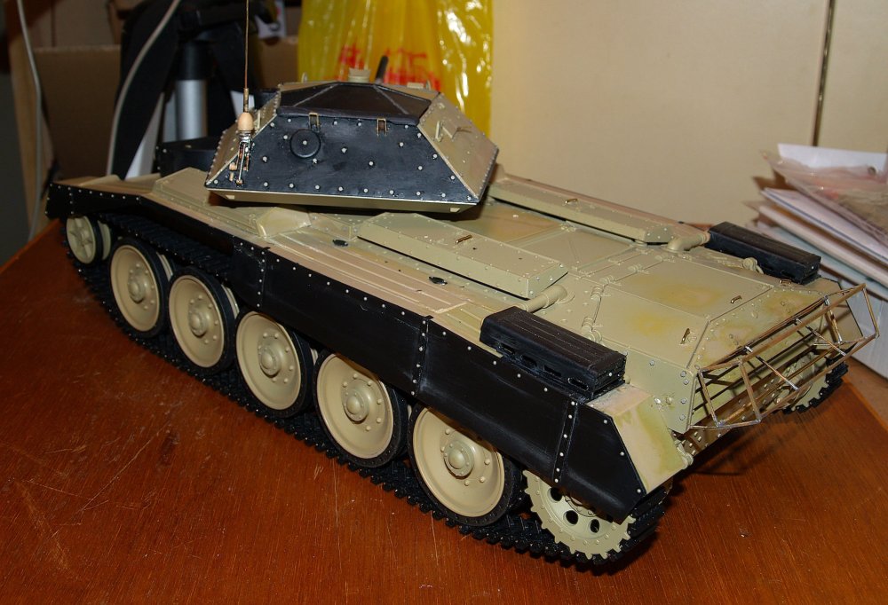

  3. W.I.P. Coolbank Crusader Mk 111 (6pdr) - Conversion to a 2pdr turreted Mk 1 .

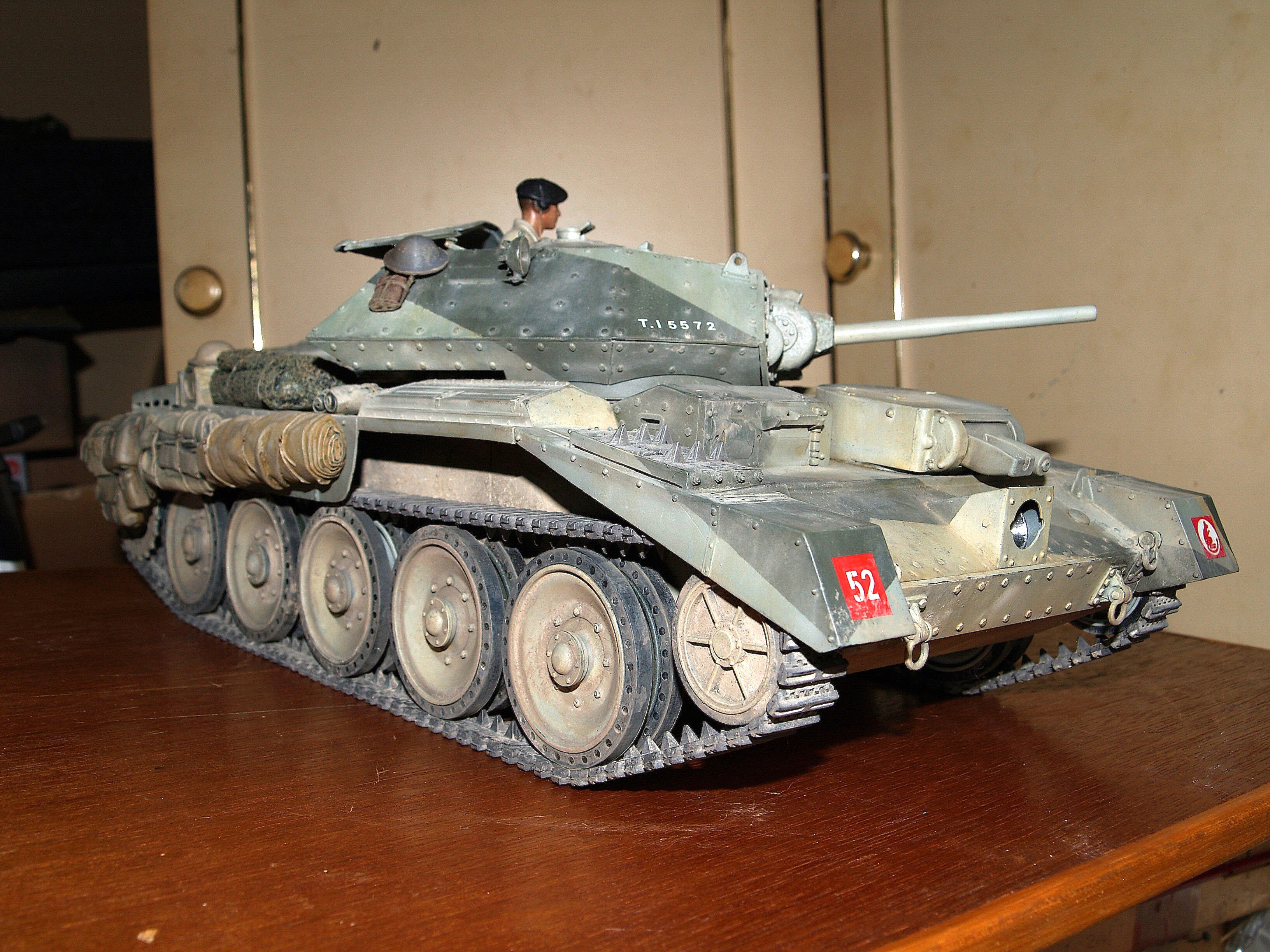

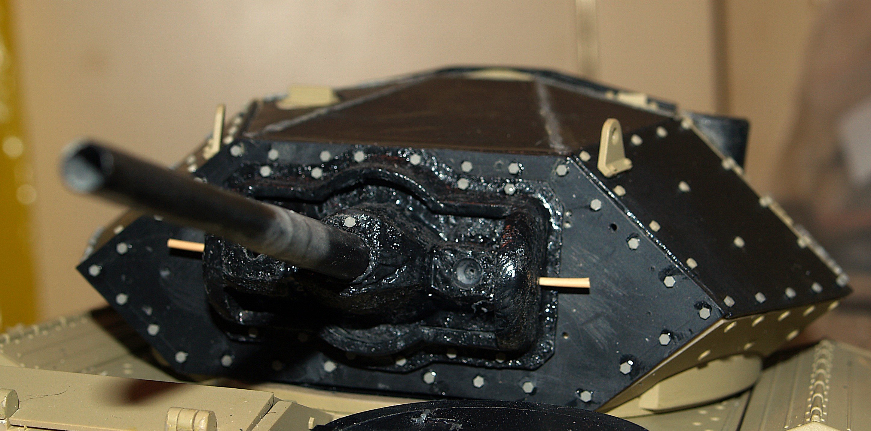

  7. Some archive pic's of the carnage . . . Basic paint , I find red oxide too 'harsh' so use a chocolate brown over black primer . Sorry about the pic quality. Hull surgery - removal of side skirts , correctly centred turret ring and bits. Turret work includes reprofiling the horseshoe shape , narrowing the mantlet (single optic type), adding the '40mm' roof , late cupola , new hatch hinges , gunners visor , anti personnel mine launcher , ventilator and track hangers, and while I was at it , lowered the vision slits on the sides . . . Yadda yadda. . . .
  8. Originally yes , but all that remains of it is the upper hul , even that has been reworked . With a chequered ancestry she is a real 'Moggy' Lower hull - Asiatam * Late wheels etc. - Torro i/r - recoil Turret - Taigen Transport tracks - fleabay , (possibly Asiatam) Spare turret track - Impact late type , on Schumo hangers. Voyager etch brass ( Aber is insanely fiddly and overcomplicated , I do have a life y'know ) Other stuff source from dealers on the interwebs . Plus the usual scratch built stuff , styrene , resin etc. the list goes on and on . All stuck together with lots of Anglo Saxon and liquid therapy . * I started this build back in 2011 🥴
