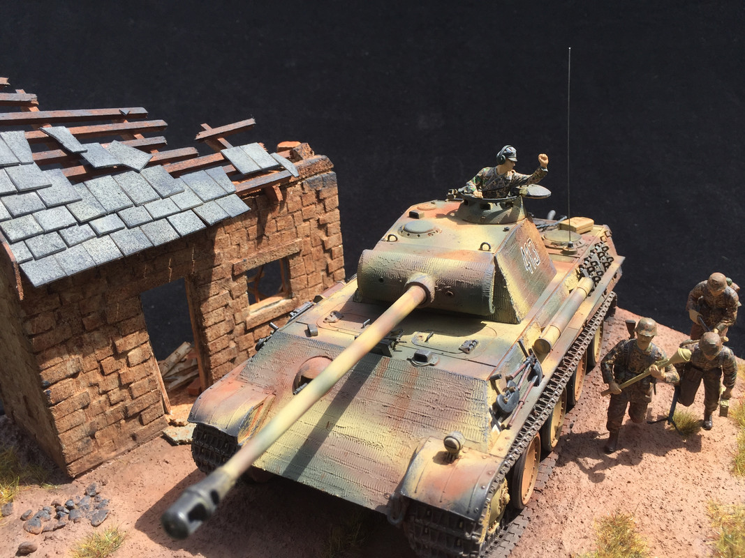

Old basic build on a Panther done in No More Nails using a razor saw (lawks) , reckon the tammy white is more forgiving longer working time etc these days

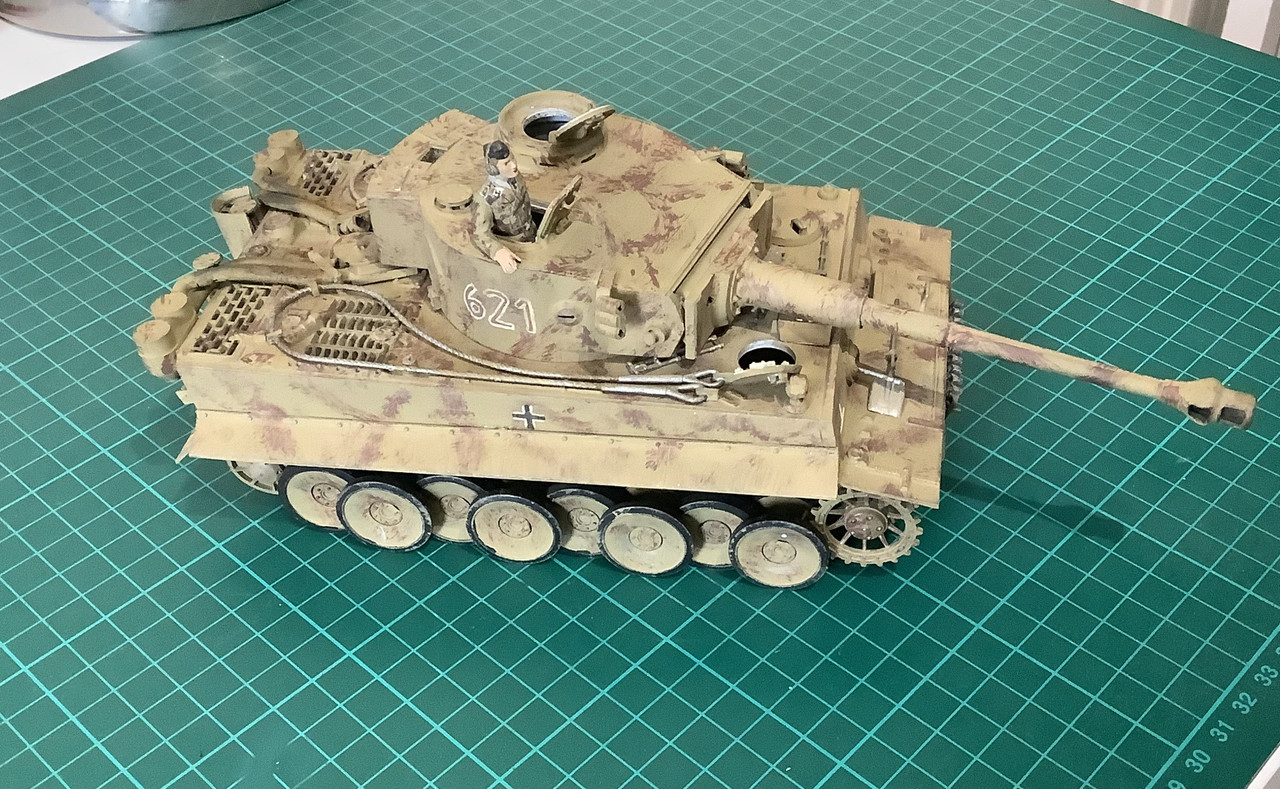

  • PanzerWomble changed the title to 1/35 Tamiya Tigger I, quick build for a paint trial - Part two up to chipped whitewash
Thin coats of ATOM matt white ....then some damp brush chipping ...the point of the exercise. I would say 6/10 .....I was expecting more . I've got some alternative thinners coming so we will continue to play about .

Anyhoo it's finished ..RFI here ..
