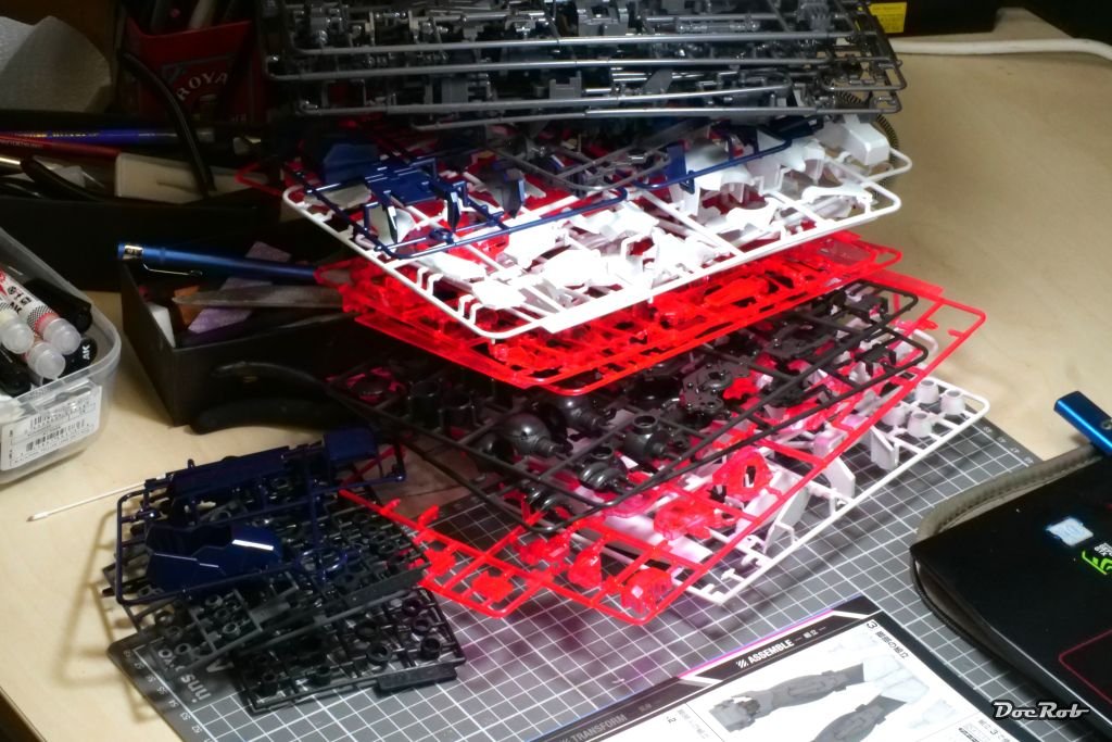

There is a lot of terminology involved with these kits. Perfect Grade means, it´s the highest grade of detailing in the Bandai range and the scale is 1/60. Highest grade of detailing means also an absurd part count manufactured in different colors and materials, mainly ABS and some vinyl like stuff. The so called Psycho Frame is a red transparent layer under the white armor, which distributes the lights emitted from the LED´s.
The kits are fully articulated, which obviously adds to the complexity of the build. There is no glue needed, and the parts are designed to intersect in many ways, which can be finger bleeding tedious, especially with correcting errors.
The manuals are only Japanese and it is recommended to use a translator with camera function, to get the grips.

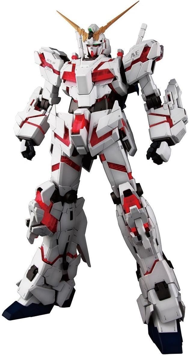

...and that´s how the Unicorn is supposed to look:

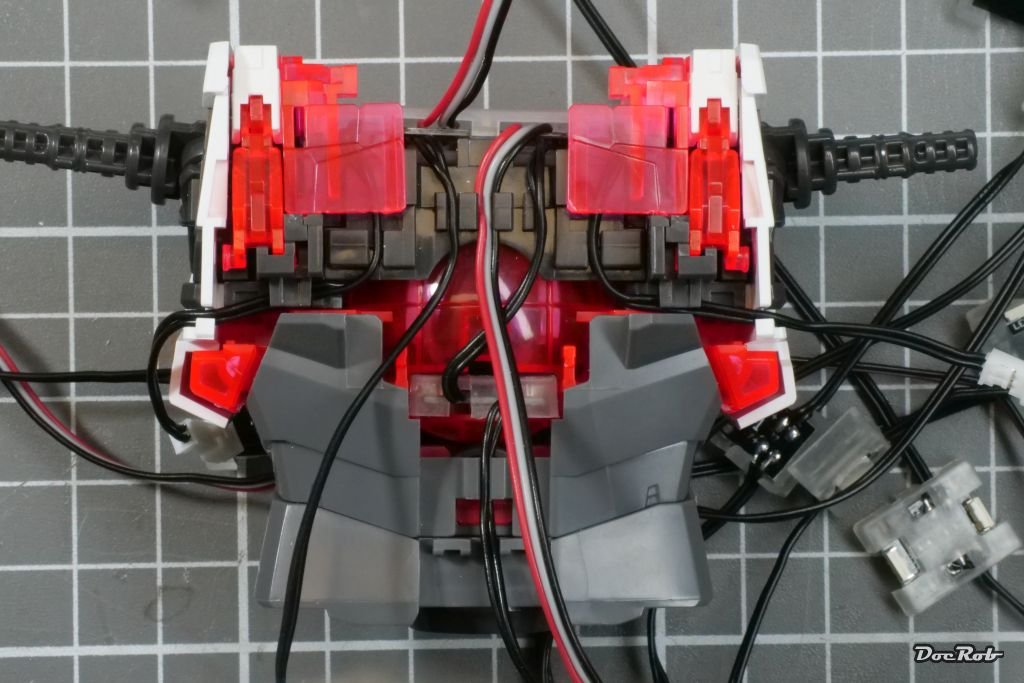

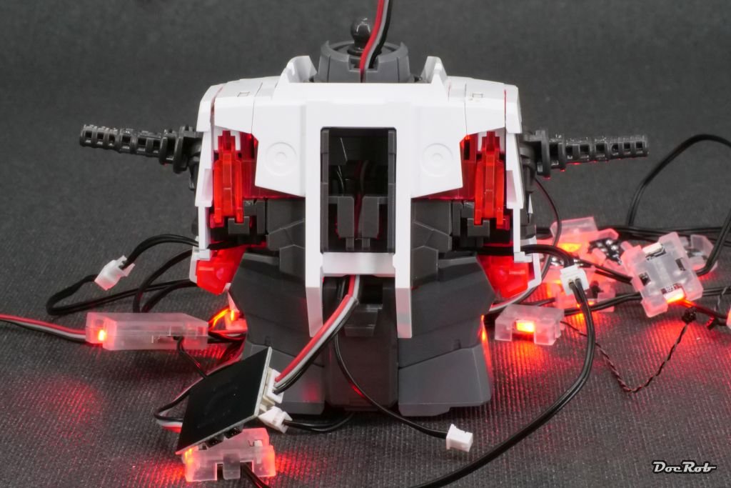

Next was the installation of the LED system from Kosmos. After looking closely into both manuals, it looked to me, that the Kosmos LED set is made very similar than the original Bandai one. That meant, I could follow the Unicorns instructions for these steps. The LED´s for torso, head, legs and arms are already connected, so testing is easy.
I installed the main hub on top of the cockpit and fiddled the appropriate wires into the wire routing channels, the torso backside looked like this when finished:
Next, all got covered up:

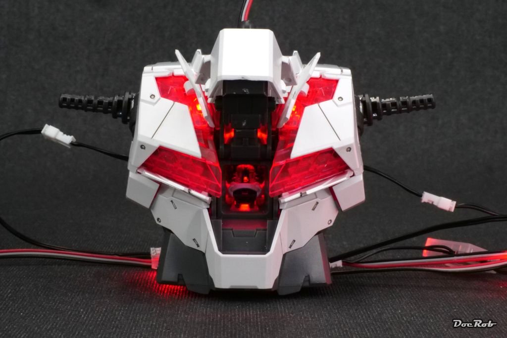

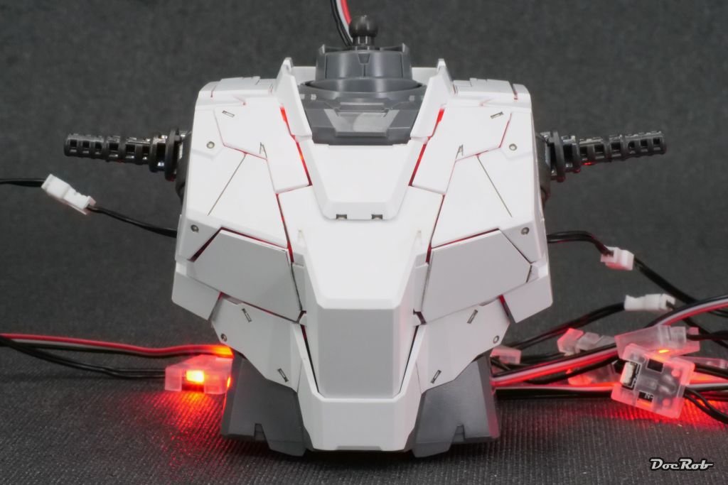

Here are pics from the front of the finished torso with all panels closed (Unicorn mode) and all panels opened (Destroy mode):

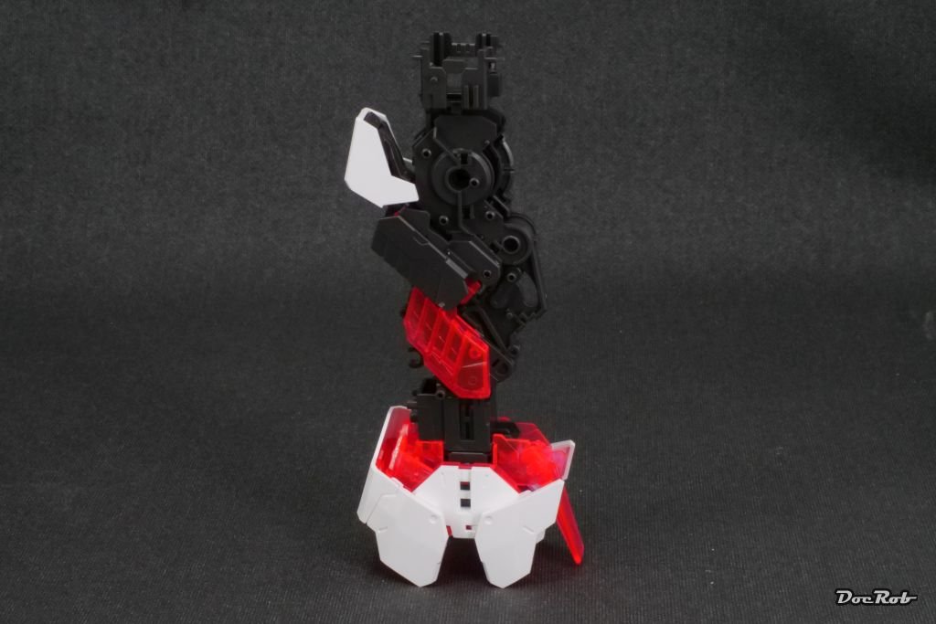

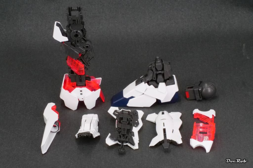

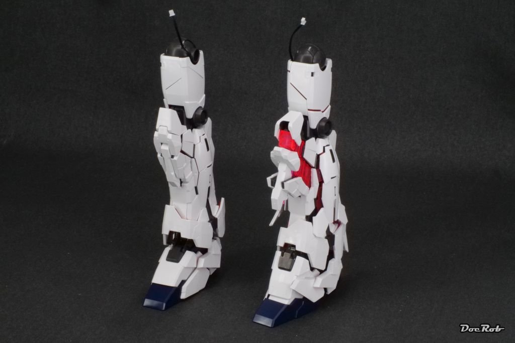

After finishing the torso, it took me more than 10 minutes to only pick the sprues for the next section, which are the legs:
