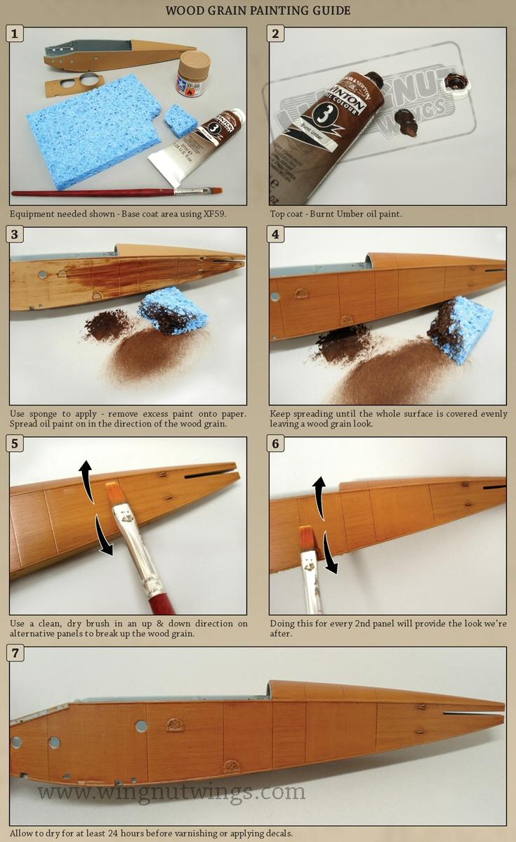

If I am to start building WWI airplane kits, I see the need to be able to re-create "wood-grain" on plastic...........can anyone tell me the best way to do that??

Hi Jim,
It's actually quite simple if you use the right materials. And cheap.
I use a base of acrylic light brown. Let it dry well. Then make some small dots with brown (burnt sienna) artist oils. Good quality oils.
And then start smearing a wide flat brush, slightly damp with rectified (non aggressive) terpentine until you reach the effect you're looking for.
Just try it on a test piece.
If something goes wrong, post it here and I'll see what's up!
Cheers,
Jeroen

Thanks for the tips guys, glad I found this!! Tried it a bit last night and it worked pretty good, at least at my skill level it will do what I want it to.
