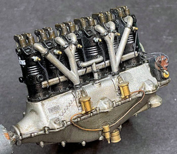

Hi all,
The engine is complete apart from adding control rods once the engine is fitted into the fuselage.
I've added a few changes to the kit supplied engine:
Nickel-Silver push rods of 0.4 mm diameter.
Rear coolant pipe from 0.5 mm diameter lead wire.
Fuel filter pipes from 0.3 mm diameter copper wire.
Throttle control return spring from 0.125 mm diameter copper wire.
Ignition lead support tubes from shaped Brass tube.
Ignition leads from 'EZ' black line (Fine).
Fuel priming levers from 0.2 and 0.4 mm diameter Brass tube and Nickel-Silver rod.
Crankcase vent ports from 'RB Productions' photo-etch grill.
Mike
