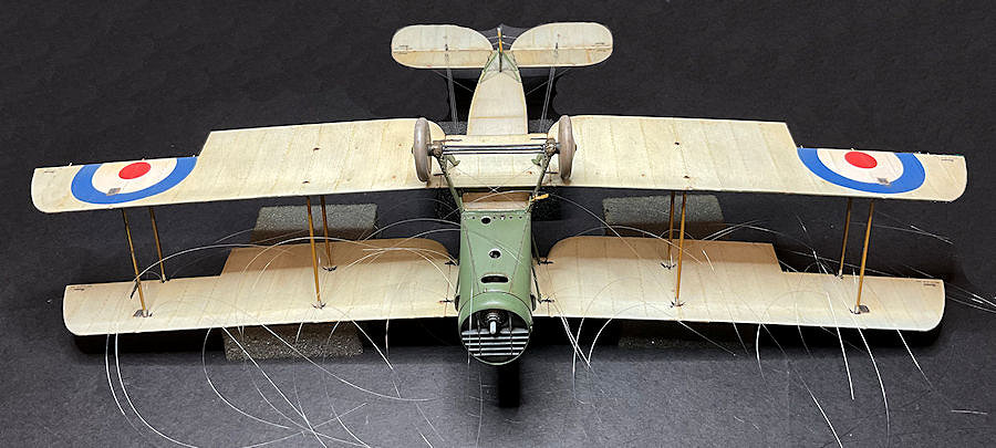

sandbagger Posted October 21, 2023 Author Posted October 21, 2023 Hi all, Upper wing fitted and pre-rigged. In total there are: 6 cabane strut bracing wires 2 drag wires 8 incidence wires 8 landing wires 16 flying wires (8 pairs). Pre-rigged using 0.12 mm diameter mono-filament and 'Gaspatch' 1:48th scale Brutish late turnbuckles (for streamlined wires). Now it's onto final rigging to the lower wings before adding the aileron control cables, Mike 4 1
sandbagger Posted October 24, 2023 Author Posted October 24, 2023 Hi all, The wing rigging is complete. Includes the: Twin flying wires (8 pairs) Single landing wires (8) Interplane strut incidence wires (8) Drag wires (2) Cabane strut bracing wires (6) Aileron control cables (2). Created with 0.08 and 0.12 mm diameter mono-filament, 'Gaspatch' 1:48th scale metal turnbuckles (Type C) and resin streamlined wire end fittings. Now onto fitting and rigging the ailerons, Mike 3 1

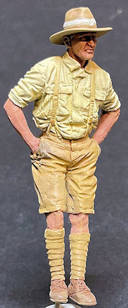

sandbagger Posted October 28, 2023 Author Posted October 28, 2023 Hi all, The figures are now done. The two mechanic figures were from 'Kellerkind' (54107) and 'Copper State Models' (F32-052). The Camel and rider were from the 'Master Box' Commonwealth AFV Crew (S3564). The decorations on the camels saddle cloth were created from the 'Xtradecal' White parallel stripes (XPS2) decal set. The decorations on the camels breast strap were created from: 'Xtradecal' White parallel stripes (XPS2) decal set Cut from scrap lozenge decal from a 'Wingnut Wings' Fokker D.VII kit. The harness rope is copper wire painted with 'Tamiya' Dark Yellow (XF60) then dusted with dark earth pigment,, Mike 5
