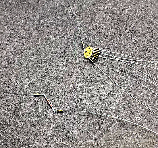

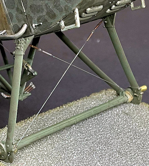

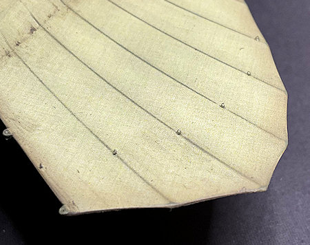

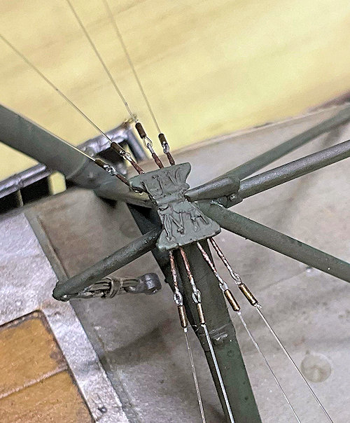

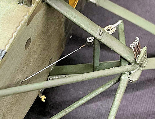

The rigging anchors in the trailing edges of the tail (both sides) and the wings are photo-etch ‘HGW’ 1/32nd scale Spoke Eyelets (132129).

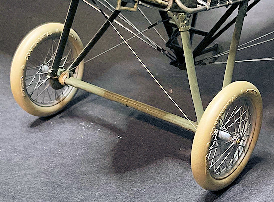

The rigging on the landing gear, claw brake and wing flying/landing wires was fitted using 0.08 and 0.12 mm mono-filament with 0.4 mm and 0.5 mm blackened Brass tube.

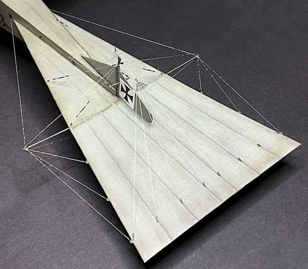

Hi all,

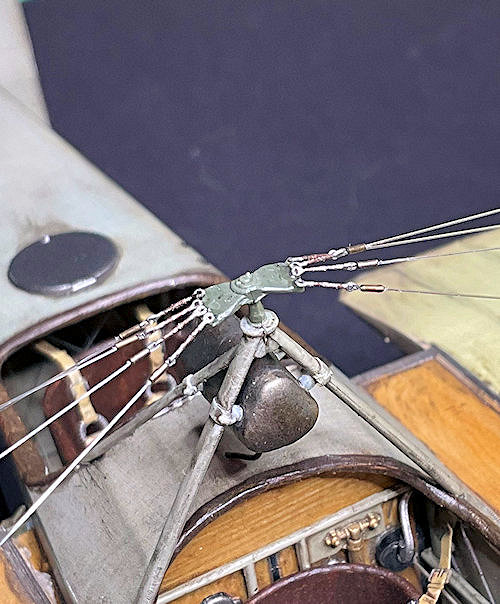

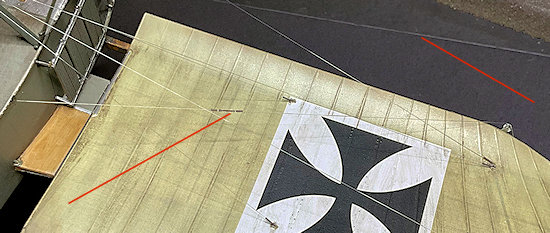

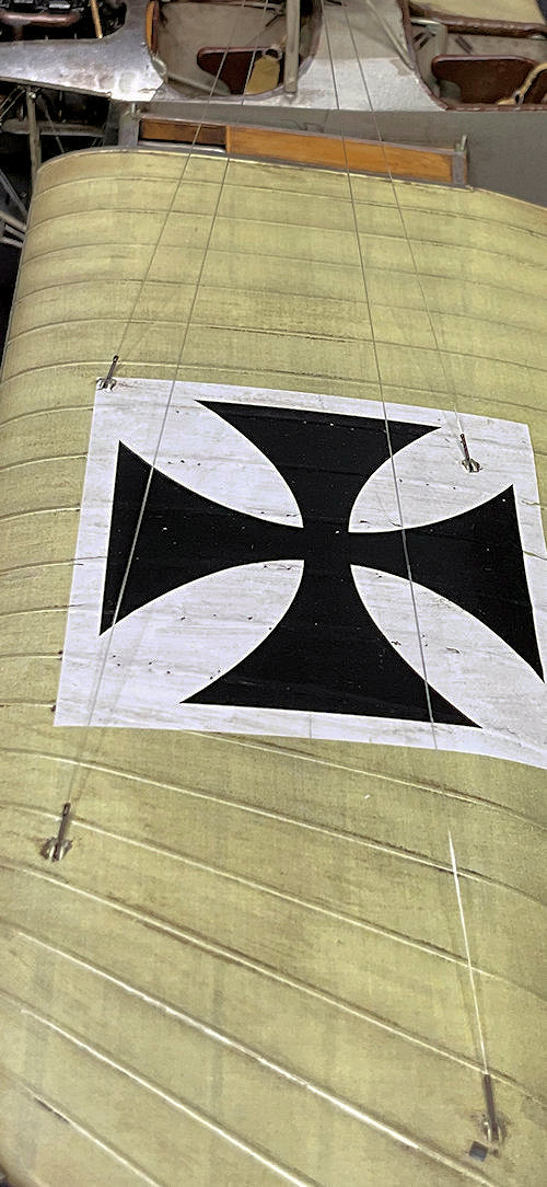

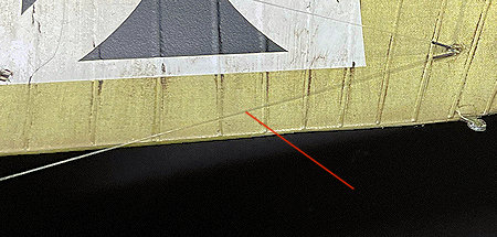

The wings have now been rigged.
I've added the drags wires from the fuselage to the outer underside of the wings.
Also the wing warp control cables.
Finally, the wing outer bracing wires.
A combination of 0.08 or 0.12 mm diameter mono-filament, blackened 0.4 or 0.5 mm tube.
Turnbuckles are either Gaspatch 1:48th metal (Type C) or Proper Plane 1:32nd resin (RD-005).

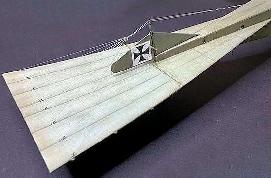

Now it's time to rig the tail,
Mike

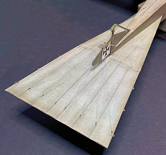

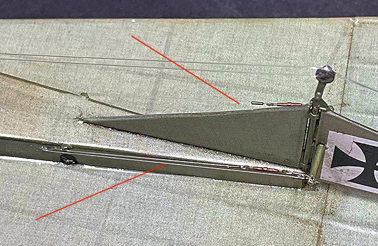

Hi all,
The upper tail warp and restraining cables are rigged.
Turnbuckles are Proper Plane 1:32nd resin (RD-005).
Wheels are also now fitted.
Now it's time to rig the underside cables,
Mike
Hi all,
The underside tail warp control lines and restraining cable are now finished.
Now it's onto the rudder control and restraining cables,
Mike
Hi all,
The control and restraining cables for the upper and underside rudders are now finished.
Line is 0.08 mm diameter mono-filament, 0.4 mm diameter tube and Proper Plane turnbuckles (RD-005).
Now it's onto the final rigging, which is the tail bracing wires,
Mike
Hi all,
The tail is now fully rigged.
Now it's onto the final few pieces (windscreen, vent pipe, exhaust pipe, propeller) to finish the model,
Mike
