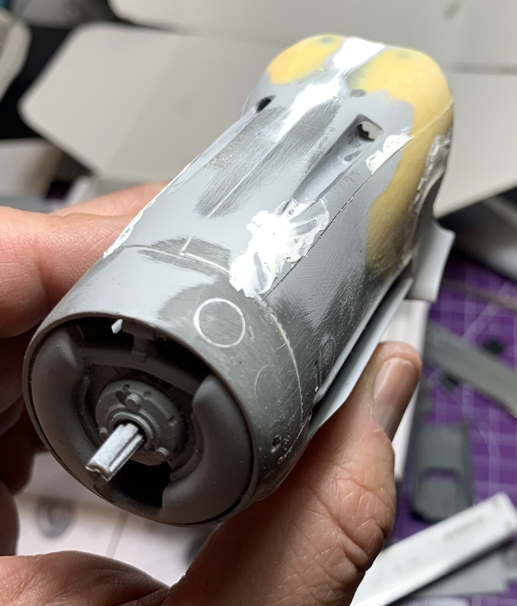

Grafting Trump radiator on the Airfix power egg assembly. You can see how Trump had to compensate for the nose up attitude by altering the slope of the upper edge. And how I tried to alter it by layer of putty at the front of it.

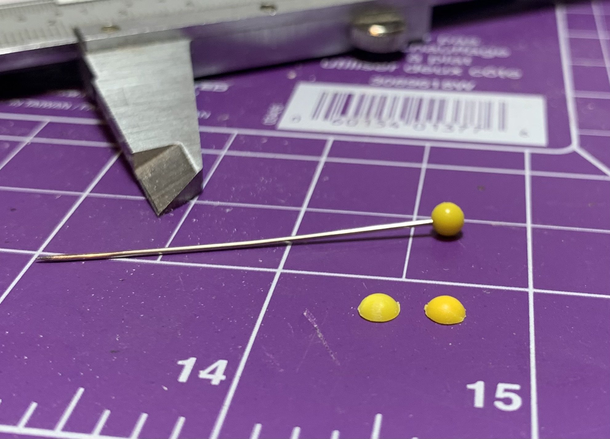

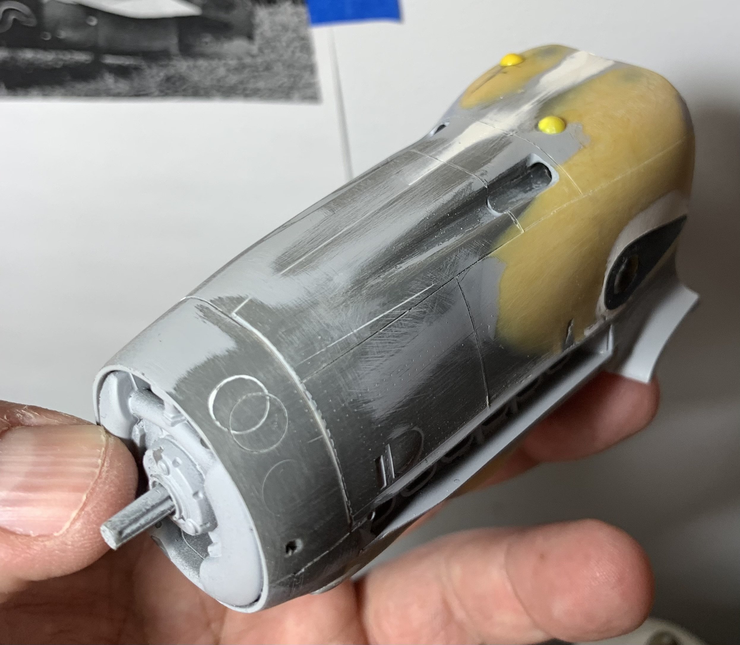

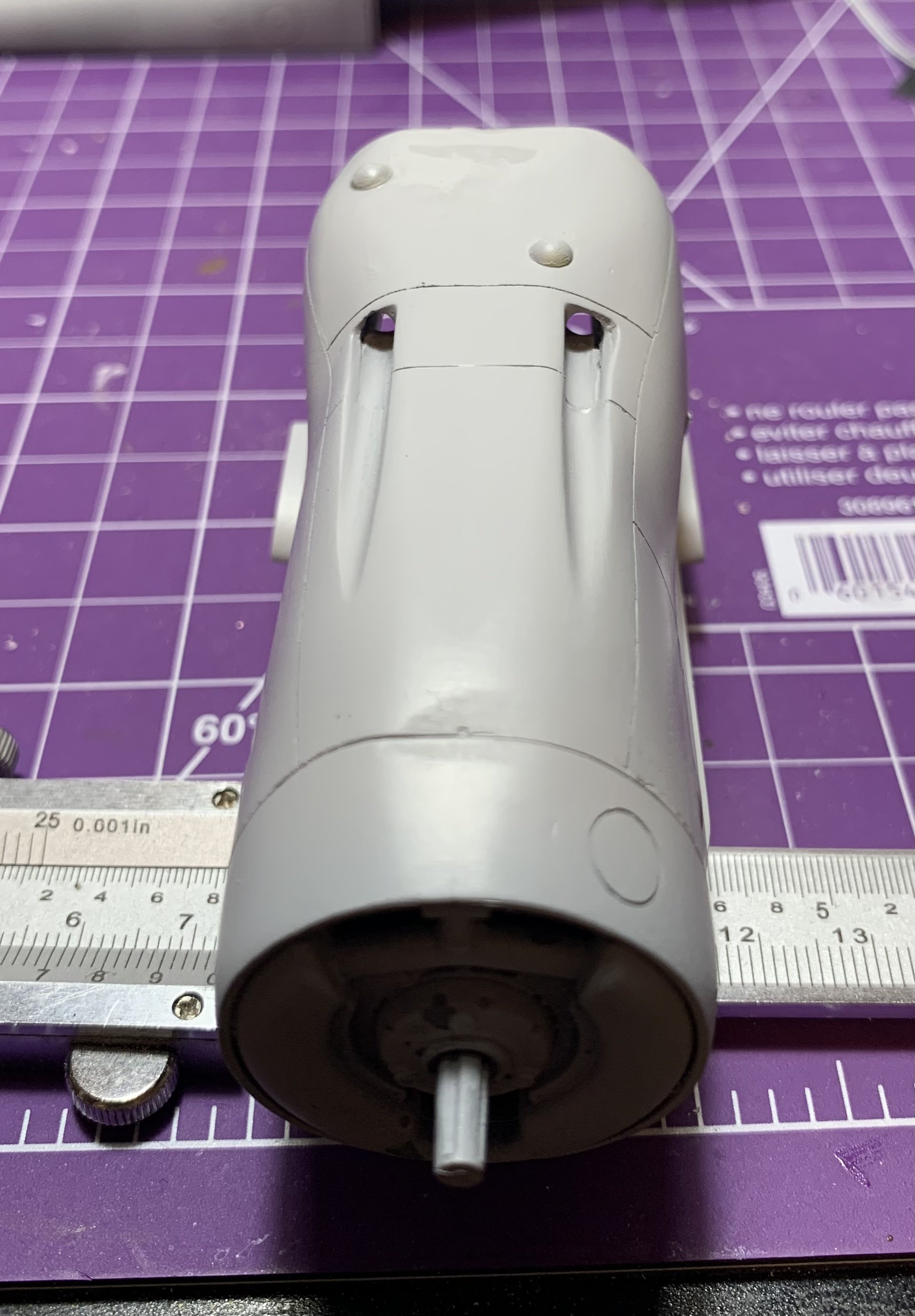

The progress is slow, I can work behind my bench only for short period of time. Usually ten minutes at the time. The main wing is almost ready. I finalized the shape of the wing bulges and created space for the ejection port shoot that is somewhat compromising the integrity of the gear leg assembly. I’ve also been working on the shape of the power egg , however the progress is much slower there, since everything has to be recreated from nothing. The original parts serve as a locators for positioning if the exhaust , gun ports etc. I know,  one would say that there’s not much difference between the G and K models , but in reality everything has to be altered , scratched build or modified in one way or the other
