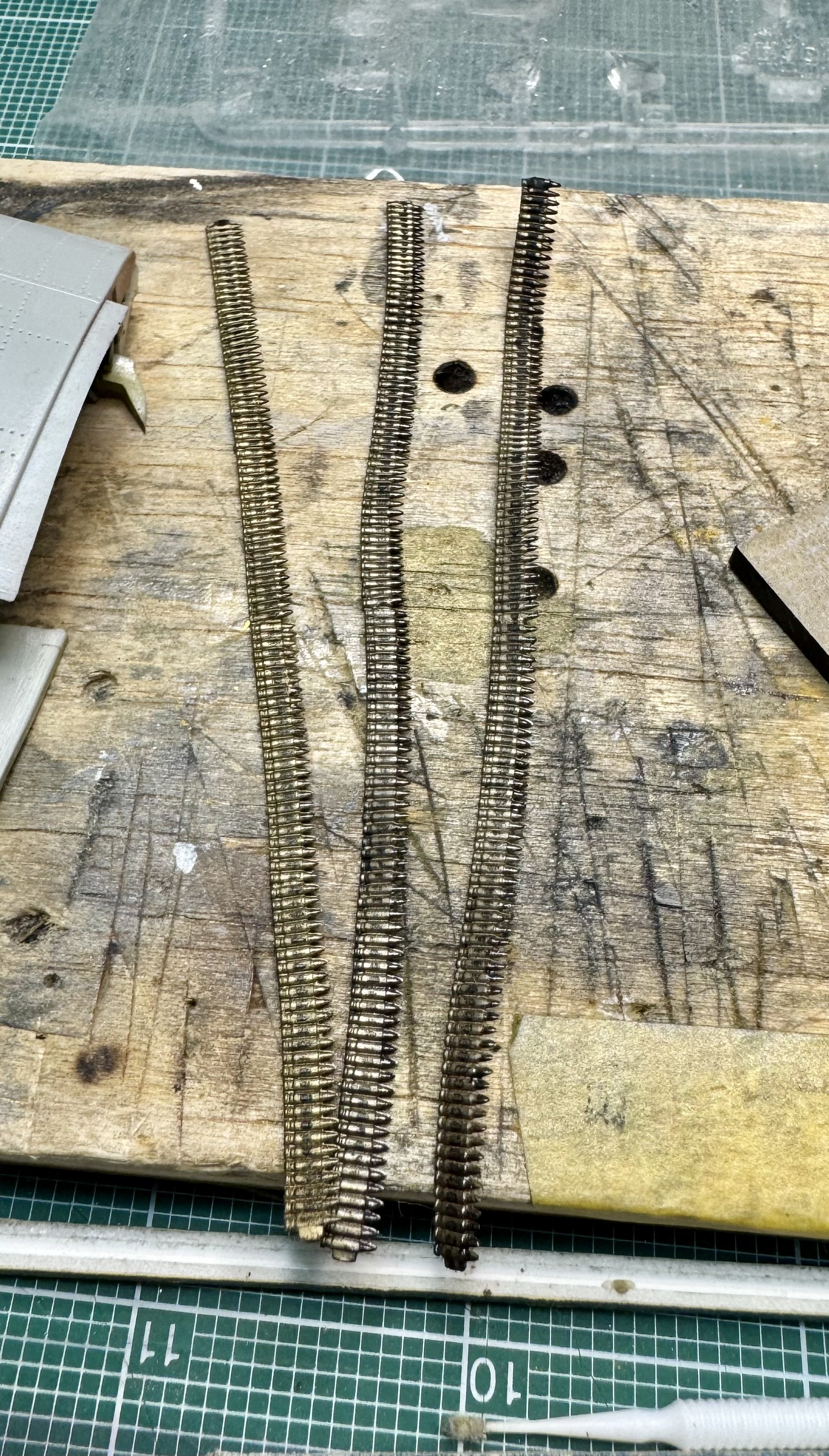

crazypoet Posted October 20 Author Posted October 20 State of play with the ammo belts. having a girlfriend is awesome, but also means that I don’t get a lot of bench time on weekends or most evenings 🤣🙏🤷♂️🤦♂️ So. I ended up having to use a tiny bit of CA to glue the belt ends together, which was a bit of a pain but at least it worked (I tried three other glues, but none of them held together at all). Now each belt is long enough that I can both fit them into the Eduard feed chutes and have enough left to also drape them properly in the ammo trays These have been primed with thinned Vallejo Surface Primer in Panzer Gray, then the cases brush-painted with Alclad Polished Brass, and the bullets themselves hit with just a touch of Tamiya Bronze. its all a bit sloppy up-close right now, but I’ll smooth things out with the next steps There is a lot of *tiny* vinyl flash around the bullets themselves that I’m going to simply ignore - I can’t cut it without making it look worse, so I’ll take a deep breath and hope that it’s hidden once I get them settled in. Once this is all thoroughly dry, I’ll swipe it with a tiny bit of Mr Leveling Thinner to smooth things down, then dust the bullets with Tamiya Weathering Master Copper powder. I'm debating with myself on the belt links. Theres no molded detail on the belts, so I’ll have to do those entirely by hand. Masking long skinny flexible things will be a challenge, but the alternative is to either leave them be or try to paint each link by hand. We’ll see how much I can screw things up when I get to that point 😂🤷♂️🤦♂️ After all that, I’ll glue them down, along with the feed chutes. Once they’re in place, I’ll use my go-to Secret Weapon washes (heavy-body black and sewer water), to refine the links and tone things down a bit Hopefully, I can get them at least close to the reference photo - we’ll see 4
crazypoet Posted October 20 Author Posted October 20 (edited) (Eduard *could* have saved us all a ton of headaches by doing these belts as resin in their Gun Bay set, but noooo 🤣🤷♂️🤦♂️) [edit] and of course, as soon as I said that, I realized that Gaspatch does *indeed* sell resin 1/32 .50cal ammo belts. All I had to do was look 🤷♂️🤦♂️🤦♂️ Now, all I have to do is find someone who can either drop-ship to my friend in the US or ship them to Cambodia. I will probably not get them in time for this build (and they may have some issues with the short-radius bends needed to fit the P-47 ammo trays anyway), but I *will* have them on-hand for my upcoming builds where ammo belts are kinda prominent 🤣 Edited October 20 by crazypoet Doh! 1

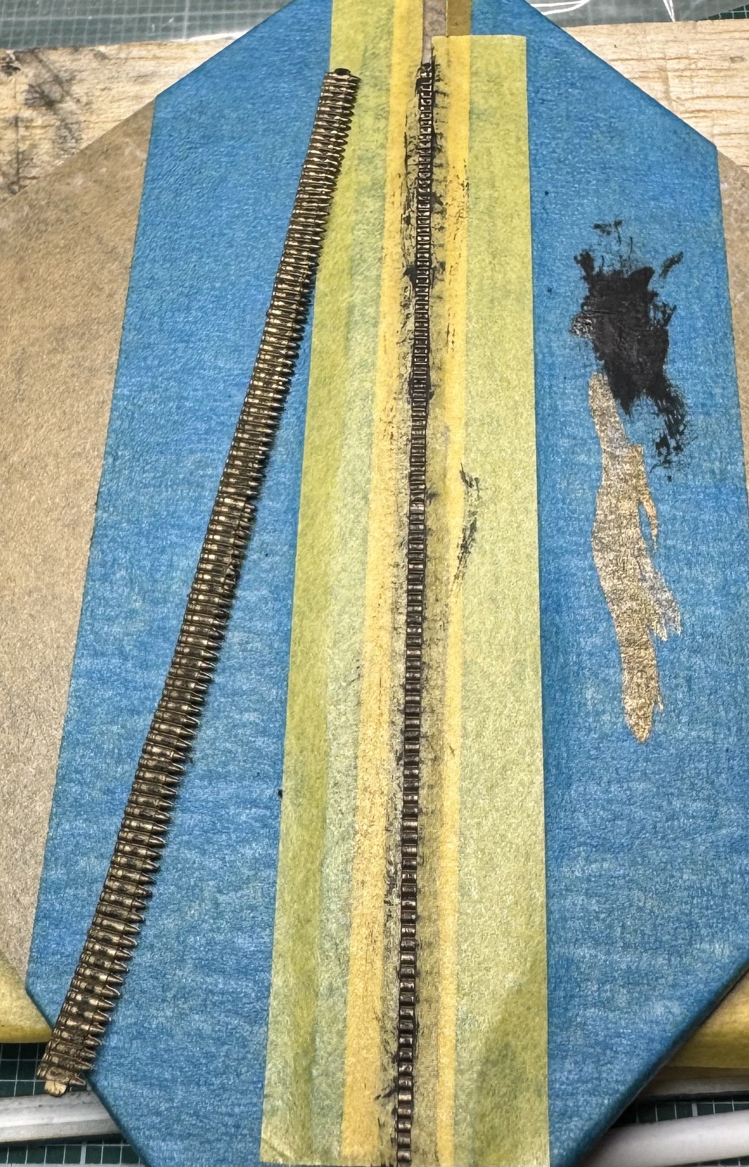

crazypoet Posted October 22 Author Posted October 22 On 10/20/2025 at 9:50 PM, DocRob said: You may consider very thin strips of silver or blackened silver painted Kabuki tape. It may not be correct, but given the scale... Cheers Rob I may give this a shot next 🙏 My first effort at masking and painting the belt links failed miserably - these vinyl/rubber belts are seriously twisty! It’s hard to tape them down solidly enough to get masking tape in nice straight lines along the full length of the belt 🤣 This is the case even after pretty aggressive treatment with hot water to straighten things out - they tend to slowly re-curl a bit during handling *Parts* of the belt I tested on came out perfectly, but other sections were…not perfect 🤣🤦♂️ I’m going to strip off the paint and try a slightly different approach I’m going to use some good sticky office tape and some straight edges cut from spare PE to hold these things as rigidly straight and level as possible, then try again with the masking approach. if *that* doesn’t work, I’ll go with your suggestion. *Really* thin tape might be just the ticket, if I can get it to settle a bit between the individual cartridges (depending on how much trial-and-error I go through with this, the gaspatch cast resin belts may arrive in time to save me and my rum stash from disaster 🤣) 3

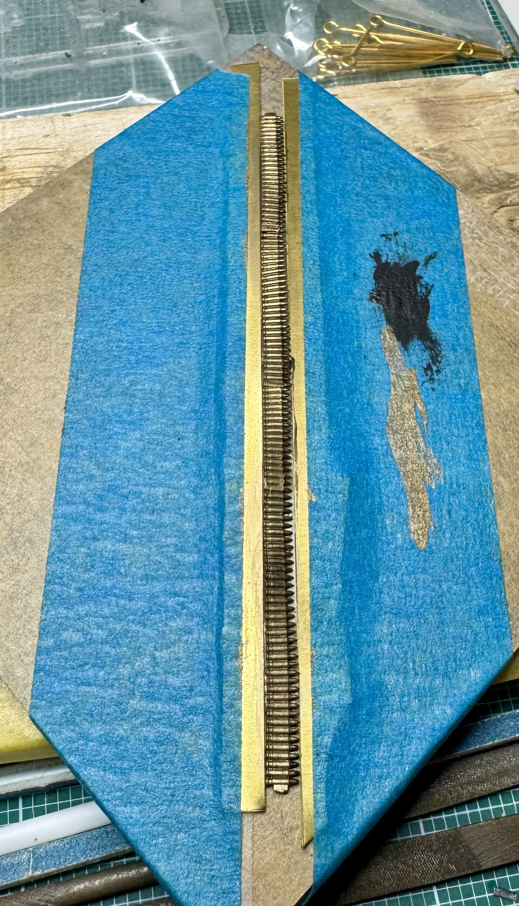

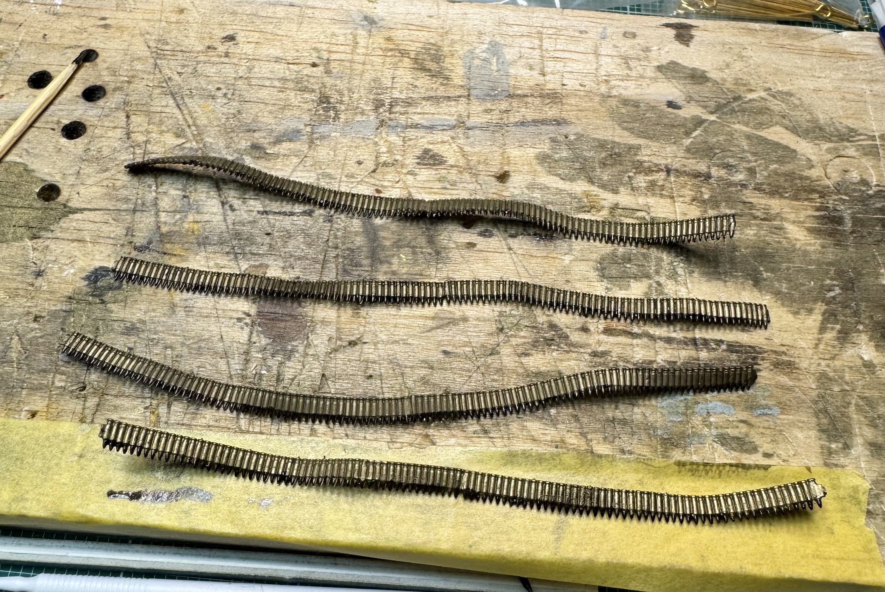

crazypoet Posted October 25 Author Posted October 25 So far, so good-enough 🤣 I made an impromptu “straightening jig” with a little lucite square, some doubled-over office tape to hold the belts down, a couple pieces of thick PE fret left over from the picket boat I finished way back when, and a bunch of masking tape The results aren’t magnifying-glass perfect, but given the belts themselves not having molded links, they’re at least reasonably presentable from more than a couple of inches away You can still see where I glued the belt-ends together, but only if you look closely. I’ll live with that, especially since the glued bits won’t all be lined up side by side in the ammo trays. I’m hoping that it will just look like normal variations in the individual links and rounds once it’s all glued in and a light wash applied to tie everything together 🤷♂️🙏🤦♂️ There’s enough of each belt that looks good that I’ll be able to fill the feed chutes and the ammo bay itself, then I can move on to the last bits of Eduard PE for the gun bay and wrap this stage up 4

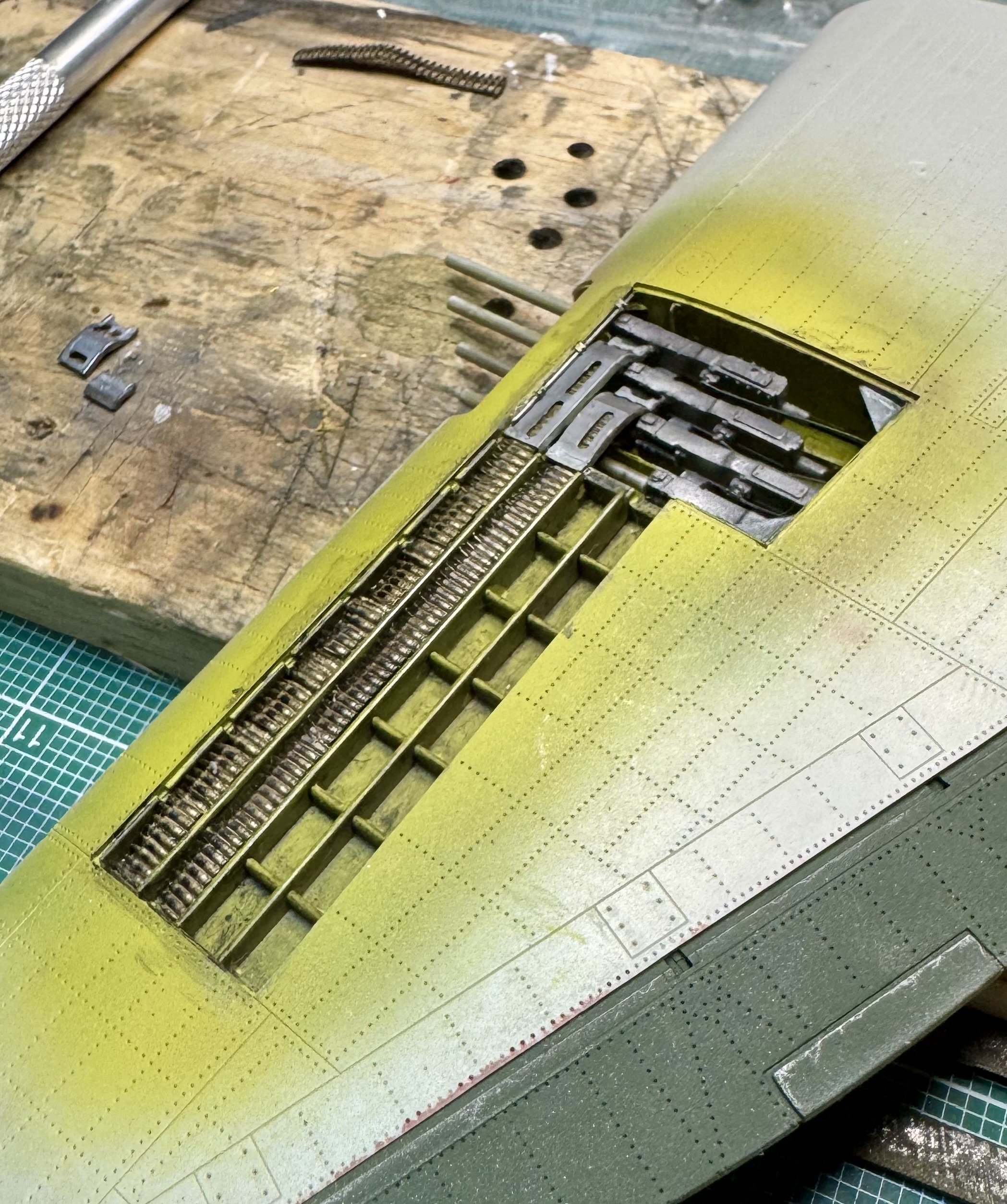

crazypoet Posted October 27 Author Posted October 27 A bit of actual installation progress, finally 🤣 I have the first two chutes and belts in, and I’m mostly happy so far I realized (of course *after* the glue had dried on the first belt) that I’d set far too much “sag” into it between the supports in the tray. Sooooo…. I went back and added a few snippets of links to fill-in, and it looks ok unless you get closer than about 3-4 inches away. grrr It will look a bit better after a gloss coat and some wash, but it shows what happens when I’m thinking a bit behind what my fingers are doing with the tweezers 🤣🤦♂️ The chutes themselves will also get a bit of a touch up with the Uschi powder once they’re all in place Once these are all in and dry, there are a few bits of PE framing around the perimeter to install, then I can face the bay covers. There is supposed to be another steel rod across the back side of the gun bay, according to the photos I’ve seen, but I’m not sure that there will be room for it alongside the PE strip in that same area. We’ll see how it goes at that point The covers will need to be folded up and bent to the appropriate airfoil curves, then they’ll be set aside until I do the final painting and assembly The gun tray cover will sit loose on the wing (not a hinged piece), but the ammo tray cover is hinged with some delicate bits holding it in place The wing insignia overlaps these somewhat, so getting the decals right will be kinda fun - I’ll have to set the covers in-place, cut the decals accordingly, and hope my fingers are steady enough to get everything properly lined up 2

crazypoet Posted November 2 Author Posted November 2 Installed the PE bits around the perimeter of the gun bay - they slotted right in, mostly The piece that bridges across the ammo trays and the ends of the feed chutes was longer than the space, and it took some thinking and judicious trimming. It’s now just long enough that, when installed, it bends up into the airfoil curve that will match up with the panels. I haven’t put any paint on these yet - that will happen later today (my girlfriend is asking about lunch and dinner plans, and those come first 🙏) I’ll do these in Alclad duralumin, I think, with a bit of silver pencil highlights on the fasteners I’m going to try to fit the steel fastener rod across the aft side of the bay (similar to the rod across the forward side). It will take some fiddling around to see if I can shoehorn it into the space and make it look right 6
