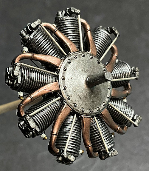

Also the engine is the Le Rhone 9J (supplied in the kit (pre-orders only).
The engine was built as supplied, apart from replacing the valve push rods with Nickel-Silver tube and adding spark plug lead using Modelkasten 0.6 (0.13mm) line,

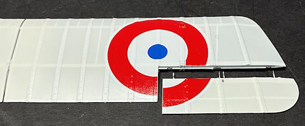

Hi all
When daylight from above passes through the clear doped linen covering of this aircraft, the internal structures and bracing wires can be seen as shadows
To represent this effect, a combination of roundel decals, masking and painting and the addition of appropriate decals from the 'Xtradecal' Black Stripes (XPS1) set was used
These will be airbrushed over to blend them with the base colour to create the shadow effect
Mike
  • 2 weeks later...
Hi all
The basic decals for the structure and rib tapes has been applied
The top surface tapes are 'Xtradecal' parallel white stripes (XPS2) decals.
The underside tapes are cut from 'Aviattic' Off White on Linen (ATT32241) decal
These were all 'faded' back with a light airbrushed coat of ‘MRP’ Clear Doped Linen (MRP-256)
The kit supplied roundels were then applied
The surfaces still need to be weathered slightly
Mike
