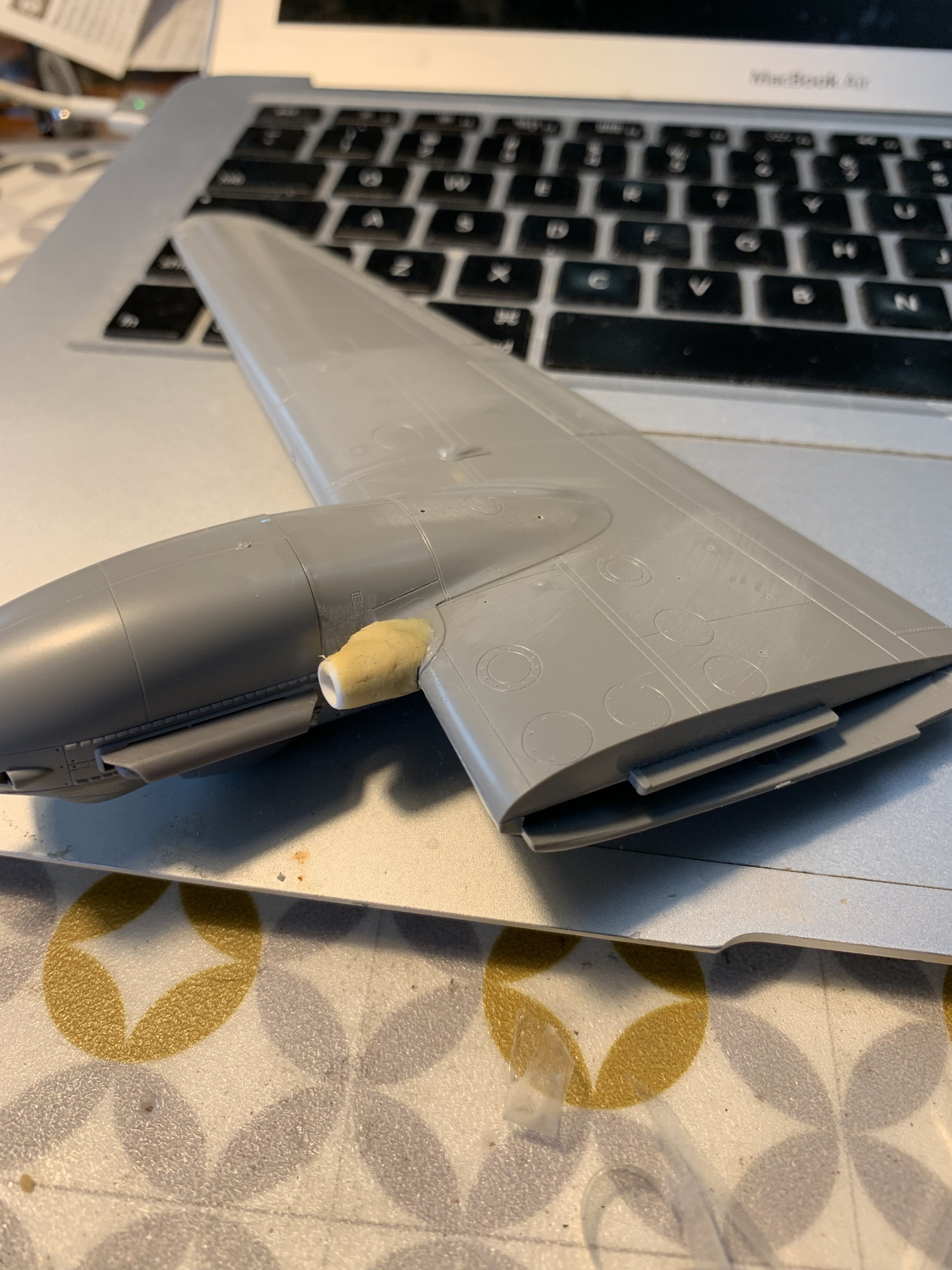

I started my yesterday, by assembling the wings and fabricating a set of new air intakes.

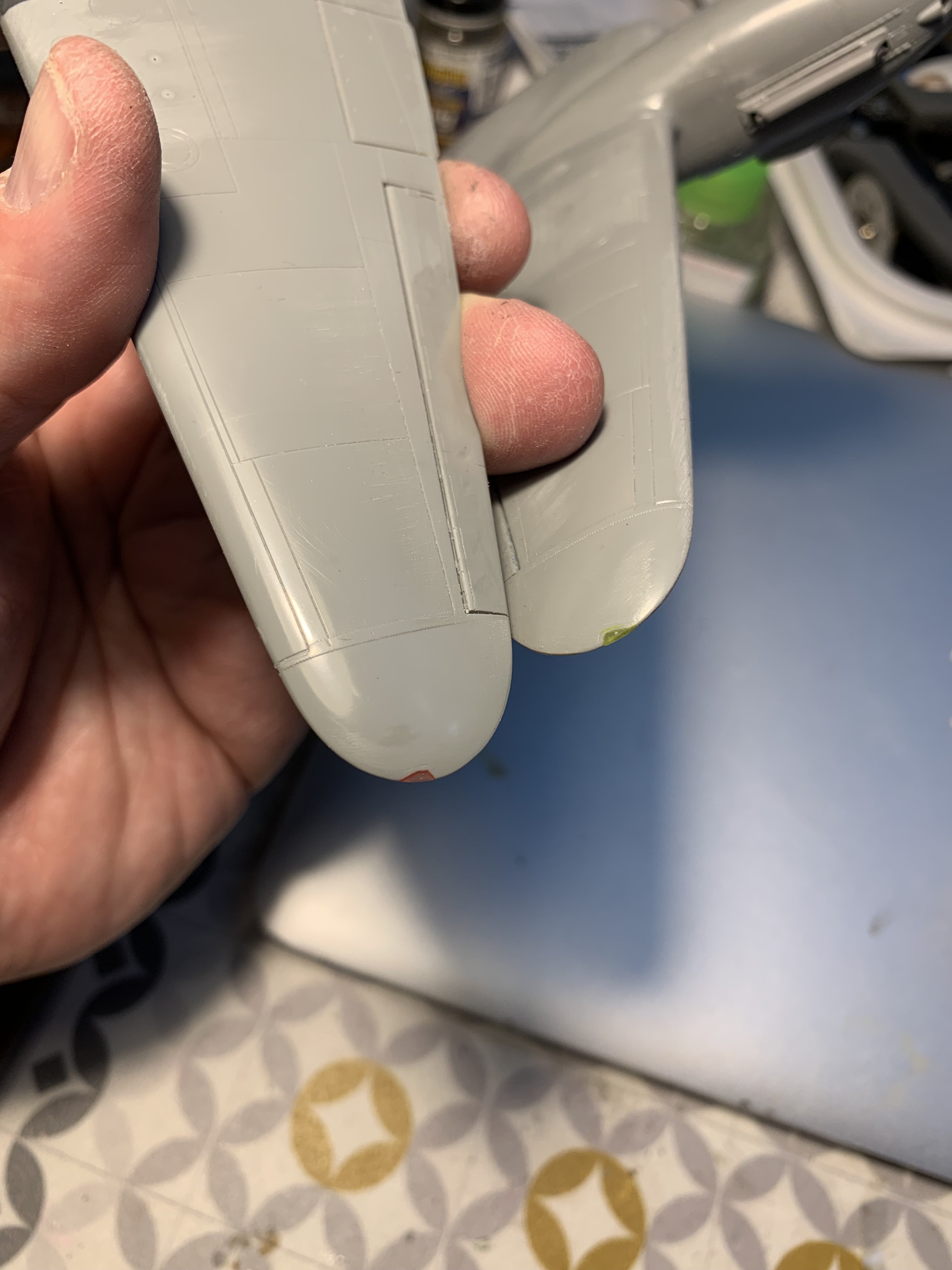

Position lights were cut out and new lenses were created from UV curable resin.

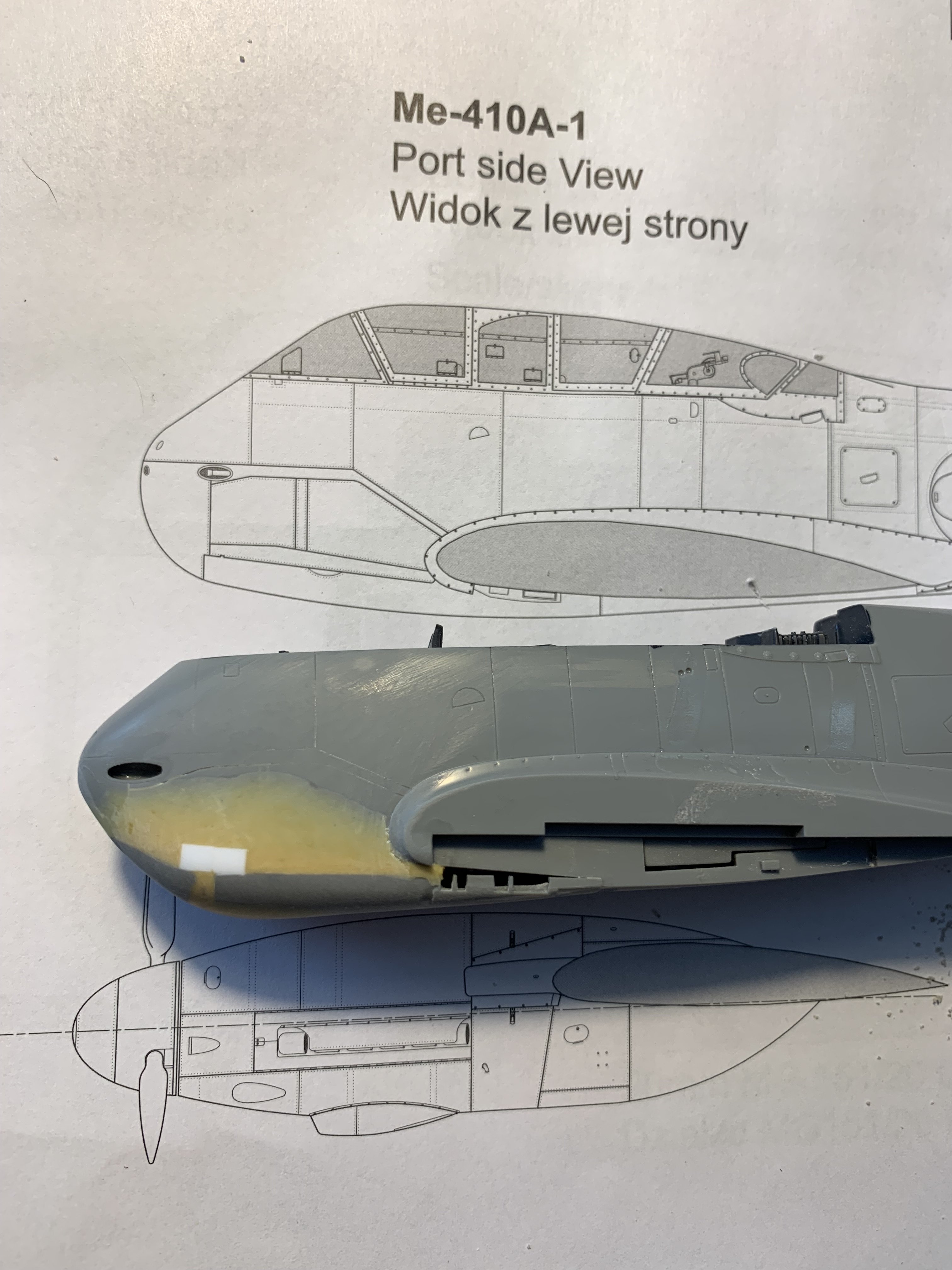

The nose has a whole bunch of issues, think egg-plane which the model is not  I’m not going to recreate the teardrop shape , since I care about my sanity and would like to finish at some point, however some preliminary shaping to catch the glimpse of that funny look  is necessary.

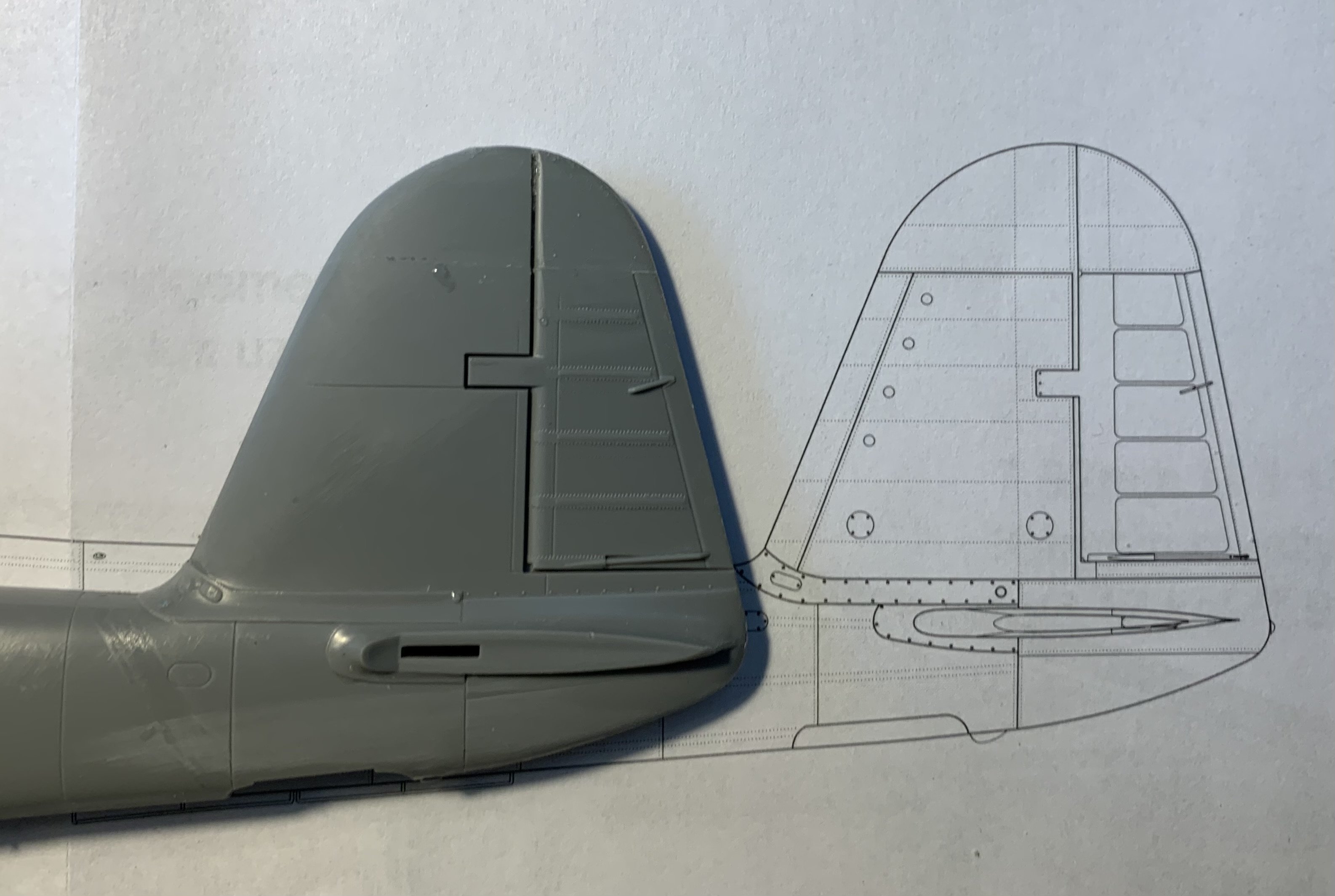

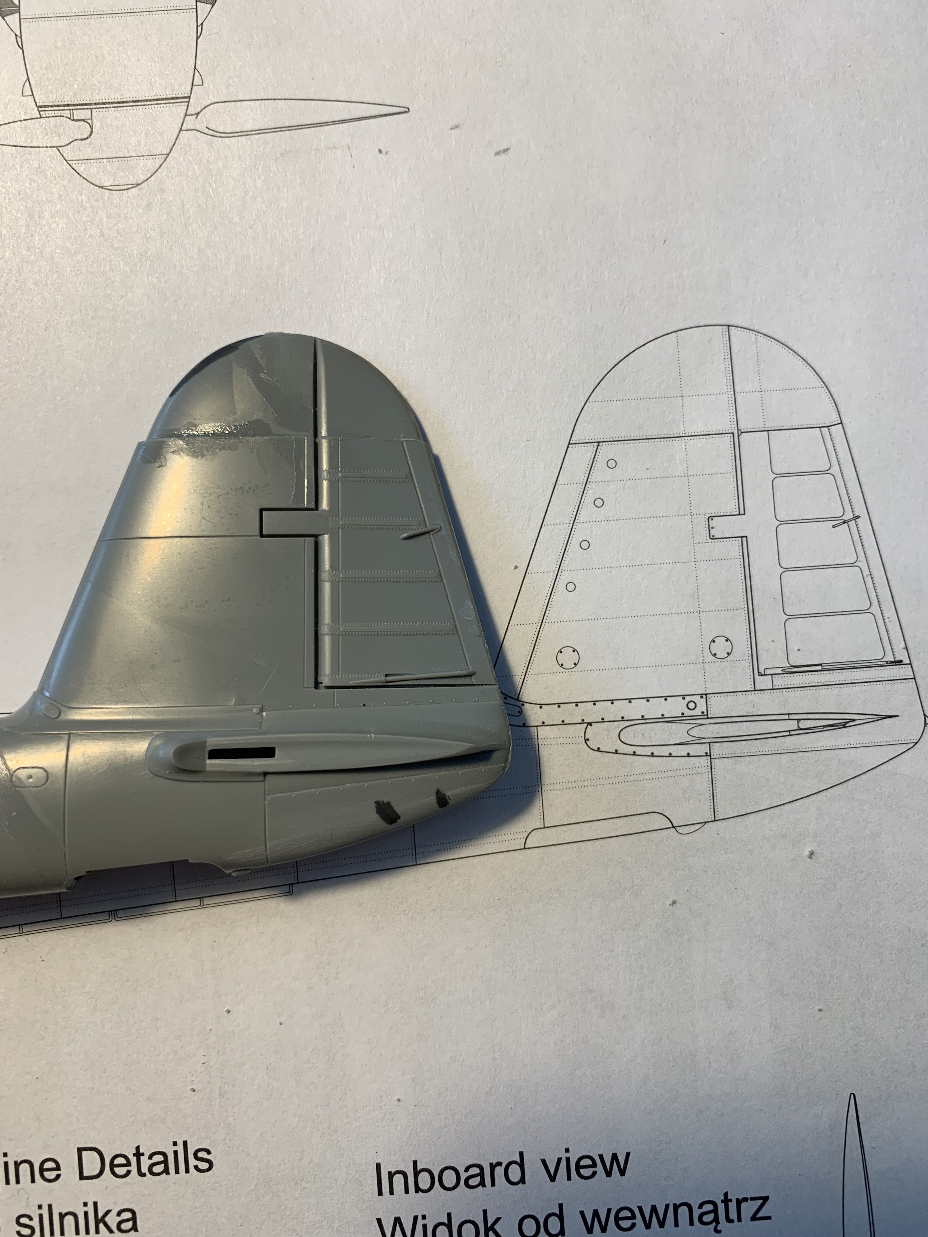

here is some work on the tail. Shortened by 2 mm, top leading edge needs some steeper angle. The original was heavily inspired by the B-29. The bottom needed some reshaping and thinning too. Not sure if worth it?, we shall see.

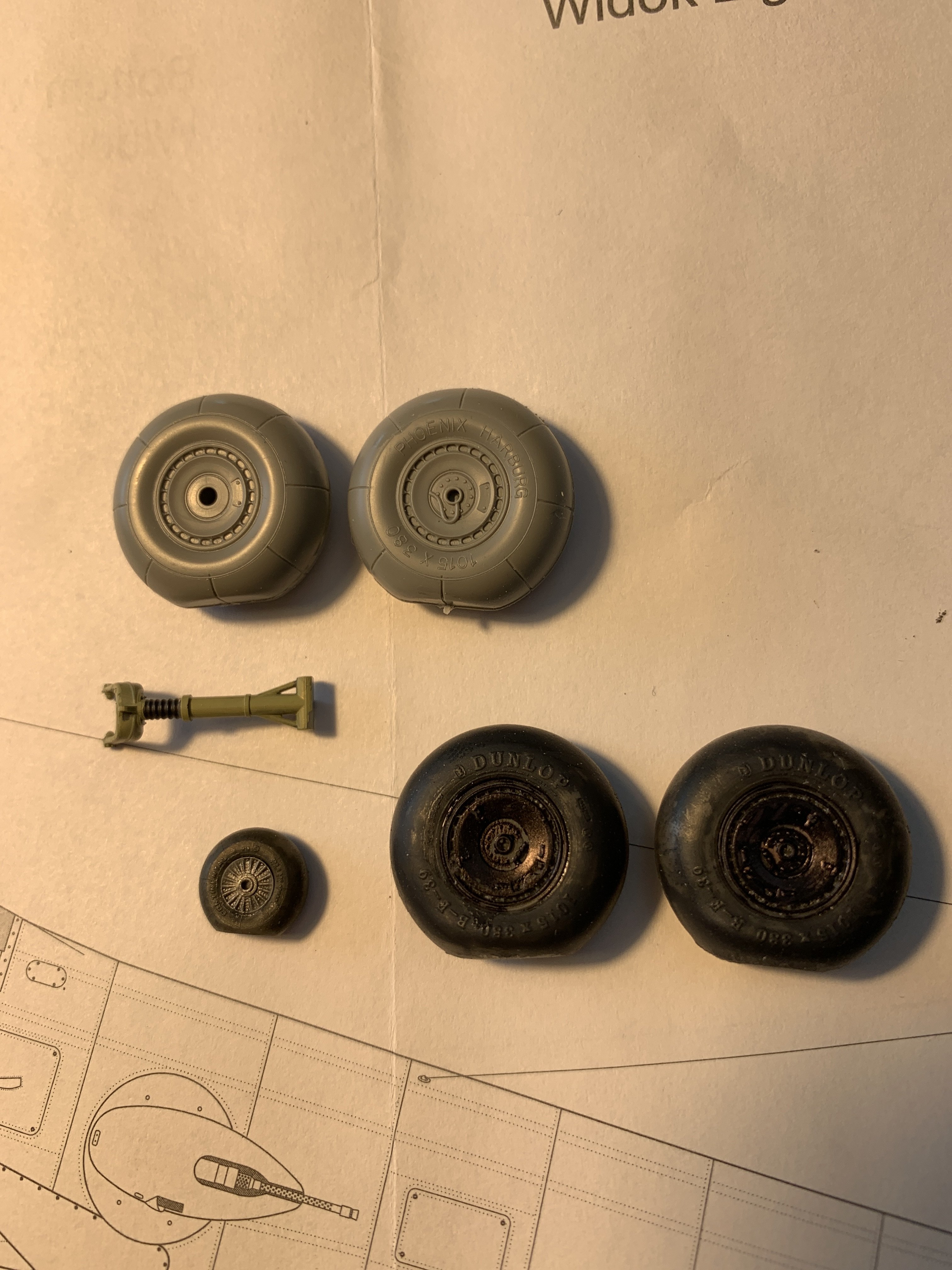

some work on the resin wheels, now that I’m looking at them, I reckon the real value of the resin set is the tail wheel. Kit’s mains are actually really nice.

slowly shaping the intakes, please ignore the paint. It’s just a temporary solution in order to get a better perception of shape.

Martin, quick question(s) for you.  I see you scratched the position lights.  Is there a benefit of doing them now before you paint the wings?
And for the UV resin, do you need a special UV light to cure the resin?  I've never used UV resin before so I'm curious on how you did them.  For example, did you dye the resin red and separately green, then put the resin in place and cure it with UV light?  Etc.
Thanks in advance - I'm already learning a lot for this build!
The resin comes with a small UV light to cure it. Takes seconds of illumination and you can sand it. I approached it in the fast way. First, removal of the plastic lenses, then coloring the cut area with markers (sharpies) green/red, the application of resin blob, then sanding. Ten minutes tops.

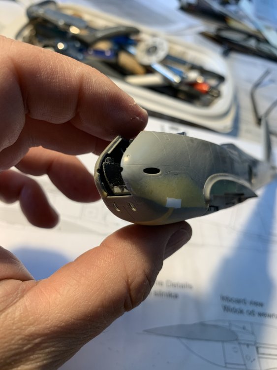

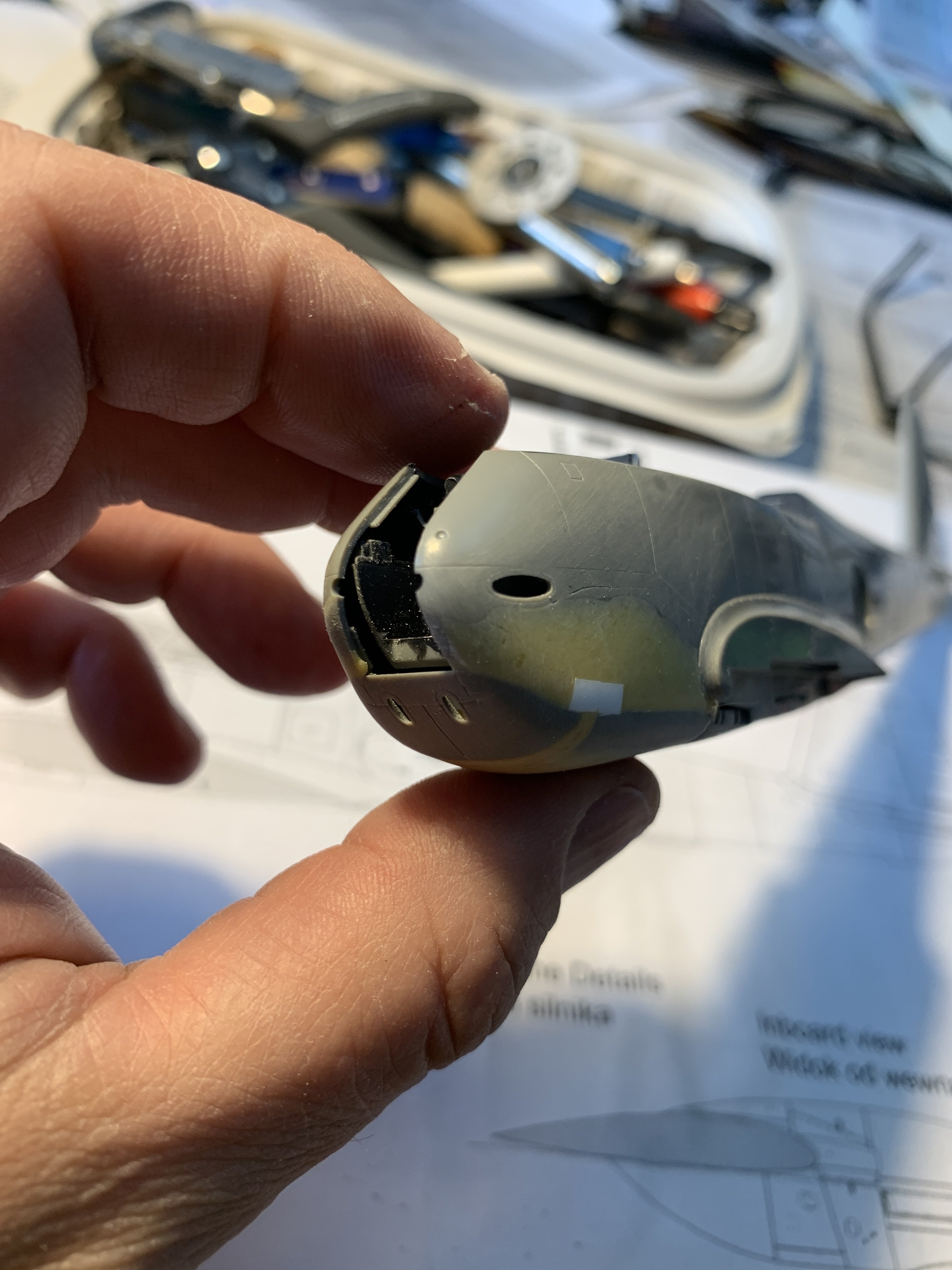

The nose needed more help. I decided to adjust the glazing so it can resemble the typical egg plane look more closely.
these are just baby steps I don’t want to remove too much material. I know that the centre belly part should be more pronounced, but that opens a brand new can of worms. The R4 gun pod should mask it sufficiently.
Interesting on the nose shape.  Looks like you don’t need to take too much to get closer to an accurate representation, nice work!
