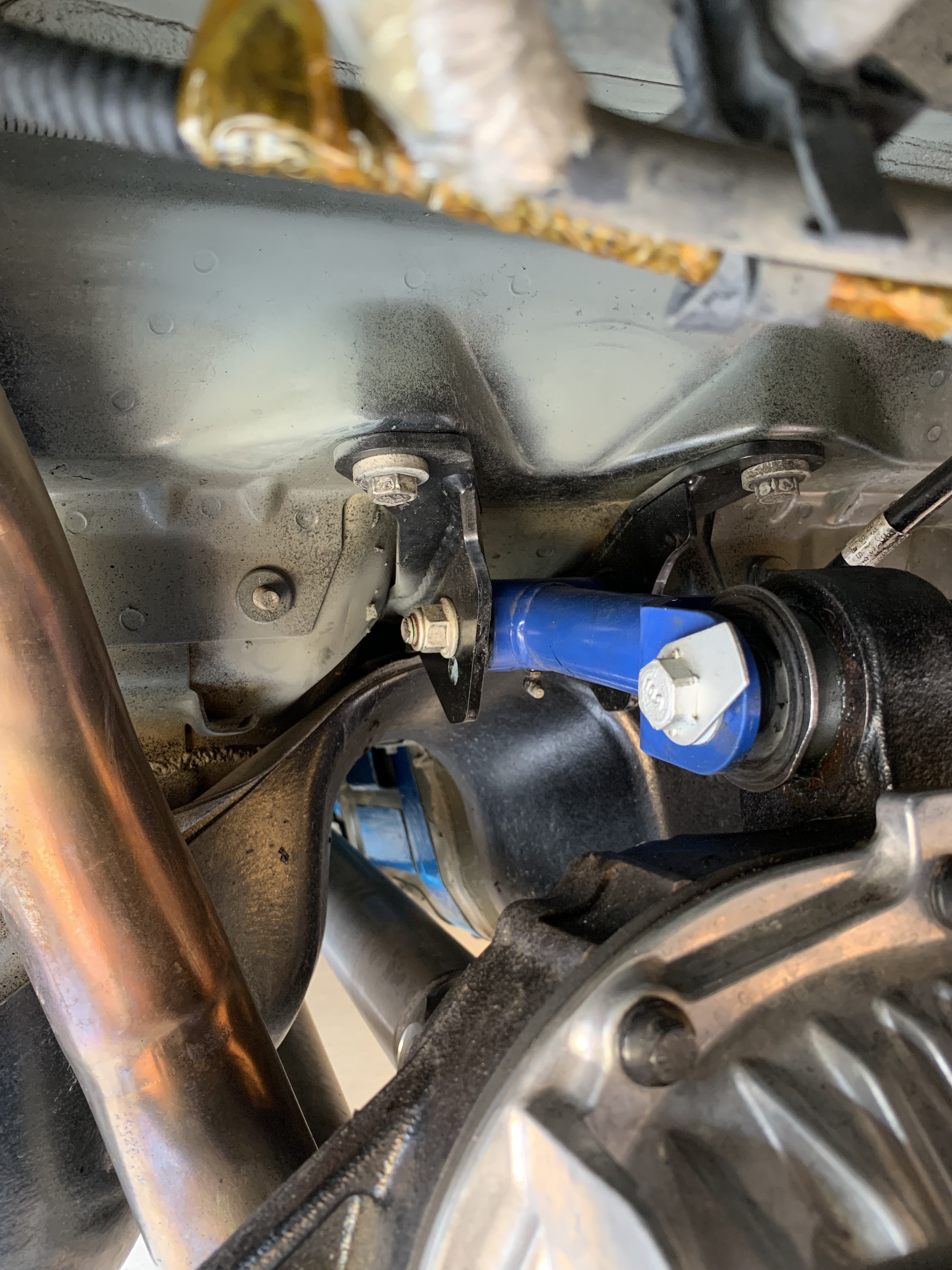

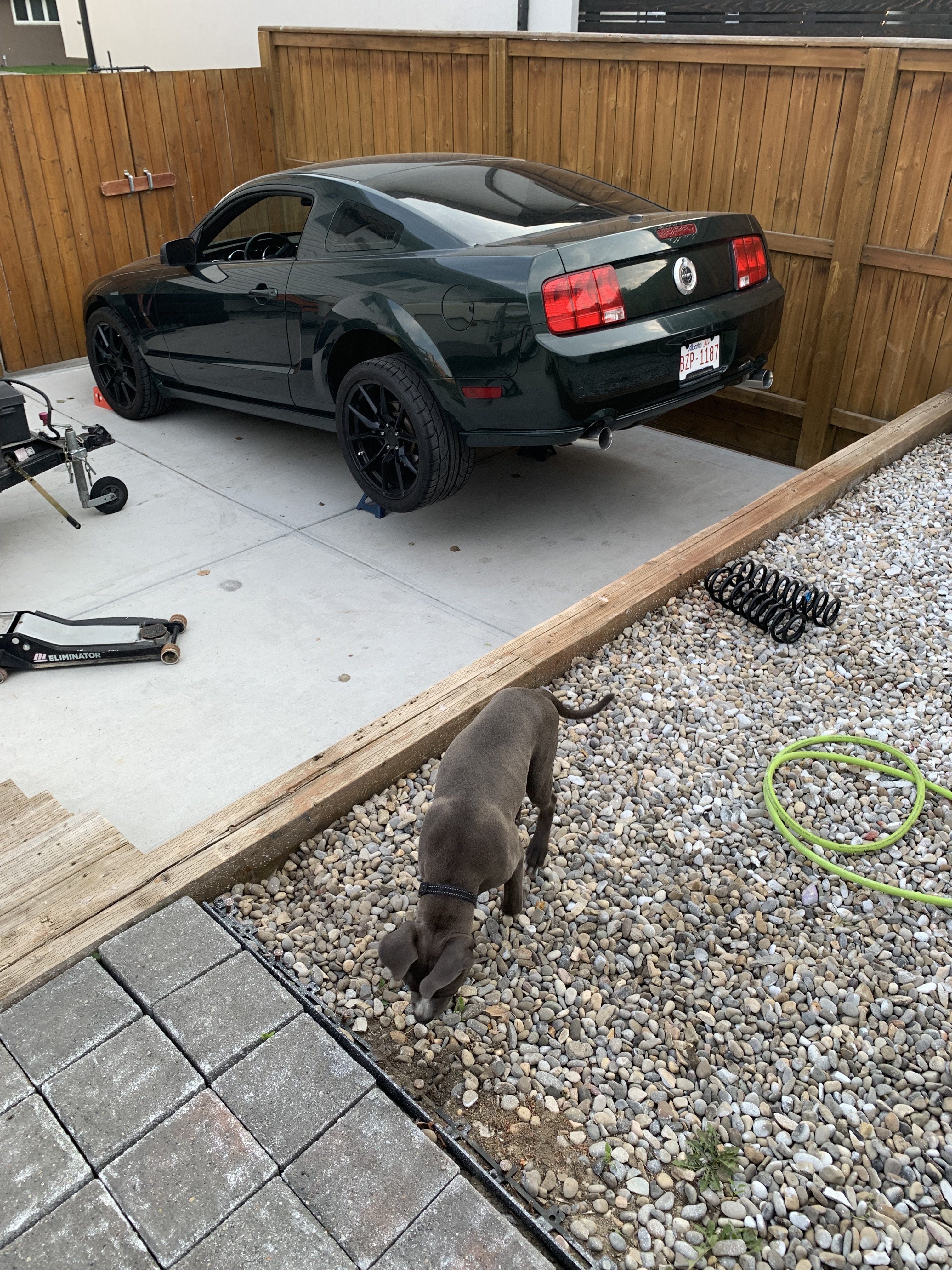

I decided to re-install the original coil springs in the rear. Two reasons, a softer ride and restoring my driveshaft/pinion angle thus eliminating that nasty clunk that has become apparent after I switched to a single piece, aluminium driveshaft.  Now I have the gnarly looking muscle car rake :)

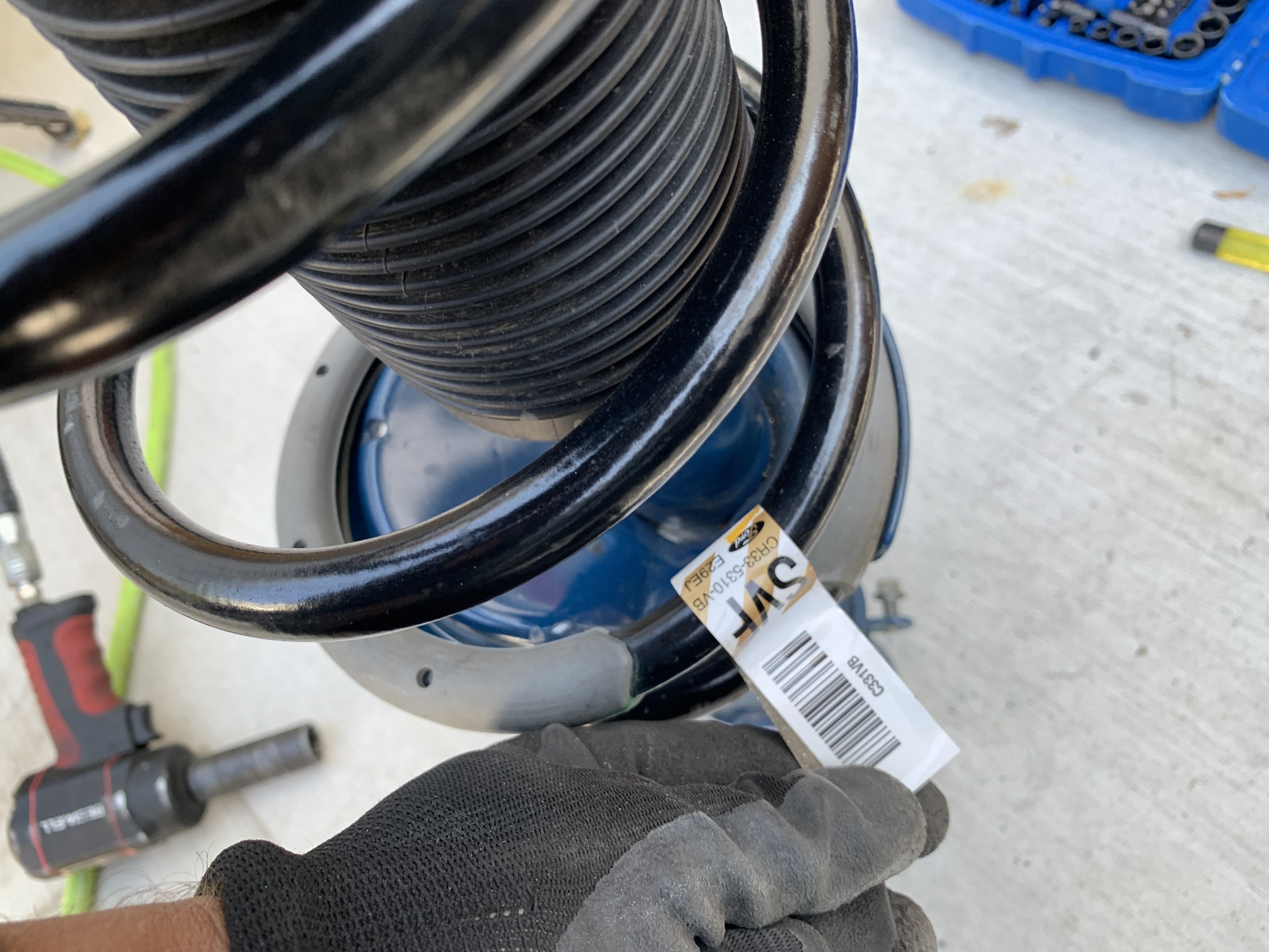

The only way how to replace the messed up sticker on the radiator cover was to buy the whole thing.
but mom!!!?

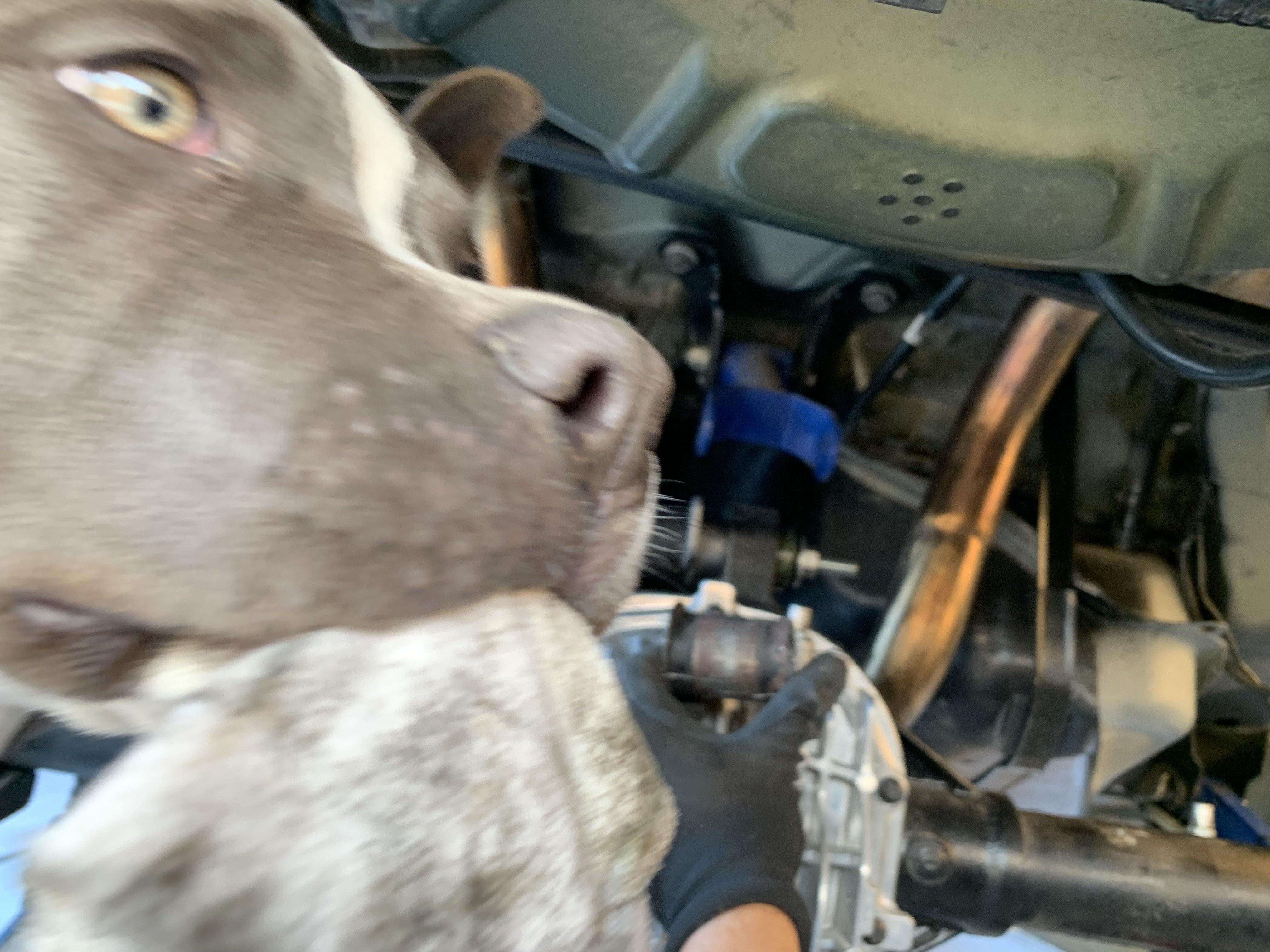

My baby boy helping, err..doing it.

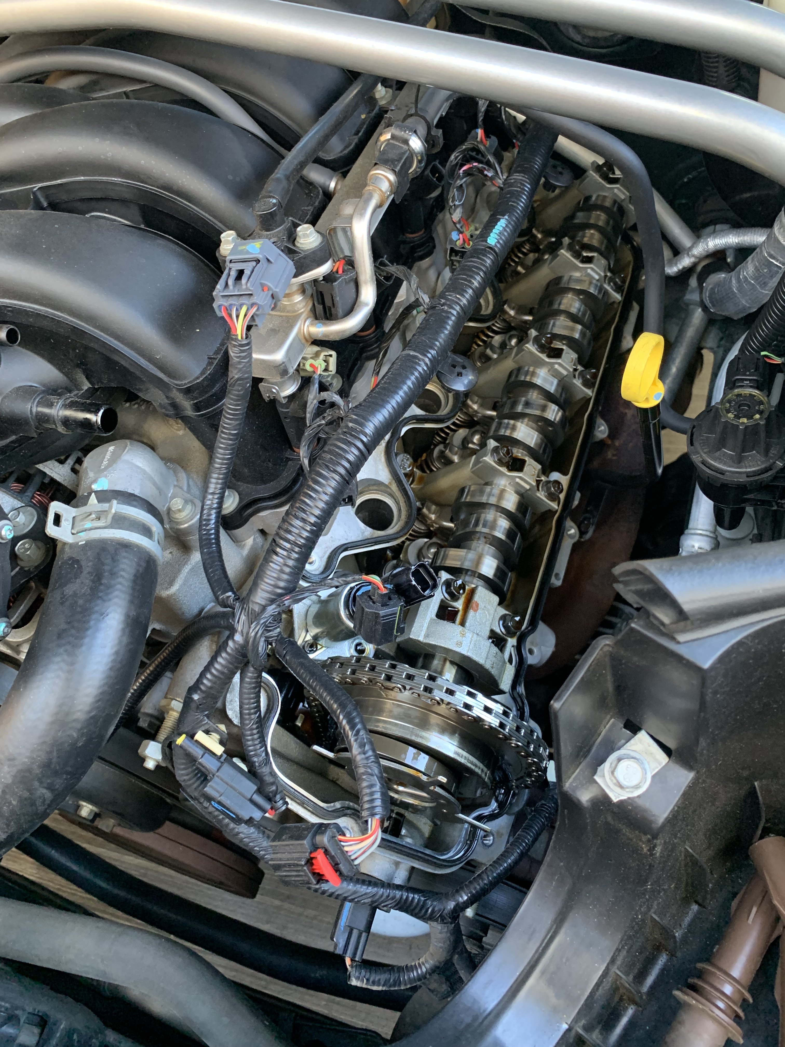

I took off the valve cover to see what is inside. now I know, there are .....stuff. :)

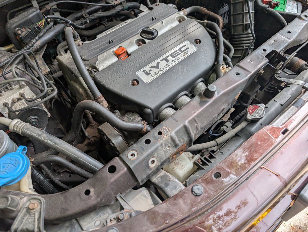

1 hour ago, Martinnfb said:
Oh , gnarly !
It gets worse.

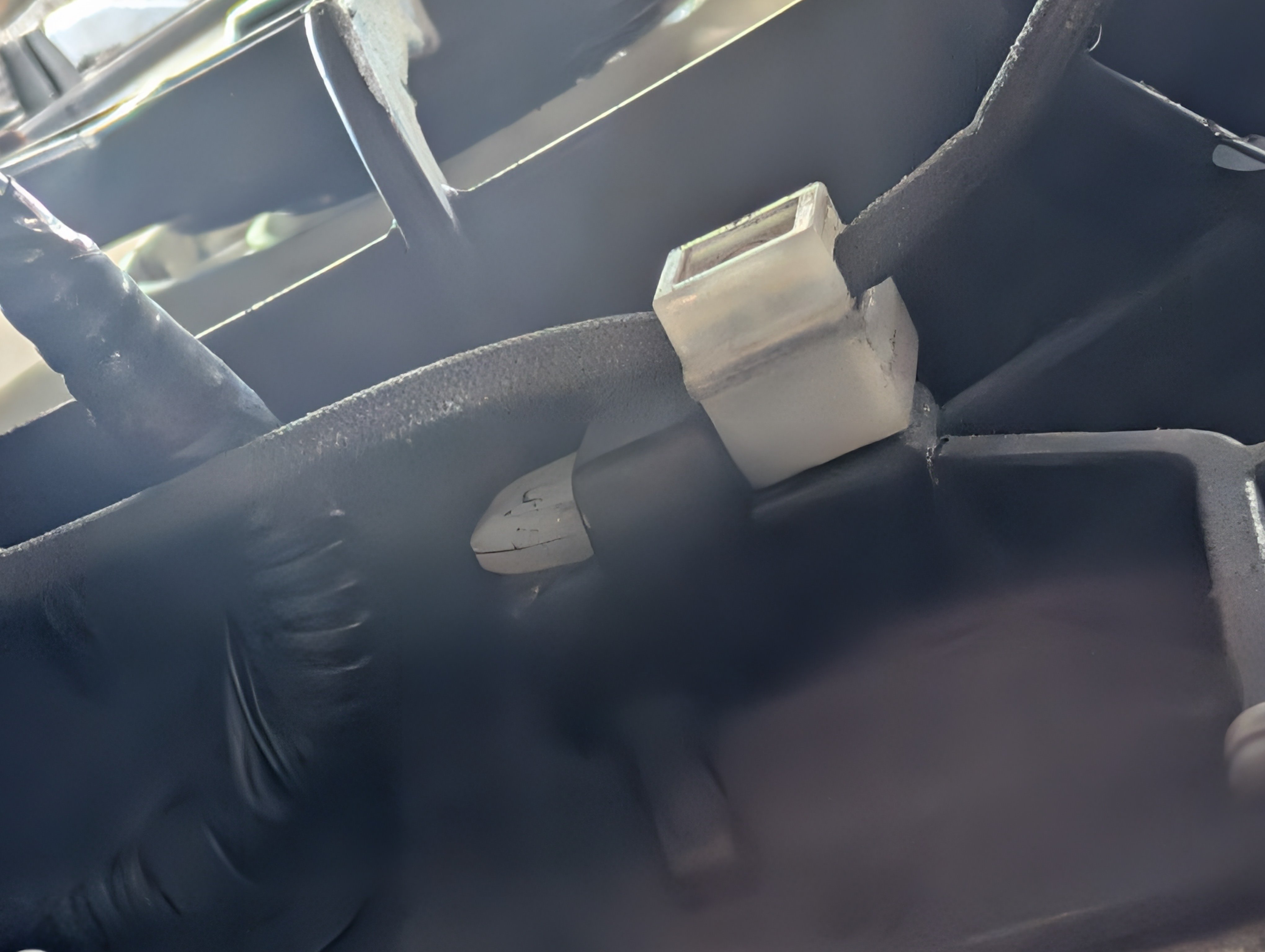

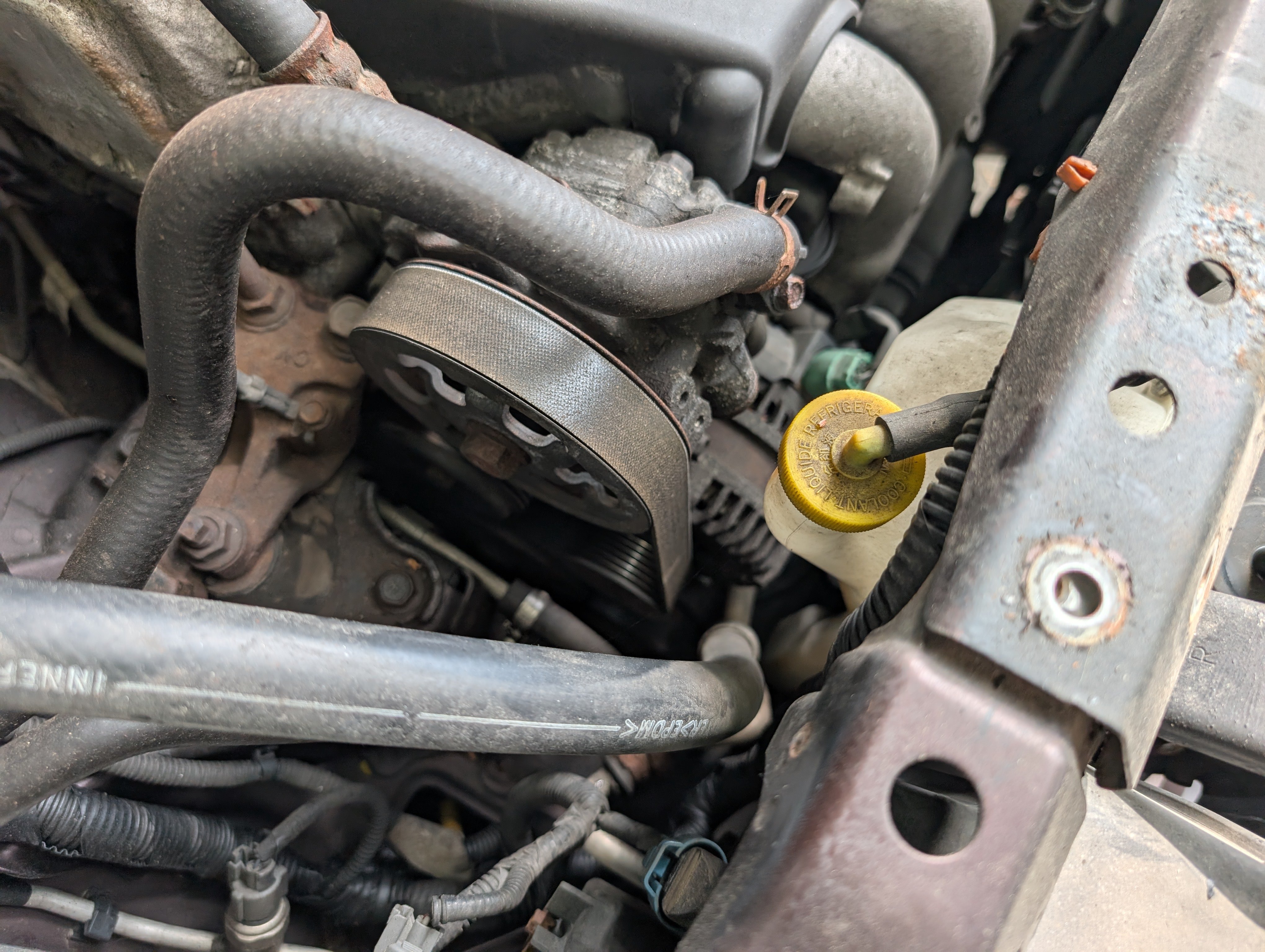

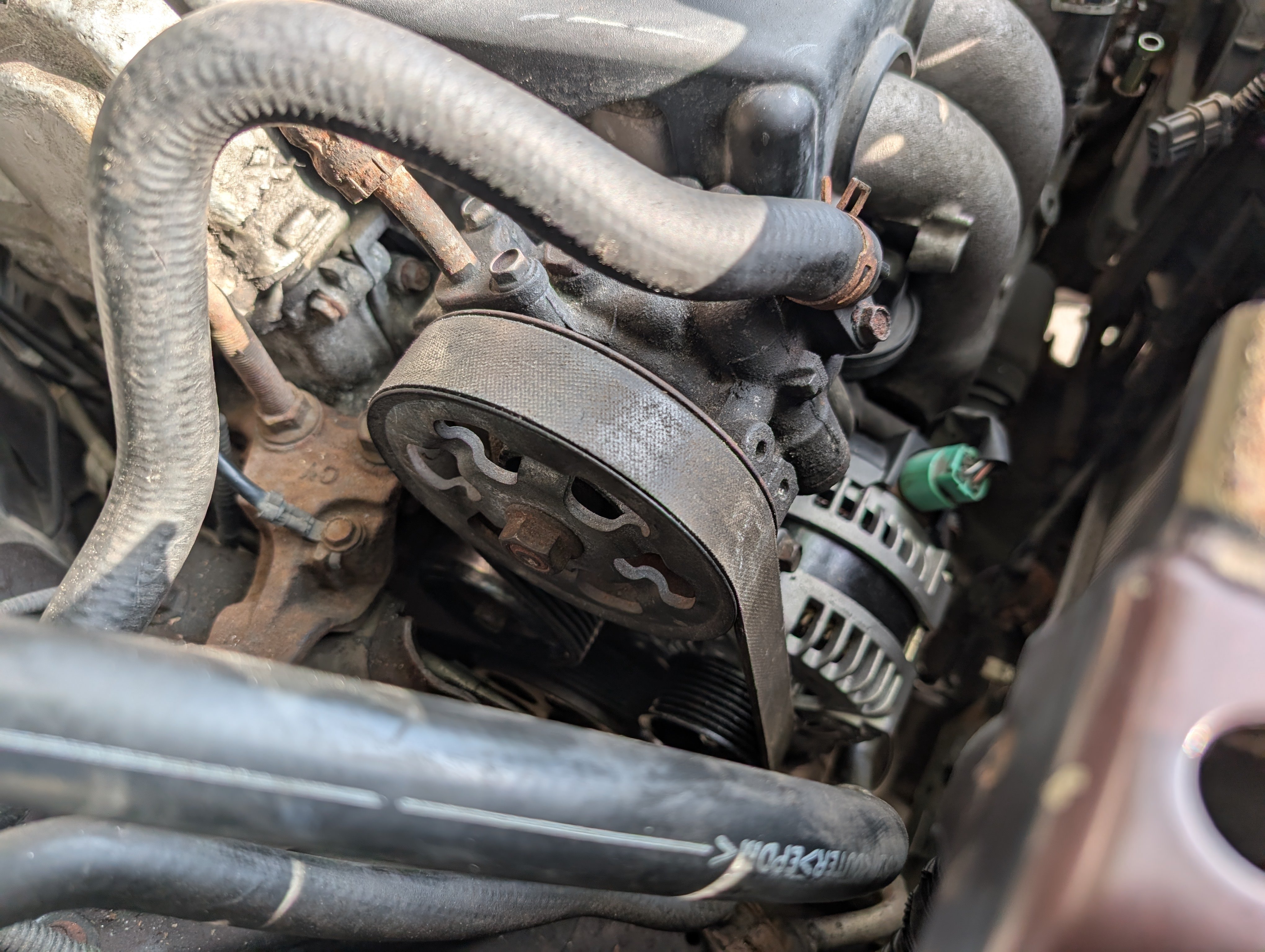

To reach the alternator, I have to pull the rad shroud, loosen and move the rad support and pull the overflow tank. Then I can get to the rad fan which has to come out. Finally, the power steering pump has to be unbolted.  At that point, I can get to the alternator.
So I'm stuck on removing the rad fan. I can't get this clip undone.
It's for a wire that runs on the bottom of the rad fan housing. The pic is from below looking up.
Oh and for some reason, there's absolutely no mention of this wire in any of the guides I've read.
Anyone got an extra set of hands?

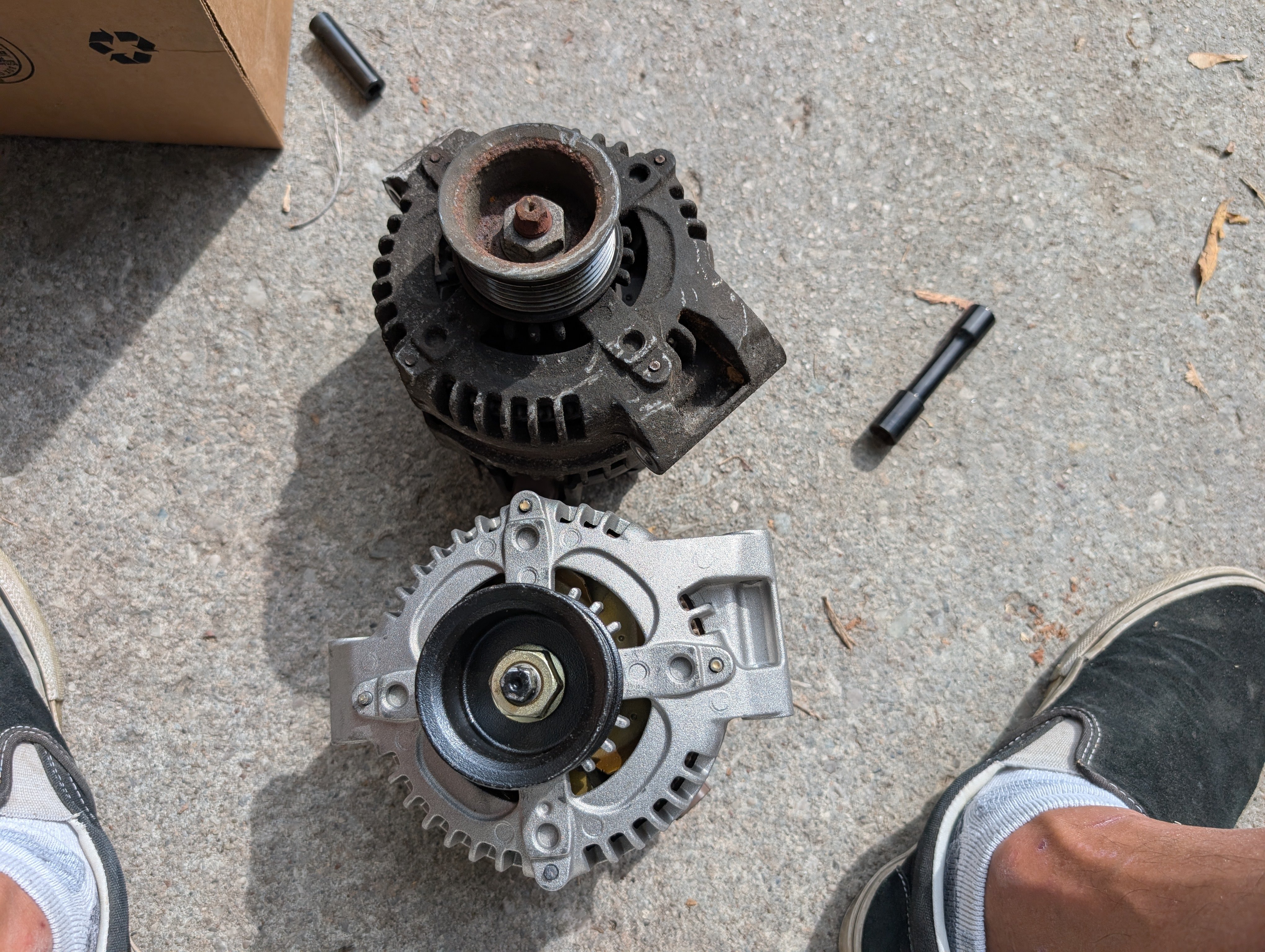

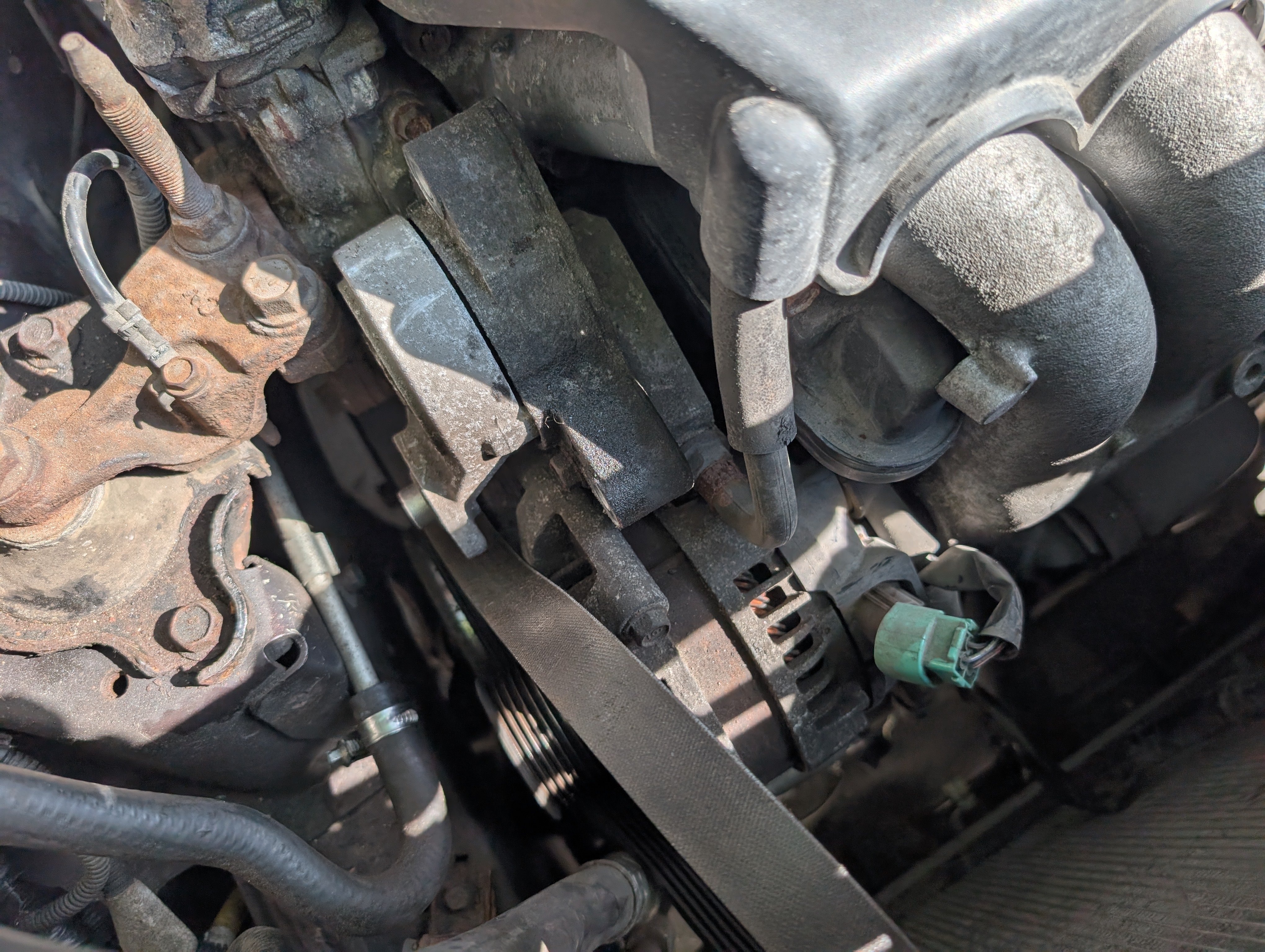

My neighbour came over today and gave me a hand. He got the clip undone so that we could pull the rad fan out.
Then it was the power steering pump and finally the alternator itself.
New vs. old
Everything back together.
A quick test drive and no more dash lights and noises from.under the hood.
