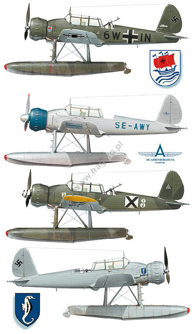

Guest DannyVM Posted May 22, 2013 Posted May 22, 2013 Hi DoogsATX, i ordered the book but still waiting for it, i wrote to Hannants, so at the moment.....waiting waiting waiting........ Thank's for the side wiews scheme's, very nice looking scheme's, thank's. Greetz Danny
Administrators JeroenPeters Posted February 13, 2016 Administrators Posted February 13, 2016 On 5/20/2013 at 10:13 PM, DoogsATX said: FYI Kagero's book has some excellent and offbeat 196's. I really dig the silver Swedish one. me too: http://www.modellversium.de/galerie/18-flugzeuge-zivil/11092-arado-ar-196-a-3-revell.html
