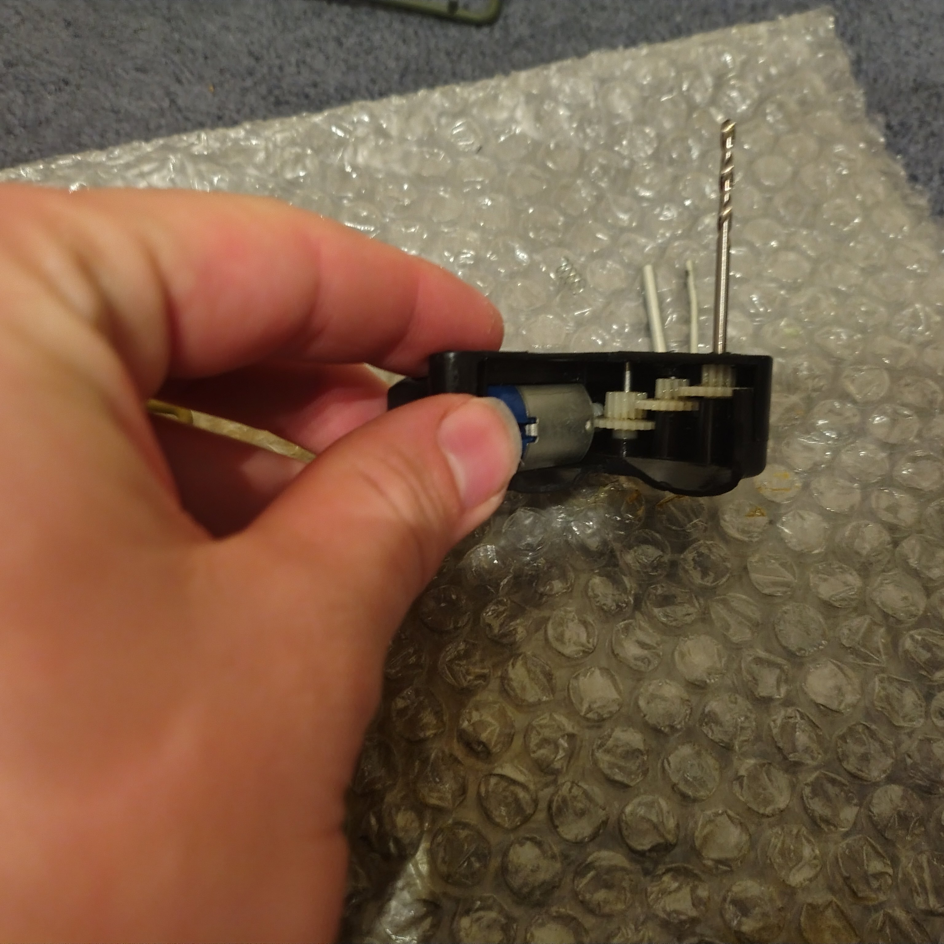

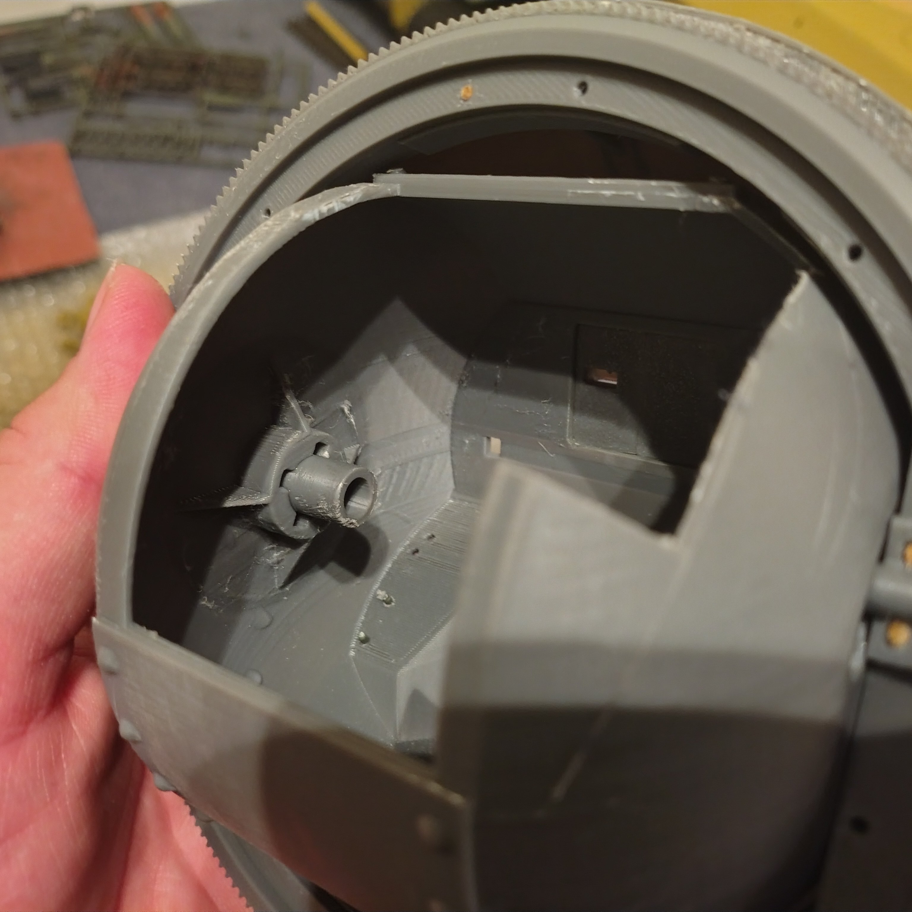

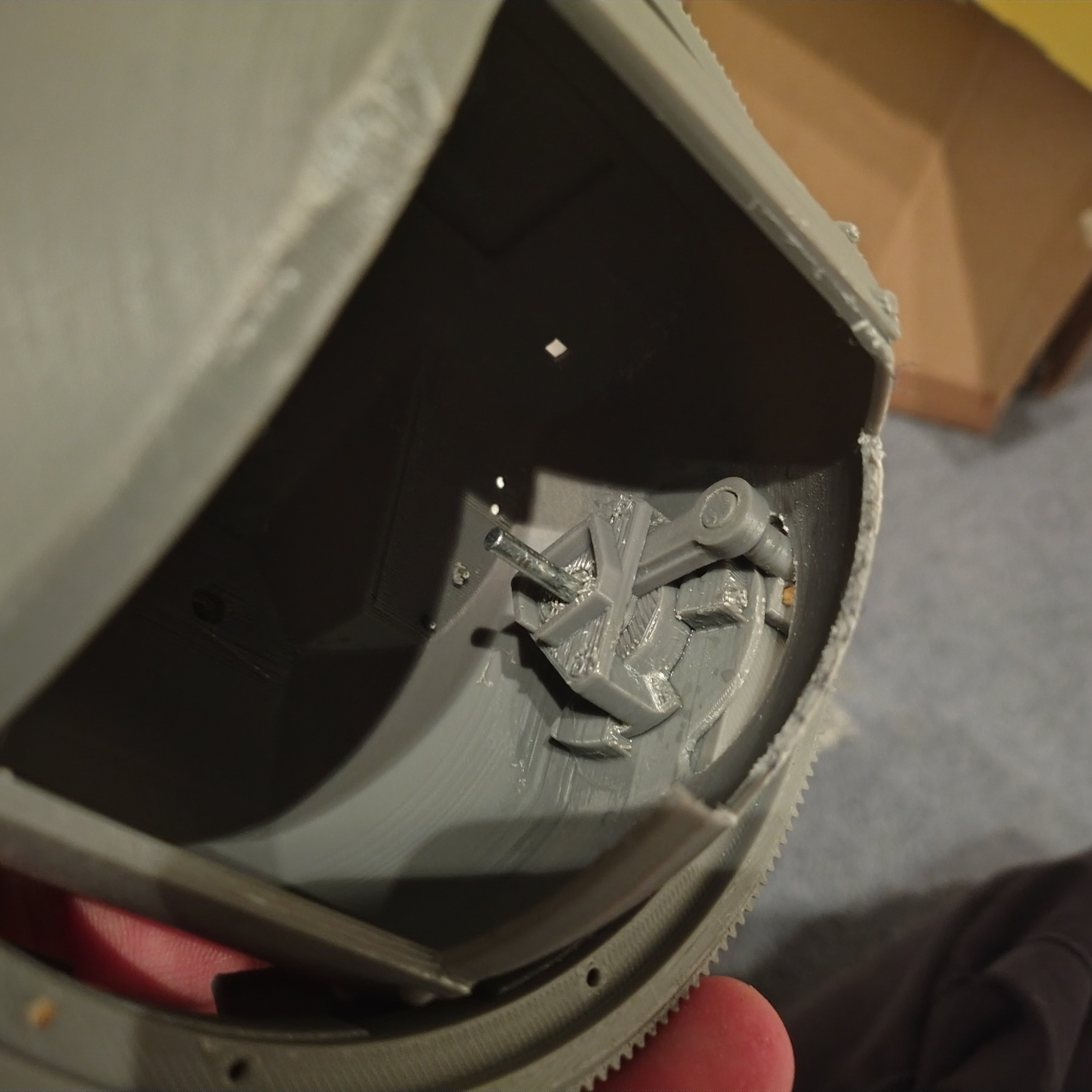

A small but exciting update. I have worked out how to make the old gun elevation gearbox work for the ball turret. The motor mount sits in those 3 twist locks and also holds the bar that connects the motor to the pin that the turret pivots about Used model glue and drilled a hole through the old gearbox and new motor mount. Aswell as drilled out the gear and made openings for a 3MM shaft to go from the last gear to the turrets elevation mechanism And here's the work in progress. Video!! VID_20251227_192507286.mp4 The grinding sound is just the slip gear. Can be seen in the 3rd photo the thicker gear with the spring. -

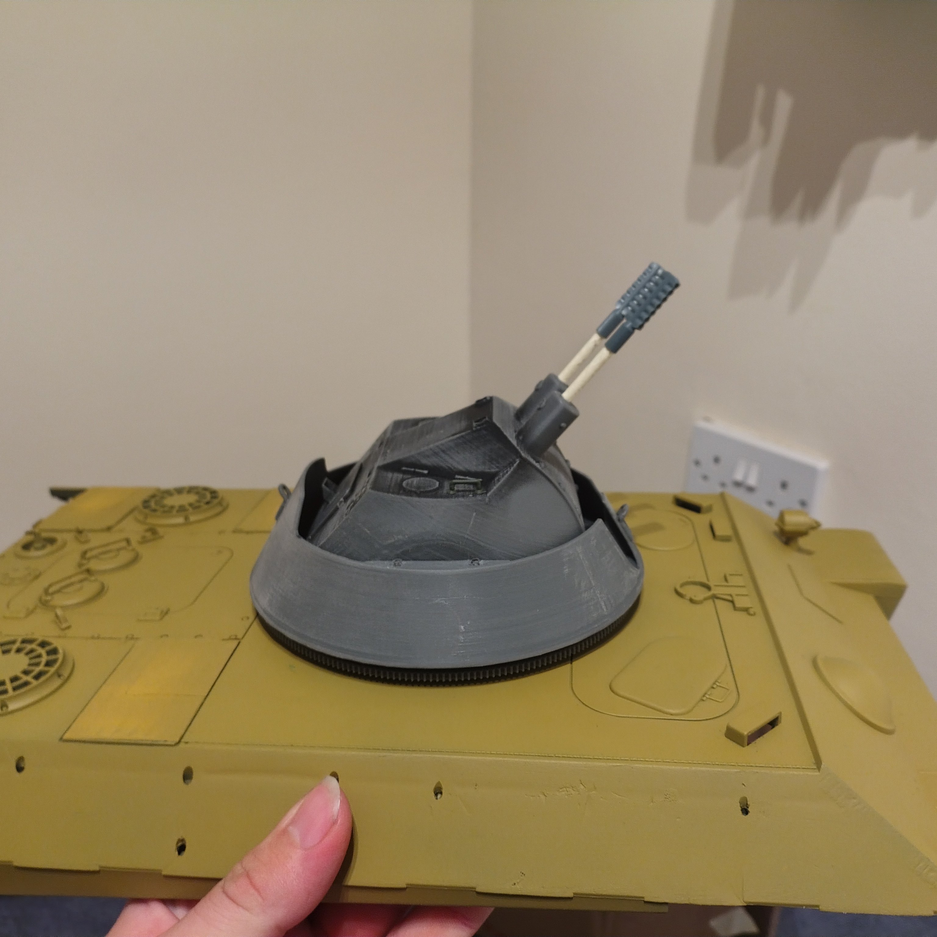

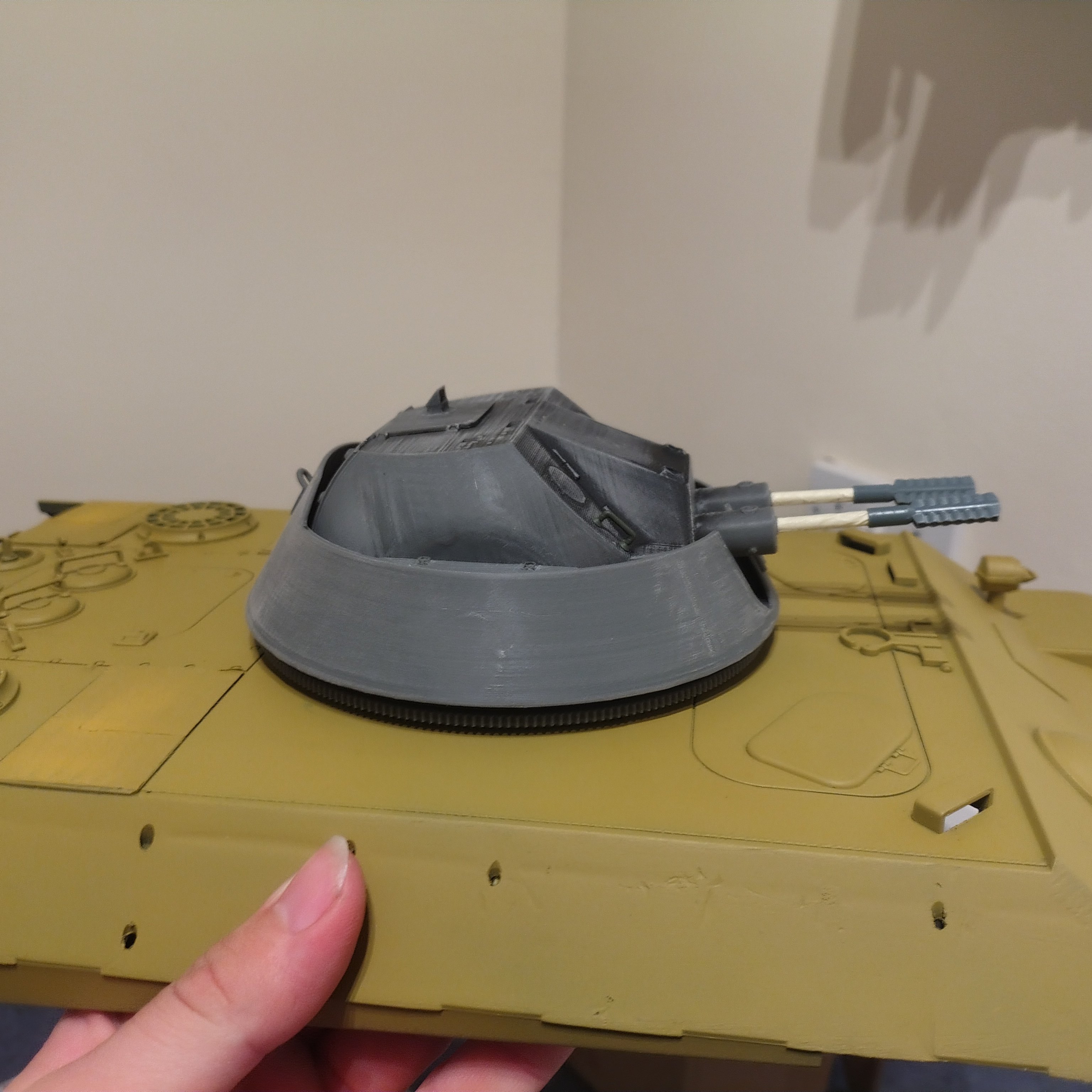

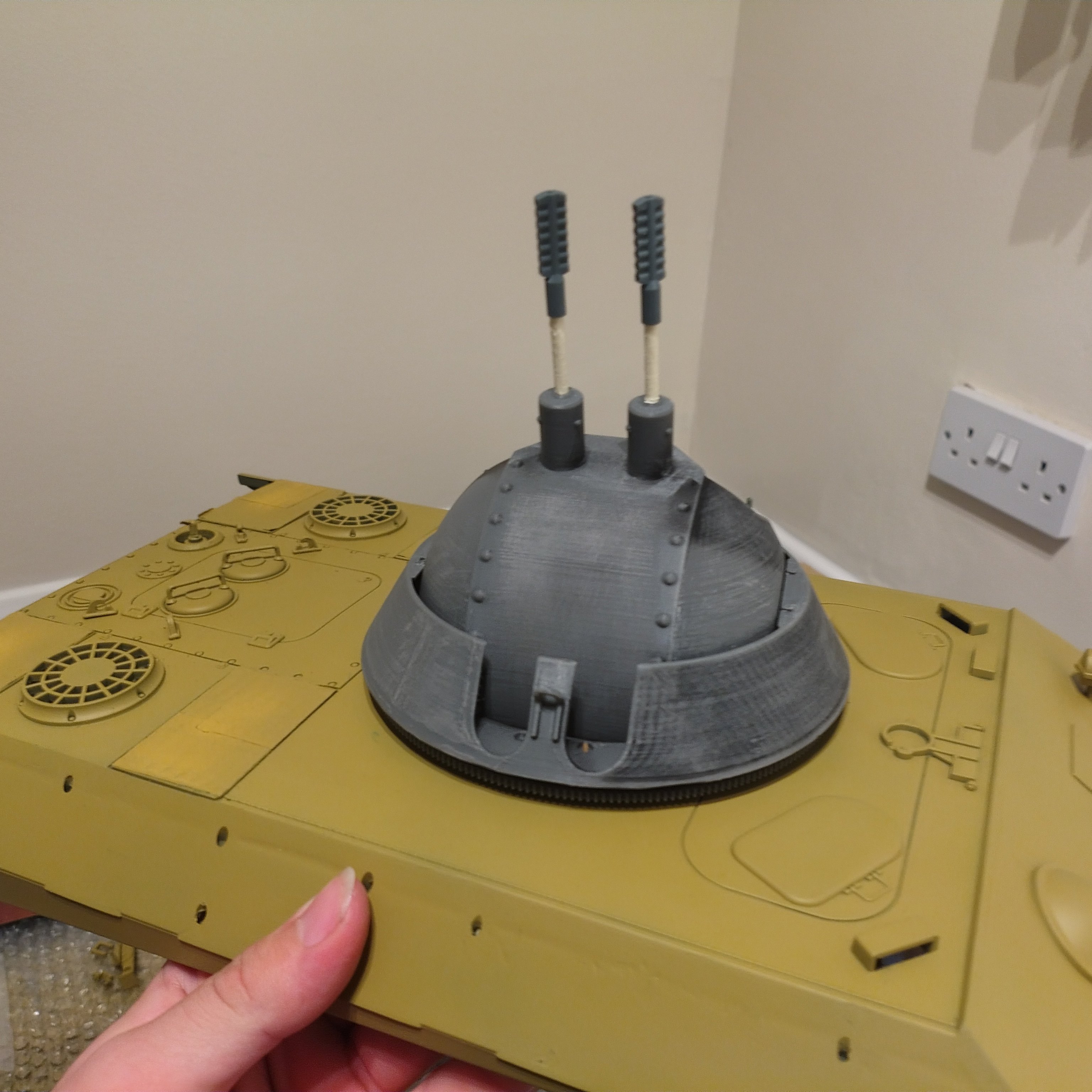

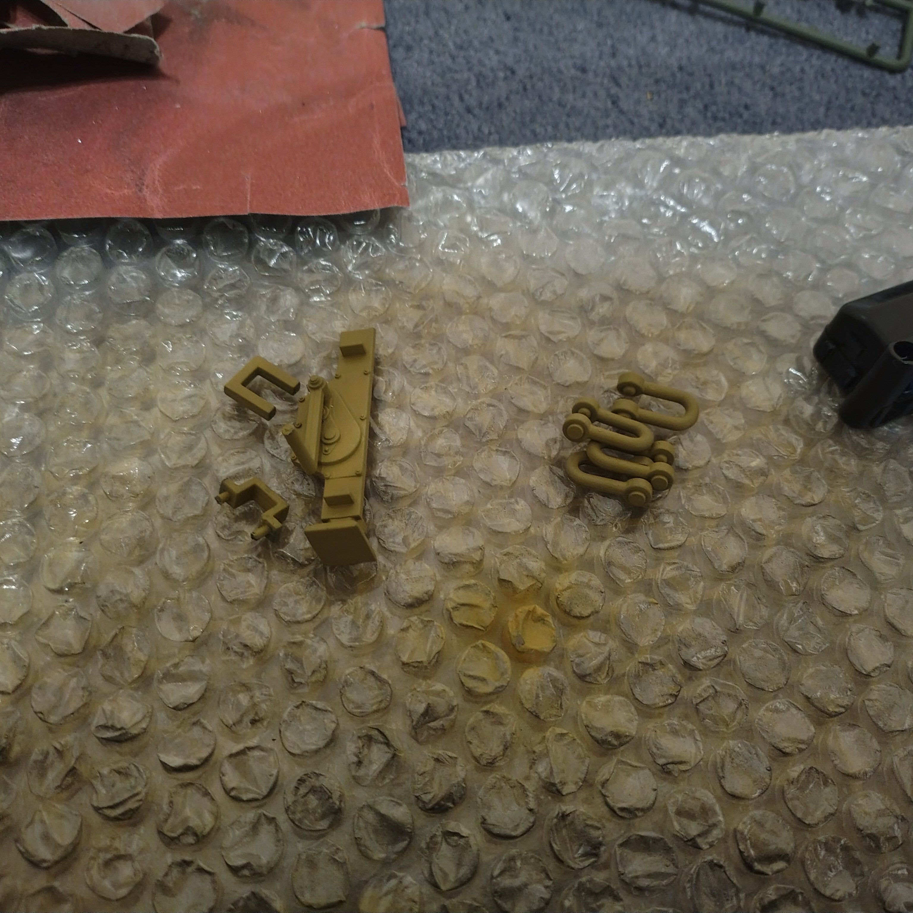

After a busy week I got some time to work on this monstrosity. I have worked out how to modify the existing elevation and depression gearbox to work with the new turret. Still got some bits to do on it but getting there now. The mechanism is deceptively simple. The pin sticks through the side of the turret and connects to the metal bar going through the support that locks into the side of the turret. As with the other side these 2 parts that lock in also provide the pivot point for the central part of the turret. As for the gearbox that's now going to have the metal bar fixed into were the drill bit is on this image and also be assured inside the turret onto the shiny metal shaft you can see in the image above.When all this is in place what should happen is when the motor receives the signal to move one way or another it doesn't actually turn anything instead it moves around the central axis (drill bit in the image and shiny metal bar in the first image) rotating whatever is attached to it. (Hopefully). Also got some added details that have arrived. And now been painted along with some nice little bolts. And lastly. Here's the upper hull shows with the turret sat ontop of it. This won't be how it sits when finished as the rotation gear is also attached under it were as when finished it will be inside the hull. -

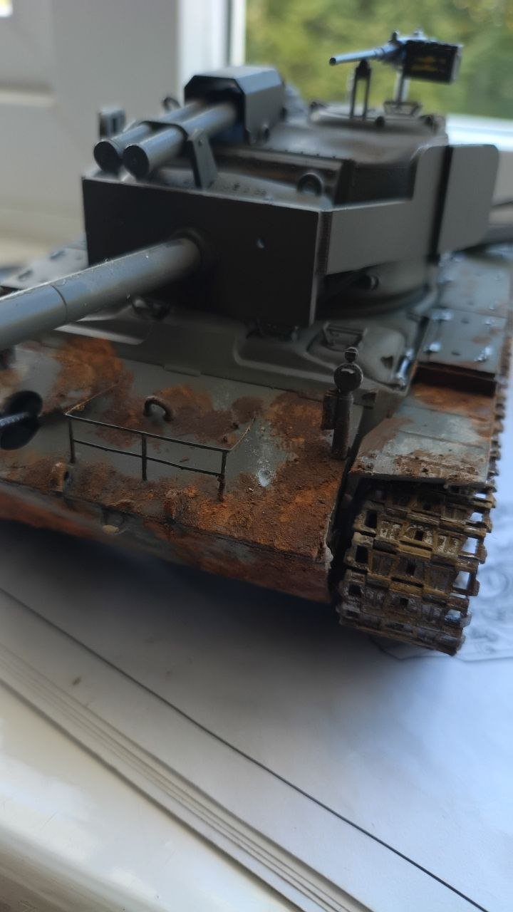

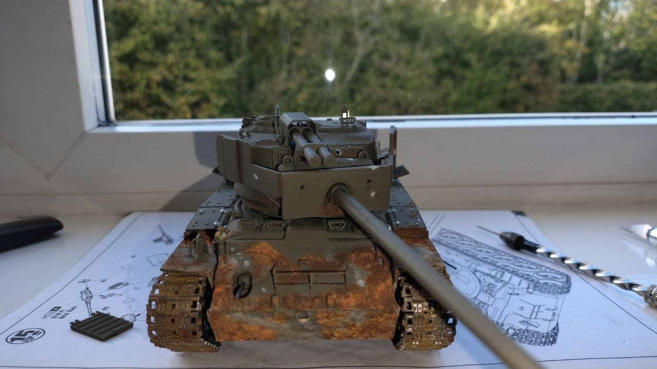

I thought I had updated this model more recently. Will have to try get some more photos of it. Calling it finished now with the weathering and even tried making some shell hits and damage. Unfortunately the weathering looks more like rust than mud with this lighting but still looks pretty interesting. -
