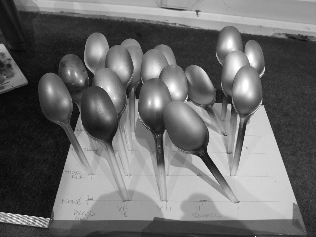

Ok, update to this thread.  I finally had to proceed with this since I needed a flat clear for the flying sub.  Here’s what I did.
Local auto parts store sells “ready to spray” clear lacquer for around $40.00.  Might be ready to spray for automotive use out of a paint gun, but it required about a 1:1 mix with my Mr. Color Leveling thinner to make it through an airbrush. And it could actually go a little thinner than that too.
I bought 30 ML or 1 oz. Bottles off Amazon for about $1.35 each.
Flattening agent was Mr. Color #30
I picked up 4 bottles at around $2.50 each.  Supposedly they come with 10 ML in each bottle, but mine arrived half dried up and apparently others have as well.  I guess these are slow sellers.  A few shots of Leveling thinner got things back to where they needed to be.
I started out slowly with a semi-gloss by adding 2 ML of #30 and topping off the bottle with clear.
Next up, semi-flat clear by adding 5 ML of #30 and topping off the bottle with clear.
Last, for a dead flat I used all 10 ML of #30 and topped off the bottle with clear.
Here’s the results sprayed on some spoons I first painted with a nice bright blue.
If you do the math, it can be quite a savings over buying your clear lacquers from MRP or Mr. Color.
 It was $1.25 per oz. of auto parts store clear which will give you 2+ oz. of sprayable clear once thinned. Mr. Color Leveling thinner works out to about $1 per oz.
So that would be $3.25 for two oz./$1.62 for a thinned oz.
MRP is $7.50 for one ounce thinned.
Mr. Color clear is $2.50 for 10 ML, add in $1 worth of thinner and you’re around $3.50 for an ounce of thinned clear, give or take a few ML.
