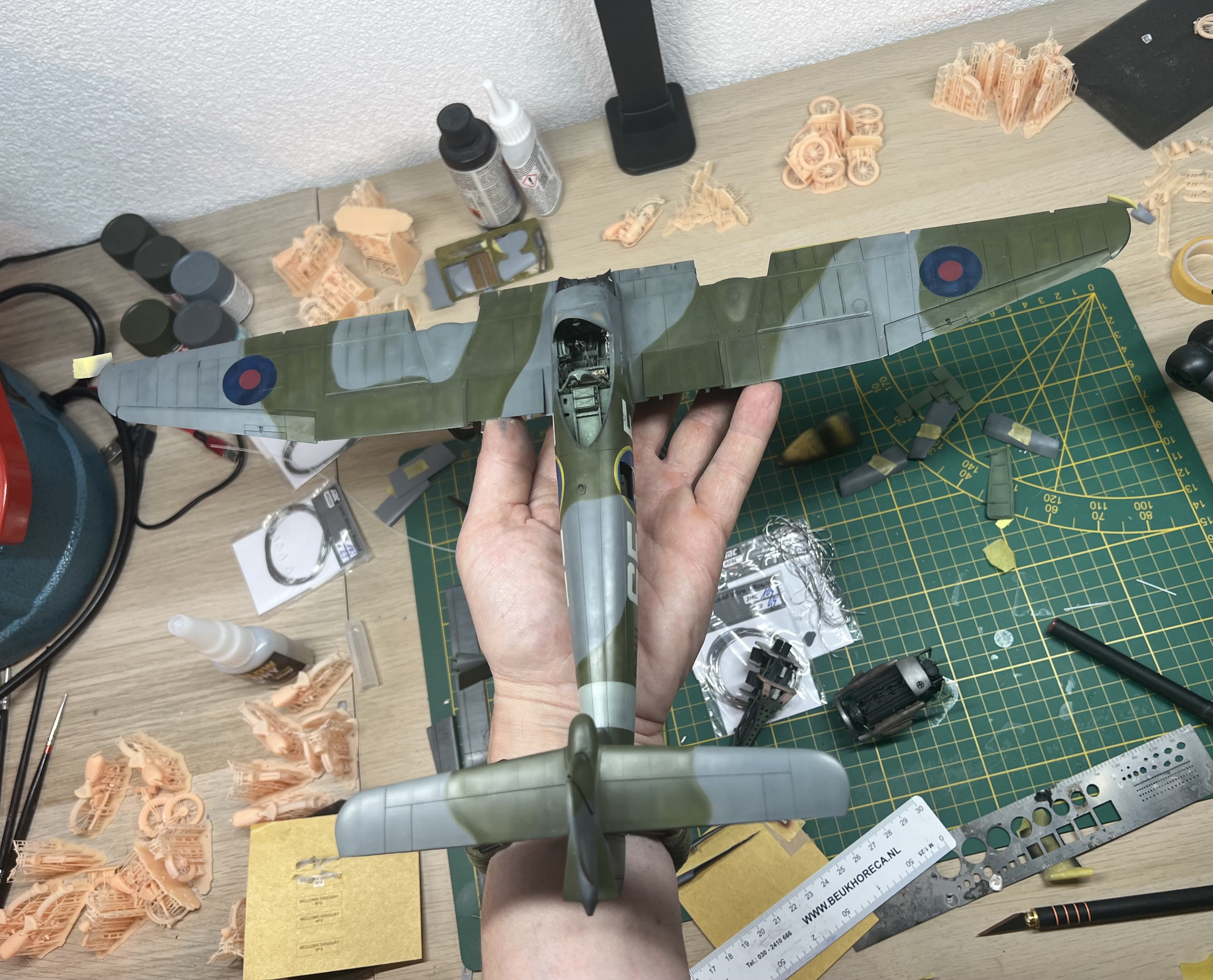

KevinM Posted April 24 Posted April 24 She is looking great Jeroen(always have to go look every time for spelling) 2
Administrators JeroenPeters Posted April 24 Author Administrators Posted April 24 1 hour ago, KevinM said: She is looking great Jeroen(always have to go look every time for spelling) Good man! The oe in dutch sounds like the ou in ‘you’. 4 1

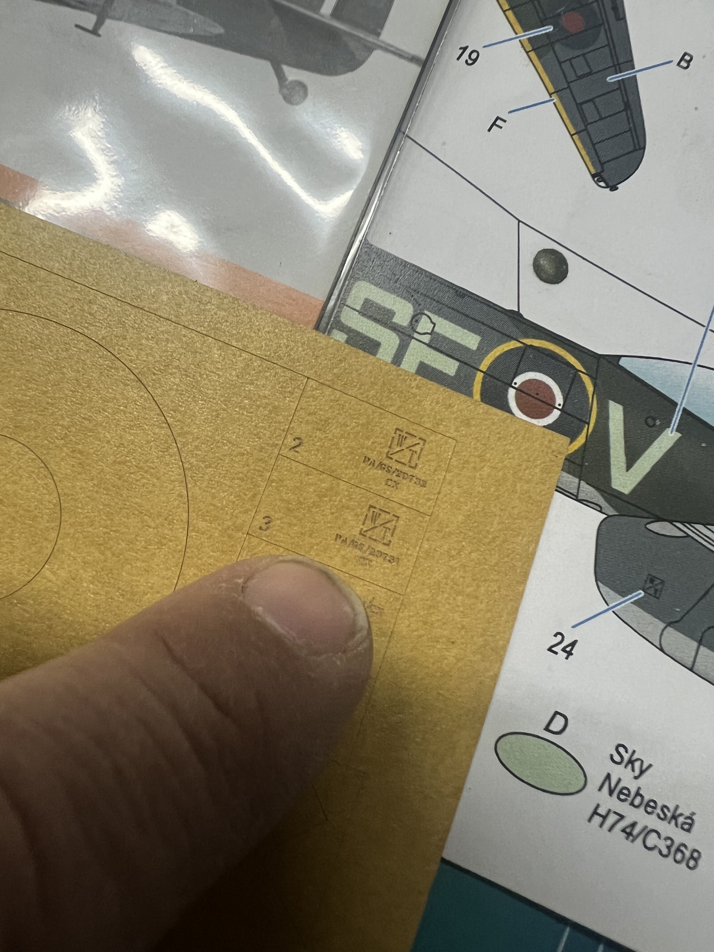

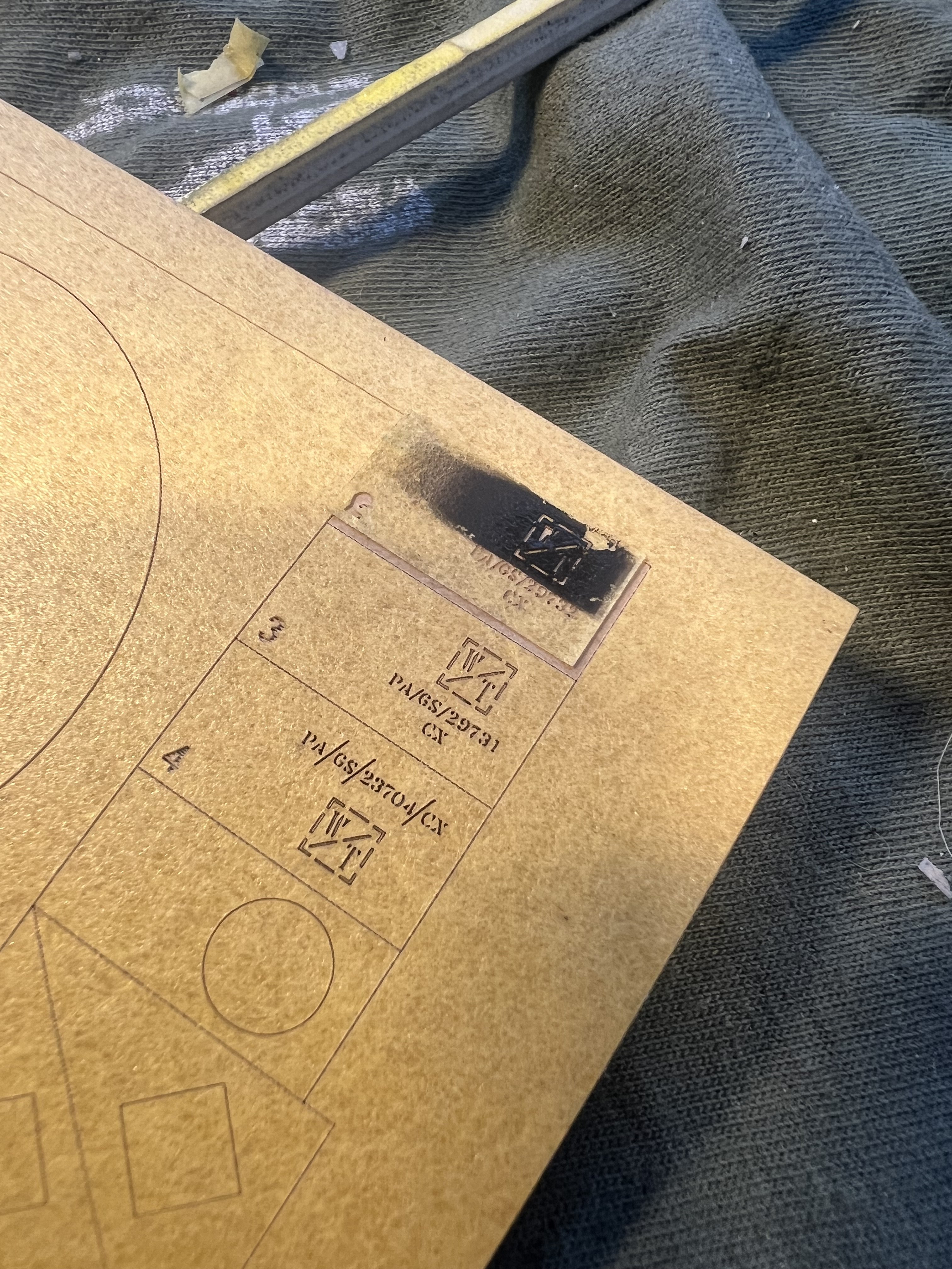

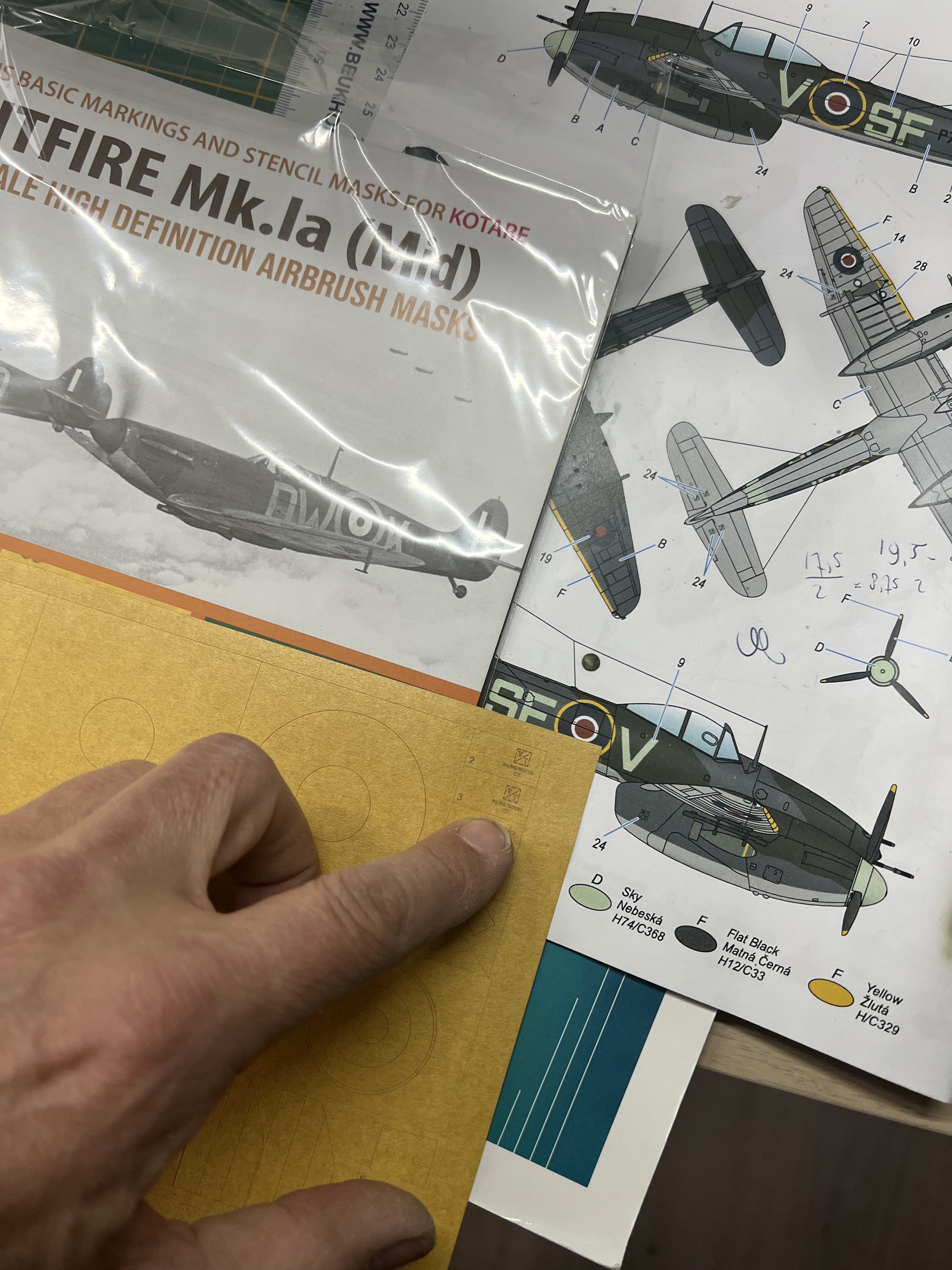

Administrators JeroenPeters Posted April 25 Author Administrators Posted April 25 Here we go again…. The Czech MH models masks for the numerals and codes prove to be uniseful. The inner shapes of the letters P are gone and positioned somewhere else on the vinyl. Looks like an error i sometimes have with my software as well. Anyhow… drew my own (again) and cut my own masks (again). I will not buy MH masks again. 9
Administrators JeroenPeters Posted April 28 Author Administrators Posted April 28 Sprayed the P7111 serial. All masks are cut by myself sofar. MH models did reply to my reaching out. They said the inmer shapes of the letter P was deliberately postioned elsewhere on the masking sheet to prevent shifting of the mask during cutting. I guess that makes sense, but my Cricut has no issues. 9 1

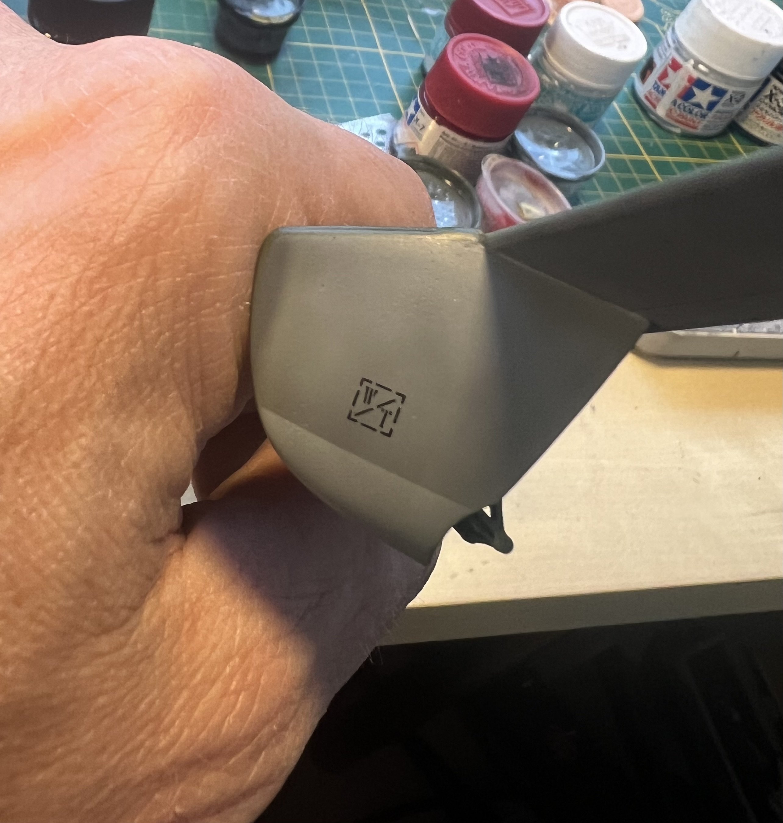

Administrators JeroenPeters Posted May 5 Author Administrators Posted May 5 Yellow leading edges painted and underwing roundels sprayed. Now i need to source a 1manarmy spitfire or hurricane mask set for the W/T stencils. 9

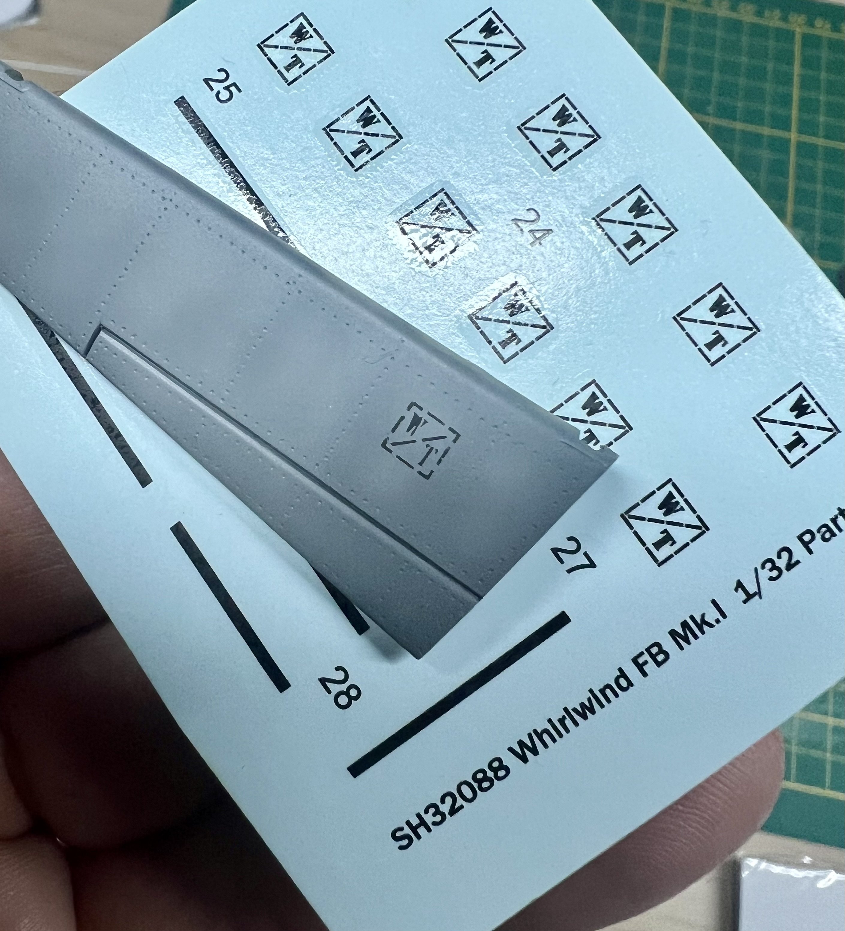

Administrators JeroenPeters Posted May 6 Author Administrators Posted May 6 Might as well go all out! Only needed the W/T mask for 10 decal replacements. Bought the 1manarmy mask set for the Spit mk1 for that purpose. I used one mask 10x and it’s still perfect! 8

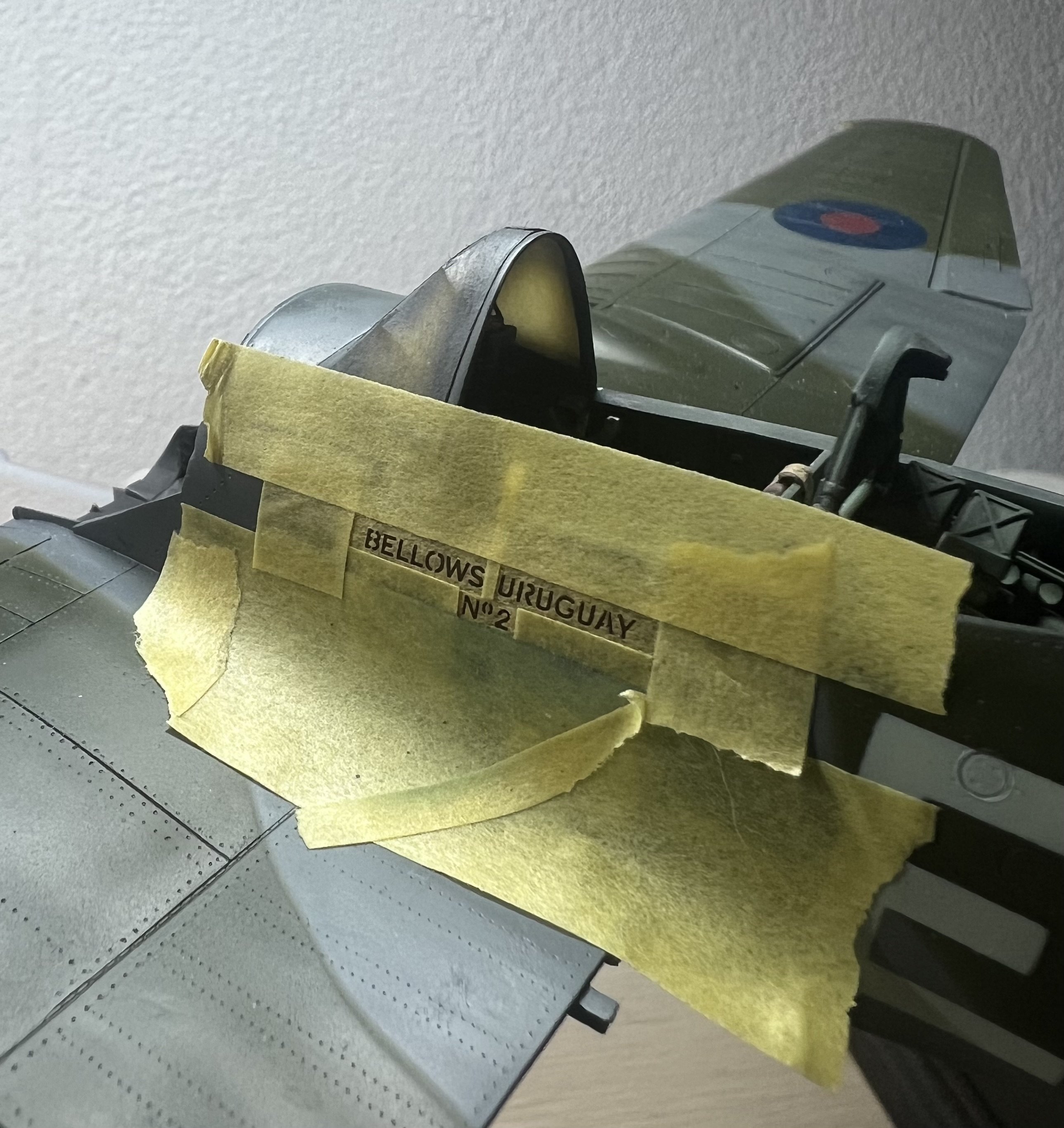

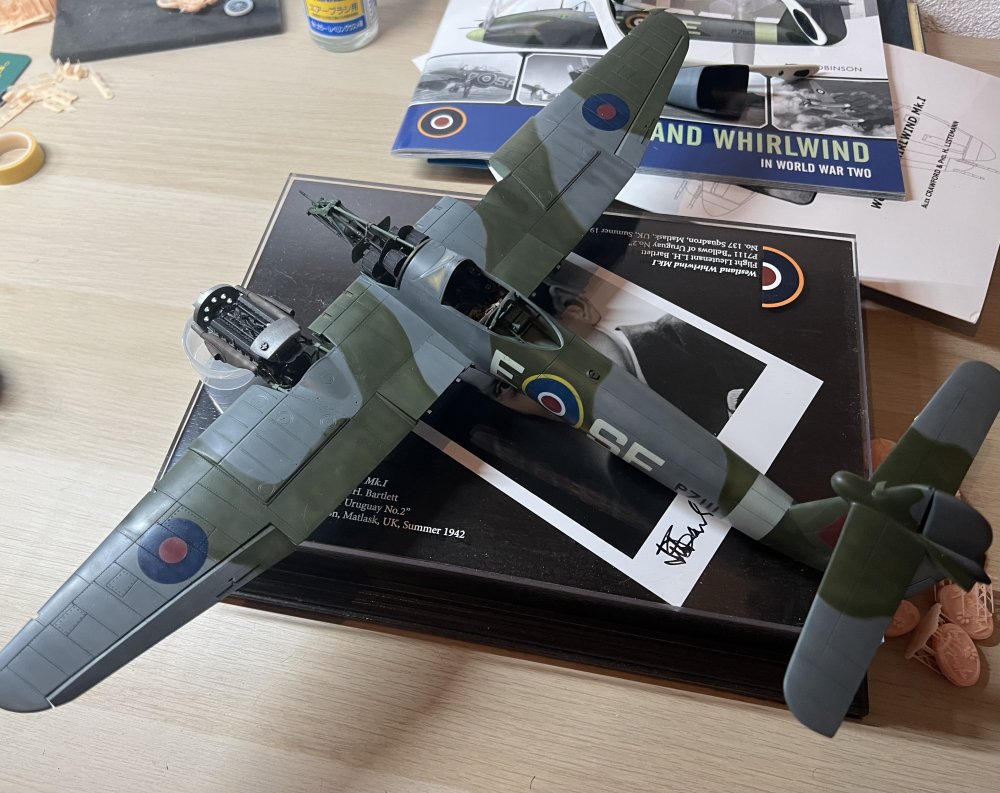

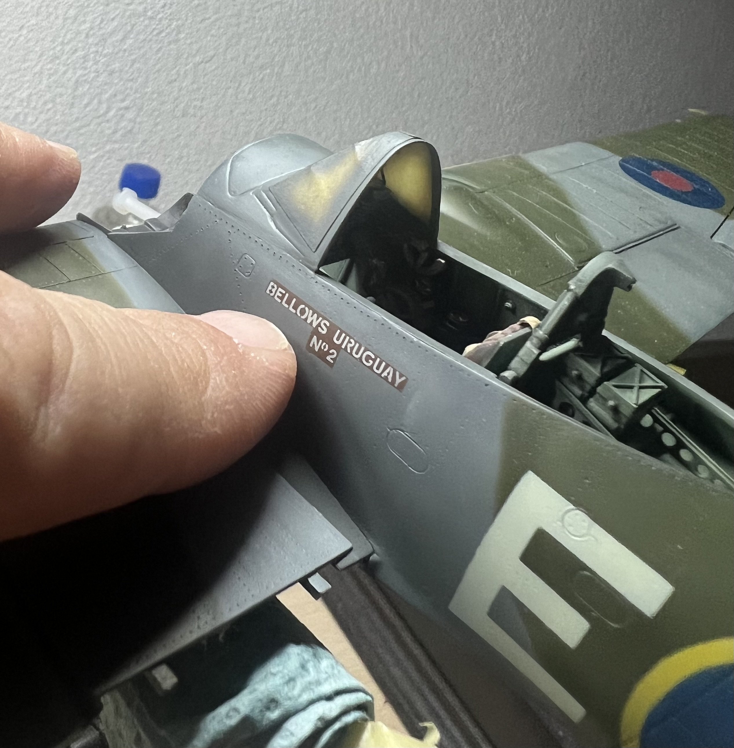

Administrators JeroenPeters Posted May 12 Author Administrators Posted May 12 Somehow the distance between the code and the Bellows Uruguay is way bigger on my model than the reference. At least i fixed the spacing between the two words. I need to get this bird finished or it will end me! 7

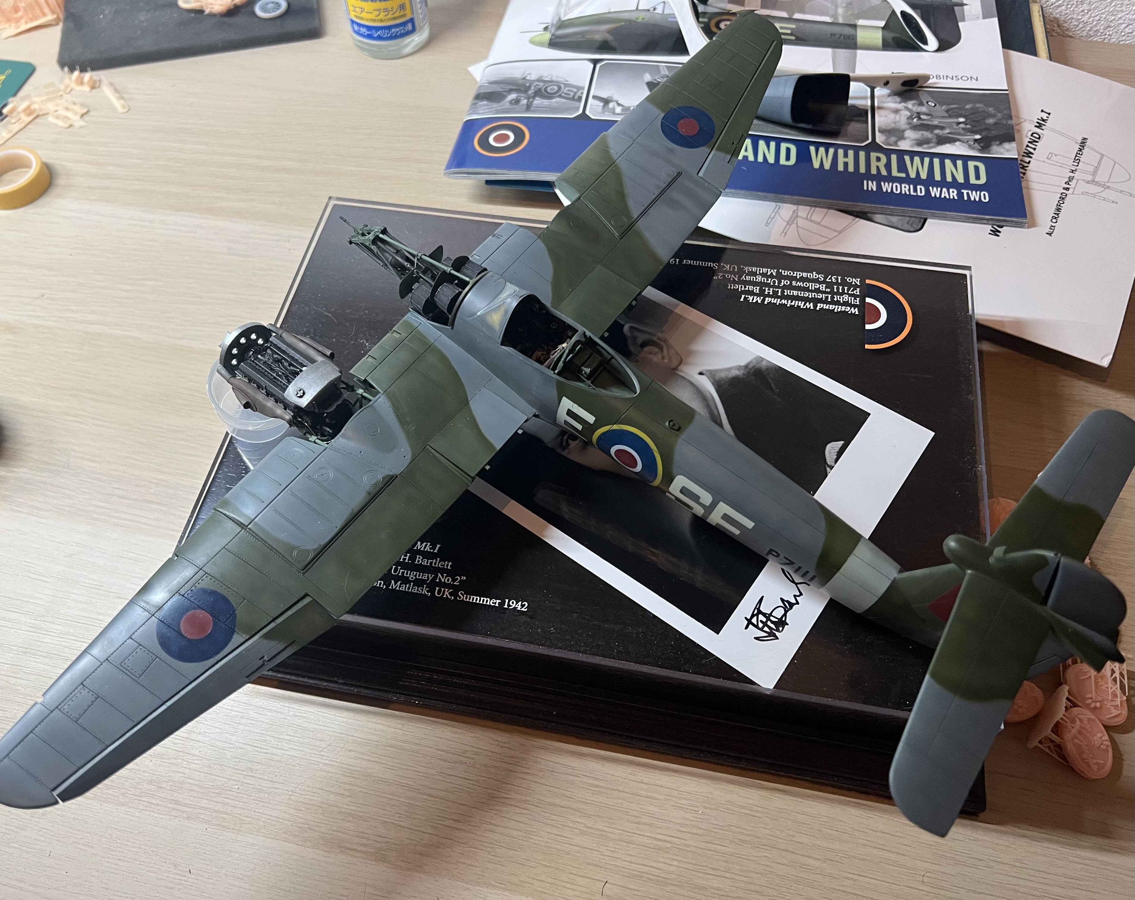

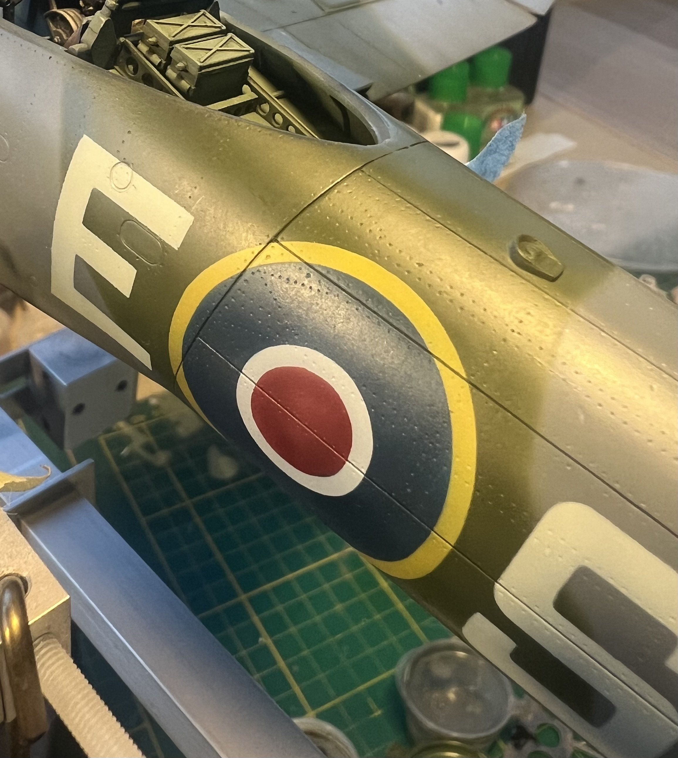

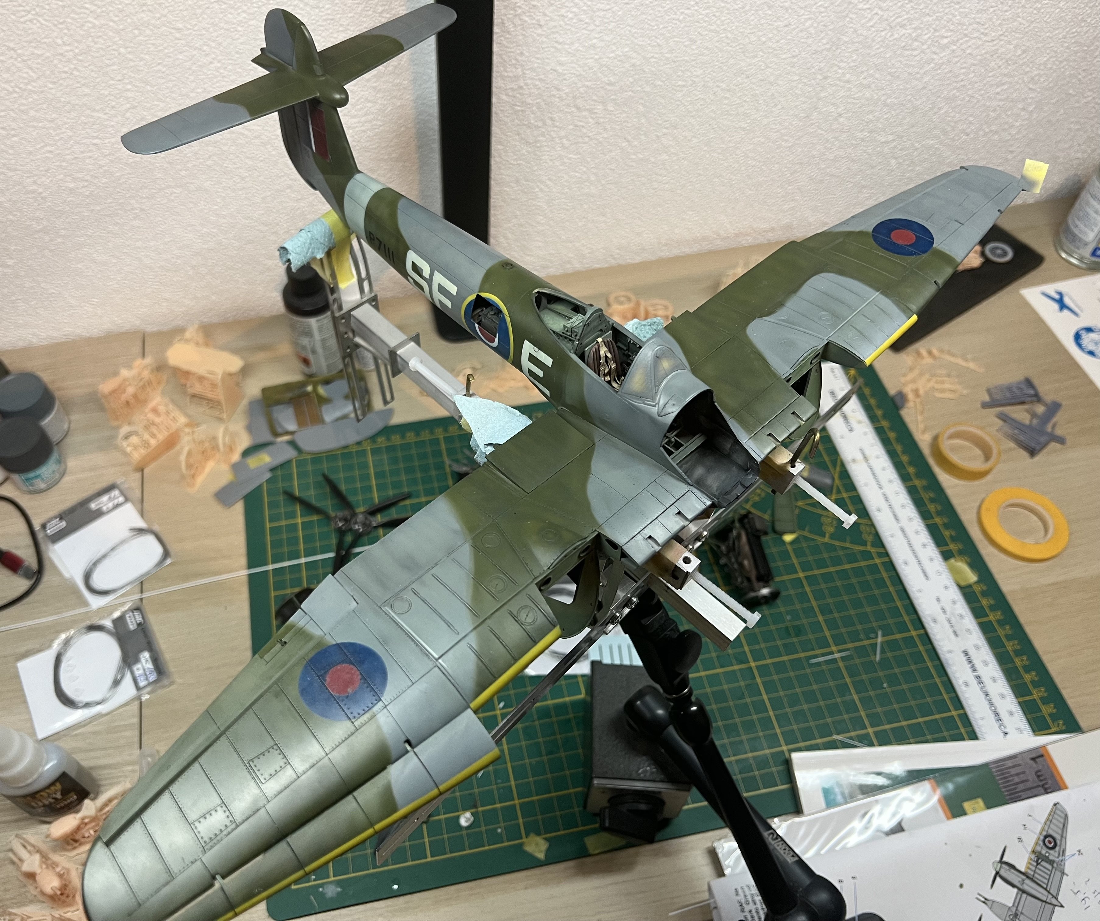

Administrators JeroenPeters Posted May 13 Author Administrators Posted May 13 So. A few people noticed the red upper roundel was too far inboard. I couldn’t live with it so i stripped the wing. Resprayed the camo and reapplied the roundel. Pfff. Let’s weather the heck out of this thing now! 9
Administrators JeroenPeters Posted May 13 Author Administrators Posted May 13 The colours are maybe better in this light. 9

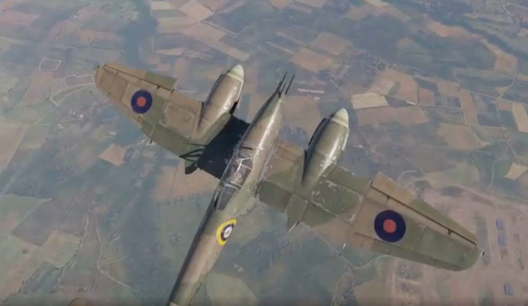

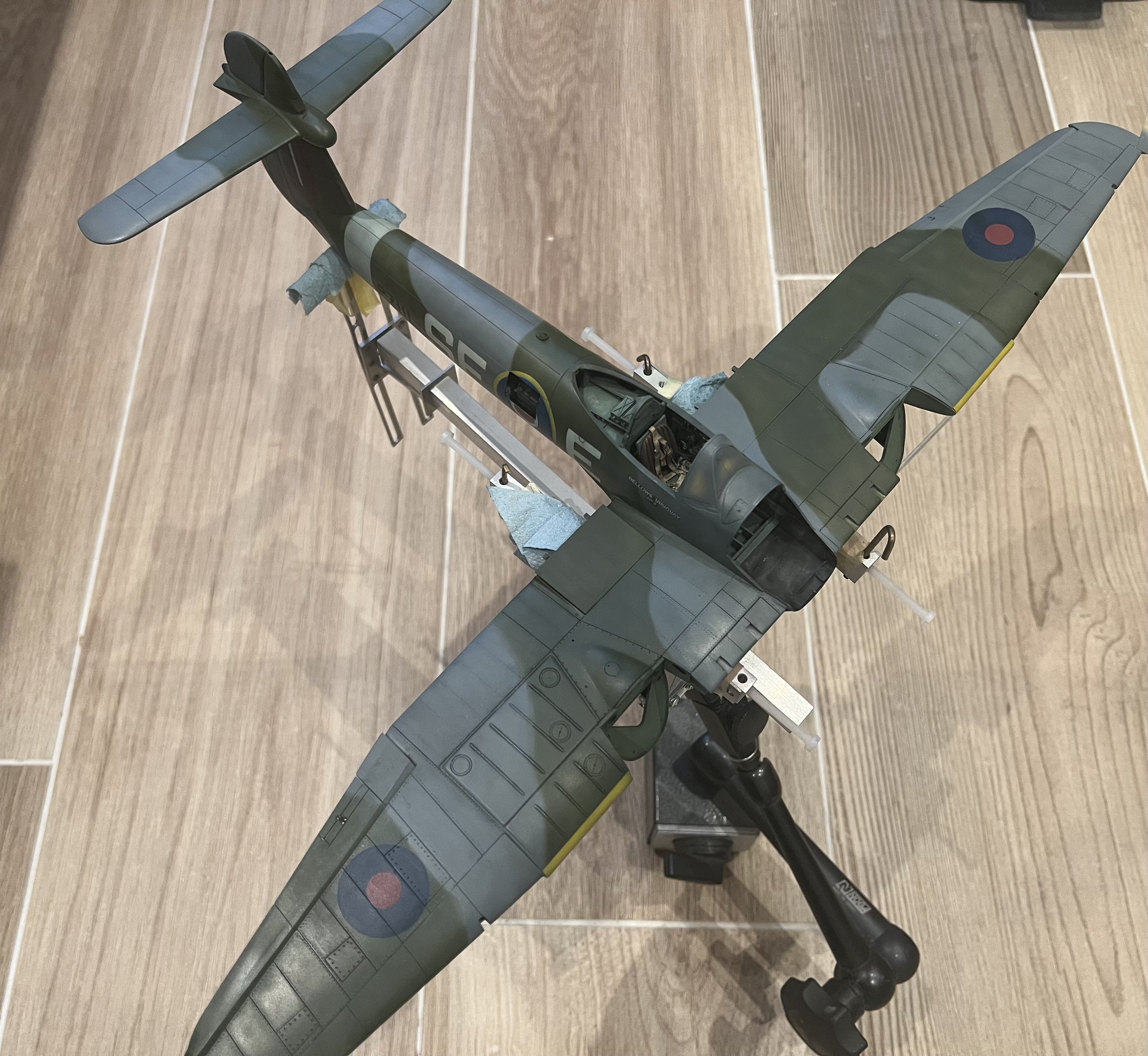

Administrators JeroenPeters Posted May 14 Author Administrators Posted May 14 Another thing I was wrestling was this: How would the colour be like UNDER the extended slats? Would the camo pattern stop there? Impossible to find any photographs. The only thing I have to go by is this in game footage of the Warthunder game. You can see the green of the camo stopping there. I will change this on my model. 6
Count0 Posted May 15 Posted May 15 On 5/14/2025 at 2:10 AM, JeroenPeters said: Warthunder game I wouldn't trust that game as a reference for a moment. 3
Administrators JeroenPeters Posted May 15 Author Administrators Posted May 15 2 hours ago, Count0 said: I wouldn't trust that game as a reference for a moment. I understand. But if reference is lacking you have to use common sense. This makes sense. 6
KevinM Posted May 15 Posted May 15 8 hours ago, JeroenPeters said: I understand. But if reference is lacking you have to use common sense. This makes sense. I concur looks more reasonable than my first thought of a primer of some type. 2
Count0 Posted May 16 Posted May 16 4 hours ago, KevinM said: primer of some type Primer is possible. I guess it depends on how the slats work, powered or gravity. I always wonder about this. After listening to the Tank Museum chats about the qualitative shortcoming of (some) British tanks seems like they would have done whatever was easiest. 1

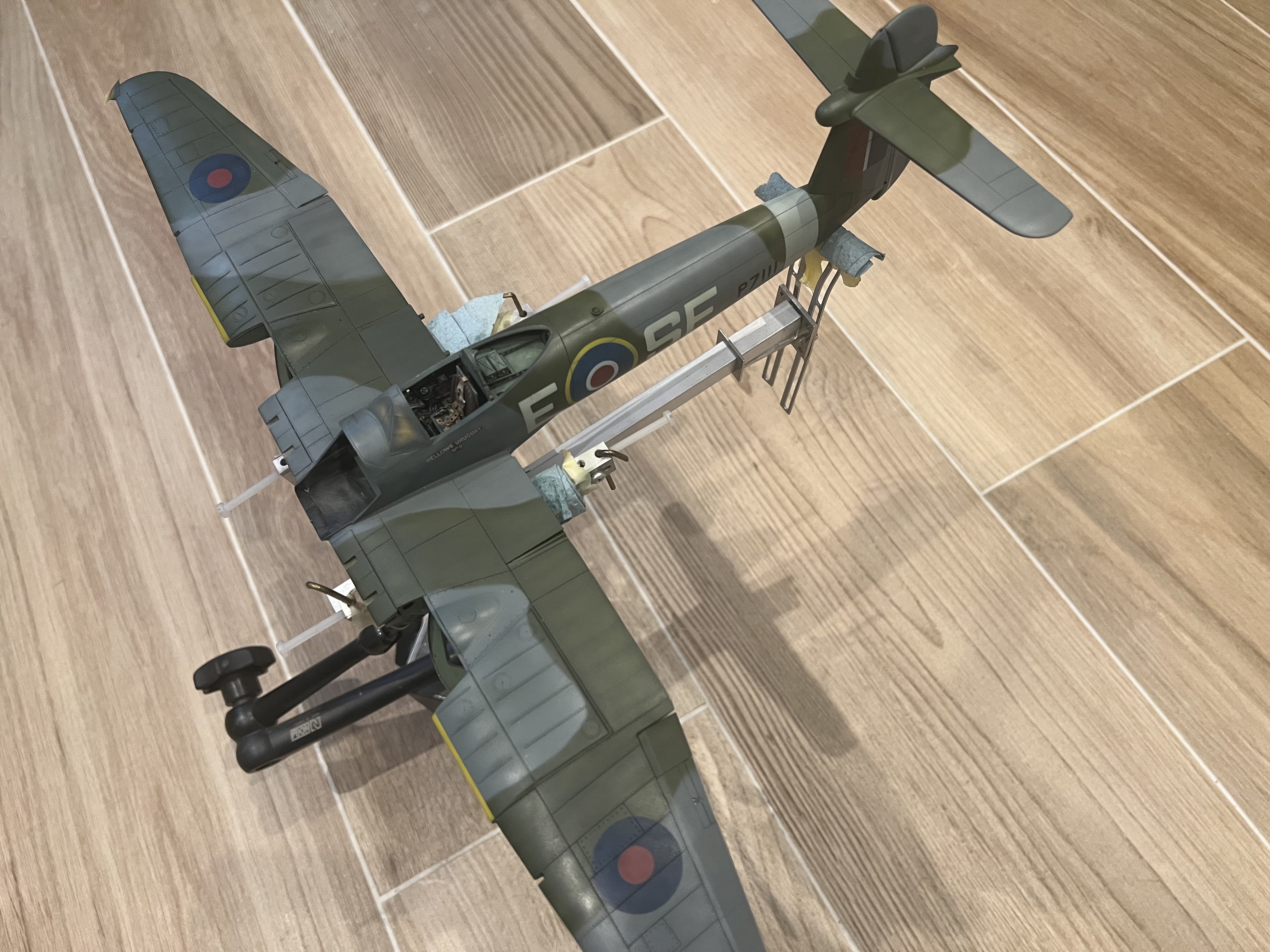

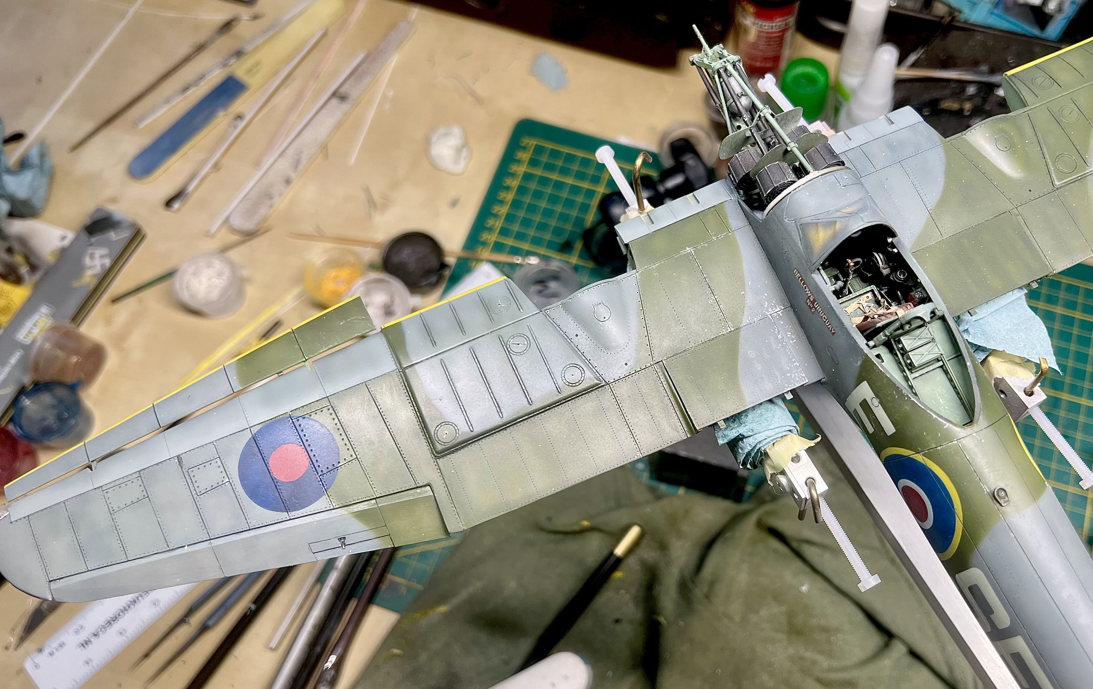

Administrators JeroenPeters Posted May 20 Author Administrators Posted May 20 Flaps are on. The can be positioned in any angle. Pretty cool. washes almost done. Then it’s time for a flat coat. 8 1

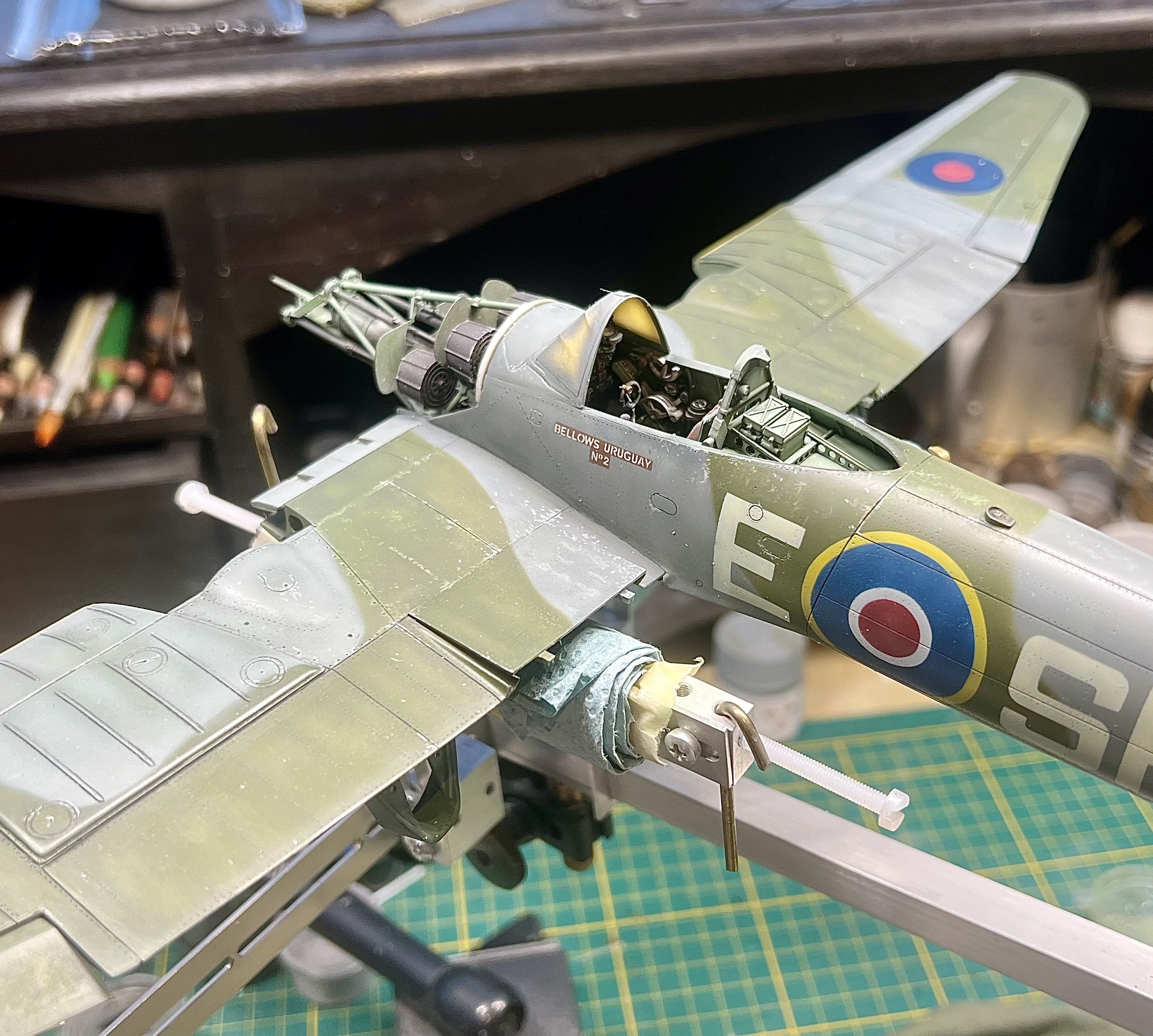

Administrators JeroenPeters Posted May 26 Author Administrators Posted May 26 The Matt coat is on and started with the AK weathering pencils. Dryfitting the nose guns, which need some alteration to sit in the proper angle. some warpage on the still to be installed barrel ends, but some boiling water will solve that. 7
KevinM Posted May 28 Posted May 28 On 5/26/2025 at 2:47 PM, JeroenPeters said: The Matt coat is on and started with the AK weathering pencils. Dryfitting the nose guns, which need some alteration to sit in the proper angle. some warpage on the still to be installed barrel ends, but some boiling water will solve that. That looks like alot of wingspan there Jeroen 2 1

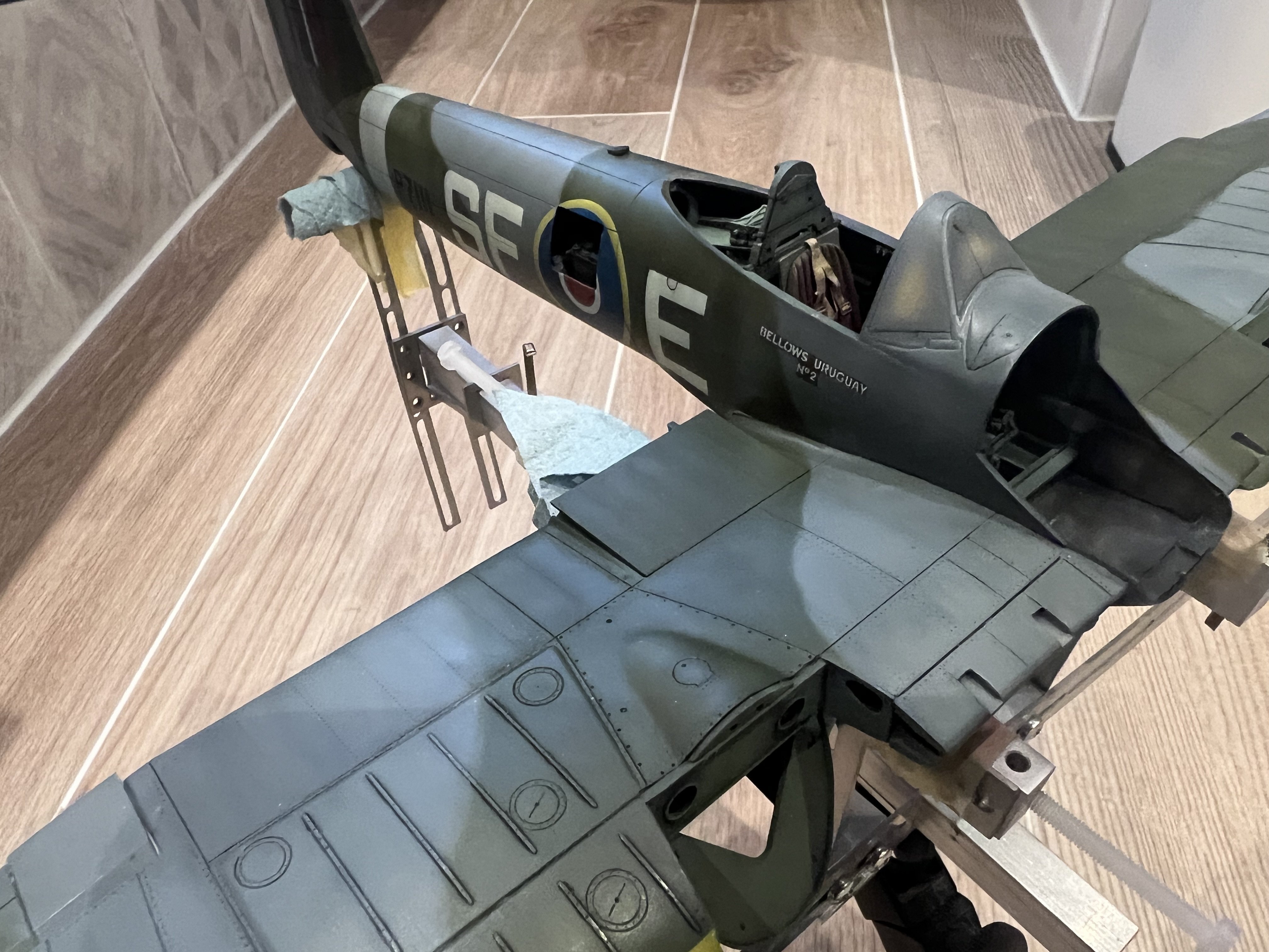

Administrators JeroenPeters Posted yesterday at 07:30 PM Author Administrators Posted yesterday at 07:30 PM Back from a short holiday and returned to the bench. Matt coat is on and started adding scratches and blotches. This will take a while. Also added a lighter ocean grey under the slats. 5
