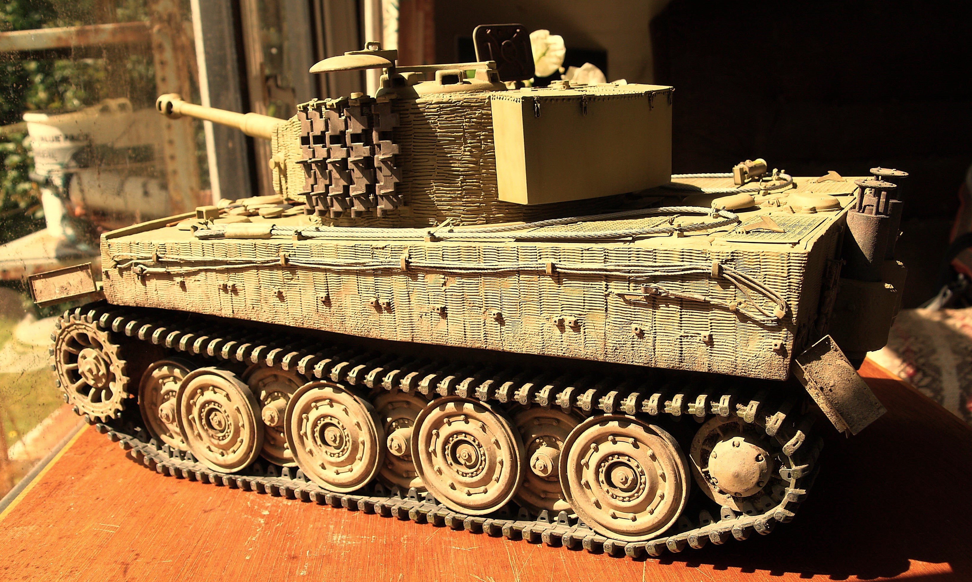

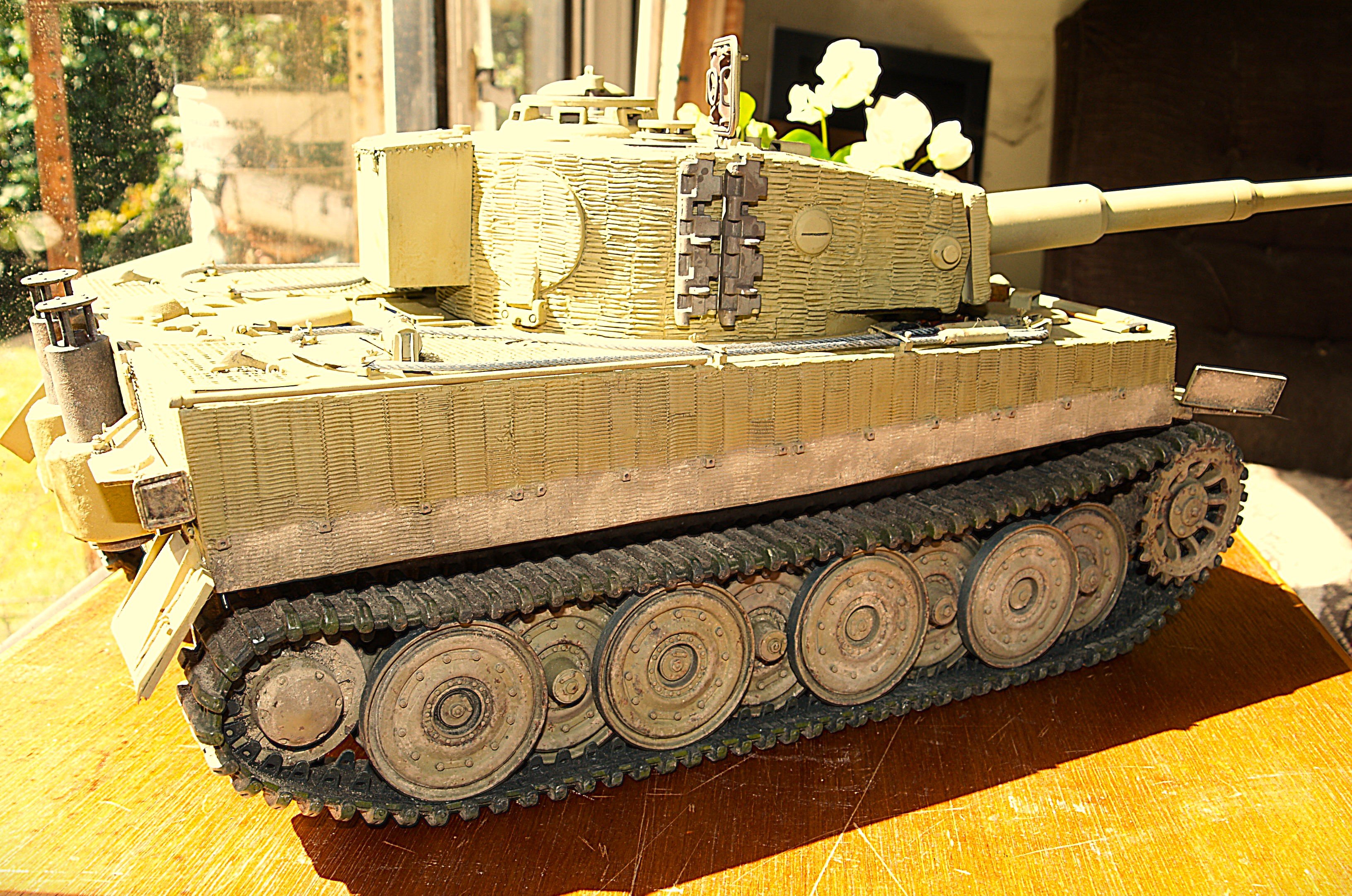

- I am finally staggering to to finishing line with my 1/16 rc  pz VI . So here are some kitty pics 👉
16 hours ago, BlrwestSiR said:
Looks great, especially the zimmerit. What kit is it? Heng Long?
Originally yes , but all that remains of it is the upper hul , even that has been reworked .
With a chequered ancestry she is a real 'Moggy'
Lower hull - Asiatam *

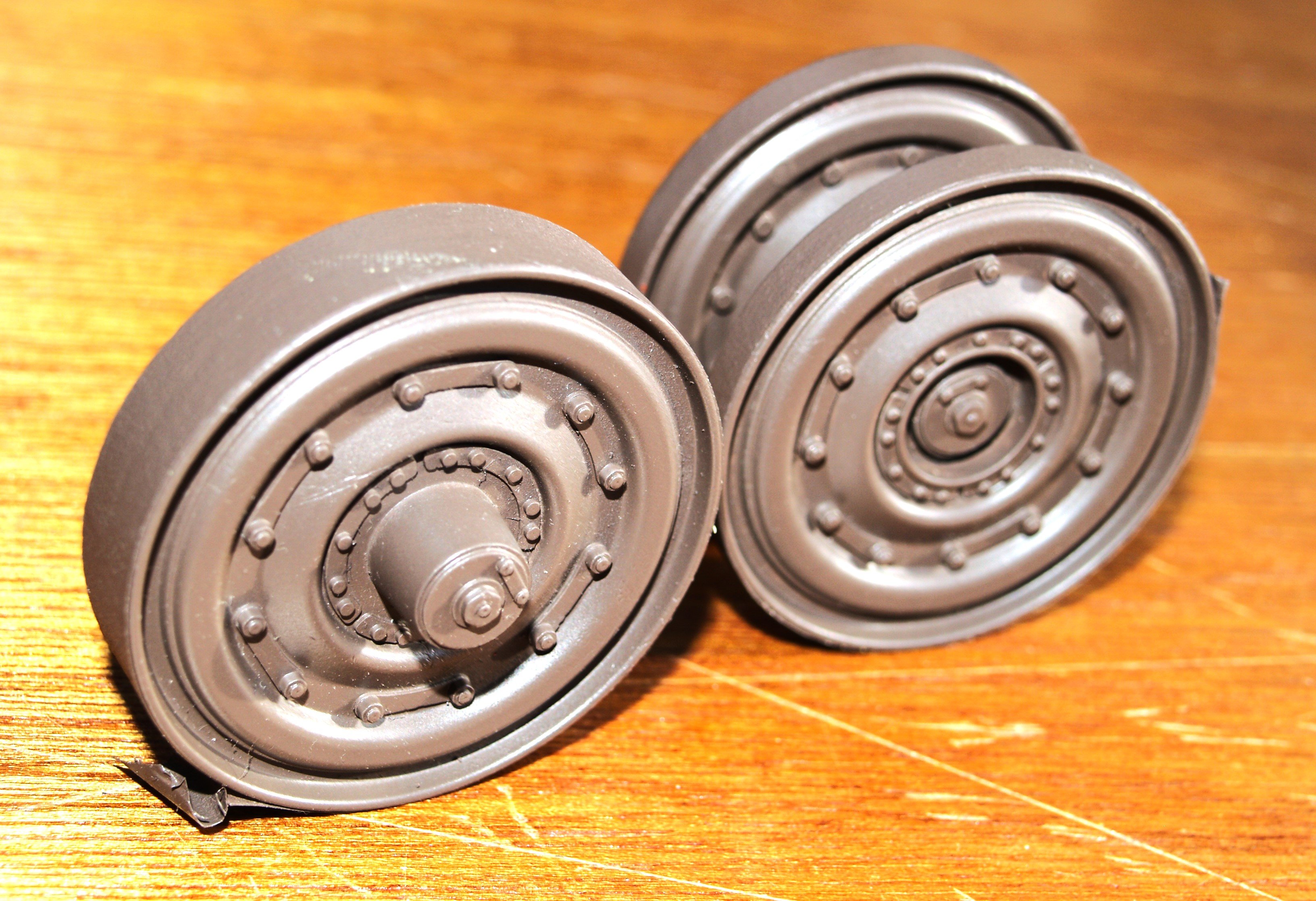

Late wheels etc. - Torro
i/r - recoil Turret - Taigen
Transport tracks - fleabay , (possibly Asiatam)
Spare turret track - Impact late type , on Schumo hangers.
Voyager etch brass ( Aber is insanely fiddly and overcomplicated , I do have a life y'know )
Other stuff source from dealers on the interwebs .
Plus the usual scratch built stuff , styrene , resin etc.
the list goes on and on .
All stuck together with lots of Anglo Saxon and liquid therapy .
* I started this build back in 2011  🥴

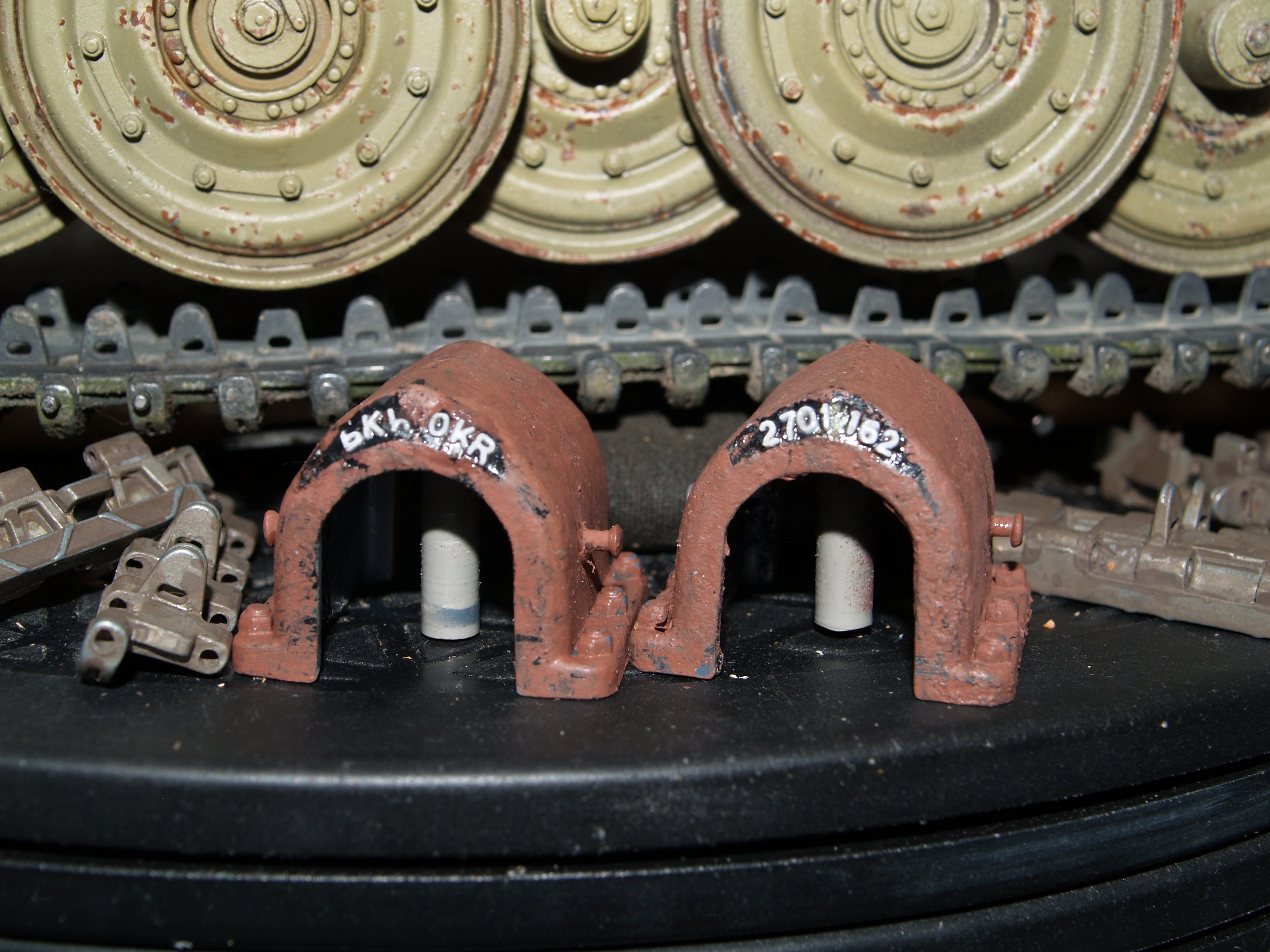

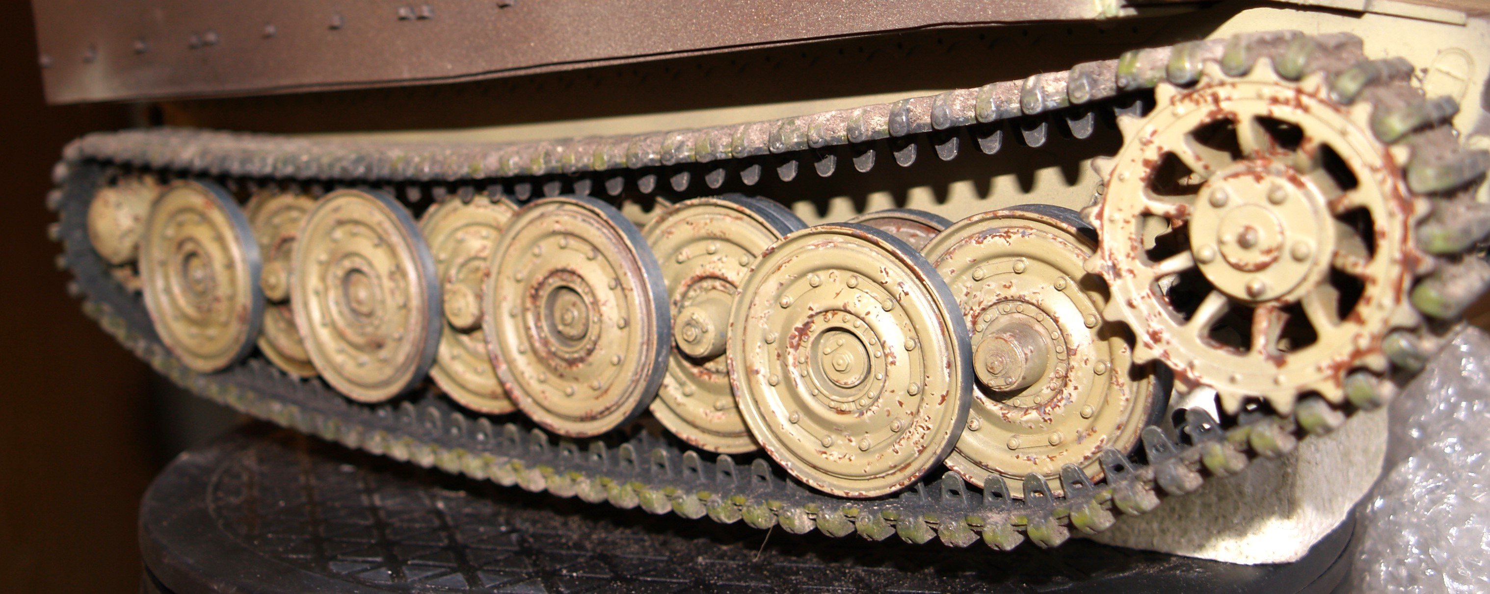

Some archive pic's of the carnage . . .

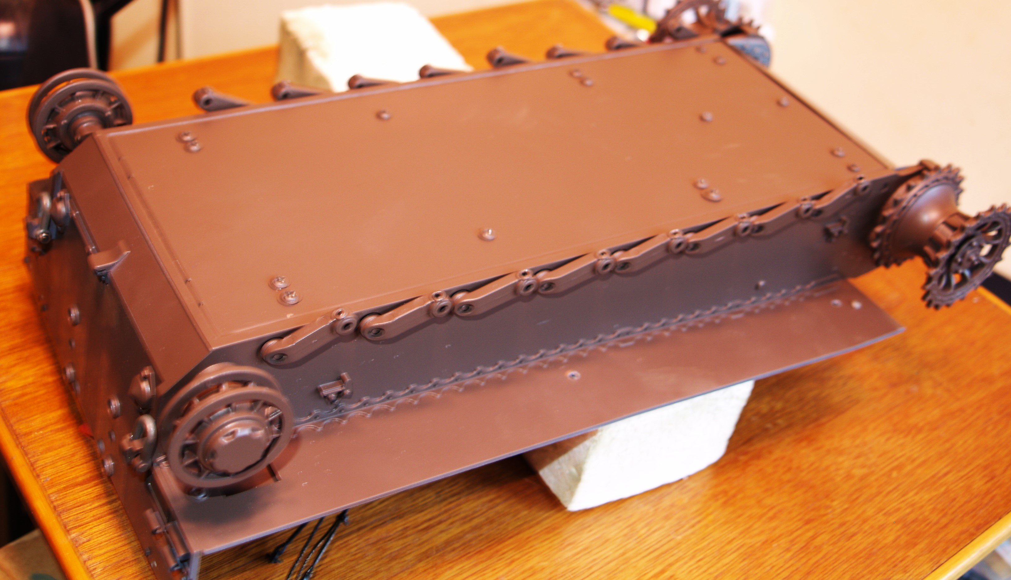

 Basic paint , I find red oxide too 'harsh' so use a chocolate brown over black primer . Sorry about the pic quality.

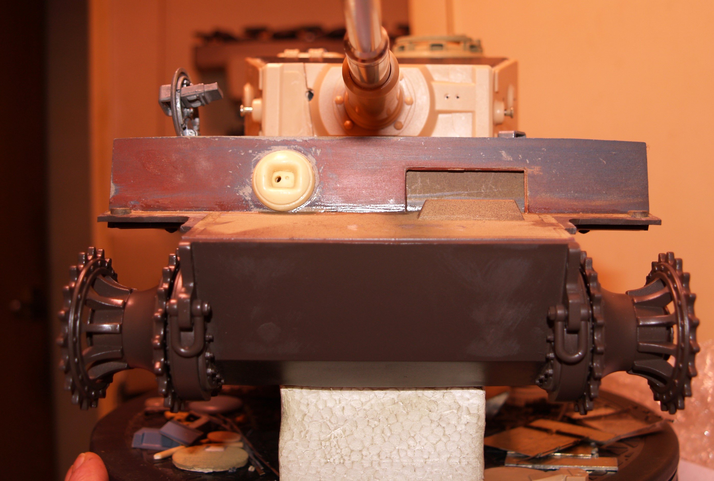

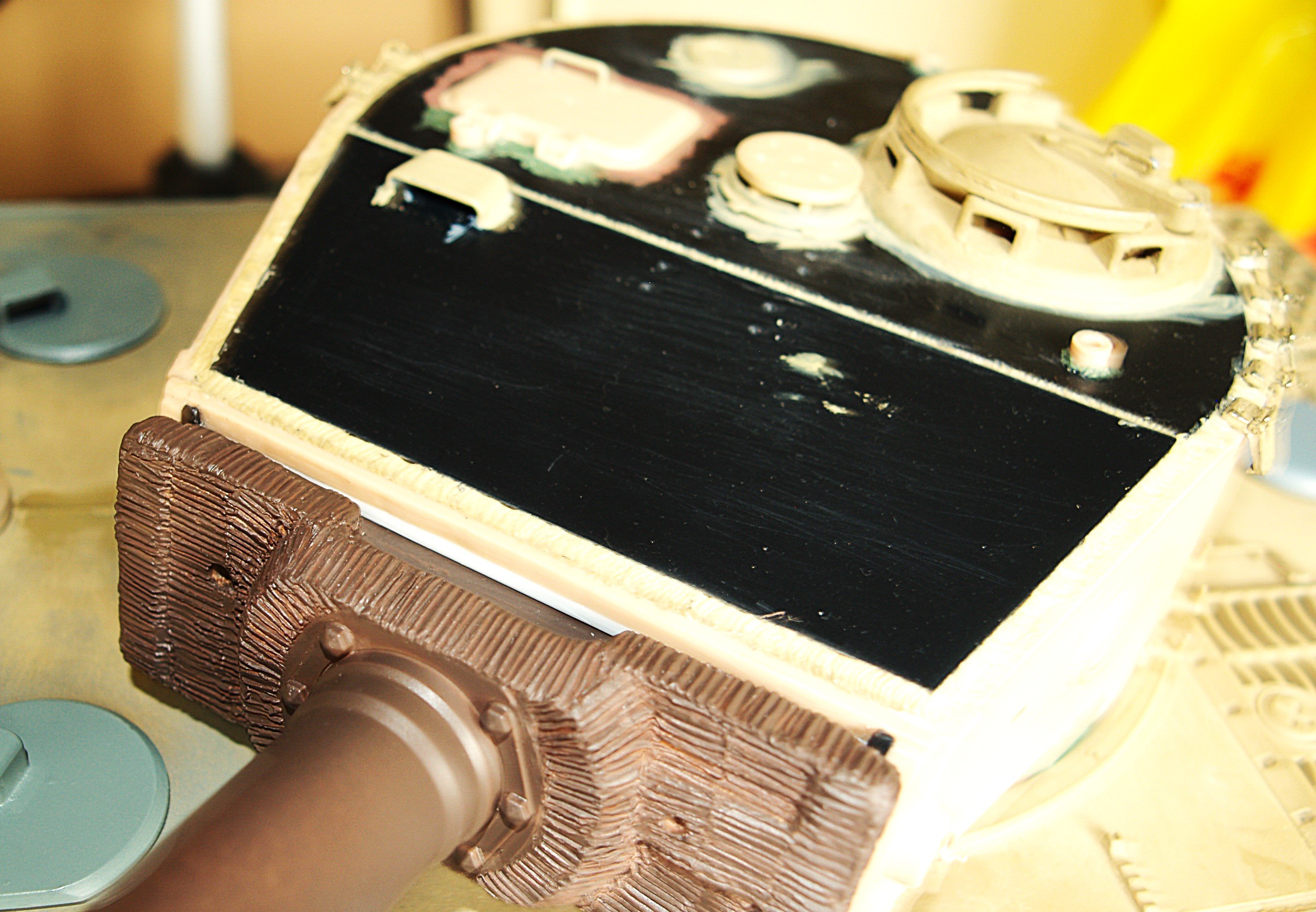

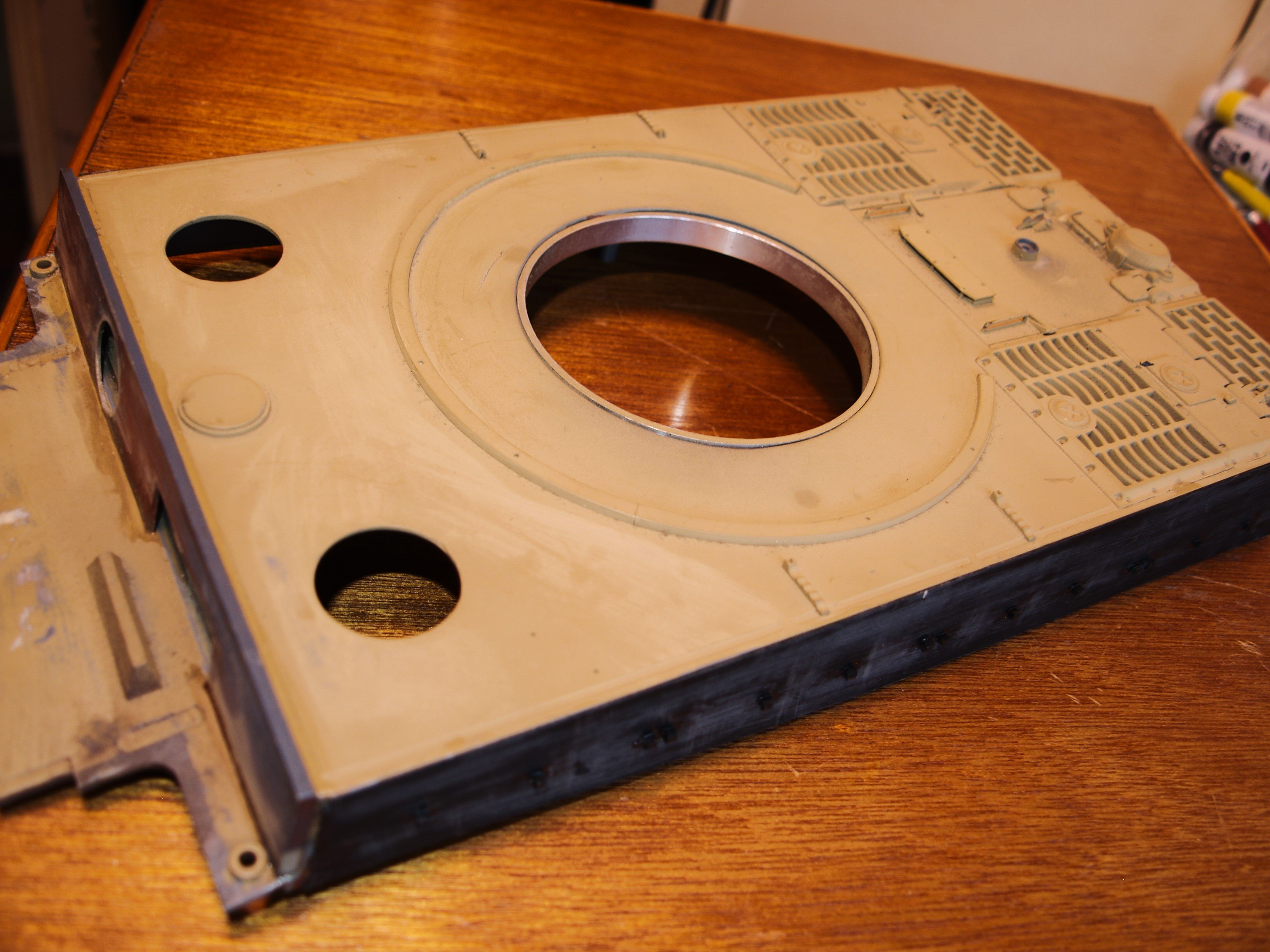

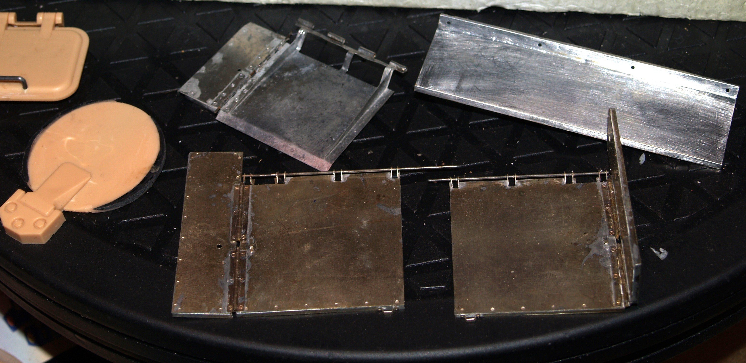

Hull surgery - removal of side skirts , correctly centred turret ring and bits.
Turret work includes reprofiling the horseshoe shape , narrowing the mantlet (single optic type), adding the '40mm' roof , late cupola , new hatch hinges , gunners visor , anti personnel mine launcher , ventilator and track hangers, and while I was at it , lowered the vision slits on the sides . . .

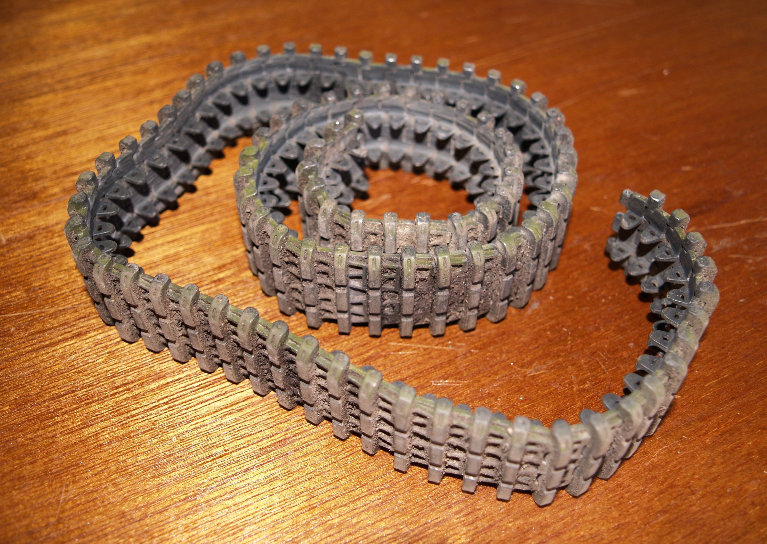

 = and mucky tracks , Yay!

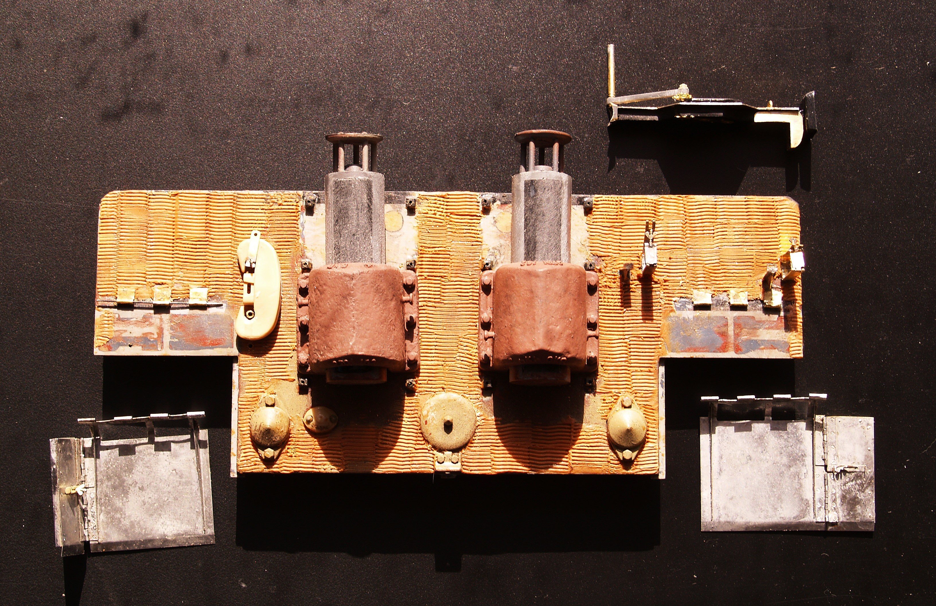

New rear panel layout details.
Lots more . . .

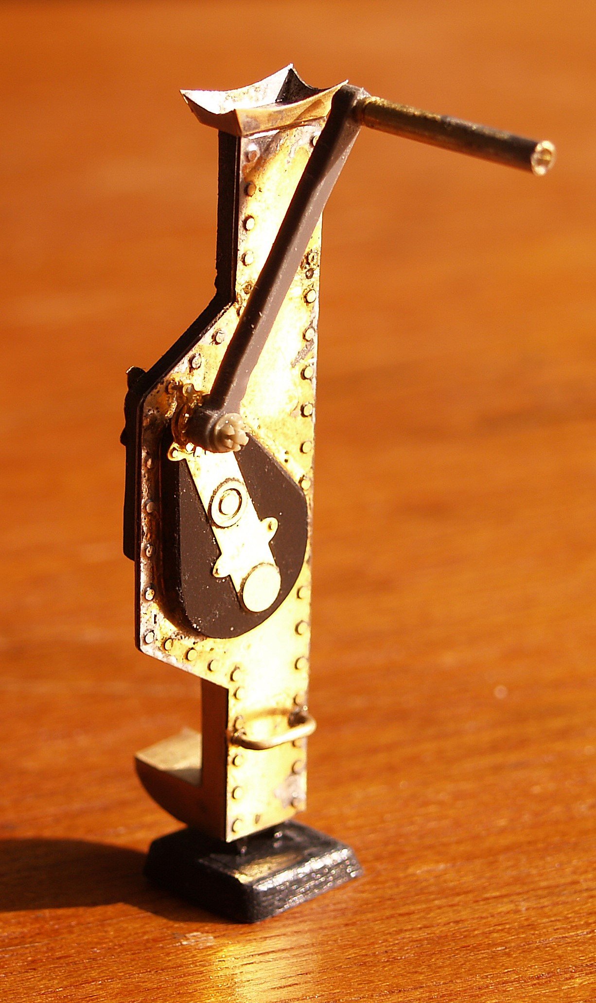

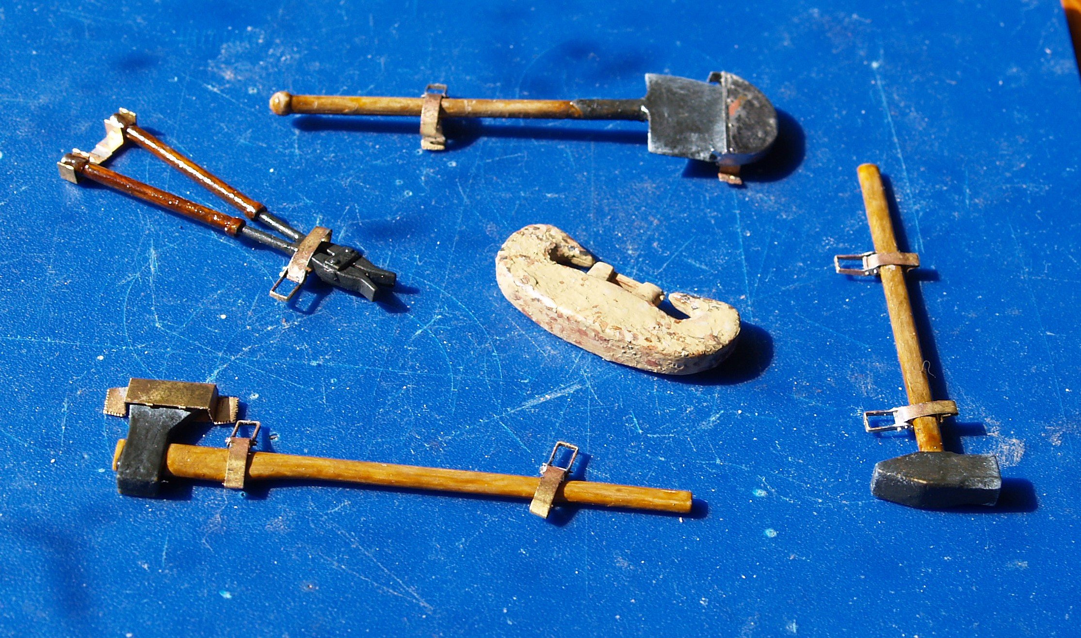

15t jack , I had another white metal one somewhere . .
Home made Kugel mount MG & the drivers visor getting some love .

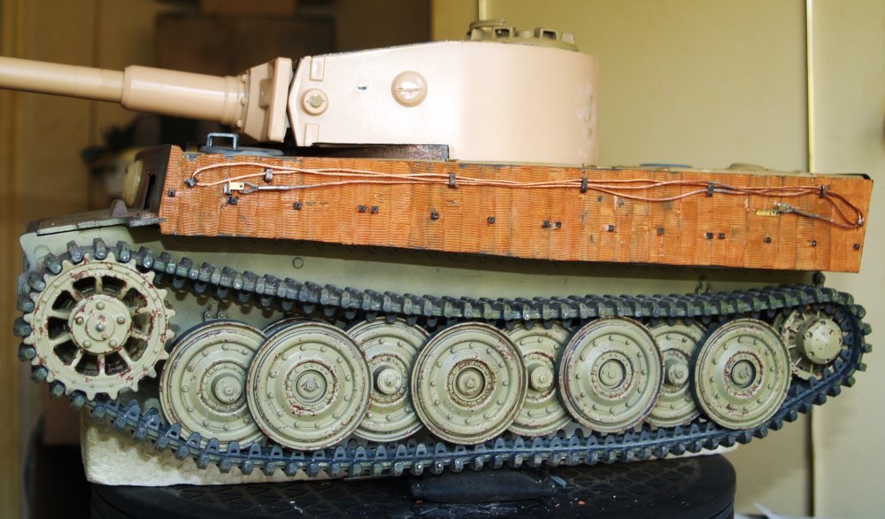

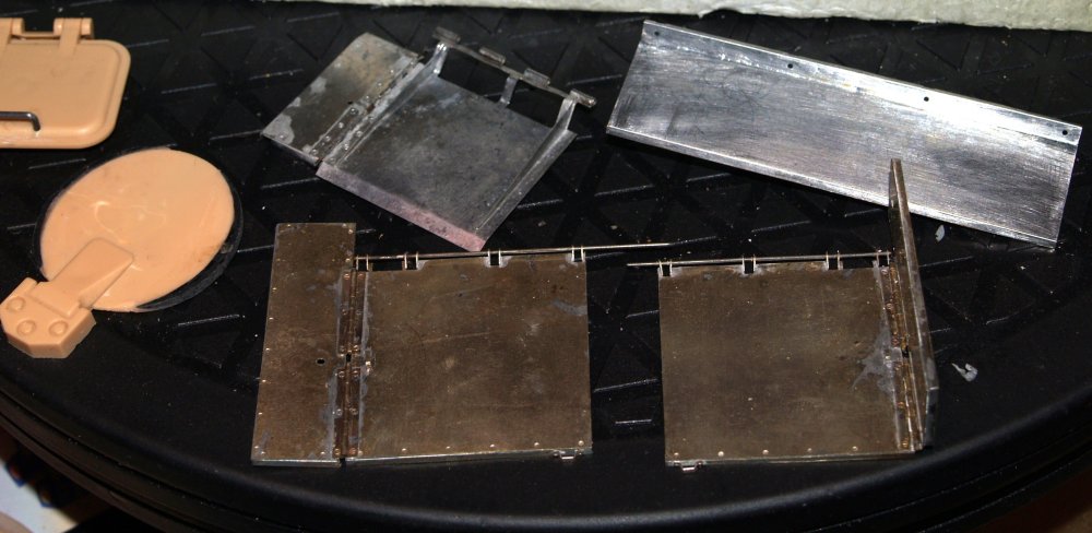

Fenders and reworked hatches . Because I'm going 'transport' I decided not to use the side skirts .
Voyager copper track cable , with new brass collet and eyes. Cable hooks were bits of packing staple.

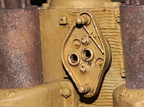

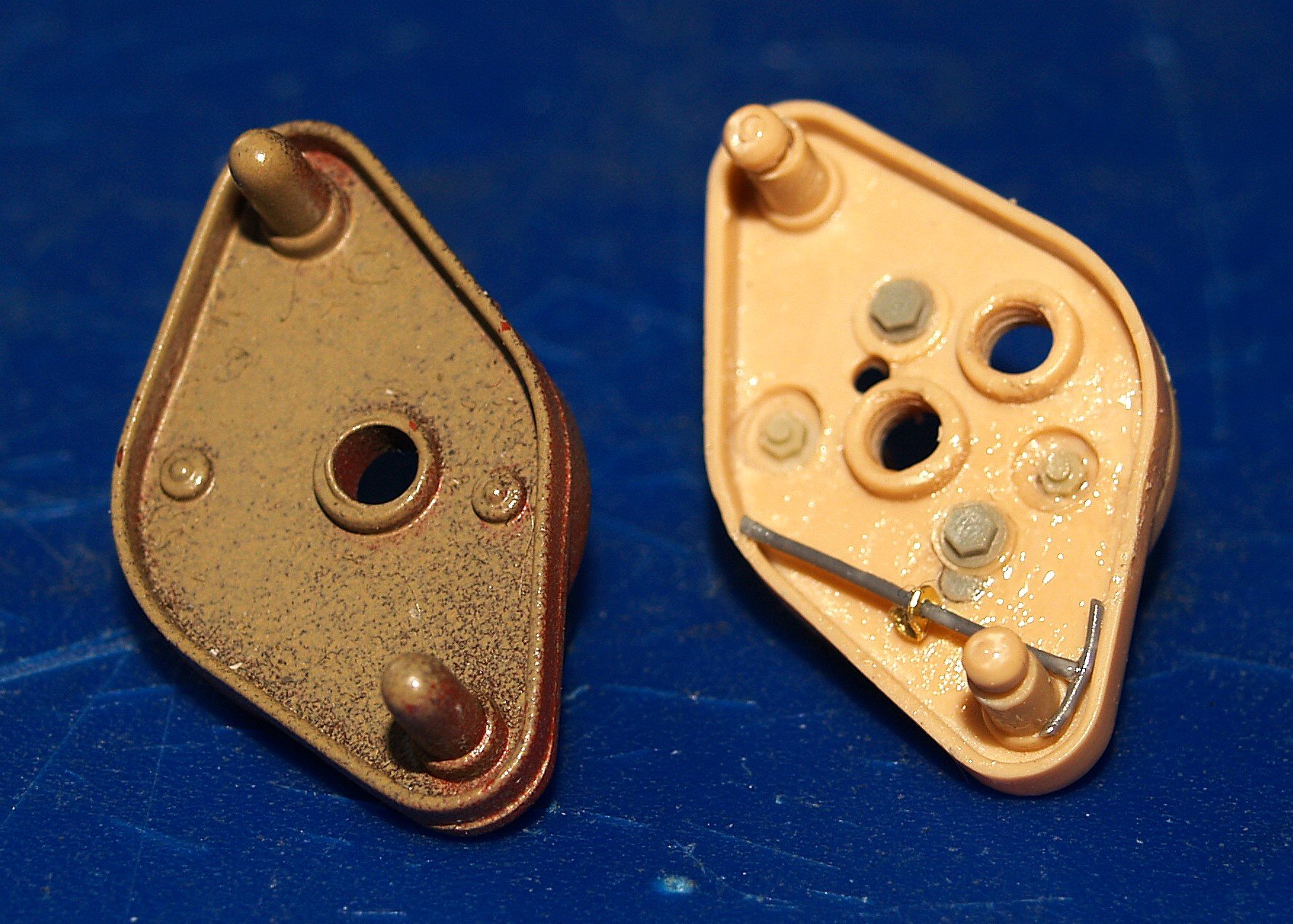

On the left is the original (early) engine starter plate .  My own reworked 'late' one , right . note the threaded starter holes  👀.
- And fitted.

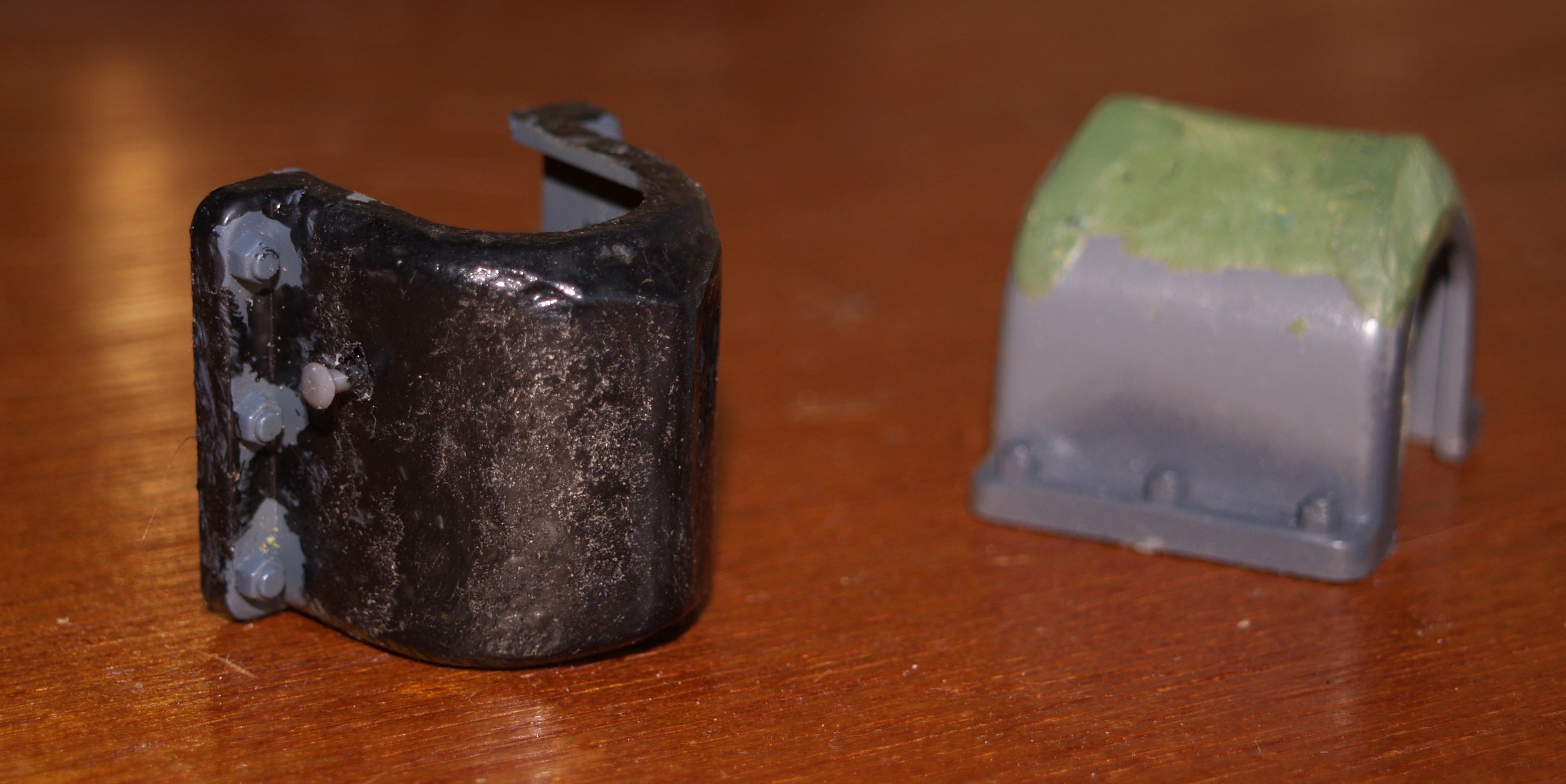

- Adding some rivets to the turret bin , loadsa little holes & stretched sprue , they were snipped off , and 'rounded' with a quick pass of a lighter .
hatch clasps not shown here , tiny things even in 1/16 , and only 6 pieces each !
Centre , Spare Aerial tube , made from brass tube and strip .
Right , Voyager engine mesh screens - they were slightly oversize , so I 'reframed' them with scrap P.E. and added some pins to help locate them.

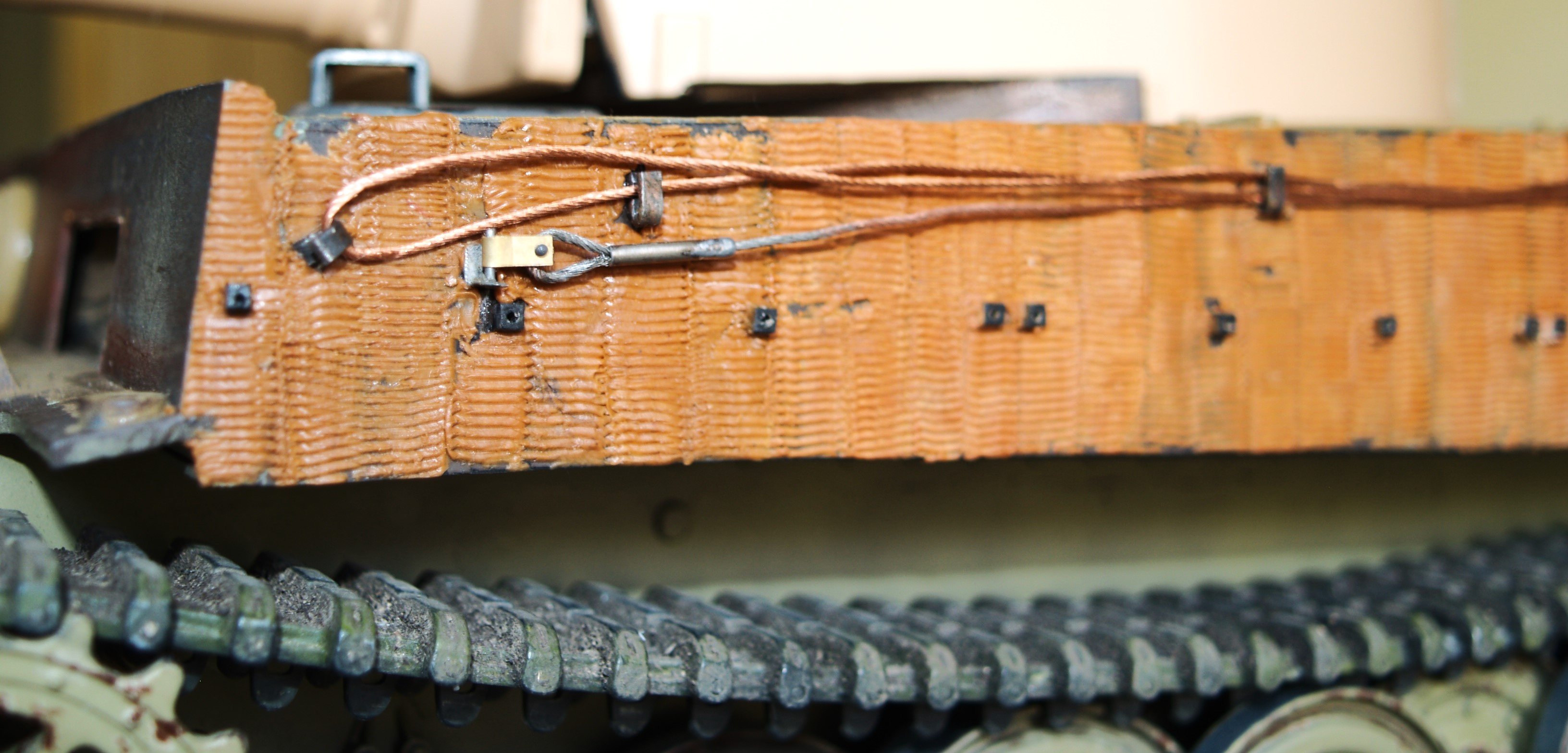

 Tow cables , HL's at the bottom . Could be better. . .
Centre ,  Bowden cable I had in the stash , looks good but was is oversize, pooh.
Top, Metal aftermarket ones , the cables have a decent weave  texture but they are too long 😶 the eyelets are very roughly crimped on .
these were removed after 'tinning' the ends with solder to stop them fraying, and the original HL ones drilled 'n glued on .
 They'll do .    B.T.W.  each cable holder is fabricated from P.E.,  7 pieces for each one here , workable too.
- I used to enjoy a bit of P.E. but am developing a healthy hate for this silliness 😬.
Engine deck as well , only 4 bits each though. Gun cleaning rod holders too.
