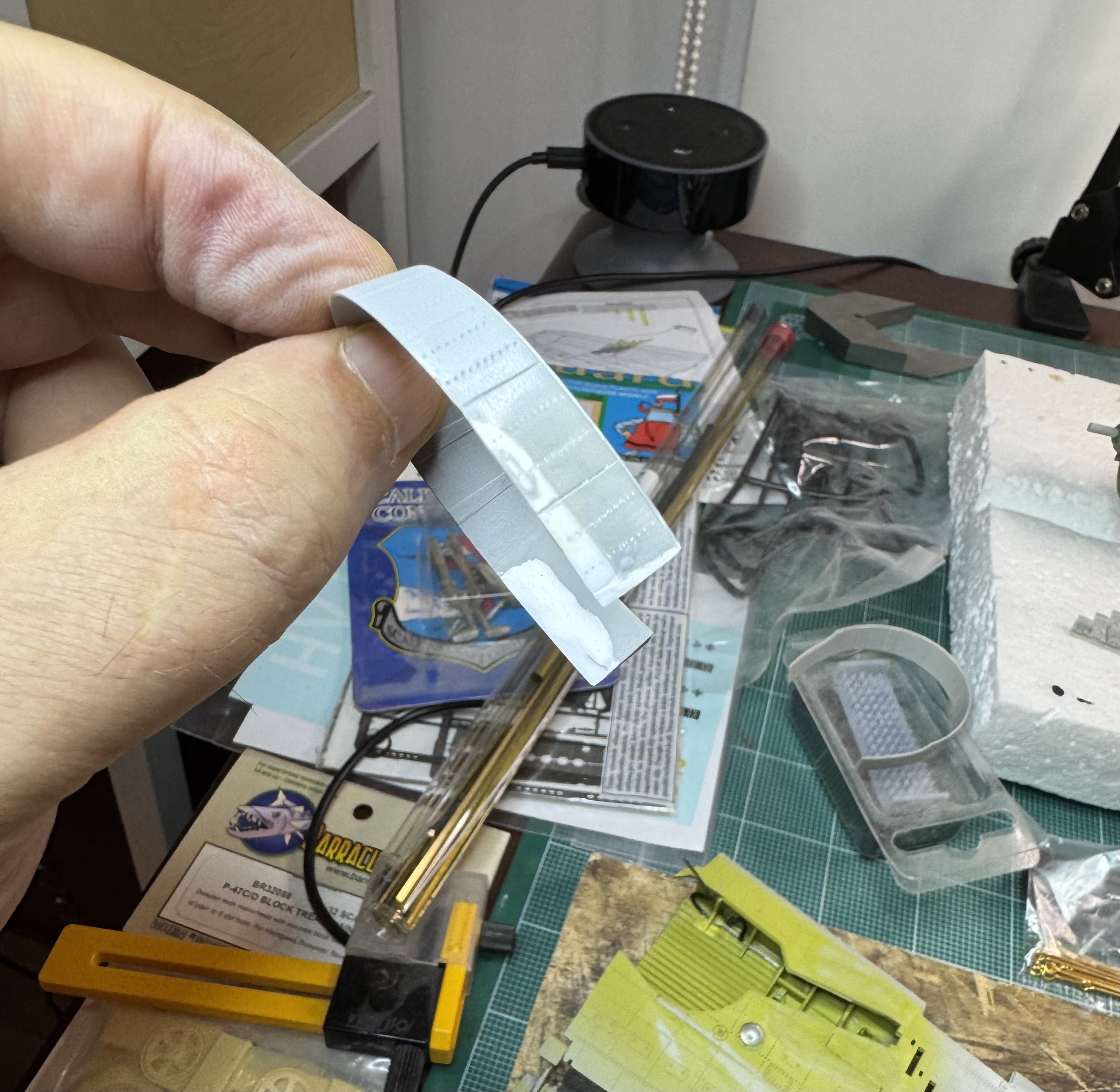

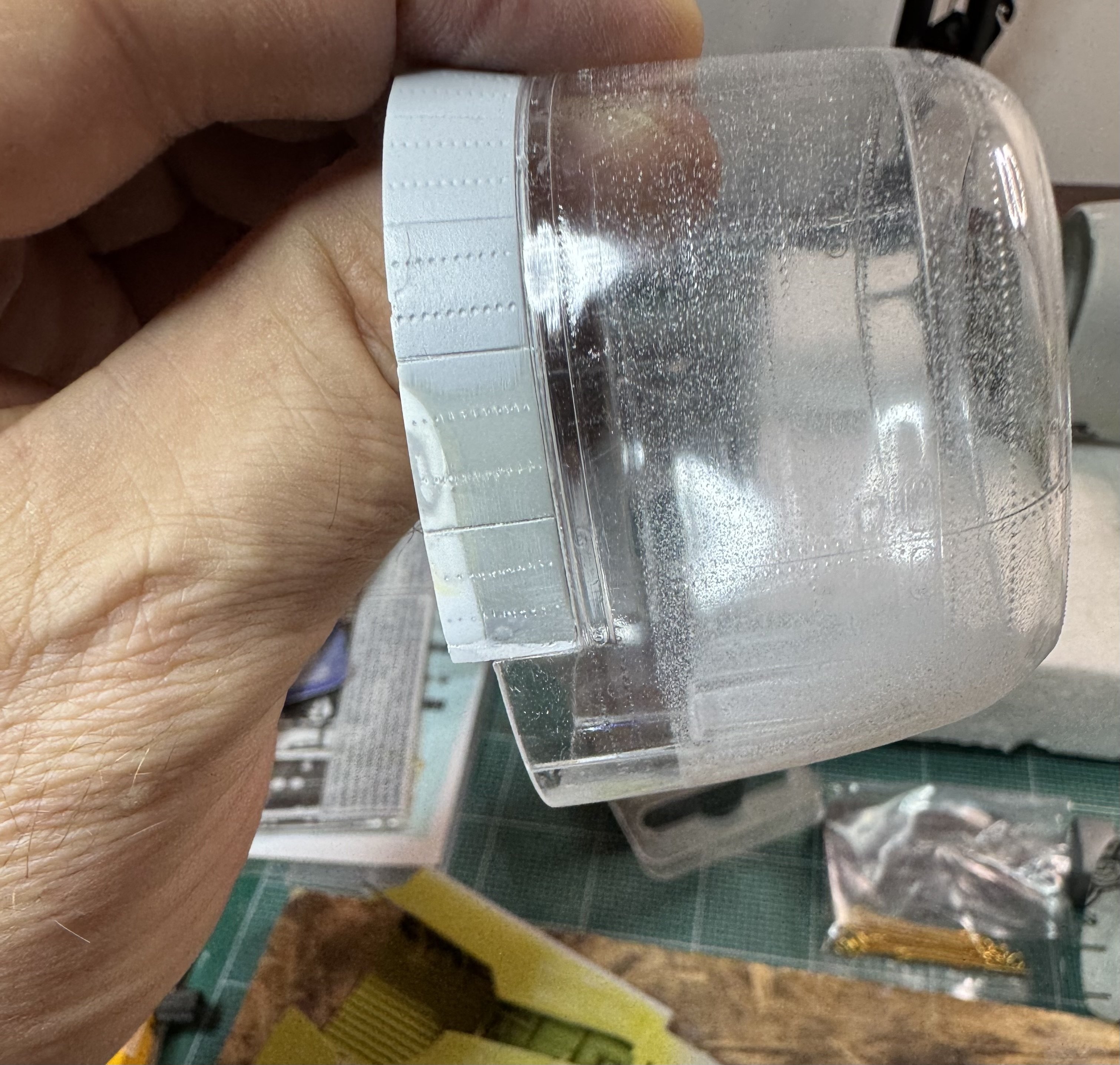

crazypoet Posted June 26 Author Posted June 26 I also finished up the squared-off cowl flaps for the D-5, and I like the way they’re fitting. Still need to be re-primed and may do a touch-up on the rivets, but I’m happy so far 5

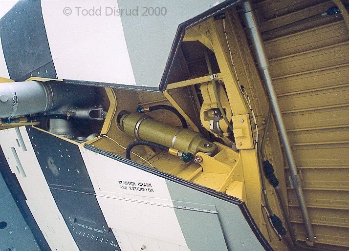

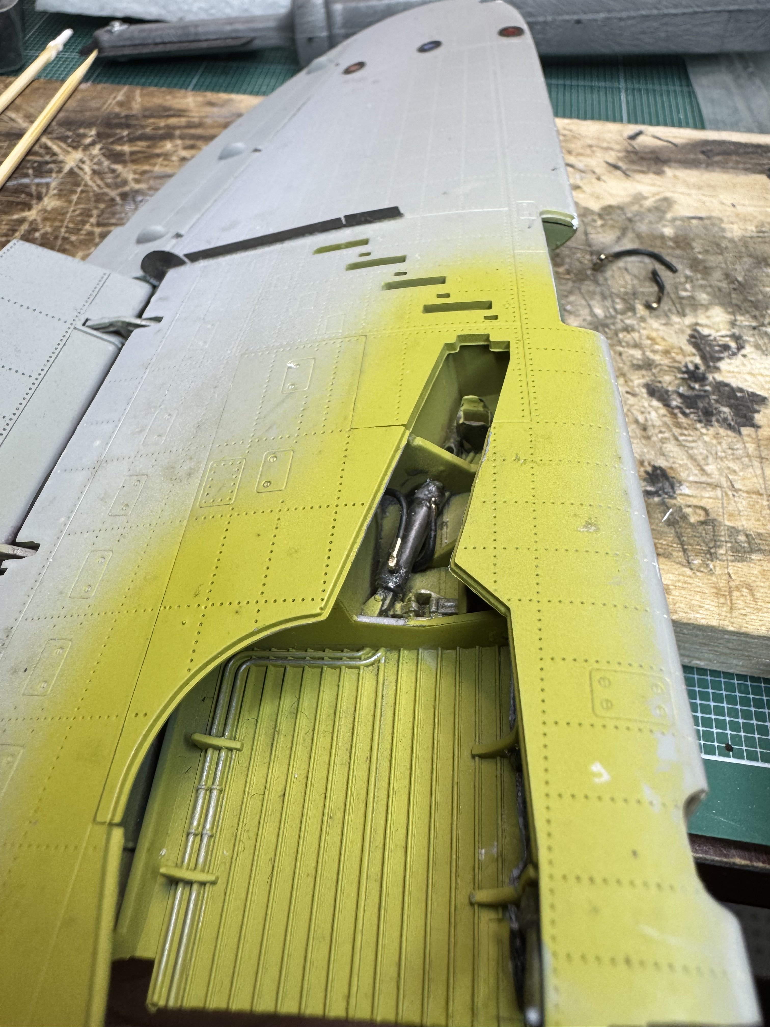

crazypoet Posted July 1 Author Posted July 1 So. In today’s episode of “why the hell didn’t I think of this *before* glueing something in place…” Each of the two hydraulic cylinders that raise and lower the main gear needs two fiddly little holes drilled to attach the hydraulic lines. plus, I need to drill a hole in the side of each gear well to accept one of the lines (the other tucks neatly underneath and out of sight) this would have been *so* much easier if I’d considered it either before gluing the cylinder in place or before joining the wing halves 7-P process in full display here 😂 at any rate, I’ve figured out the shapes and curves of the lines, I know where I have to drill, and just need to put a finish on the lines themselves. After much head-scratching and testing of different materials, I decided to go with some brass wire I had laying about to form the lines. with a small bending brake, I can set the correct angle for the connection to the cylinder, and the way it creates the bend gives me the look of a proper hydraulic fitting at the point of the bend. For the lines past the fitting, I’ll dip the wire in some black primer to give the proper OD for the hoses, then add a bit of texture to make them look like braided lines (yah, I have two sizes of scale braided lines, but the .5mm is too small and the .8mm ended up being a bit large after stretching over the brass wire…) wheeee! 5
FullArmor Posted July 1 Posted July 1 1 hour ago, crazypoet said: So. In today’s episode of “why the hell didn’t I think of this *before* glueing something in place…” Each of the two hydraulic cylinders that raise and lower the main gear needs two fiddly little holes drilled to attach the hydraulic lines. plus, I need to drill a hole in the side of each gear well to accept one of the lines (the other tucks neatly underneath and out of sight) this would have been *so* much easier if I’d considered it either before gluing the cylinder in place or before joining the wing halves 7-P process in full display here 😂 at any rate, I’ve figured out the shapes and curves of the lines, I know where I have to drill, and just need to put a finish on the lines themselves. After much head-scratching and testing of different materials, I decided to go with some brass wire I had laying about to form the lines. with a small bending brake, I can set the correct angle for the connection to the cylinder, and the way it creates the bend gives me the look of a proper hydraulic fitting at the point of the bend. For the lines past the fitting, I’ll dip the wire in some black primer to give the proper OD for the hoses, then add a bit of texture to make them look like braided lines (yah, I have two sizes of scale braided lines, but the .5mm is too small and the .8mm ended up being a bit large after stretching over the brass wire…) wheeee! A little advance planning is always worth it😄 2 1
crazypoet Posted July 4 Author Posted July 4 So with much cursing, a couple of drinks, and managing to break *both* of the tiny actuator arms for the inner landing gear doors (these things survived two years of storage and handling, only to fall prey to my using a bit of extra force with a pair of needle-nose pliers while fitting these lines. Gawds 🤦♂️ Fortunately, I have the correct size wire stock and drill bits to replace them later) the first set of lines are in and the glue is drying (micro crystal clear, since I needed it to dry slowly). I have a bit of cleanup to do, but I’m happy with the results My version, followed by a photo of a restored original (they used the same materials as the original, excepting the bright blue cap on the fittings 😂) I stand ready for your ridicule 5
crazypoet Posted July 5 Author Posted July 5 Ok, both sides done and a bit of cleanup accomplished. I need to do a light rub of Uschi’s iron powder to bring back the finish on the cylinder ends, and then dust things up to make it all look a bit lived-in its not quite as nice as it would have been had I done this before joining the wing halves - I simply didn’t think ahead (I was thinking more about the gun bays, truth be told) ah well, lesson learned for next time 6

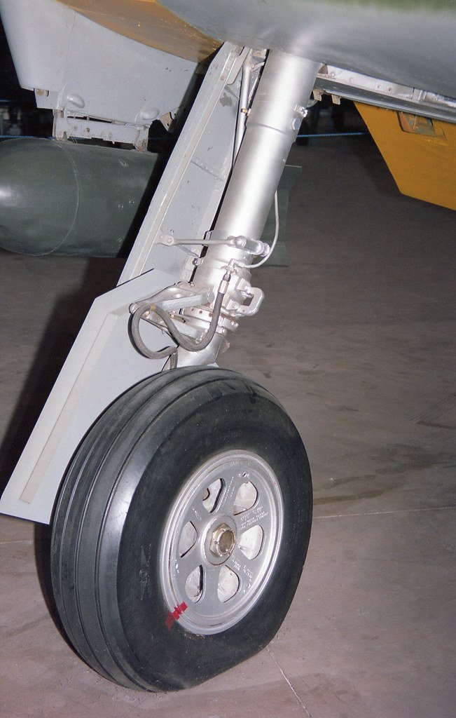

crazypoet Posted July 8 Author Posted July 8 So I’m getting ready to start putting these together. I have a pretty good feel for where they connect in the wheel well. There’s not a line already molded in the kit plastic, but that’s not a problem here - I can just add that as a part of the strut and glue it down when I install it so that part will be fairly straightforward so here’s the tricky thing. This line feeds the brake cylinders on the inside wall of the wheel hub. What isn’t clear is whether the line terminates into the axel (and then internally to the brake cylinders) or connects at some point to the brake cylinders more directly. I’ve found two pics that *sort* of show this end, but neither show that level of detail. so a question to those who’ve trod this path before me - brake line into the axel, or to a point on the inner edge of the wheel, where the brake cylinders are actuated? my instinct (and some excellent YouTube vids on how aircraft brakes actually work) tells me that this line will connect to the plate holding the cylinders - but that’s still not entirely clear from the photos I’ve been able to find im using the excellent resin main wheels from BarracudaCast for this, which include a bit of detail on the brake cylinder side of things, but not enough the make it easy to identify a connection point for the brake line here are the two pics I have that sort of show this. Neither one is taken from an angle that really lets me look at that final connection point, so I’m wide open to suggestions 🙏 2
DocRob Posted July 8 Posted July 8 Sorry, no hit, I checked my pix from a P47-D from Chino, but non showed it clearly. Problem is, the wheel well cover sits so tight around the axle and brake line, that it is barely visible at all. You should check, if it would be visible with your kit LG. Have you checked technical drawings? Cheers Rob 1
crazypoet Posted July 8 Author Posted July 8 31 minutes ago, DocRob said: Sorry, no hit, I checked my pix from a P47-D from Chino, but non showed it clearly. Problem is, the wheel well cover sits so tight around the axle and brake line, that it is barely visible at all. You should check, if it would be visible with your kit LG. Have you checked technical drawings? Cheers Rob I have a subscription for AirCorps, but not even their references and manuals (so far) have shown this in detail i agree that it’s a bit of a snug fit between the wheel, gear covers, and strut - but it would be just my luck to have this in a contest and find that I got it wrong 😂 1
HubertB Posted July 8 Posted July 8 Nice work 👍! No judge in a contest would probably know what’s right anyway, not taking into account that accuracy is NOT a criterion in judging in model contests. But no judging can beat the « I know it’s accurate » feeling , and this is the one you are striving to satisfy . Hubert 2 1
denders Posted July 8 Posted July 8 Well, it has to work in similar fashion to the brakes on you car. The brake cylinder and pads don’t rotate with the wheel and I can’t see any reason to complicate it by going through the axle. 1
denders Posted July 8 Posted July 8 It seems strange that I don't have one of the P-47 Squadron Walkaround books, but I don't. This is from the F4U Corsair book. The wheel and brake line connection are from the same period. 1 1
denders Posted July 8 Posted July 8 Well, now that I said I don't have the book, I went on ebay to see which number in the series it was (#11) and looked on the bookshelf again, there it is. But, it doesn't have any helpful photos similar to the corsair photo. I did find this drawing which you might find interesting. 1 1
crazypoet Posted July 9 Author Posted July 9 15 hours ago, denders said: It seems strange that I don't have one of the P-47 Squadron Walkaround books, but I don't. This is from the F4U Corsair book. The wheel and brake line connection are from the same period. This is truly helpful! I wish that at least one of the half-dozen P-47 books I have had even one shot like this 🙏 I’ve figured out that, yah, it would be overly complicated to route this line through the axel, so there’s that. i *think* I’ve figured out sort of where the line connects to the plate with the brake pistons (ish). This photo actually gives me some good ideas about how to “translate” the pics that I do have. granted that it’s a different manufacturer and engineering team on the Corsair, but there’s only so many ways to skin this particular cat thank you for digging around - it truly helps 🙏

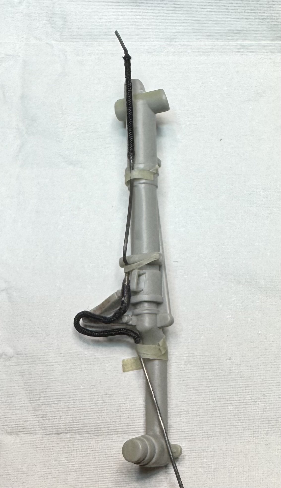

crazypoet Posted July 11 Author Posted July 11 OK…. I’ve worked out the routing, based as closely as I can from different sources (thanks Doc and Denders!) I decided that I’m going to try doing this as a single wire piece on each side. getting appropriate scale wire around here is a bit of a challenge, but I made the happy discovery that the twist-ties used by the local bakery to close their bread bags have steel wire at their cores that is just about perfect in terms of length, scale and flexibility 😎 So my approach to this… I used a bit of too-thick copper wire to build a full-length template from the gear bay to wheel hub, then used a sharpie to mark where connectors and cable clamps will need to be added, and the curves for the flexible hose sections that I’ll replicate with .5mm braided line with the twist-tie wire threaded through so… each piece will have two sections of braided line with line connections at both ends, plus four cable clamps that I’ll make from thin strips of plastic masking tape. The final version of the braided line sections will be a bit more “curvy” than the template, to emphasize that they’re flexible and affected by little things like gravity and being long enough to flex with gear extension and the oleos extending/retracting The gluing, priming, and painting sequence will be a bit of a challenge, without messing up the braided line sections with paint from other areas even so, it’s a lot simpler that doing these lines as different pieces (braided line, then bare metal line, then braided again and so forth) then gluing them down with the proper alignment so here’s one of the copper wire templates (right wing side), next to a piece of twist-tie wire with the first bit of braided line. I’m using drops of micro crystal clear (and a light touch with files and such) to secure the braided line and also form the connection line adapters and such along the length this will be a bit fiddly, but I’m having fun with it 2
crazypoet Posted July 11 Author Posted July 11 (This is one of many times when I wish I had Jeroen’s mad CAD skills and access to a good 3D printer… 😂) 2
crazypoet Posted yesterday at 09:02 AM Author Posted yesterday at 09:02 AM I finally had a bit of bench time today, and sort of got this sorted for one of the struts 😂 getting the flexible parts of the line to look natural while keeping the rest suitably straight, with proper bends in the proper places was a bit of a chore 🤦♂️🤦♂️🤦♂️ but it’s finally “close enough” to match my references. right now it looks a mess as it’s just temporarily taped in place - nothing’s been glued down, no cable clamps yet, and no primer or paint but the fit is finally right, and I can do the final fine-tuning of the bends as I glue it into place I’ll make the cable clamps from 1/32” strips of tamiya tape and CA - there will be four of those on each side I’ll have to prime and paint the brake line and strut separately, so I don’t mess up the braided sections. Then glue the line down, add the clamps, paint the final details and add appropriate oil stains and dust and suchlike. The final connection to the wheel hub will wait until I’m ready to mount the wheels themselves, since I’ll have to add a final 90 degree bend in the line, cut it to length, and glue it to a pinhole I’ll drill in the hub wheee 😂 3
