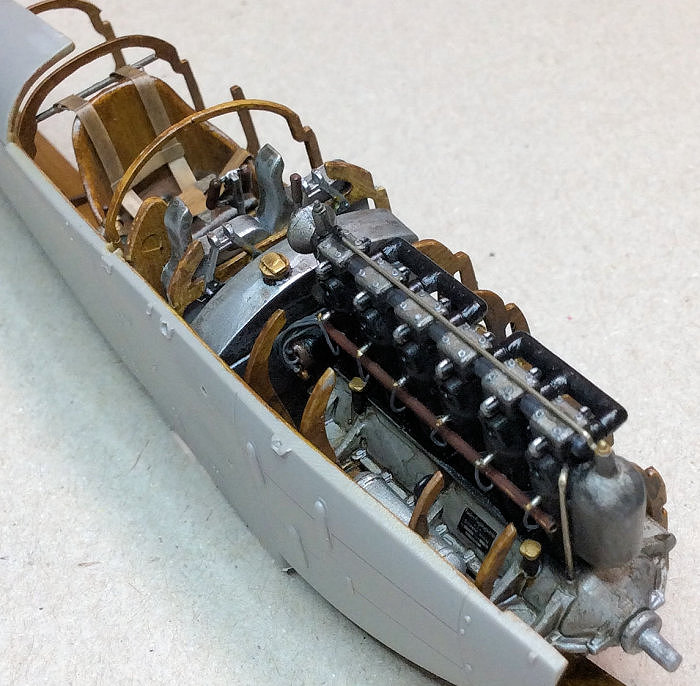

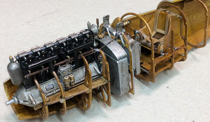

Hi all,
The engine is completed.
It's the basic kit engine with just a few enhancements, as most will be hidden by the the fuselage.
I've added:
Ignition lead support tubes (1.0 diameter brass tube).
Ignition leads at the spark plugs and magnetos (0.3 mm diameter lead wire).
Coolant expansion tank and pipe (modified WNW engine cylinder and 0.4 mm diameter Nickel-Silver tube and flexible black tube).
Coolant supply pipe from water pump to cylinder integral gallery.
Carburettor control rods (blackened 0.4 mm Brass tube).
Air vale at rear of camshaft housing.
Fuel feed pipes to base of the carburettor.
Spare WNW data plate decals.
Mike
Hi all,
I'm getting close to the fuselage being closed up.
As is usual, most of this won't be seen, but hey-ho.
I just have to add the flight control lines, engine controls, wiring at the starter magneto and switch and the gun trigger cables.
