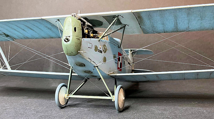

sandbagger Posted March 30, 2023 Author Posted March 30, 2023 Hi all, An update on the Hannover build. The fuselage has been closed up. Fuselage, wings and tailplanes have had their panels and fittings etc painted. Pilots Spandau machine gun fitted as well as the nose cowl and some of the engine access panels (others will be left off). Still some work to be done before weathering then preparing and applying the decals. Mike 5 2

HubertB Posted April 4, 2023 Posted April 4, 2023 Very nice work, Mike. If I may, the linen effect decals look surprisingly « heavy » on this build, compared to what I have grown to get used to on your builds. But then, maybe it’s just me … Hubert
sandbagger Posted April 5, 2023 Author Posted April 5, 2023 14 hours ago, HubertB said: Very nice work, Mike. If I may, the linen effect decals look surprisingly « heavy » on this build, compared to what I have grown to get used to on your builds. But then, maybe it’s just me … Hubert Hi Hubert, Yes it is more obvious than usual. I think it can only be the light blue base colour. I did consider applying a very light over spray of the base colour to 'knock it back', but thought it too risky. Actually it's not too obvious viewing the model normally, Mike 1

sandbagger Posted April 10, 2023 Author Posted April 10, 2023 Hi all, The upper wing has fitted. Pre-rigged with resin anchor points, blackened 0.5 mm diameter Brass tube and 0.12 mm mono-filament. Rudder control cables also rigged with 'Proper Plane' turnbuckles, 0.08 mm diameter mono-filament and blackened 0.4 mm diameter Brass tube. Now it's onto final rigging, Mike 4
sandbagger Posted April 12, 2023 Author Posted April 12, 2023 Hi all, Final rigging is complete. I tried this time using resin Anchor Points, but won't bother in the future. Although they will take tension in the rigging line, they break away very easily if only slightly knocked. I'll continue to use the metal versions from 'Gaspatch', even though most unfortunately have blocked 'eye' ends, which effectively renders them unusable. I've used 1:32nd and 1:48th scale One Ended version turnbuckles from 'Gaspatch' on this build. There's still more bits to fit and figures to paint, but I'm getting there, Mike 5
