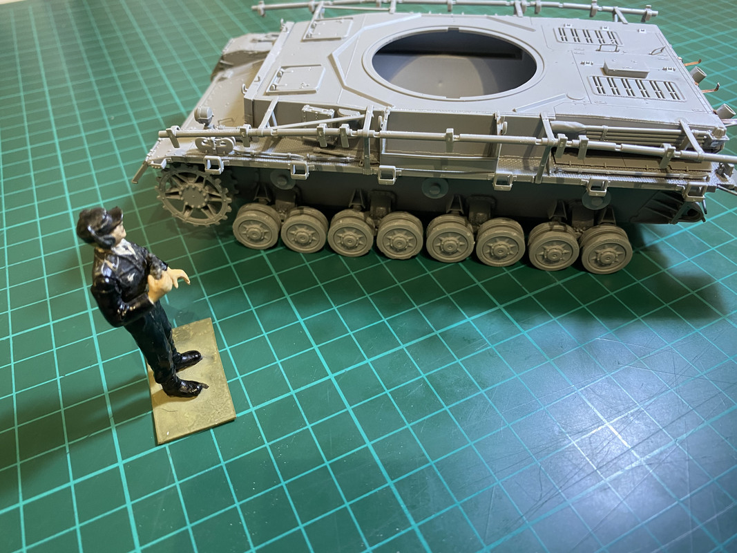

Had this as a birthday present a few years ago , built some of it just to check it out, held off building much more, as was unsure where it was going ....late Normandy ....Battle o/t Bulge Scenario ....East Prussia 45 ...?????maybe just build the tank and couple of figures and not make any in depth scenario ??? Whatever way , it's well inside my comfort zone .
So nice box art
E6-B6-A773-5279-472-B-88-EC-09339-BE60-F
My first Border offering ...looks good .
Lots of sprues, lots of options , nice moulding, tight Takom'esq side gates , PE , Metal Barrel ...seperate plastic track links or optional link and length tracks. Very clear instructions , not convinced by the painting instructions , but will do my own research anyway . Decals look ok ish , buy will probs mask or use better ones from stash.

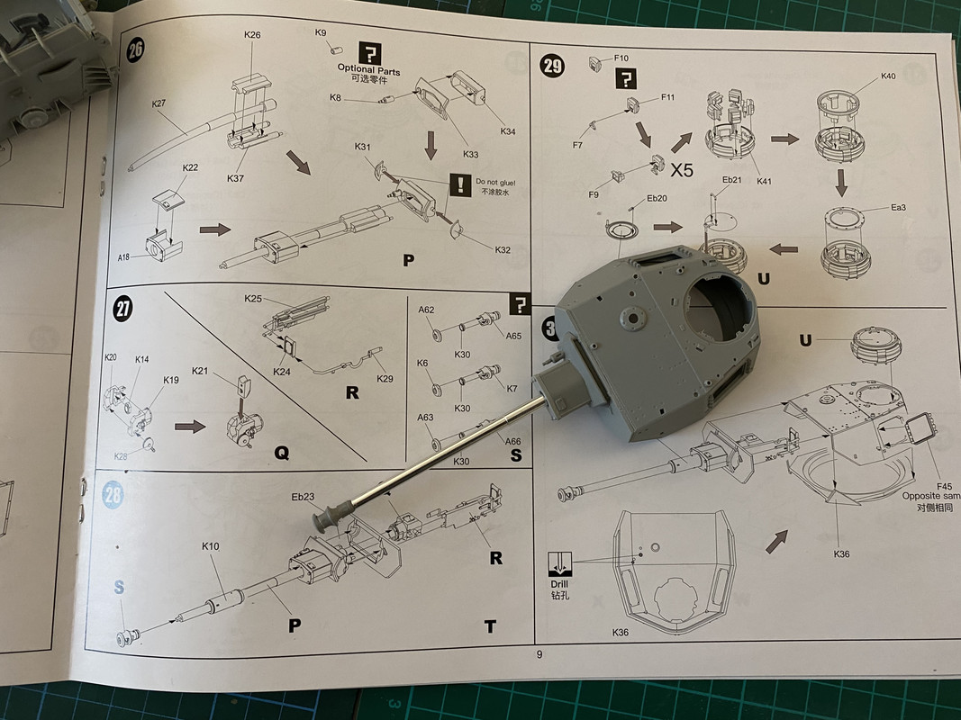

Zipping on , turret ready for paint .

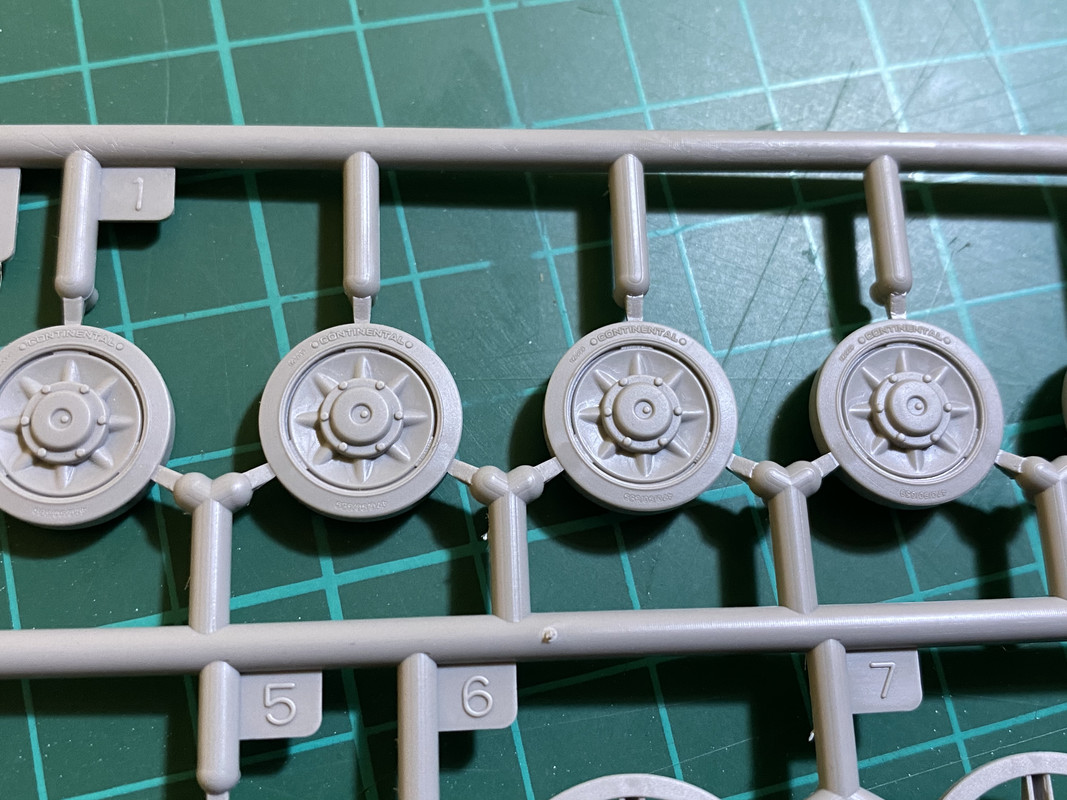

Close ups on some of the nice moulding details - manufacturers markings on tyres , well defined tracks , pin marks very slight and rarely in an area that is visible. Plastic is good too , not too soft , but easily cut, sanding doesn't rip it.
D11495-F3-8947-46-CE-AC99-1-DAA64-D97640

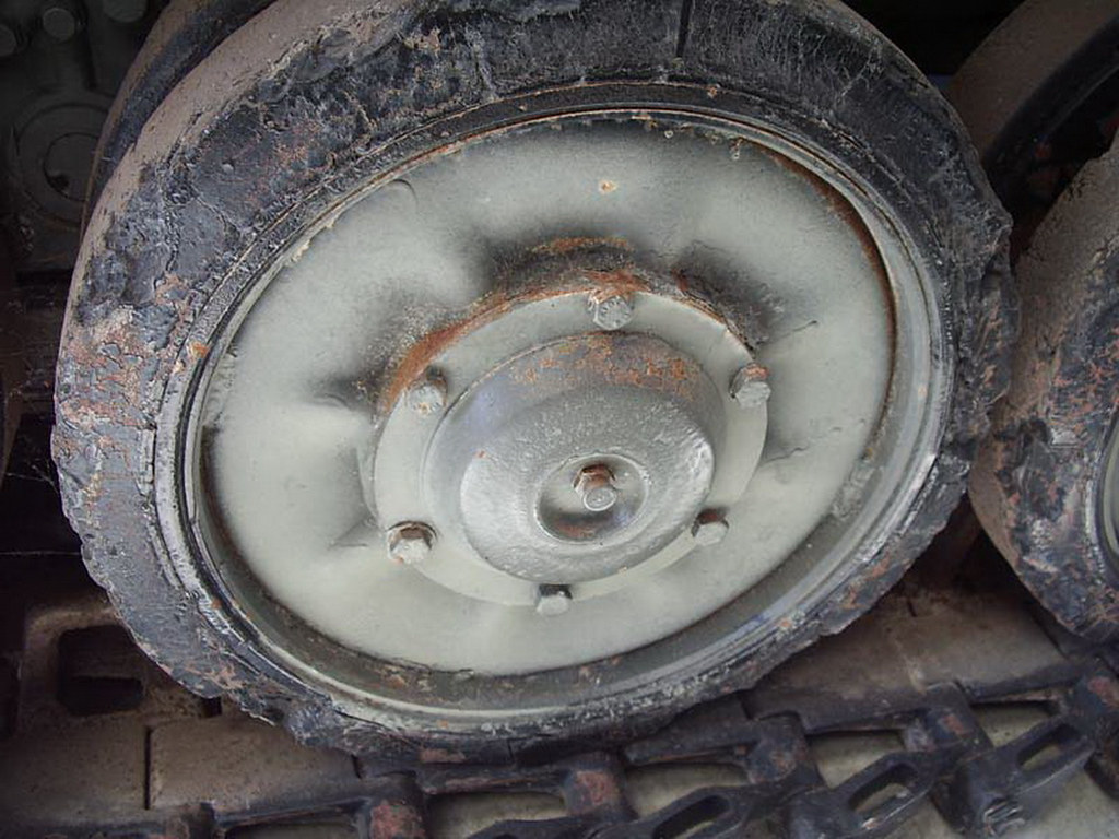

Pretty good , even down to the offset centre oil level screw and the hub welds. Holes in the edges of the tracks .

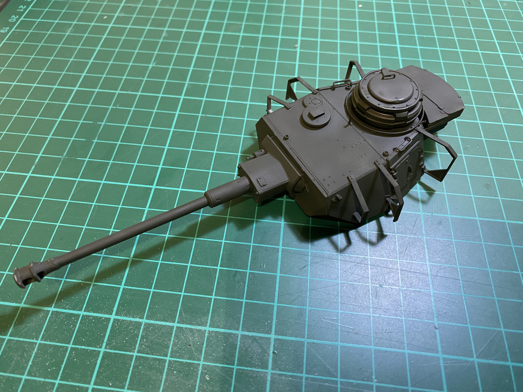

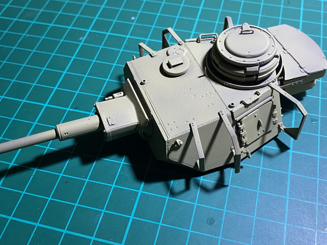

Turret done barring the spaced armour . Primed with grey rattle can , based with black/green , primed uppers with primer red , painted in Dunklegelb Tamiya's newer XF-89 . Now to finish the hull to the same point then cammo .
E81-CCC49-58-E6-45-F4-994-B-CB451-CD3-F5
Nice i nscale armour texture and welds . No filler needed

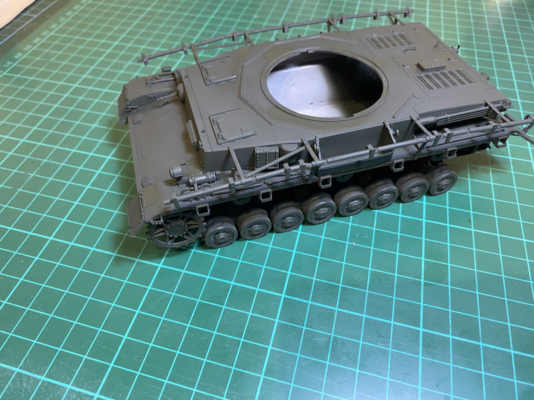

Bit more progress...been busy with other things this week . Kurt overseeing construction of the Wanne . You cant tell but those suspension units  will rotate if you want them to , if you are using the workable track .
Hows the fit ??? It's absolutely awesome , as tight as a millenial Tamiay offering , zero filler or clamping needed
Kurt feels that Panzerwomble's intake of wine is inversely proportional to the progress of this model .

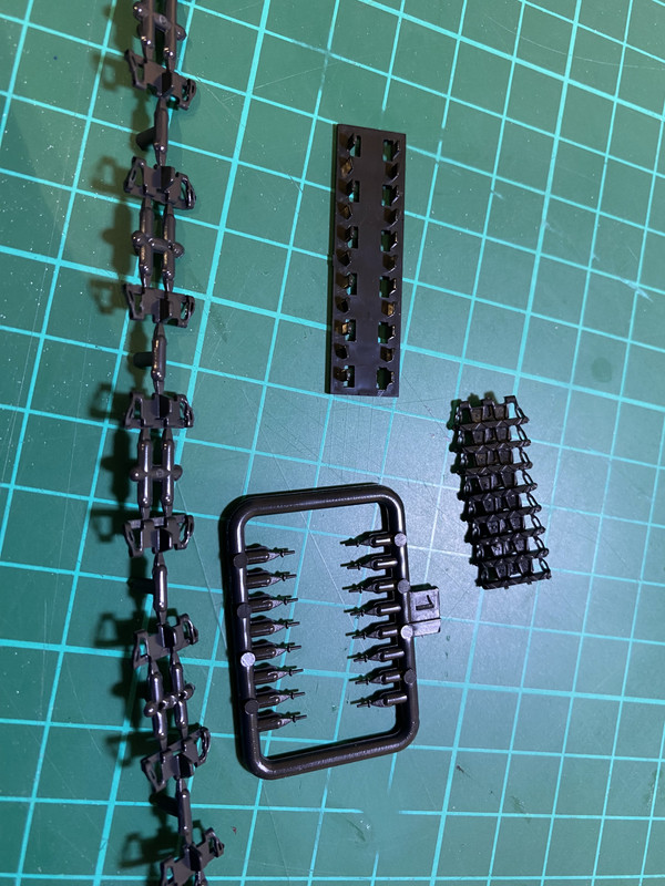

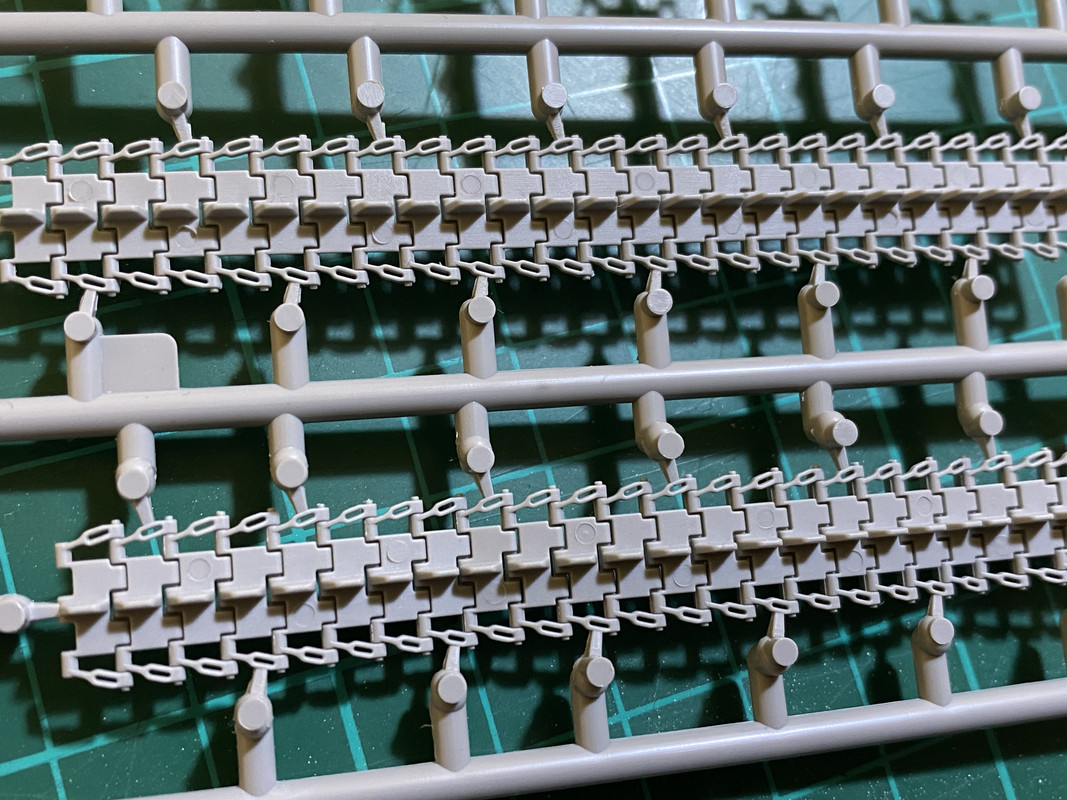

But what about those workable tracks ... ??? For my money they are a let down . Not so well detailed as the link and length offerings , the track pins are poorly thought out. If they were the only option I'd go metal tracks rather than bother with these.

Nice work, Guy!  The main reason I prefer indy links is because I like to have a little variation in placement for road wheels and tracks on some piece of terrain.  I've got a couple sets of friuls that migrate from model to model as I save the magic tracks for that model that deserves them.  Teeny tiny pins suck.

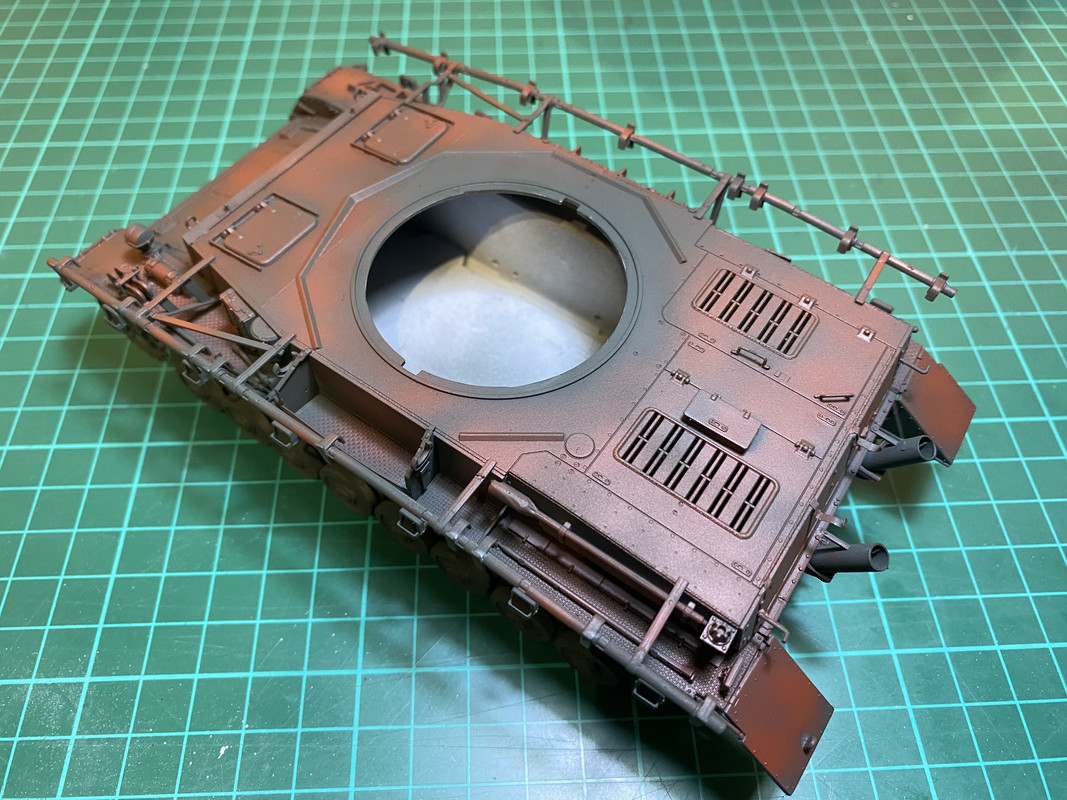

Primed in primer filler  , black based , toned with red primer , based again in DGelb . Not bad for an evening .
Need to sort out the spaced armour on the turret then can do the cammo patterns .

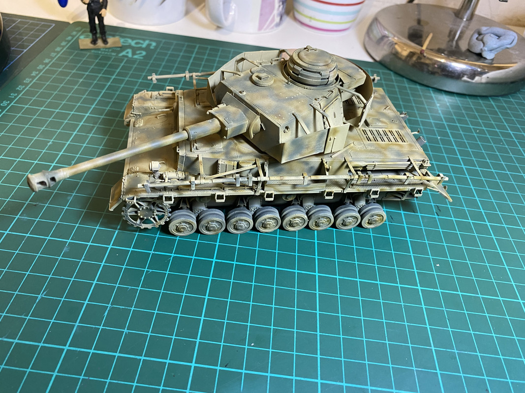

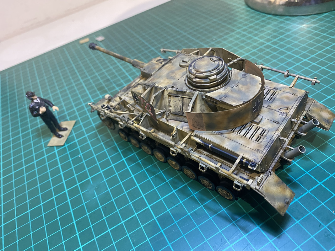

Replaced most of the plastic spaced armour ( 1mm ...) with copper foil ..(0.1mm) . Given this was made from 5mm boiler plate my copper is much closer to scale.
And done the two colour cammo plus a quick filter coat.

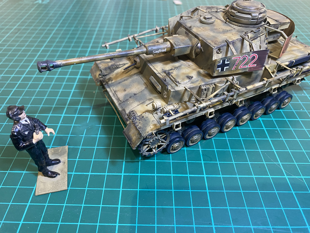

Ok where were we ?
Construct , basic paint .

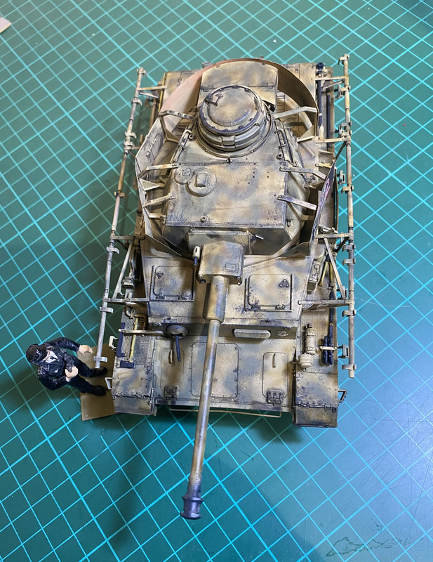

So , painting of some details , selective glossing , decals , (we are going LSSAH for this one) , dry brushed , initial chipping , heavy oil pin / flood washing and then sealed for now with matt varnish . More detail painting to come , and then a bunch of mud as I reckon this is a survivor from 7th Koy KG Peiper at the end of the Bulge in Jan 45. Not sure if the mesh guards made it through all the bombardments, but will need tracks and a crew of two . Here one from 1er Zug got zapped by fighter bombers on the 30th Dec*. Had a thought about a base as well .
