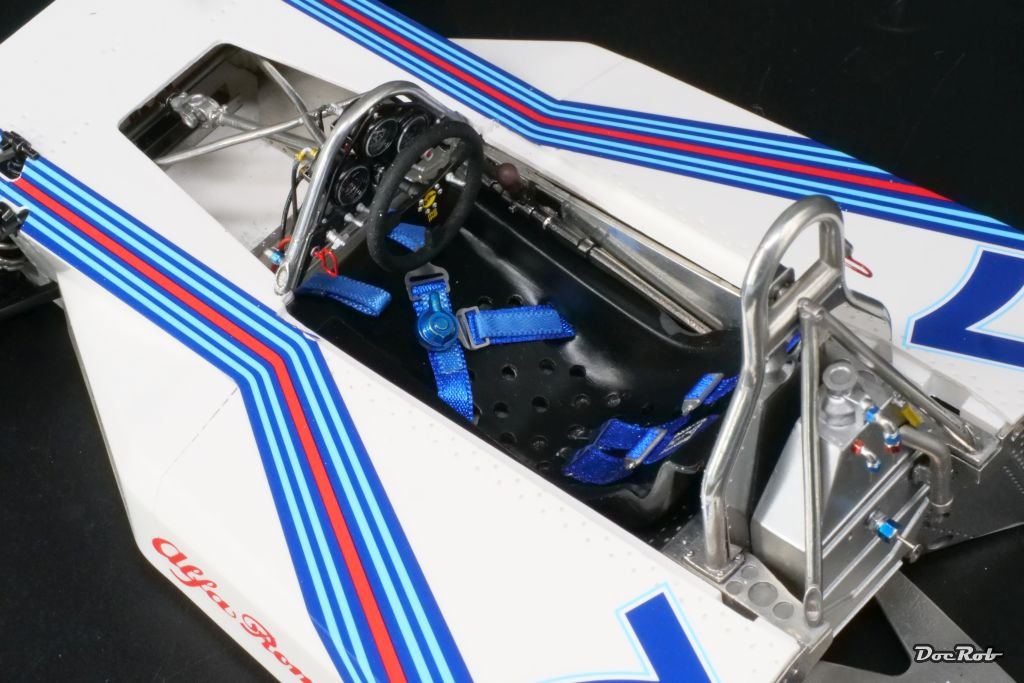

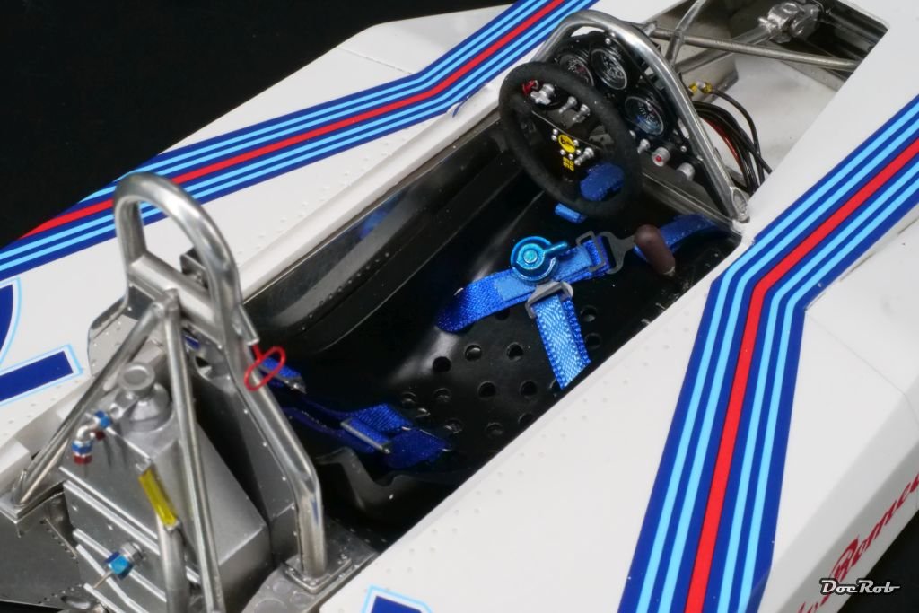

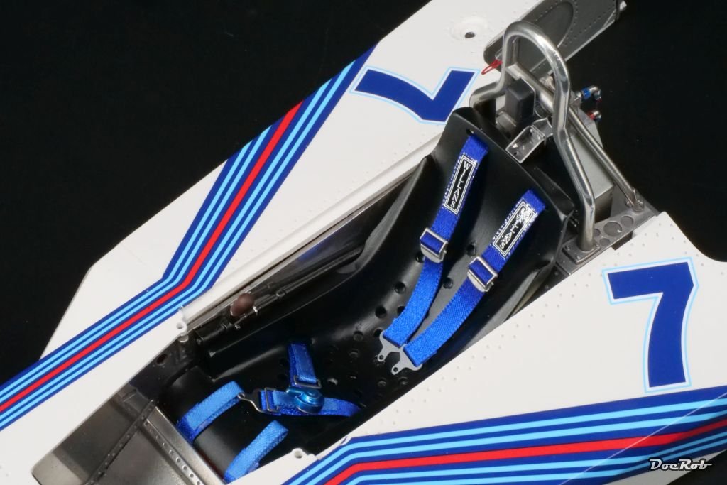

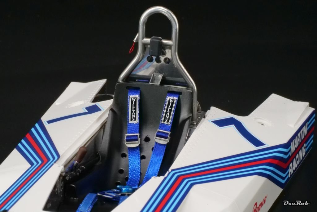

The cockpit tub starts to become busy. I added the seat belts to the seat and then this was glued into the tub. I really like MFH seat belts, as they look good and are relatively easy to assemble. There are white metal buckles and PE parts and two widths of blue ribbon. All got assembled using double sided tape, which has a strong bond and is supplied with the kit. I bought seat belt sets for other kits too, like for my 1/12 Tamiya kits.
The manual placed the headrest/rollbar before the seat, but I chose to do it after, because it was easier to fiddle in the seat belts behind the seat.

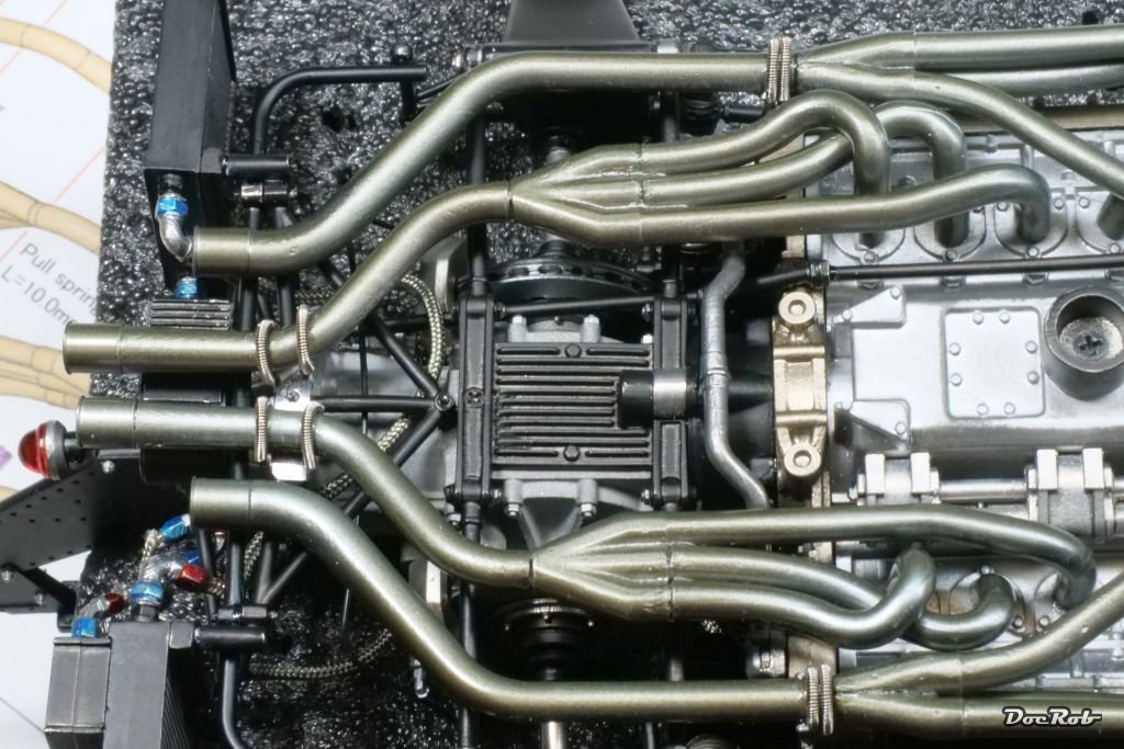

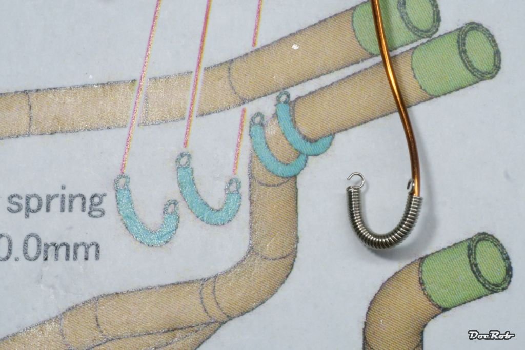

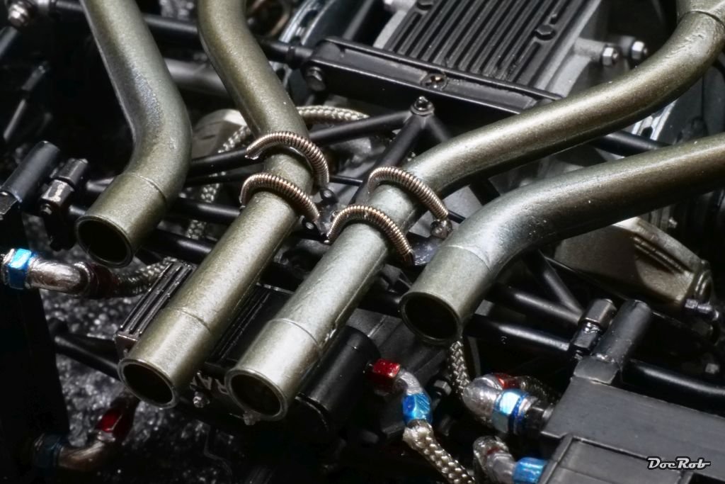

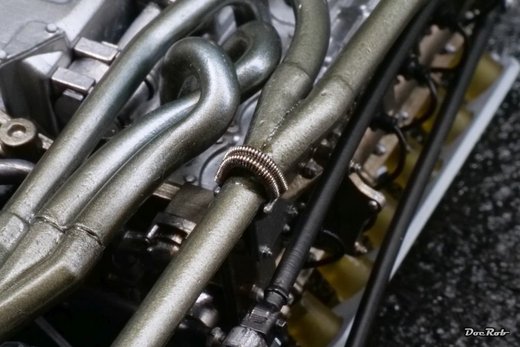

One subject out of an earlier phase of the build was still aggravating me, the coil springs, which hold the exhausts in place. There are eight and I couldn´t add a single one, despite trying really hard.
Then I had an idea. What if I insert a copper wire into the coil spring, to bend it easily into the needed curve. I tried and it worked.
Half an hour later, this issue was fixed and I have an open issue less on my schedule.

That copper tubing on the front brakes looks great. Is that infact copper line or is it paint?
Oh I see now, copper wire. From the exhaust spring photo.
Edited by Count0
addition
The copper of the braking lines was supplied with the kit and actually is a tube with a very tiny bore. The copper from the exhaust coil springs was wire from the leftover box.
Some fantastic progress Rob. Great solution for the exhaust springs.

Thanks Carl, I first used the MFH seat belts with my Tamiya 1/12 Renault Turbo build and liked them better than the ones Tamiya supplied and bought them for all my F1 1/12 kits and even some 1/20 kits.

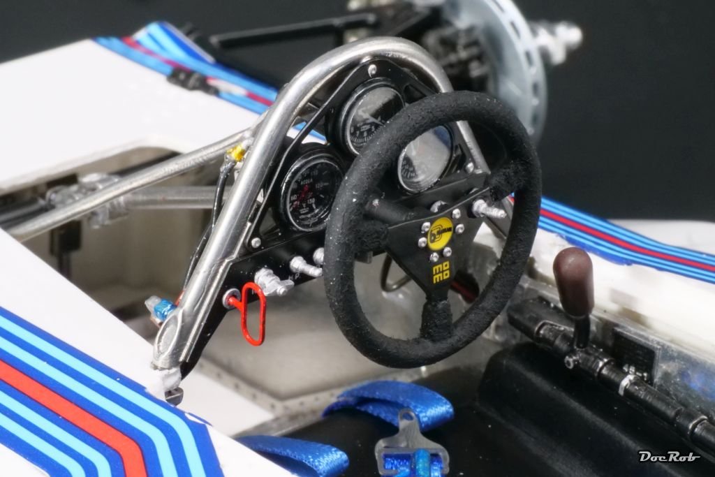

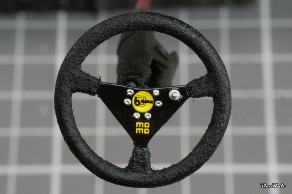

Today I finished the steering wheel, which was first airbrushed gloss black for decaling, then received the rivets, followed by a coat of semi matte clear. After drying, I masked the inner part and applied a coat of Tamiya LP flat black and dabbed in some black StreetBlister textile flocks for texture with a brush.
I was not satisfied with the matte look and added a coat of Tamiya LP flat clear, again not flat enough. Finally, I used good old Tamiya XF-1 flat black.
The fibers were finger dabbed into the fresh point and there are still some of them waiting for a shave. It looks a bit coarse in the pic, but this is heavy macroed.

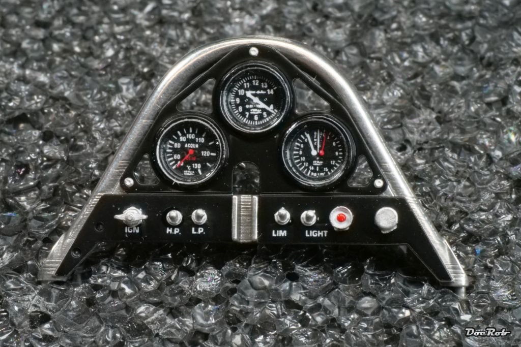

The instrument front panel, made from PE was also sprayed gloss black, followed by decaling the switches and dials, followed by a semi matte clear coat as a finish. I then added some brackets to the instruments, before gluing and riveting everything to the front roll bar, which was polished beforehand.
The bezels are supplied as clear acetate circles, which I glued using Future. Last were the white metal switches, with only the fire extinguisher pull ring missing, because it´s to fragile

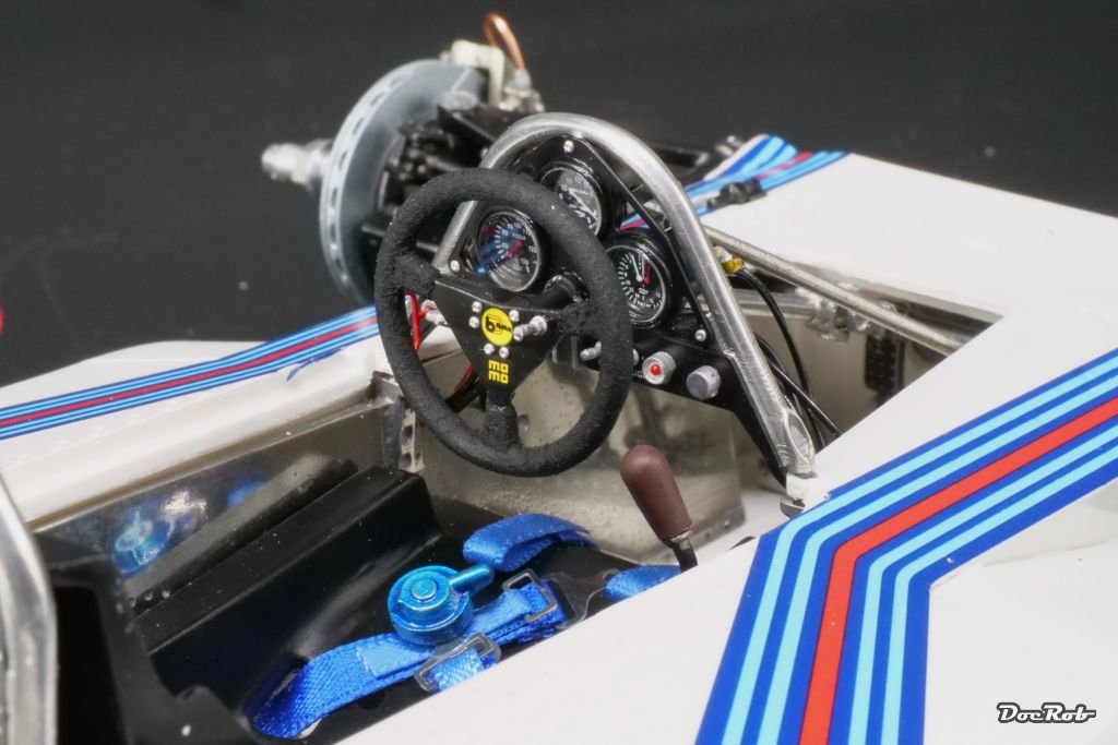

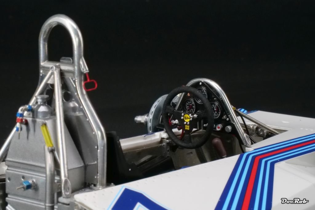

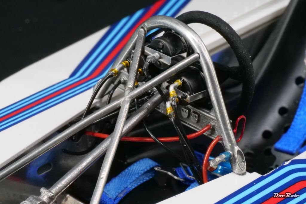

Today, I finished the front office. Before installation, I glued all the tubing and wiring to the backside with CA and let dry. Then I fiddled the steering column with the instrument panel in place and laid the wires in their correct places, a delicate affair.
After adding the x-bar to the instrument panel, I made the final installments to the front side, namely the fire extinguisher pull ring and the steering wheel.
