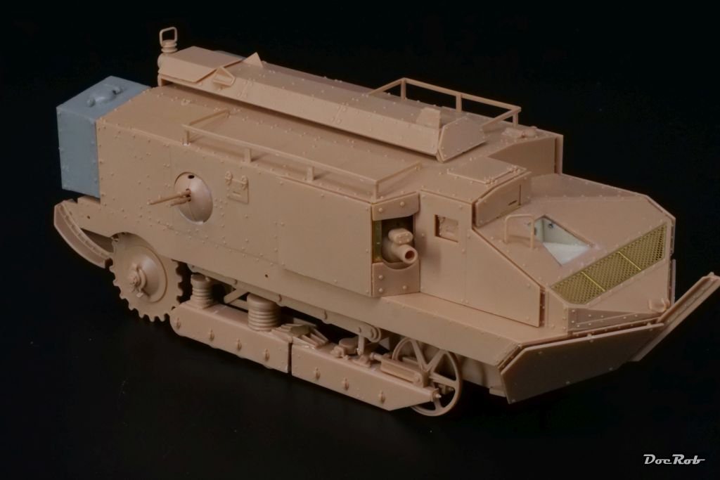

The kit is from Hobby Boss and represents the up armored late model, needed for the FC Model Tips conversion. The kit is of relatively high quality, but some parts could be more refined. Sprue attachment points seem to be placed at random and some parts have prominent parting lines. There are also some errors in the manual and some placements are only shown vaguely. In all, it´s an easy build with a fiddly three piece per link track, which I will substitute with a set of Friul white metal tracks.
The FC Model Tips conversion set contains some resin parts, which address the changes made from the late model, mainly the new rear tanks, a gunport in the front hull section, a manhole cover as extra armor and a few bits and pieces. A decal sheet for all the Spanish tanks is supplied, be it the 1922 Maroc version or the later 1936 Madrid version.
The resin is of relatively bad quality, with imperfections and bubbles and huge cast blocks, but nothing, that couldn´t be overcome.
I have the feeling, this will be a short build log, I´m not used to put something together in only a few hours. I started with the under carriage, which consists on maybe half the parts count. It´s a bit fragile during construction, but in the end, it´s robust enough. Some parts like the coil springs look a bit toyish, but there will be dust and mud, so I didn´t bother. Fit was good, engineering was - hmmh - hobbybossish.
Next was the boxy body, which luckily is build up from a one piece tub. I needed to make some surgery, to add the front gun port, which only had some of the Spanish vehicles. Here the position is shown, clearly measured in the manual.
I added the gun port in front and the huge external tanks at the back. The cabin built up straight forward without issues. In contrast to the early version of the tank, this one was up-armored with additional steel plates, riveted on top of the body.

It seems, FC Model Tips was an earlier incarnation of FC Model Trend. The modification is quite simple, cutting away a trapezoid in the front for the gunport and sawing away the huge cast blocks of the fuel tanks. There is a corrected version of the front grill present as well, but it was not looking good and I opted for the kit supplied PE.

No template Paul, but exact measurements. I transferred some points onto the kit and connected them with a pencil, a sharp blade did the rest.
Today, I finished building the Schneider minus the tracks. Almost everything worked like a breeze and the fit of the body parts was very good. The manual suggests to add the side MG´s with their gun carriage glued to the base of the tub and then add the sidewalls with the fitting hole on. That was somehow impossible to achieve and I suggest to cut away the lower part of the gun carriage and glue the ball mount direct to the side wall hole.
