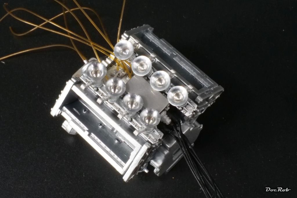

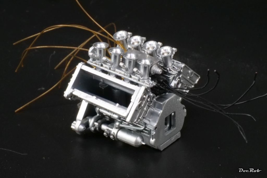

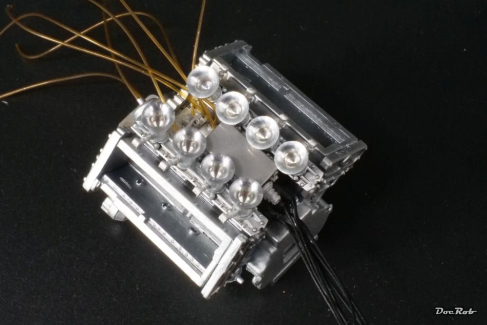

I have seven or eight kits with the legendary Ford / Cosworth DFV engine implemented and this is the firs time I build one. Actually the Lotus 49 was the first car in a long row using this engine, which proved to be the most victorious F1 engine of all time and for years set a kind of standard in F1 racing until it got finally replaced in 1983.
I decided to give the kit engine some extra love and added a MFH set with turned funnels and fuel and ignition distributors. The engine will be very visible, so a bit extra detailing will improve the looks. I glued the yellow transparent fuel lines to the distributor with CA and then did the same with the ignition wiring, made from black 0,4 mm cable. Drilling the numerous 0,4 mm holes was delicate and gluing everything in place after shortening the tubes and wires will be equally difficult.

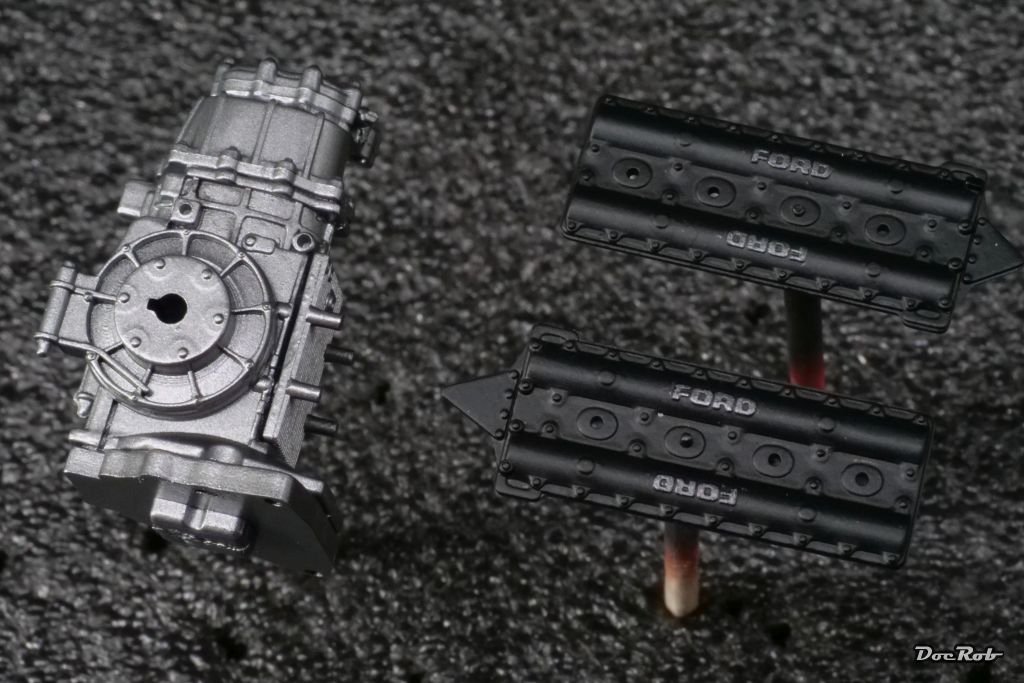

I also assembled the gear box and sprayed it gun metal. I decided against the texturized color from Zero paints for that task, because I think in 1/20 scale the texture might be a tad too much.
The valve covers were sprayed firs aluminum, followed by semi mate black, which I planned to carefully erase with a toothpick on the Ford logos. It didn´t work that way, so out with the AK Aluminum pencil, which also wasn´t successful due to the grainy application. It had to be the good old soft pencil, not perfect, but good enough for me.
Engine tubes and wiring aren’t the most fun part of a build, but the results are *so* worth it!
I’m loving this so far 🙏
You are right, it´s a demanding task, but very rewarding as well. Sometimes, it is a bit like meditation, until a drill bit breaks and sticks into the white metal part :D. I guess, you know both kinds of feelings with your fine plumbing on the P47´s landing gear.

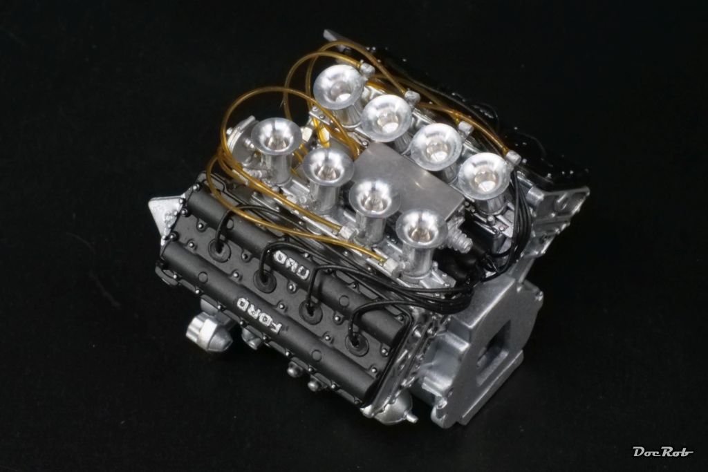

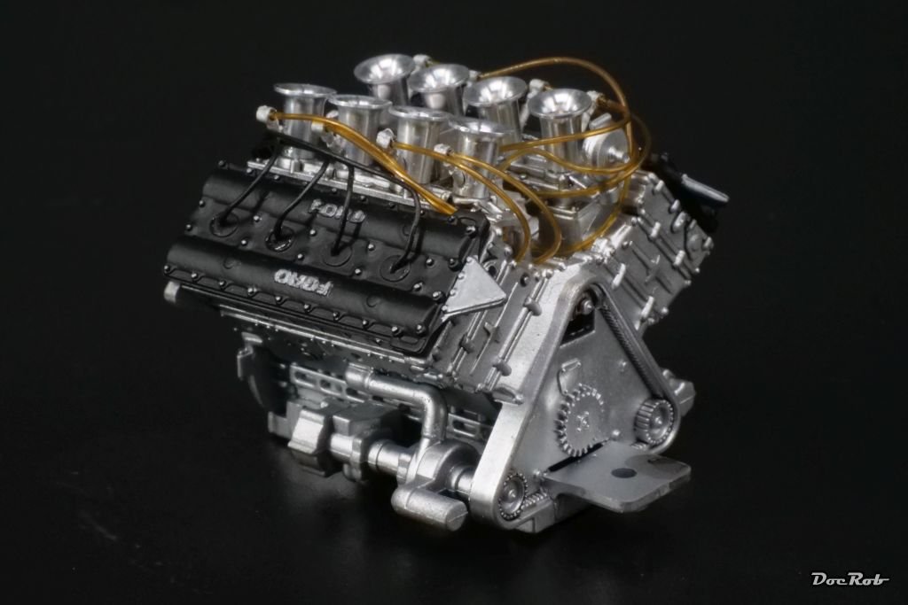

Finally, I got the wild hairdo of the engine straightened out. I combed and parted the fuel lines and ignition wires and glued them into place with CA. It wasn´t that terrible a task than thought, but needed a steady hand.
My hand was less steady, when I tried to refine the Ford brandings with a brush and paint. I will rework it, when I have a completely unmoving hand, but today, I exhausted myself with swimming and running, not the best combo for painting these only slightly protruding buggers.
The worst about macro photos, you can´t hide anything, the engine is tiny and looks better to the real eye.
I was going to ask why ford positioned their logo upside-down, then I saw that it was on both sides, so could be read either way.
obviously I need more coffee this morning 🤣🤷‍♂️🤦‍♂️😂
At least, you identified it as a Ford branding, so there is hope for my meagre painting skills with that logo :D.

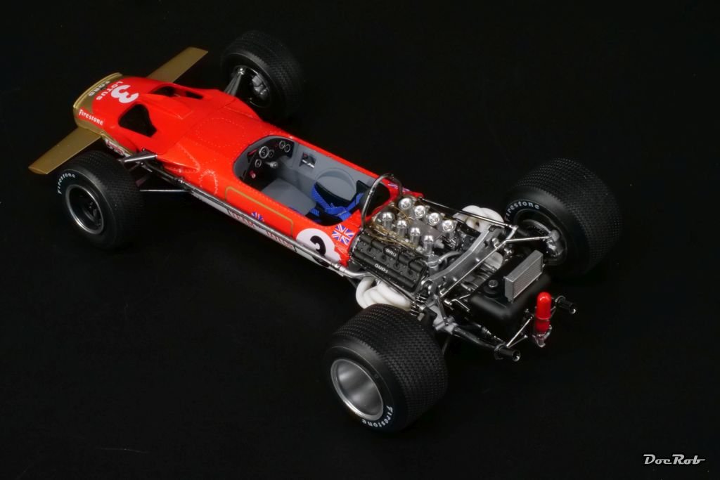

A lot is going on lately, not modeling wise, unfortunately, but I´m still onto the Lotus 49. Everything is prepared and painted and waiting to be assembled.
The kit is a VERY mixed bag, quality wise. Some engineering is fantastic and you need no glue to assemble, others areas are downright terrible, specially where the pre chromed parts come into play. I de-chromed the sprues with oven cleaner, because the detail looked soft. Unfortunately it wasn´t the chrome, the plastic got covered in a layer which looks like clear resin as a base for the chrome and this is not removable. It´s also impossible to glue the de-chromed parts with plastic glue, they call for CA. I had to drill most of the holes on the back end out, they were simply to narrow.

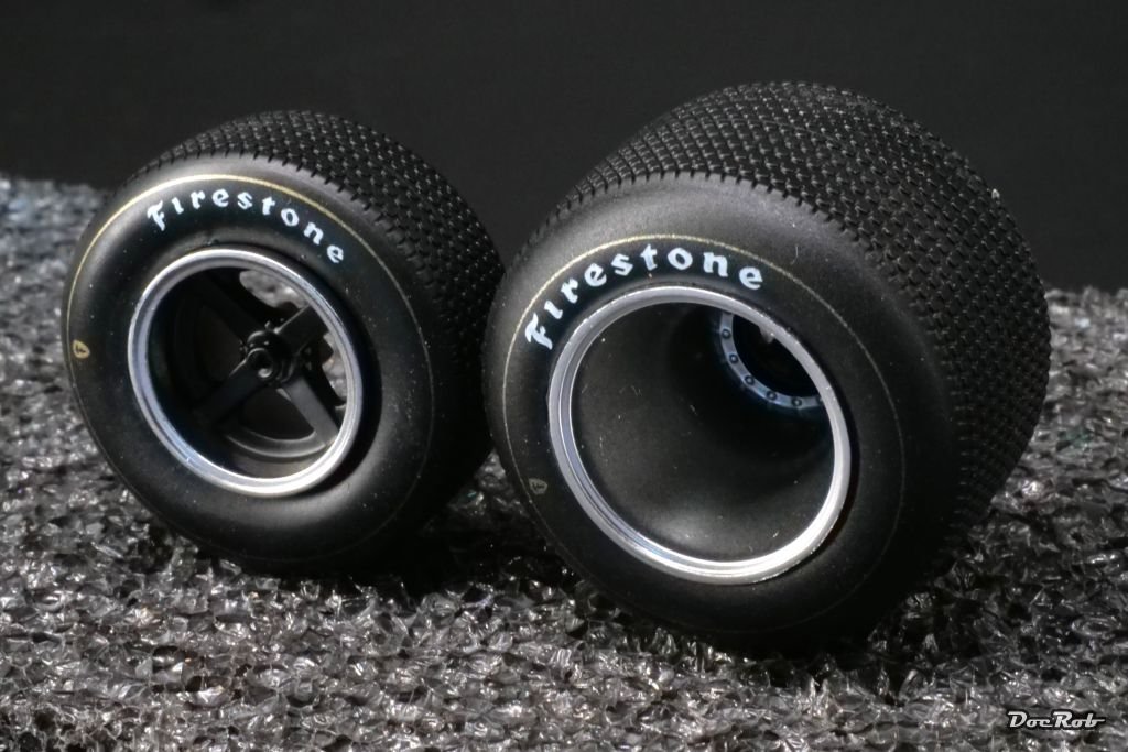

One of the best aspects of the kit are the pre-printed tires, an approach, I wish other companies would copy. The rims were sprayed polished aluminum and semi gloss black, as the chrome looked wrong.

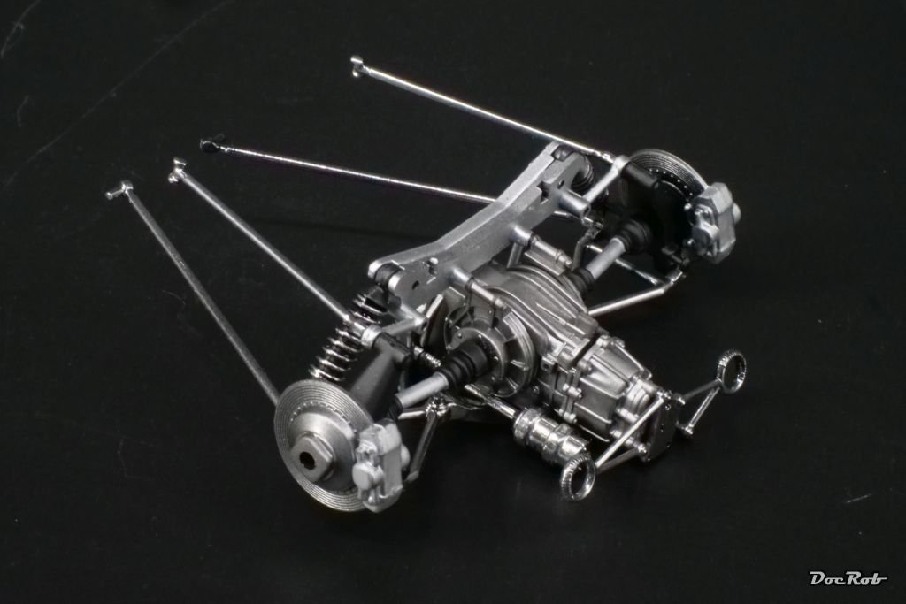

I assembled the gearbox with the rear suspension, an area, where there is great engineering, intersecting the parts with almost no need for glue.

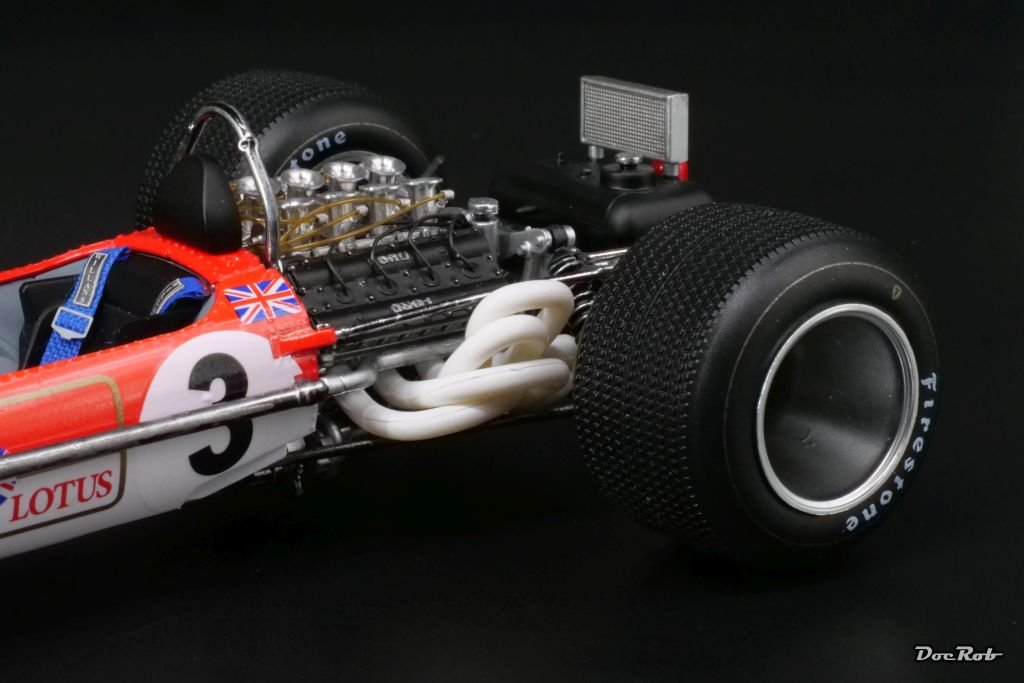

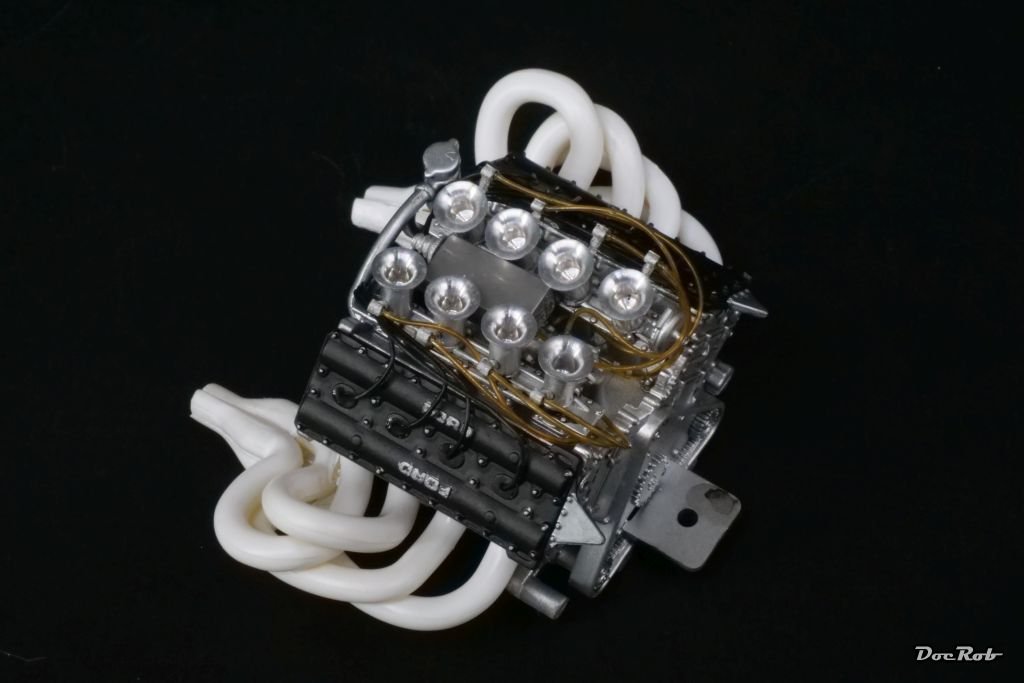

One of the worst area of the kit were the exhausts, which were chromed, albeit they need to be painted black or white, depending the car you show. The de-chromed plastic doesn´t take paint well and need CA to glue, not easy, when you assemble the four parts per side with only seconds to fit them to the engine case, moving and wiggling the fragile parts.

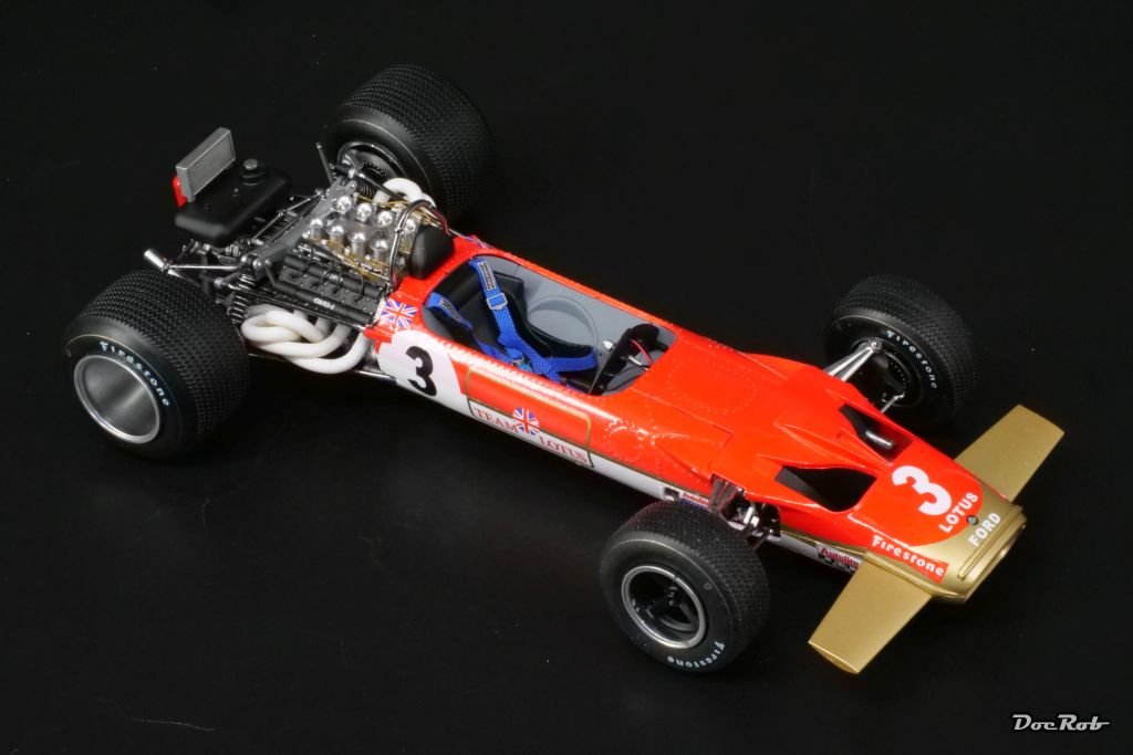

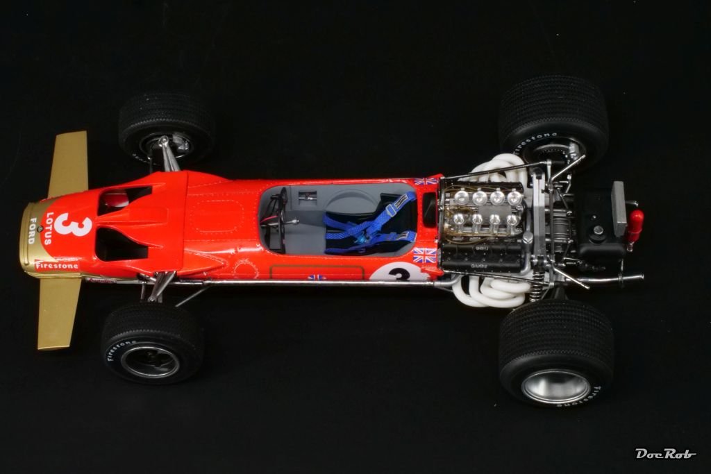

Almost done, the Lotus and my nerves. Assembly is very difficult due to fit issues and the complexity of the car itself. There were the exhausts with a special PITA award mentioning. I had to break them from the engine, because it would have been impossible to install the four chromed rods, connecting the body with the rear suspension. I had to shave off a lot of the exhausts undersides to fiddle them in and glue them in place.
