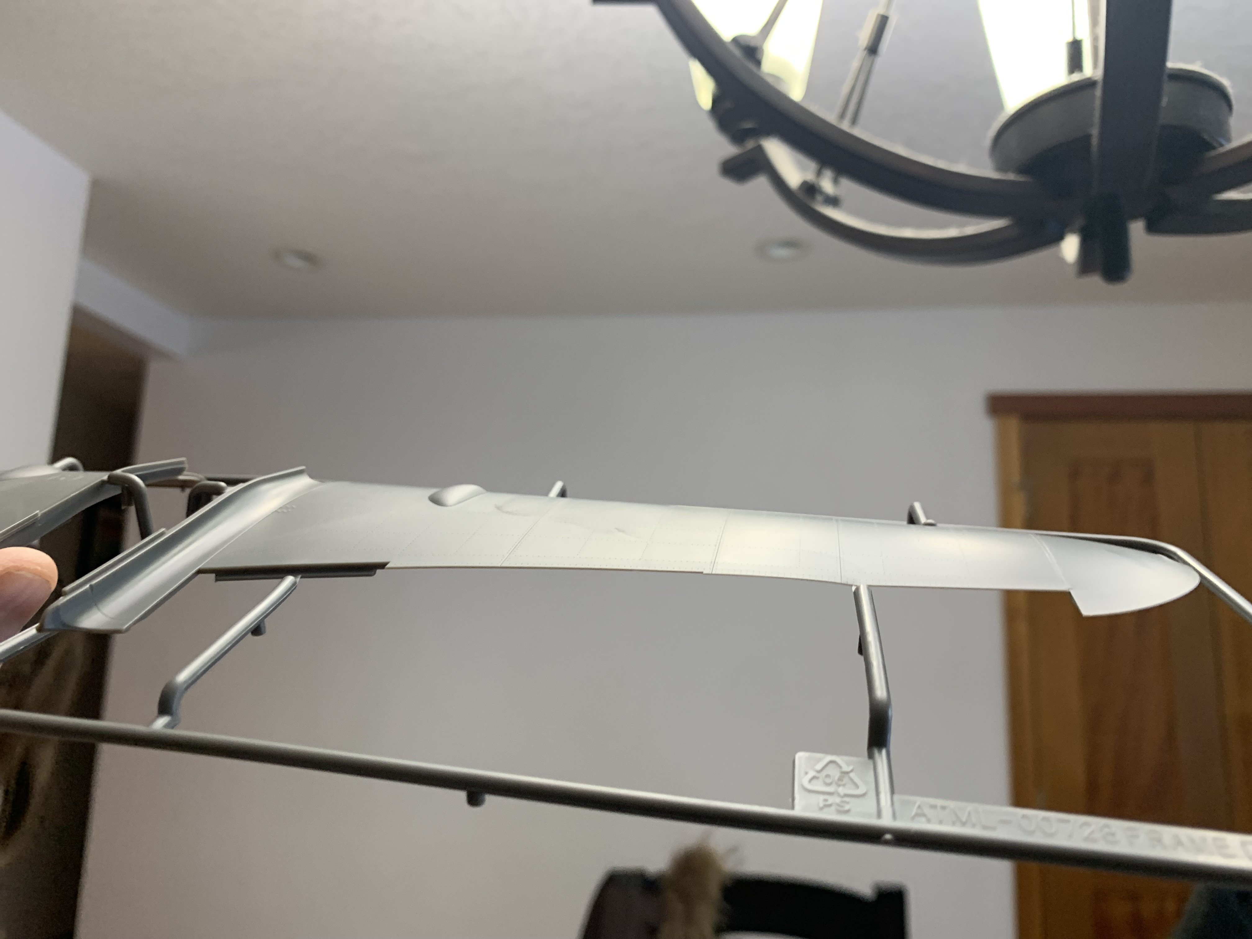

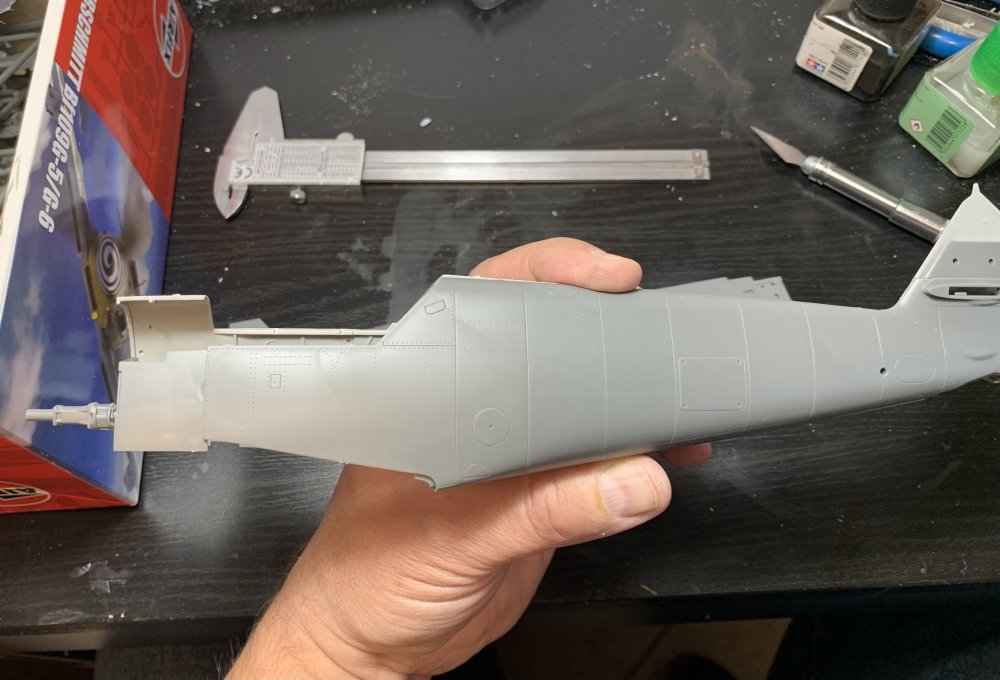

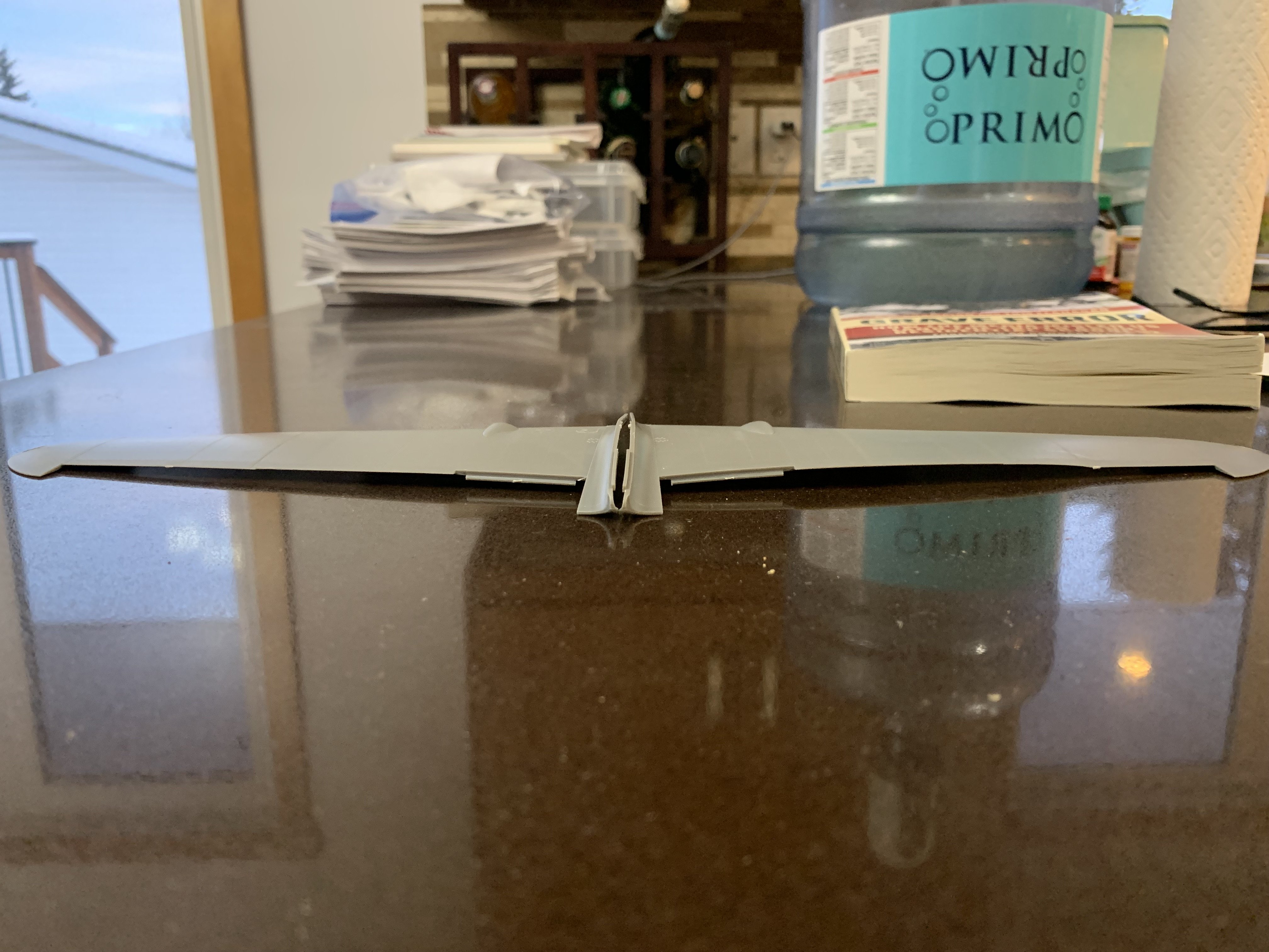

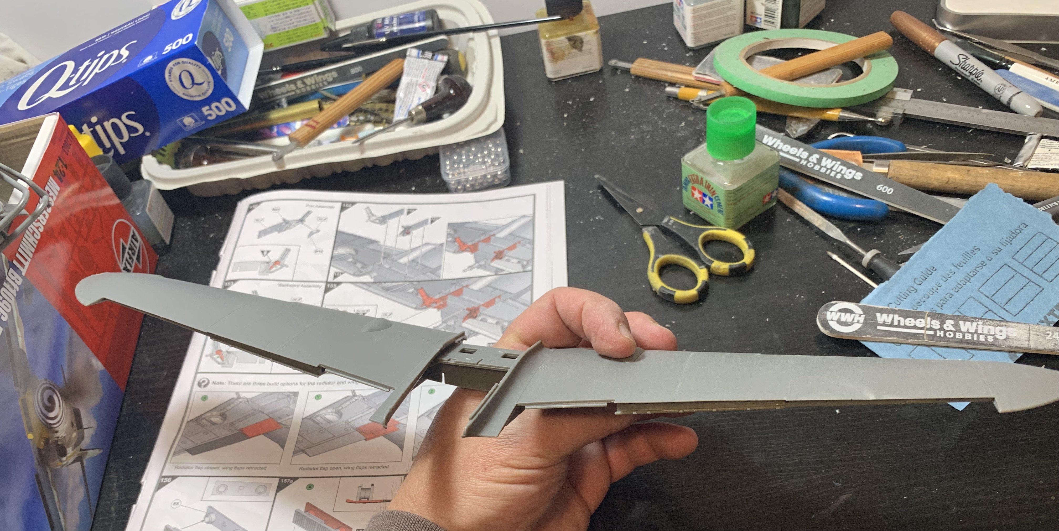

Martinnfb Posted Thursday at 02:43 PM Posted Thursday at 02:43 PM I couldn't help myself and opened the box to see how badly are my wings warped. It wasn't that bad , it actually straightened itself upon assembly. 6 1

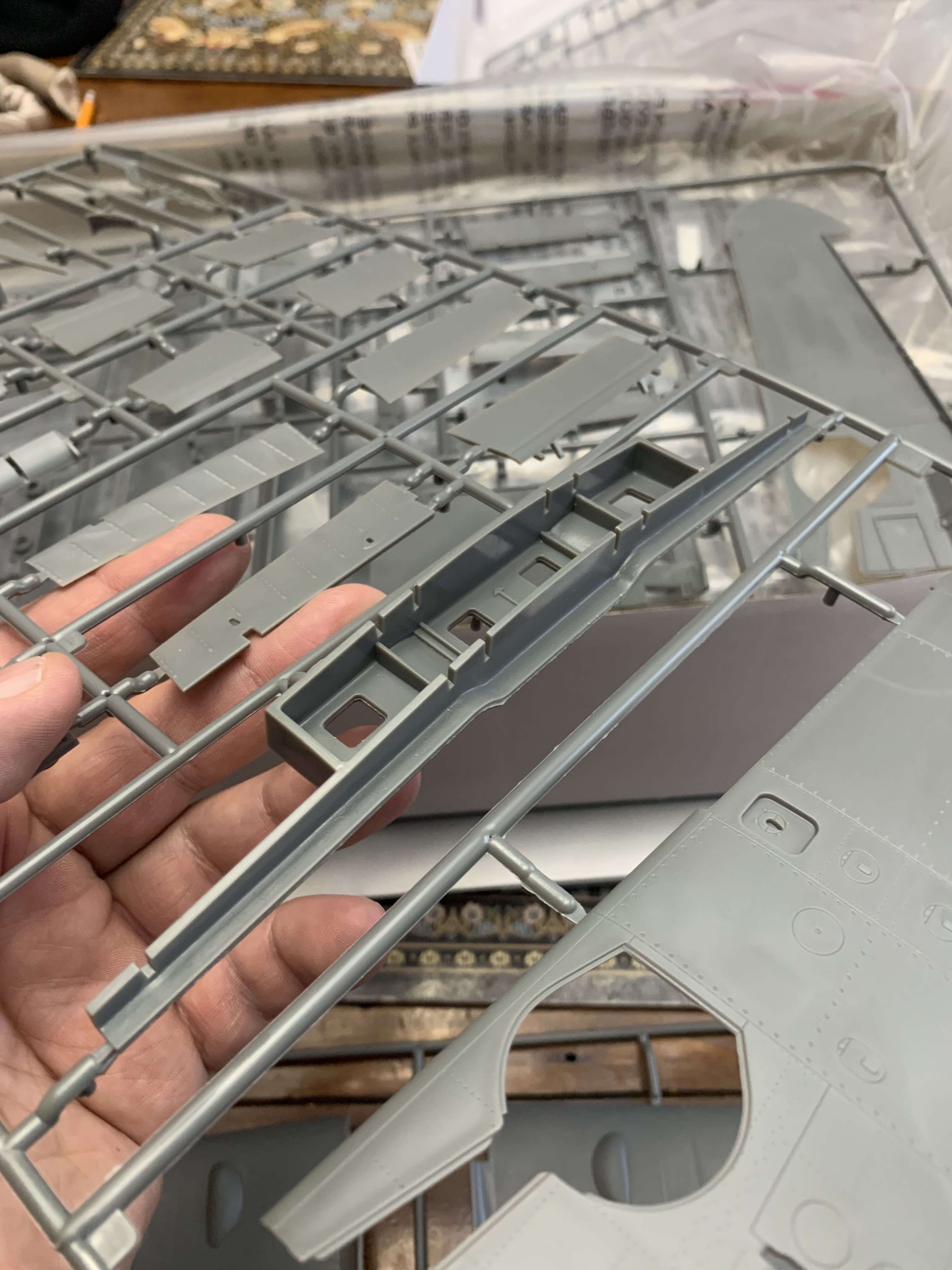

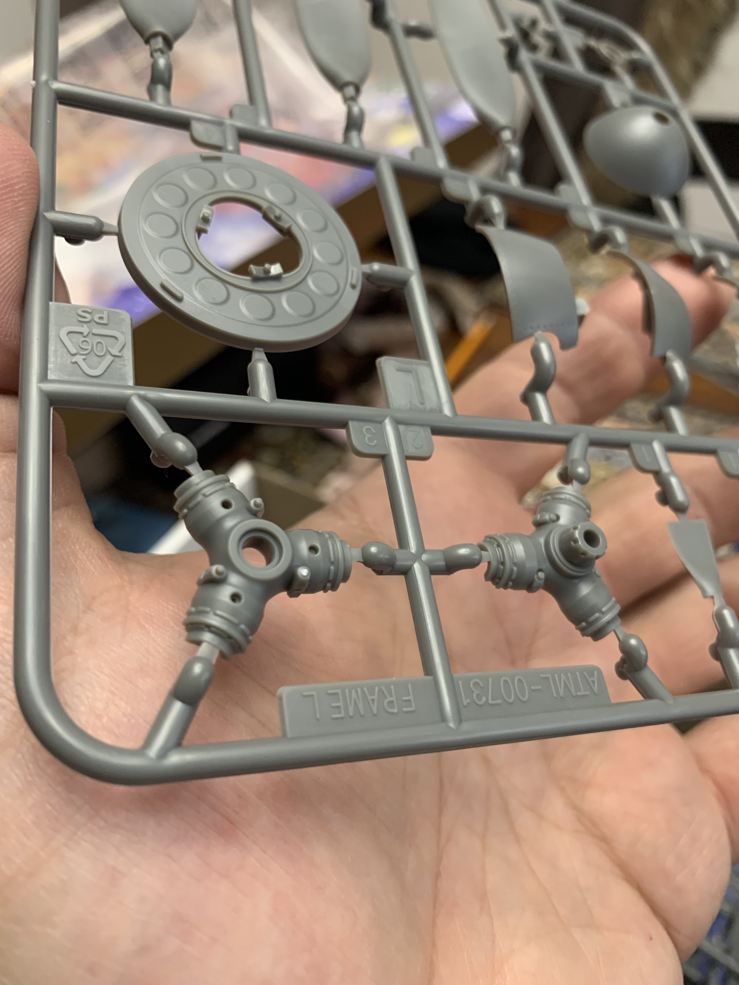

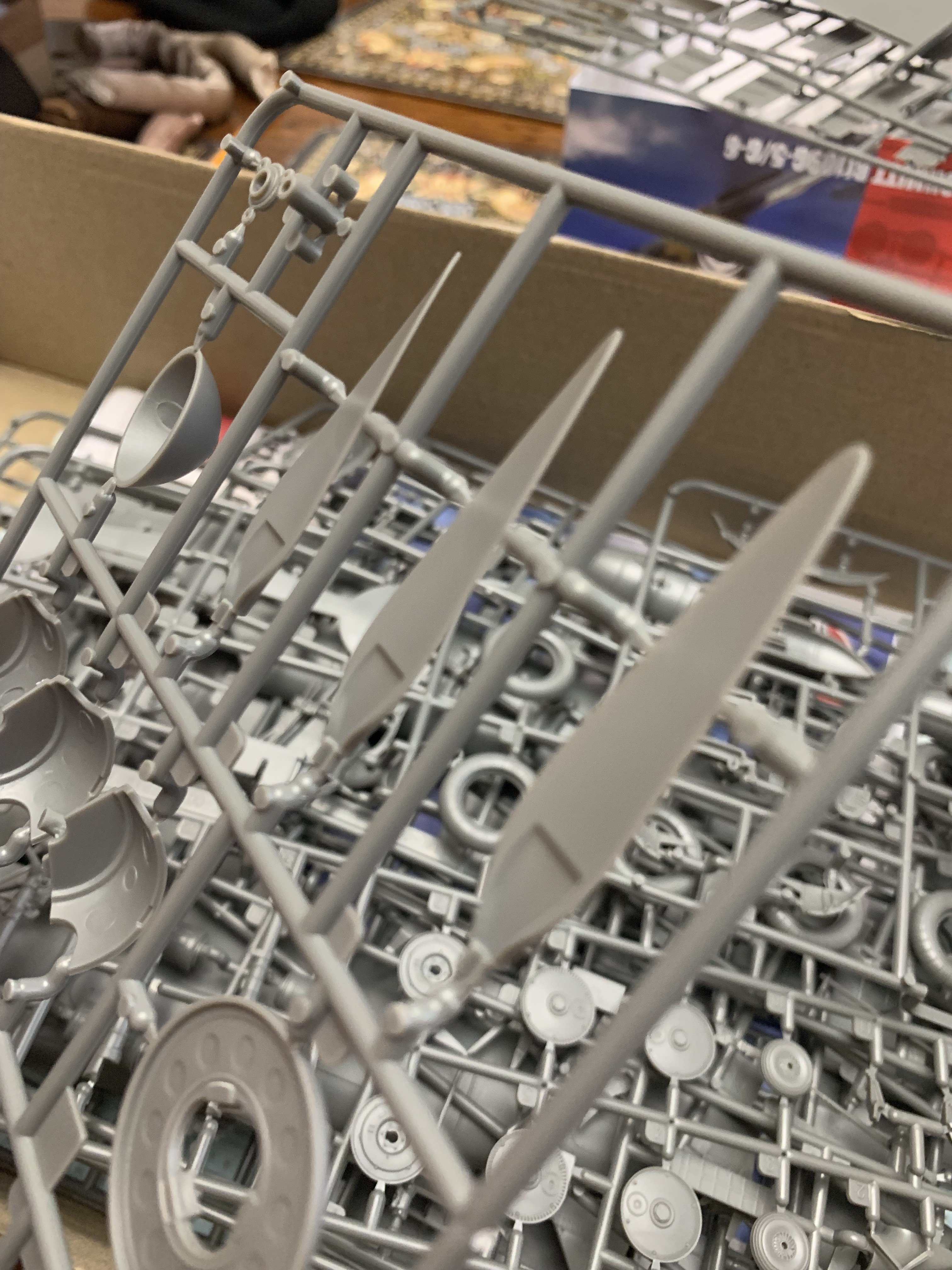

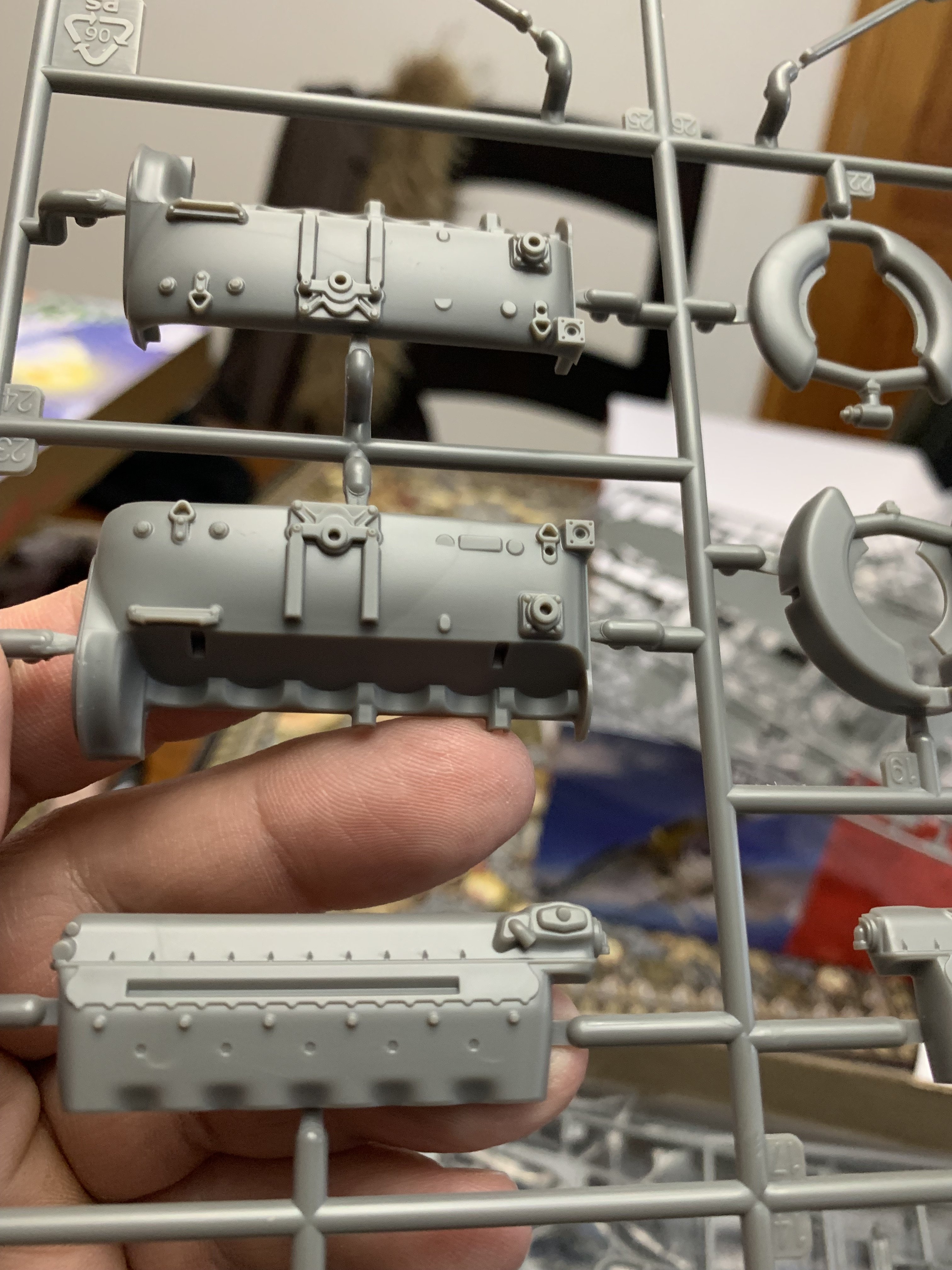

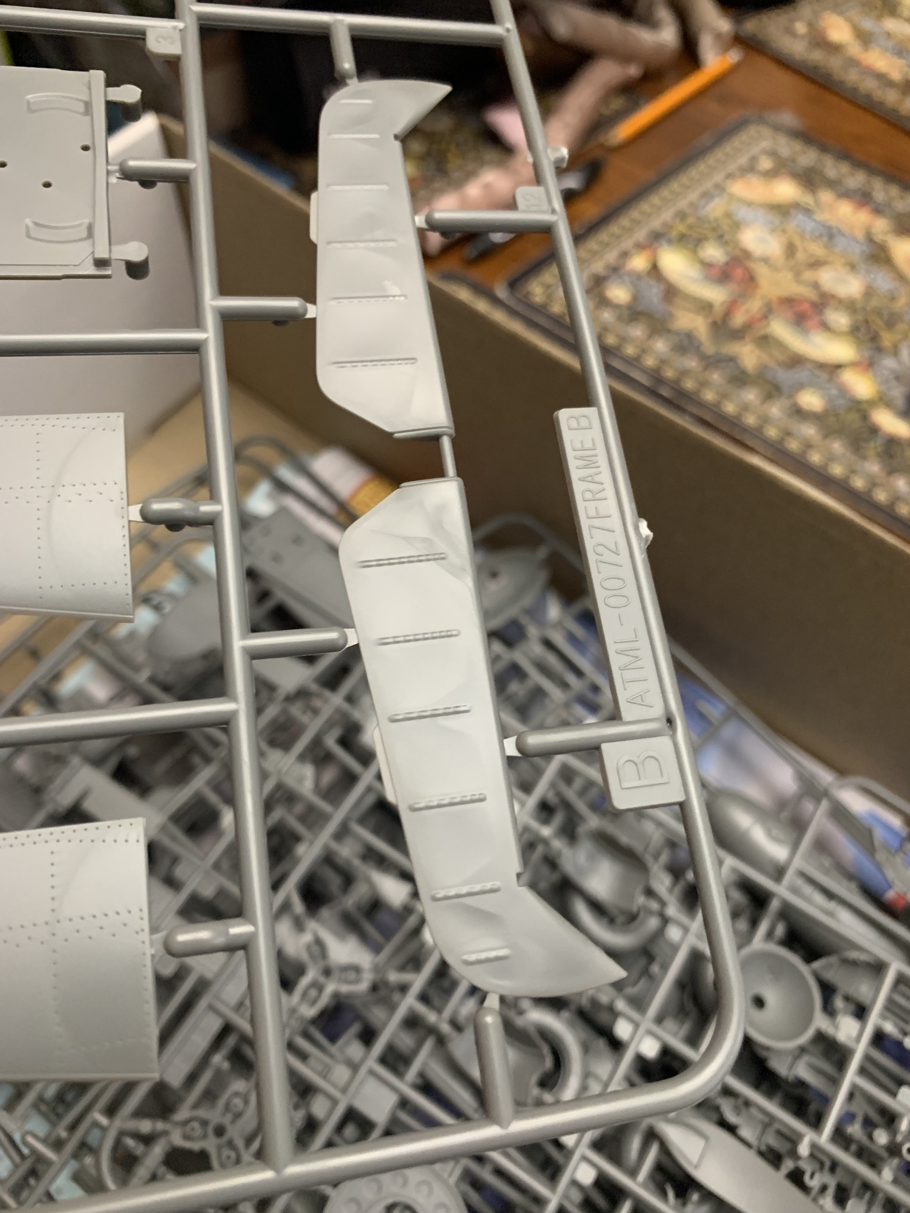

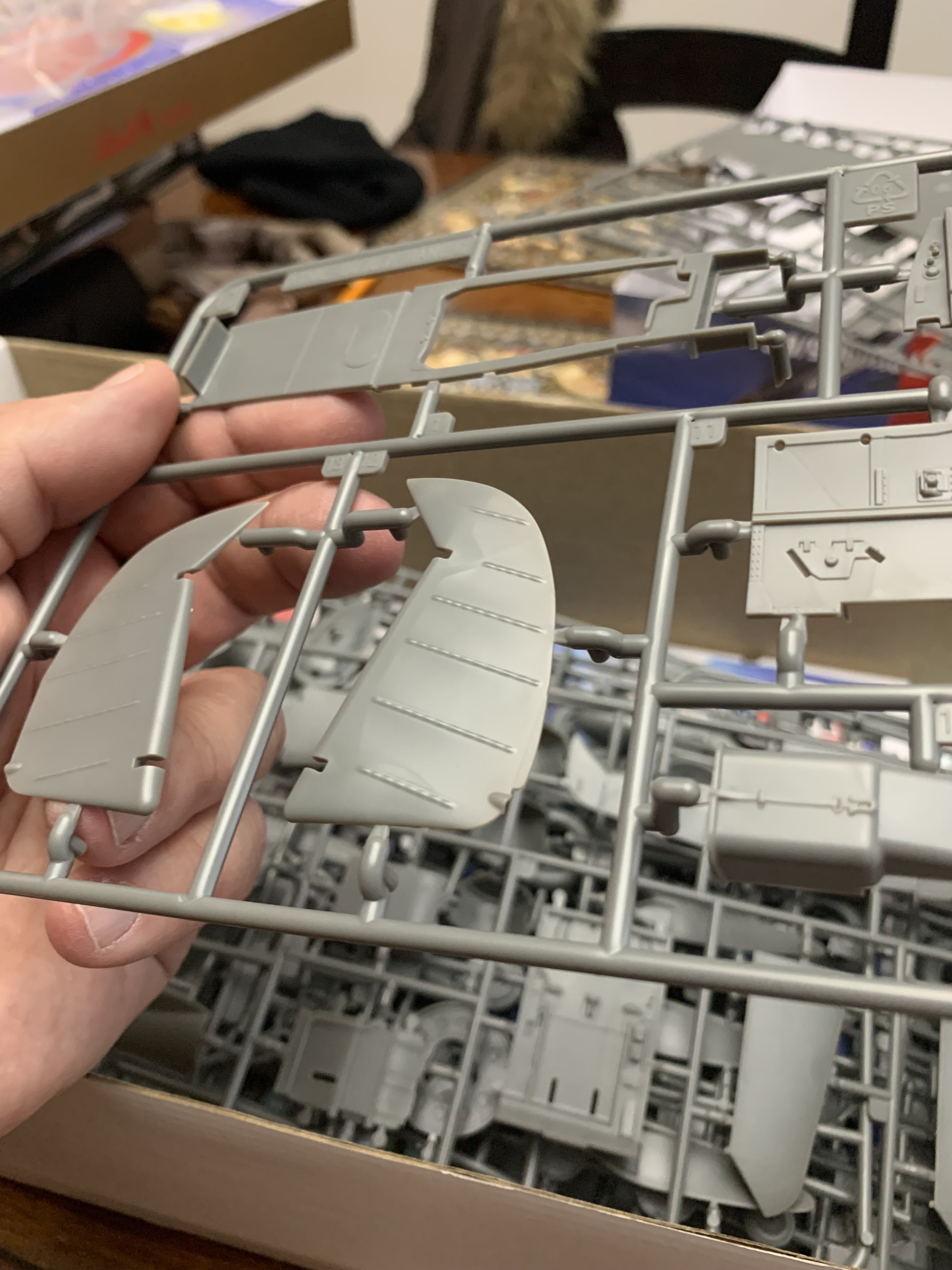

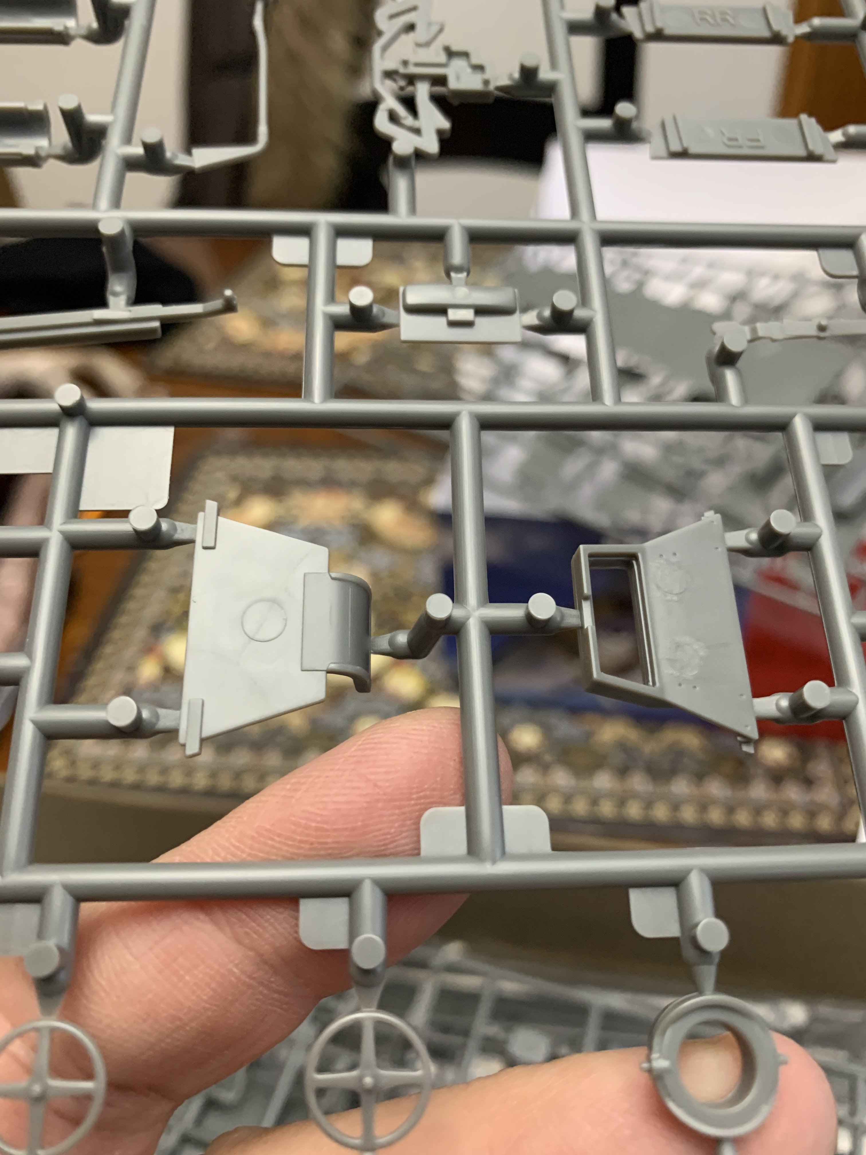

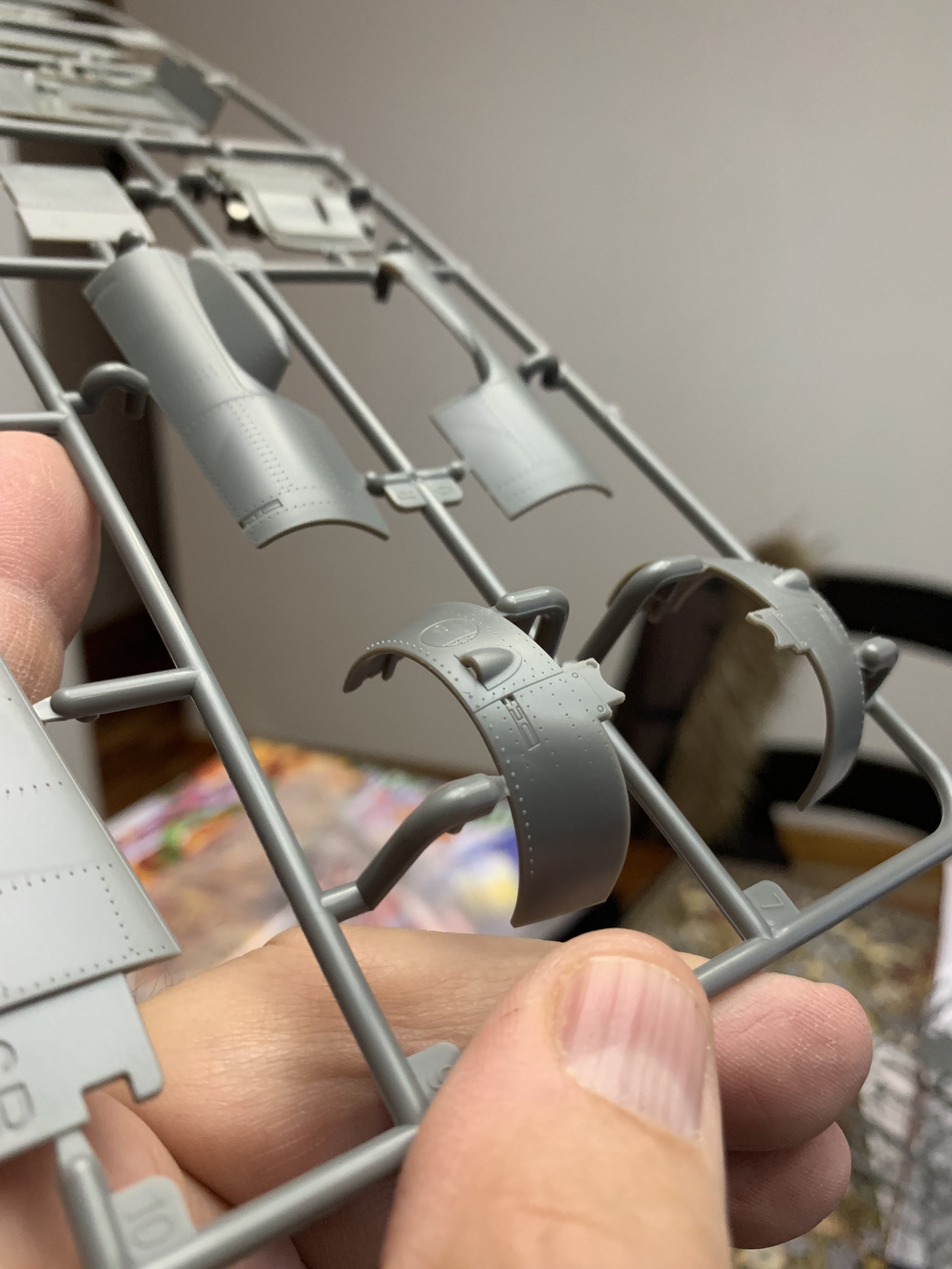

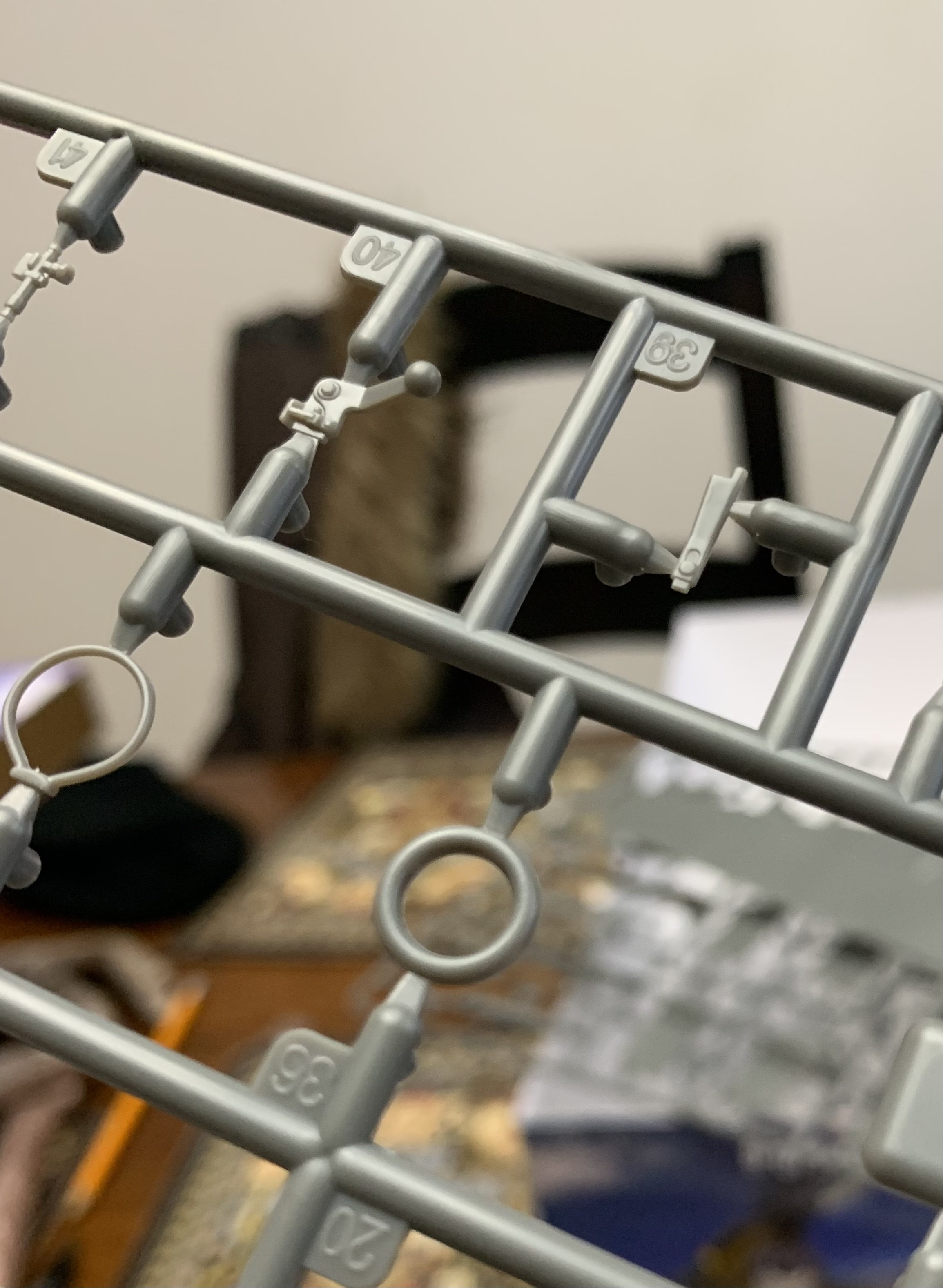

Martinnfb Posted Thursday at 02:49 PM Author Posted Thursday at 02:49 PM You might wanna see some of the parts. The detail is exquisite out of the box. The ejection port marks on the headrest are easy to be sanded off. 7

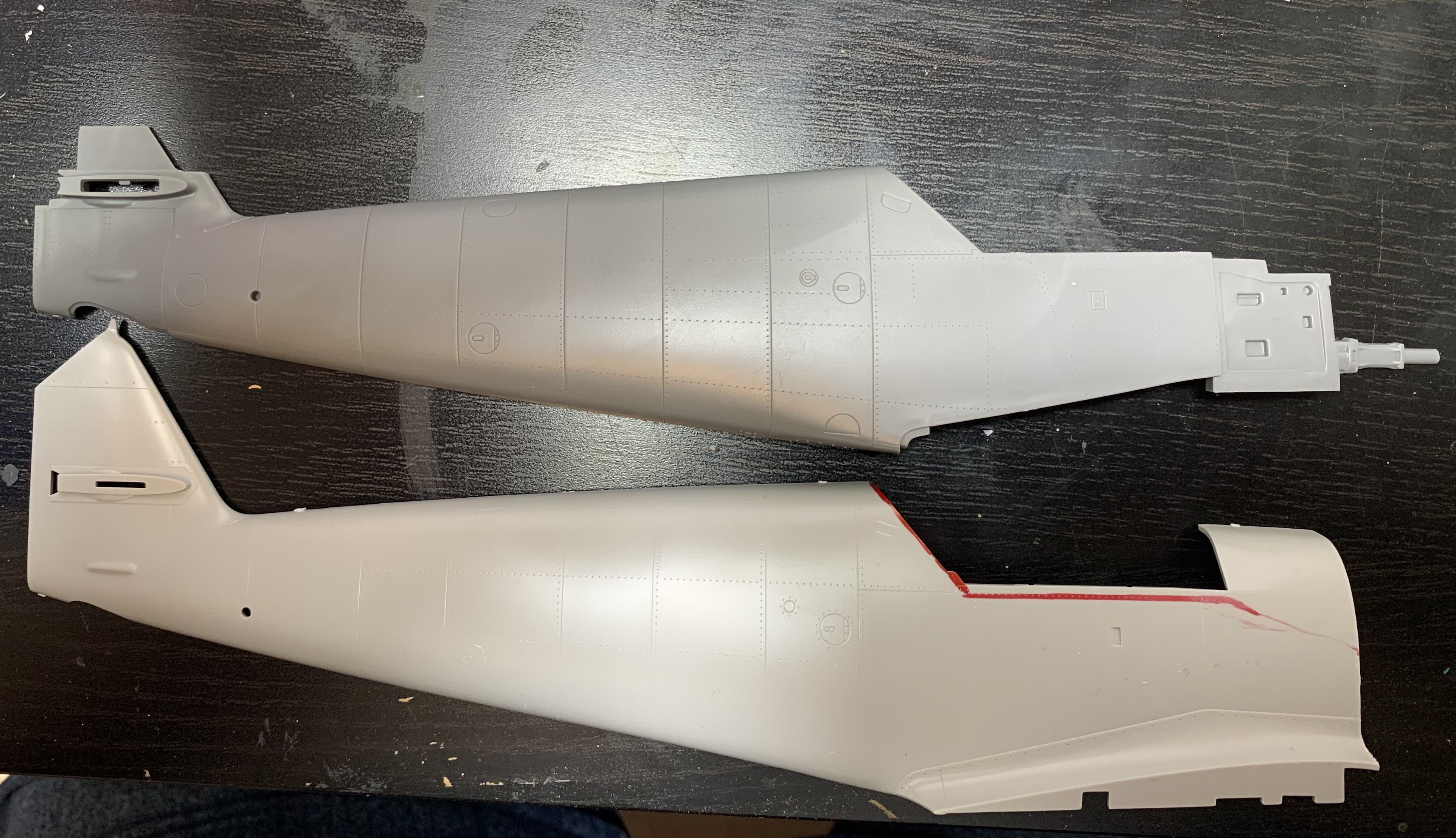

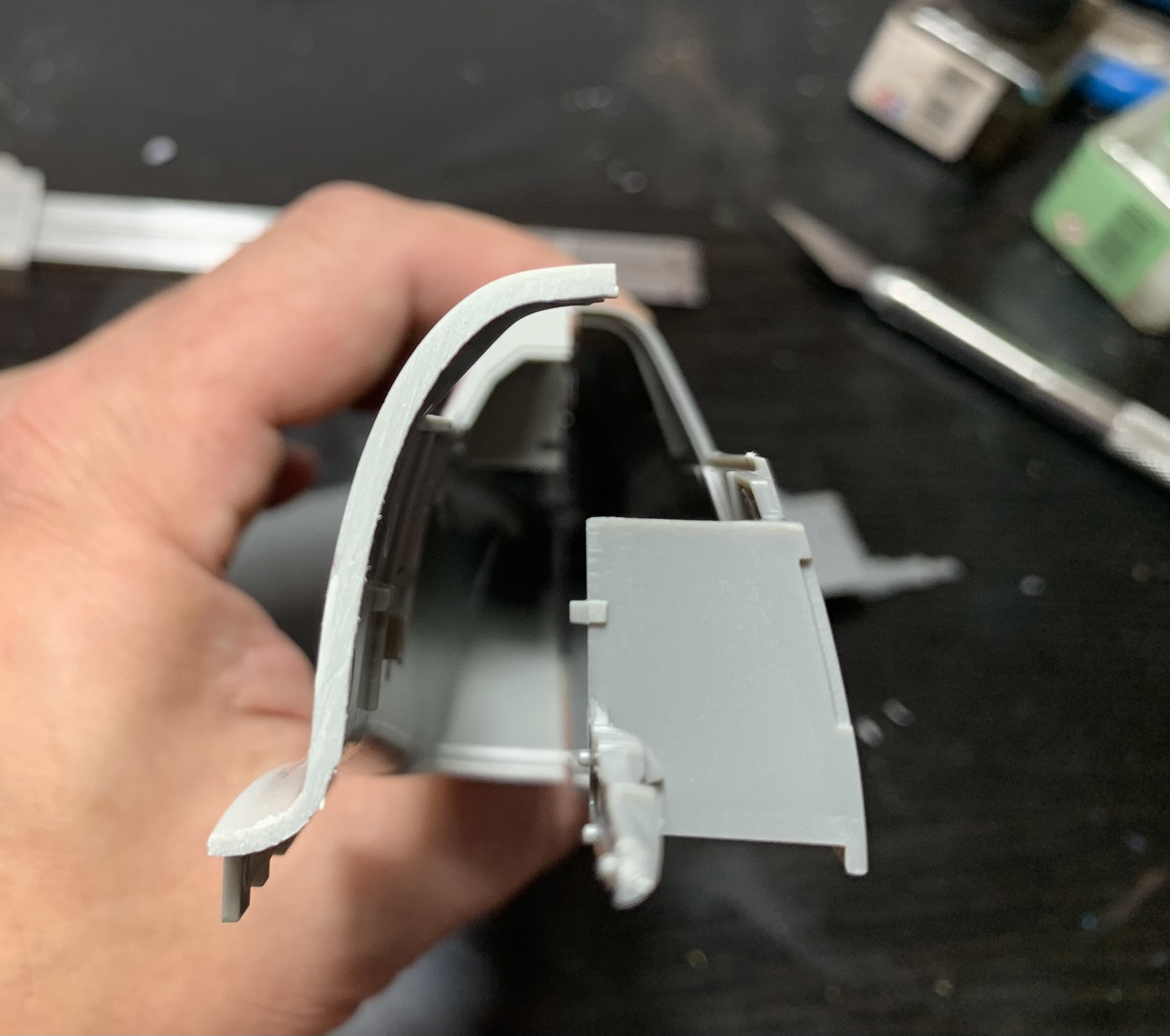

Martinnfb Posted Thursday at 05:13 PM Author Posted Thursday at 05:13 PM A quick comparison with the Trumpeter’s G6. You can see how the fuselage on TRP kit had distorted height in attempt to compensate for high power plant thrust line. this is hard to catch , but once you see it…. 5 1

belugawhaleman Posted Thursday at 06:02 PM Posted Thursday at 06:02 PM Looks like a great kit. One thing, however, it sounds like you were expecting the wings to be warped......is this a problem with these kits? 2

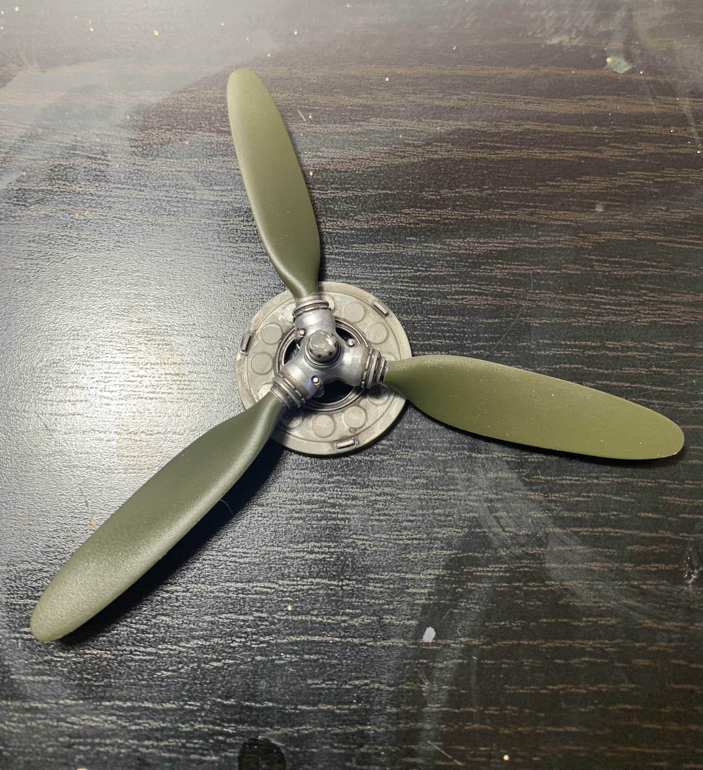

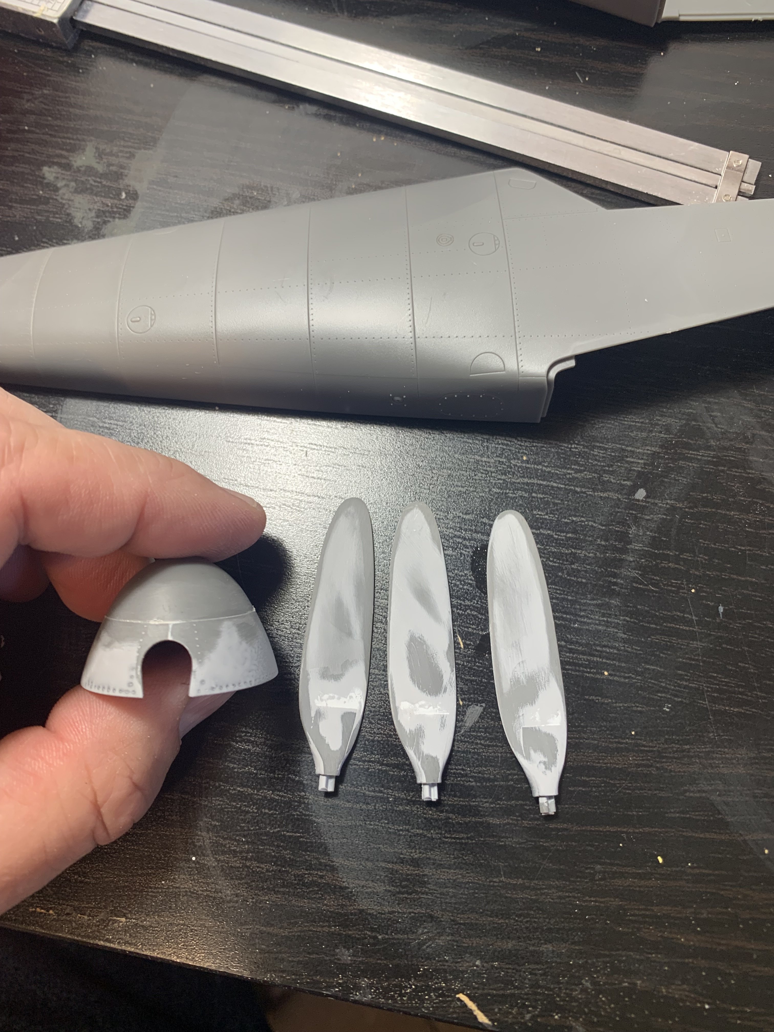

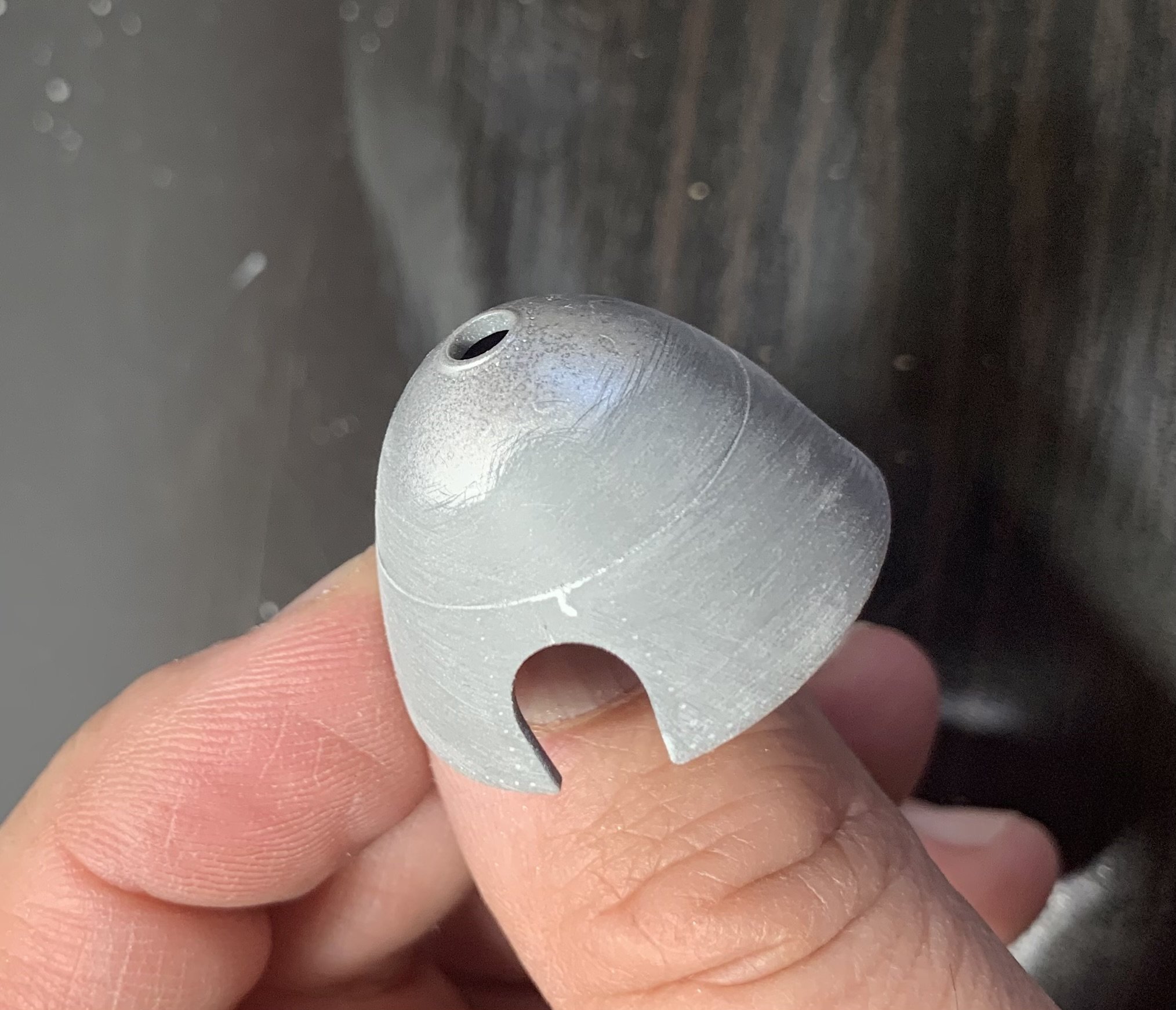

Martinnfb Posted Thursday at 08:21 PM Author Posted Thursday at 08:21 PM Yes, It seems to be a common issue. However once assembled, the wing is straight. So , not much of an issue. propeller blades need some putty which is ok. However the spinner lost some detail while being sanded smooth. 5 1

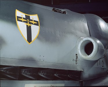

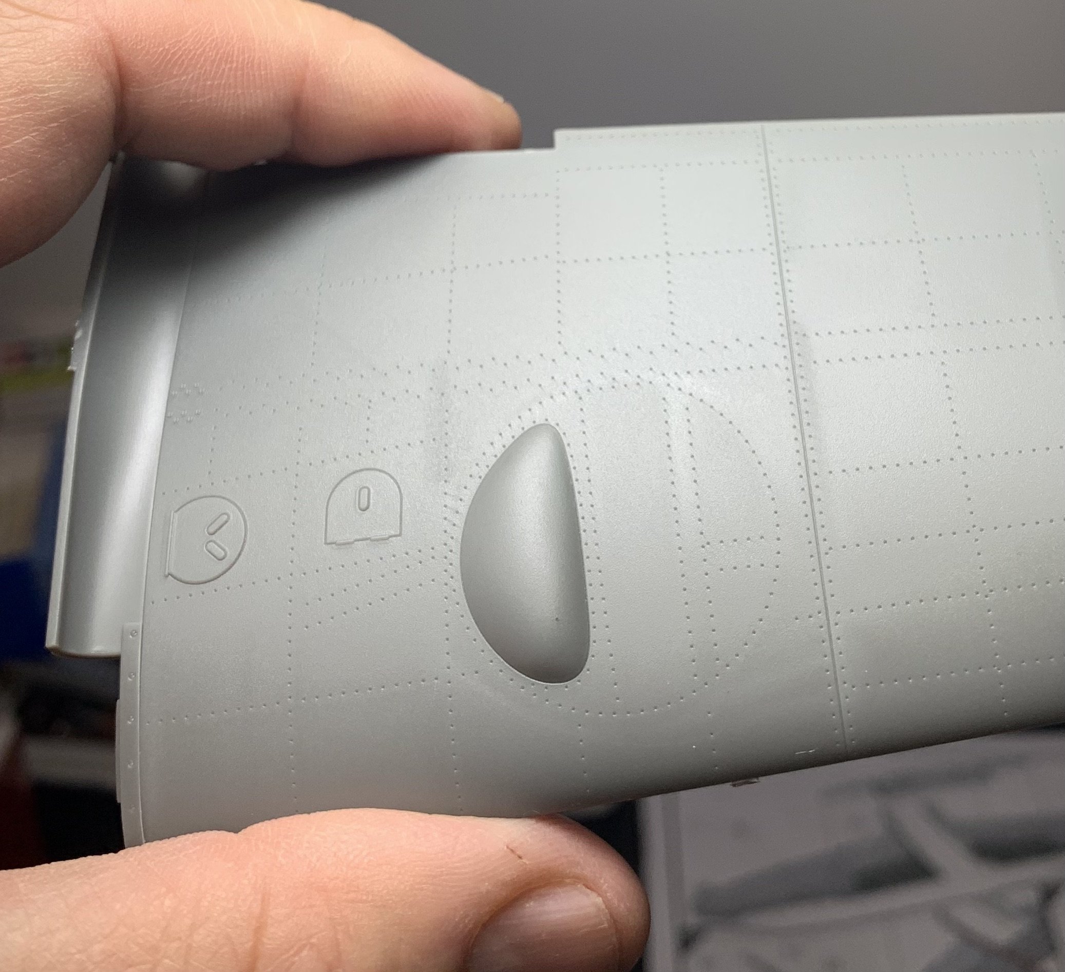

Martinnfb Posted Thursday at 08:29 PM Author Posted Thursday at 08:29 PM One wee detail that was omitted are tropical filter mounting holes. 4

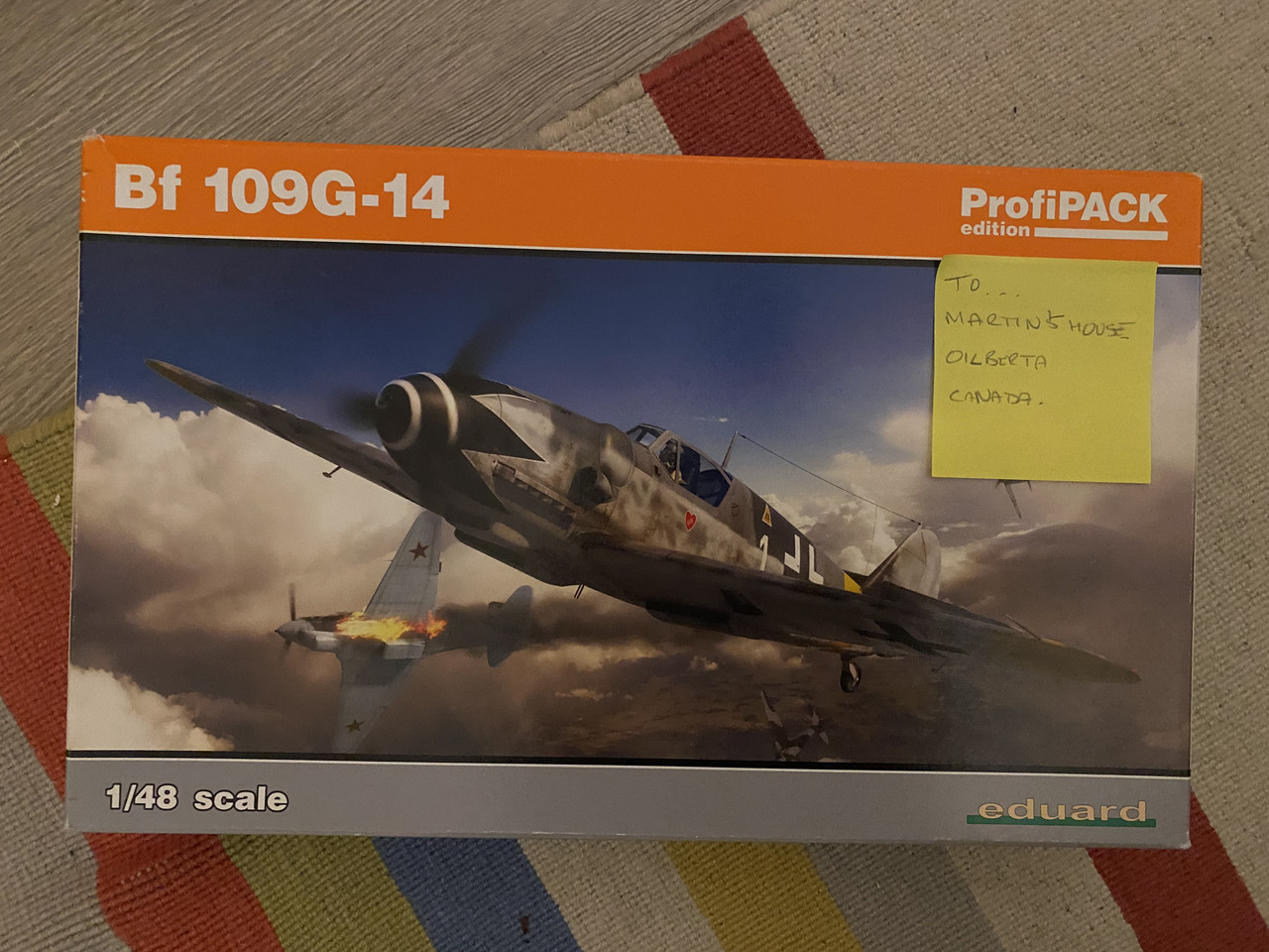

PanzerWomble Posted Thursday at 09:29 PM Posted Thursday at 09:29 PM Look , I'll send you this from my stash ....half the size, twice the part count , masks , PE , proper styrene , zero warpage...20x more fun . Just need ya ZIP code 😀 It's even got "those" tail markings on the decal sheet. 1 3

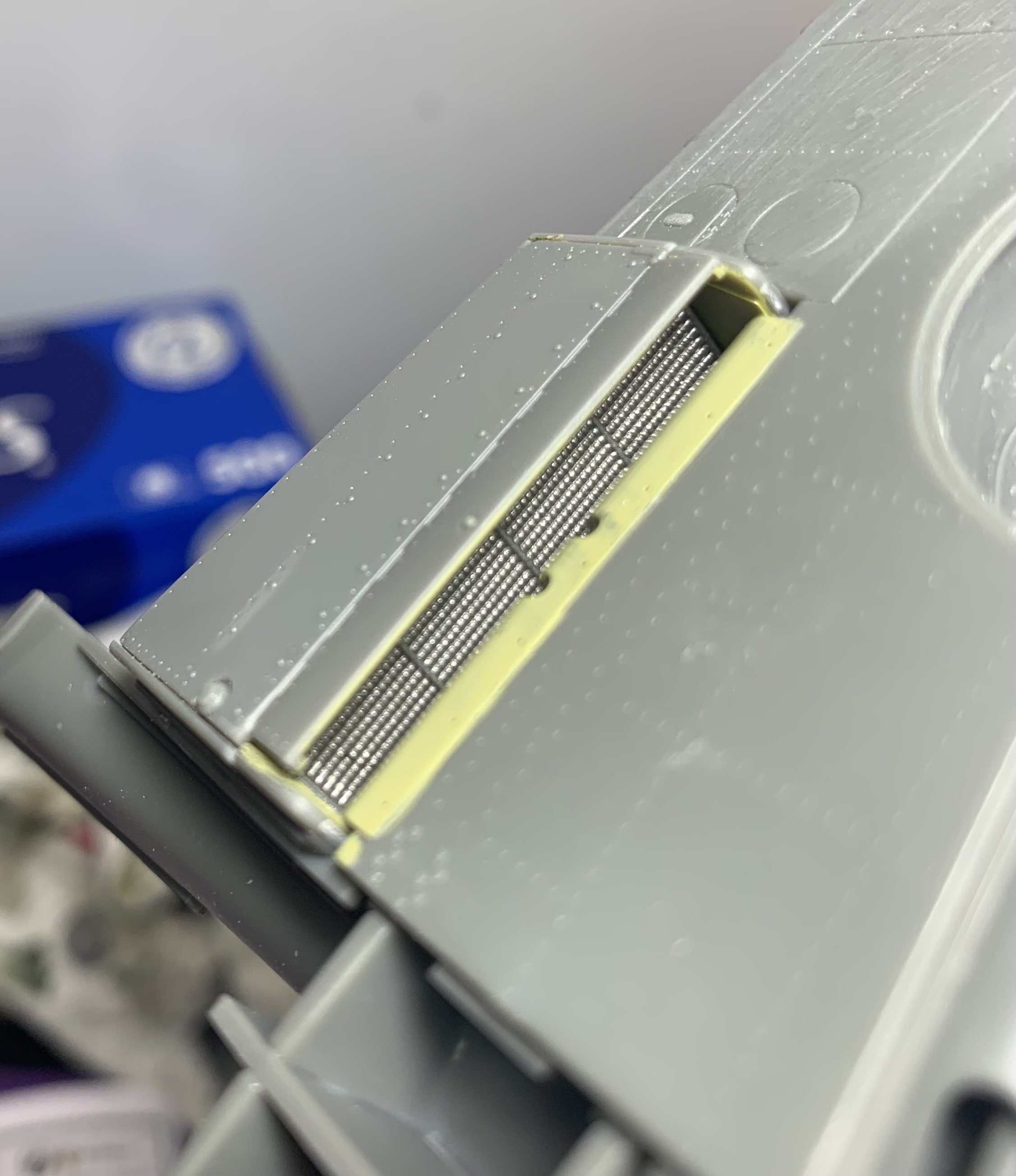

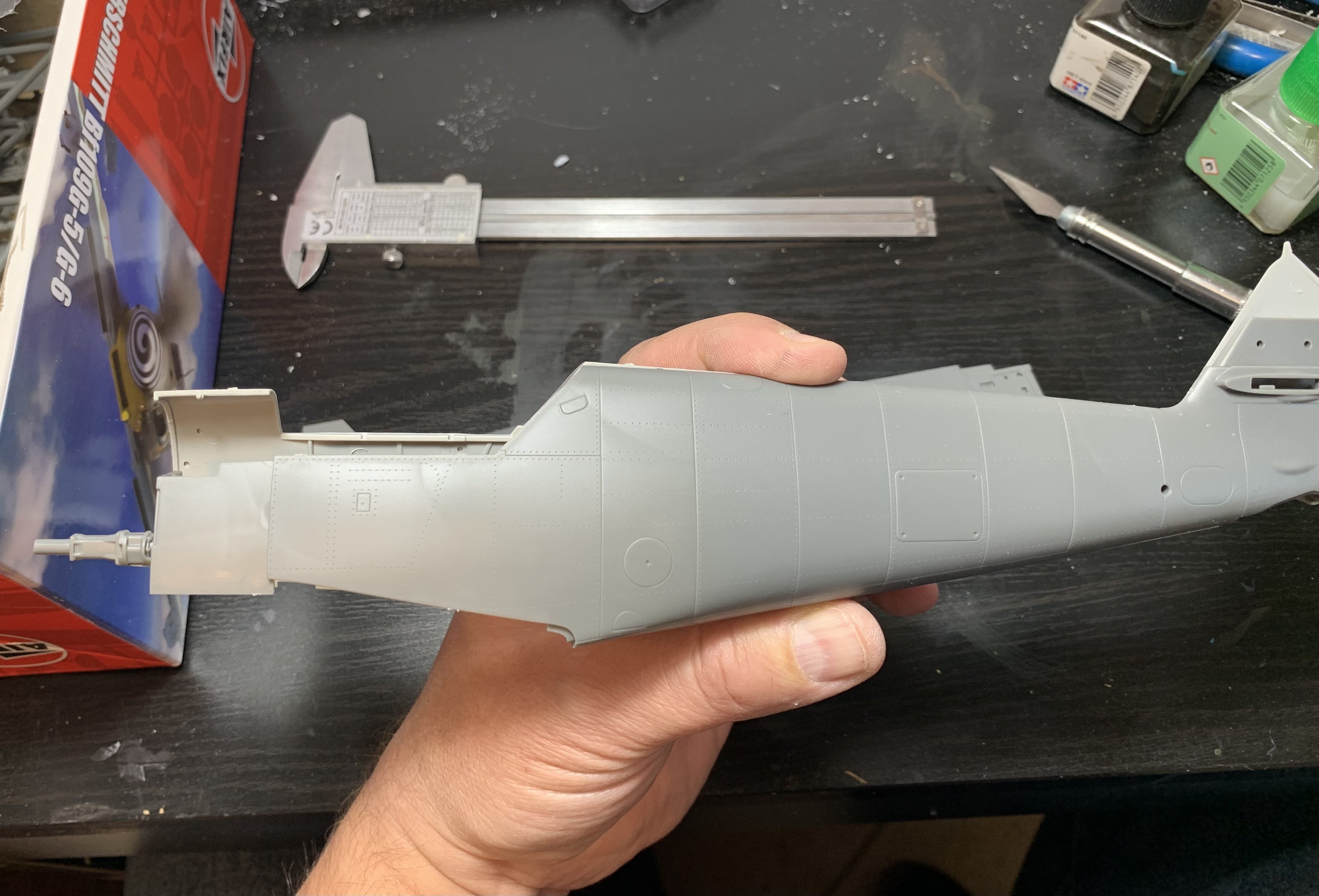

Martinnfb Posted Thursday at 10:02 PM Author Posted Thursday at 10:02 PM Thou shall see no squirrels! radiators are in, the flap actuators are not there yet simse I had to push the assemblies together quite a bit 5

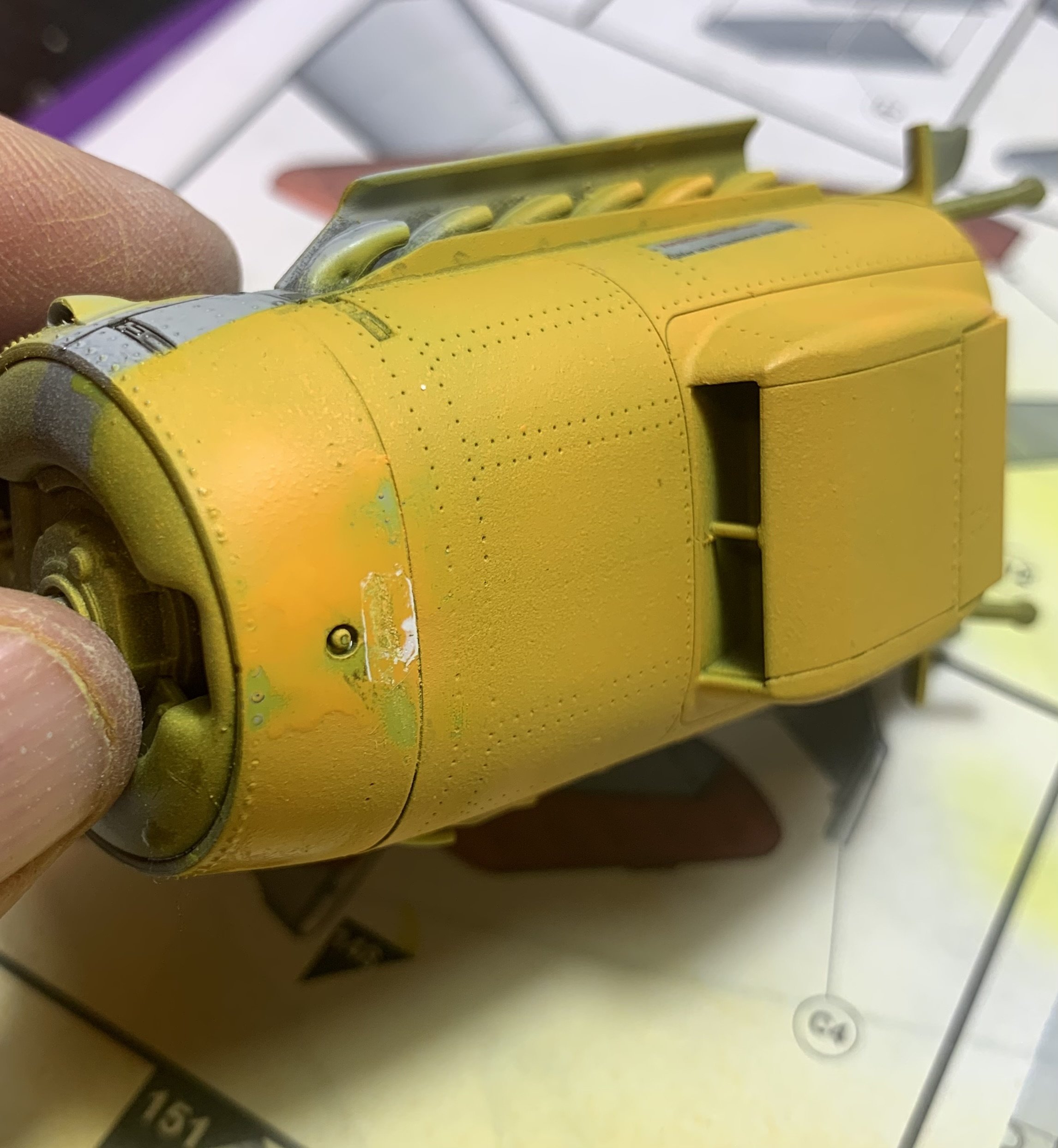

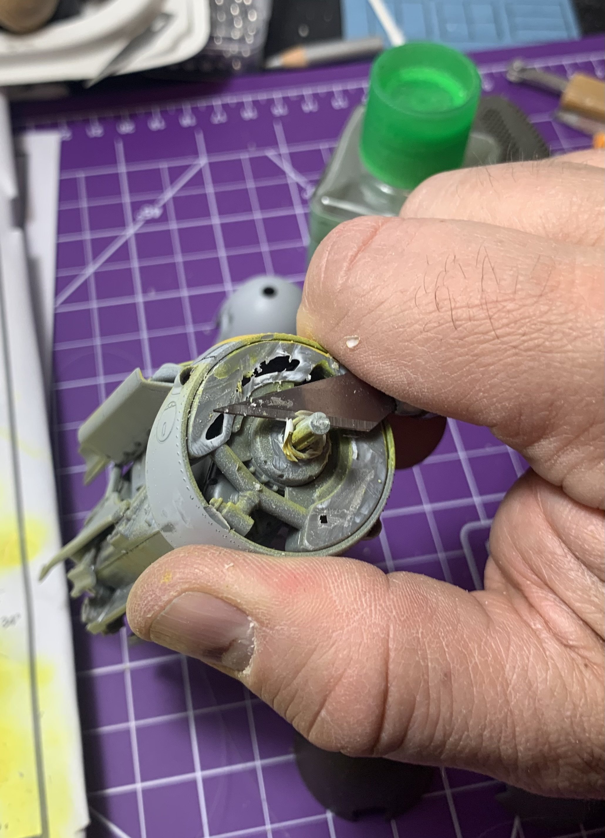

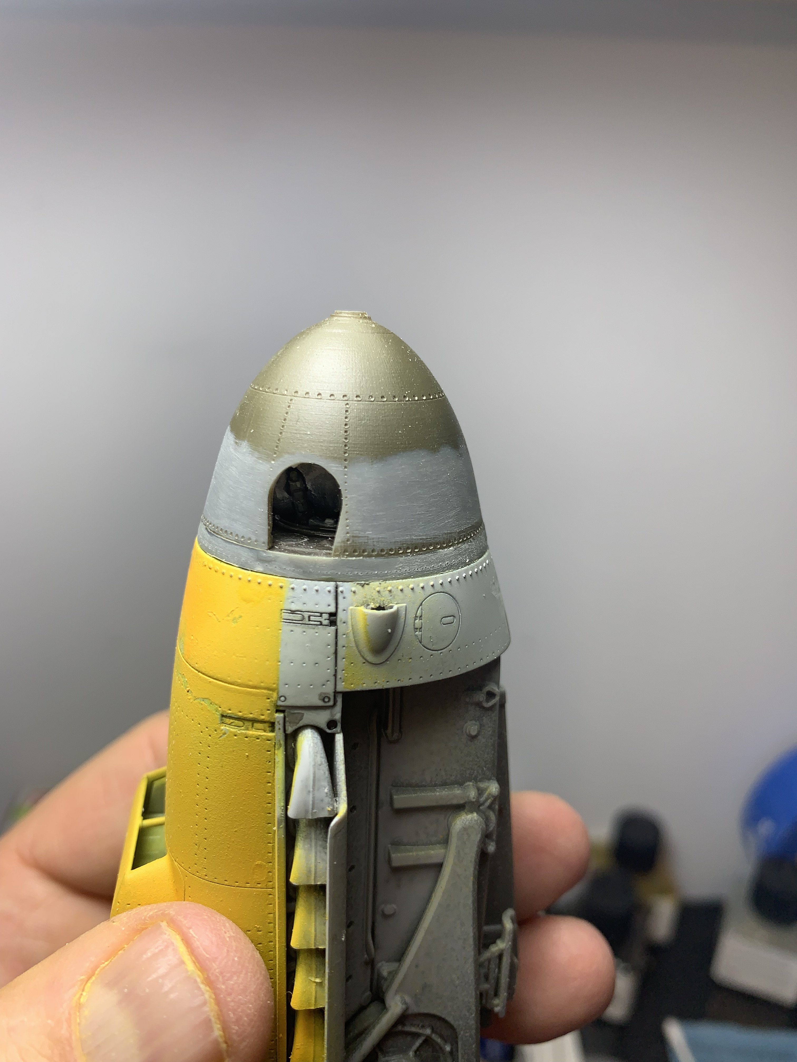

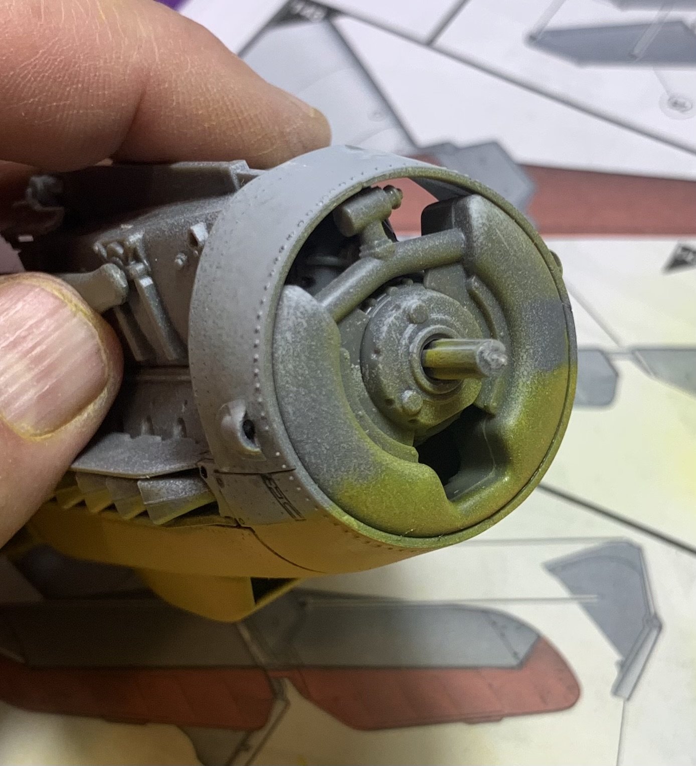

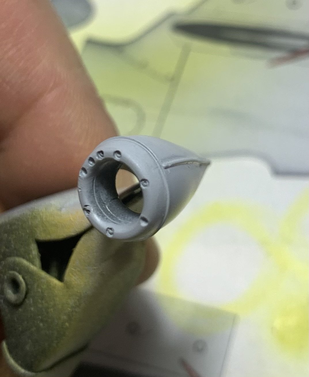

Martinnfb Posted 14 hours ago Author Posted 14 hours ago Airfix designed the power egg to be assembled in two ways, with open and closed cowling. Instead of downsizing the engine, they have you to sand it downs a bit in case you’re closing the cowling around it. The whole process is trouble free. I cracked the lower seam line as I was drilling the missing hole for the coolant reservoir drain/ purge valve. The intake received some basic details like attachments point for tropical filter and welding seams( to be tamed). Ventilation vents on the sides need some work or straight out aftermarket ones. 2

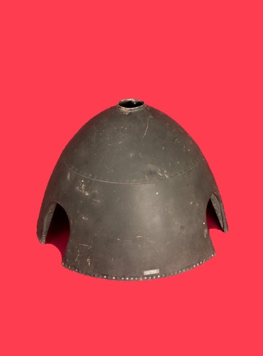

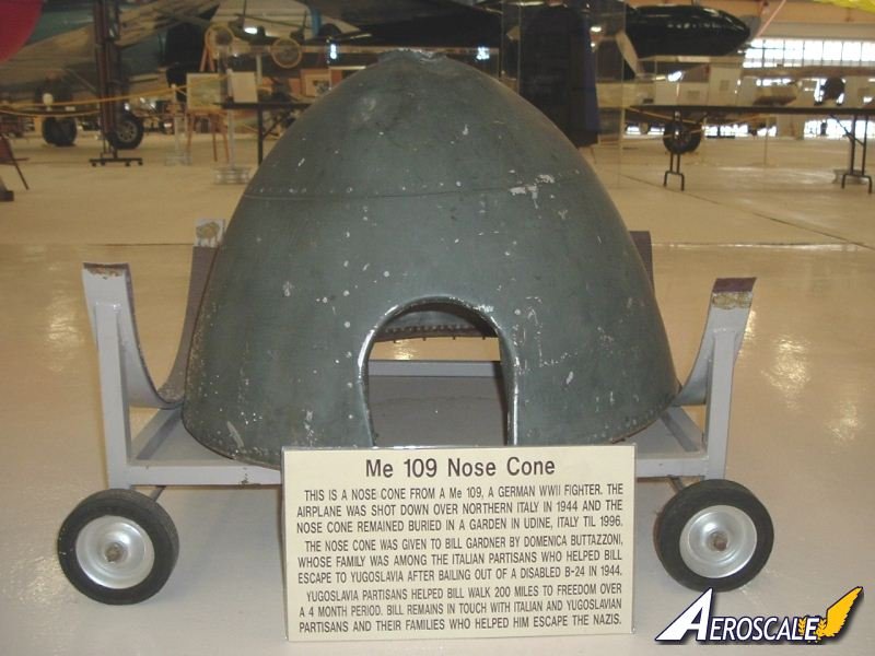

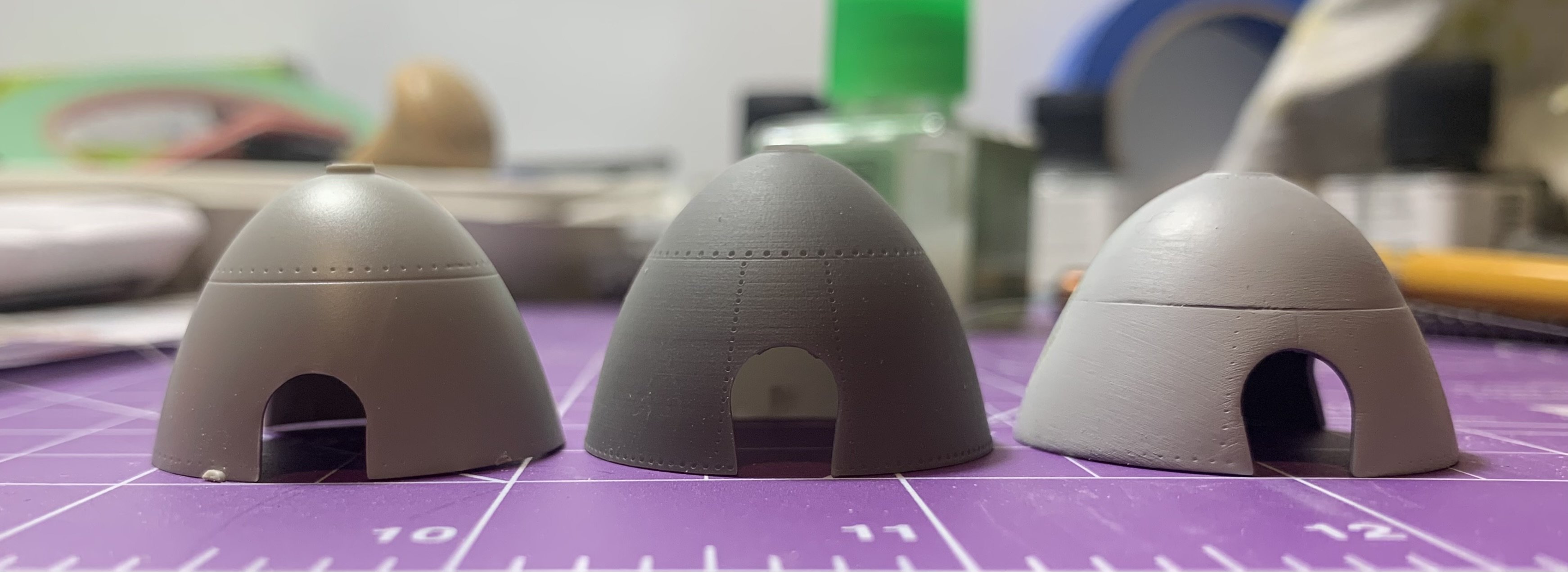

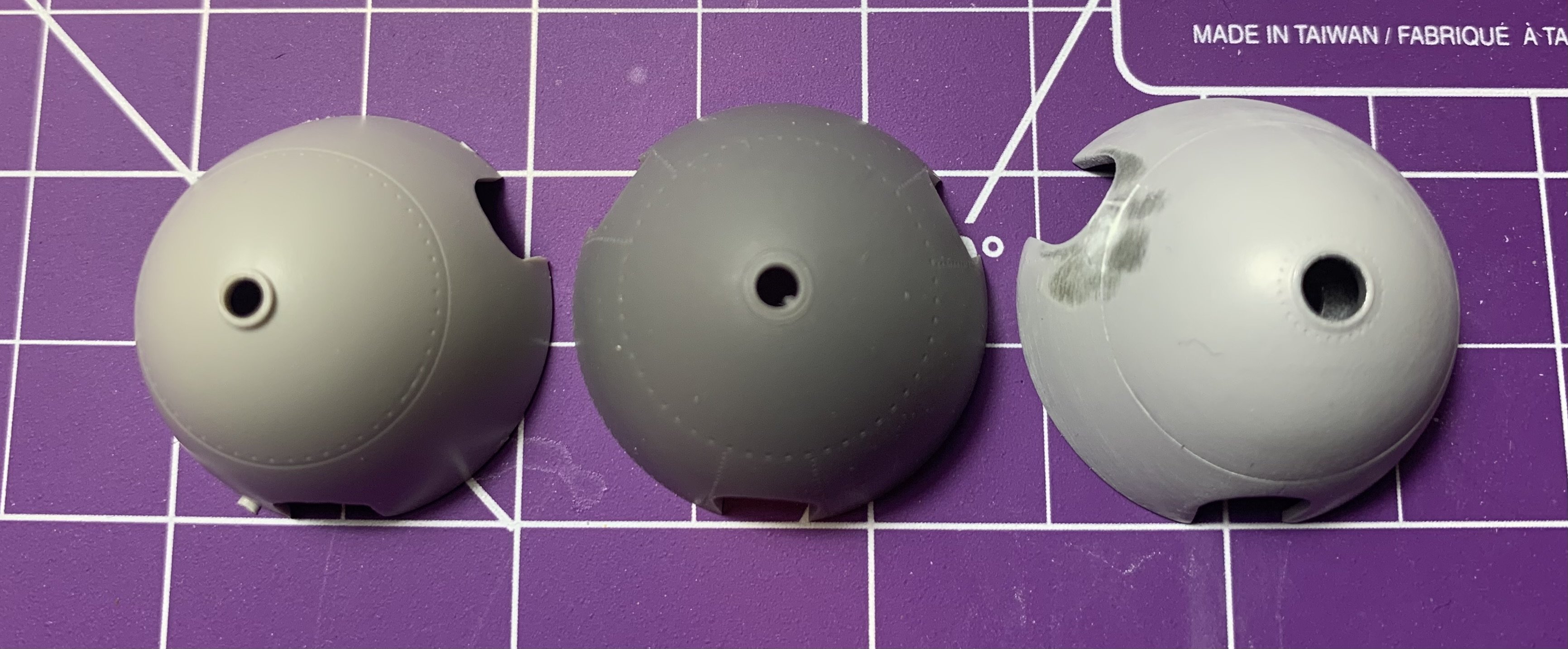

Martinnfb Posted 14 hours ago Author Posted 14 hours ago Trumpeter - Model Monkey - Airfix @Model Monkey is the best, however, being designed for TRP kit, the diamenter is 1mm too short. It doesn't take much to fit it in, I might take that route 3
PanzerWomble Posted 8 hours ago Posted 8 hours ago Its funny how all manufacturers struggle at time with nose cones, given its a simple shape . Good probe 😀 1
