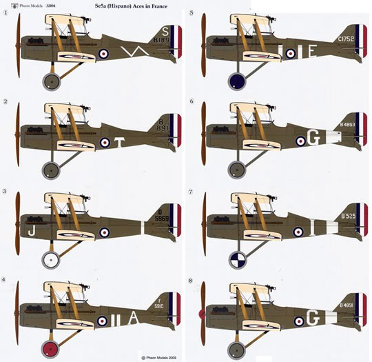

Dave J Posted May 5, 2013 Posted May 5, 2013 Looking Great Jeroen! If you still thinking about what scheme you are doing... Don't forget Pheon Decals do a huge sheet with SE.5a Schemes
