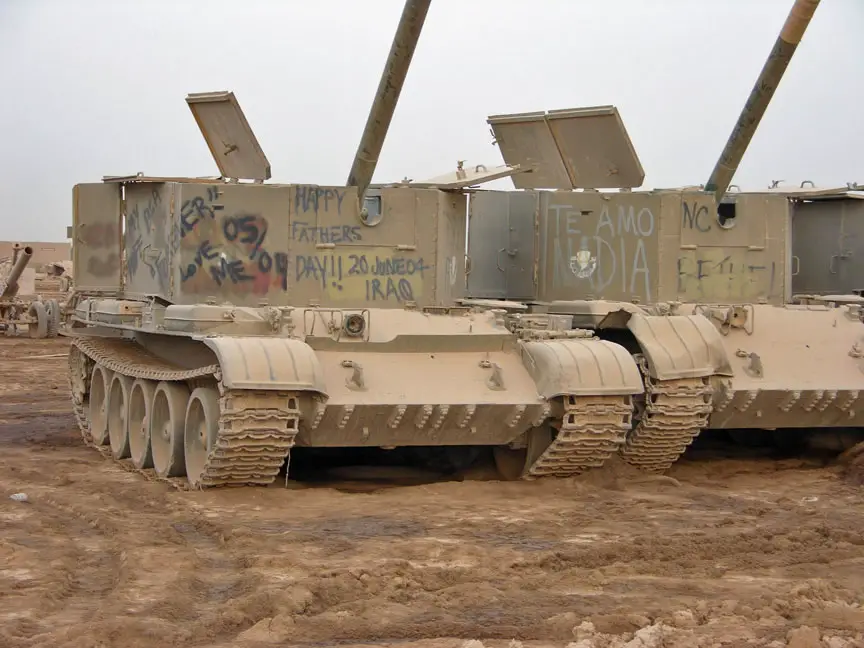

From the 1970s through the 1980s, Iraq acquired a large number of T-55s from various nations. These vehicles were already showing signs of obsolescence by the 1980s, however, and so were modified for continued use. “Enigma” was not an official Iraqi designation for the variant but rather a term used by Coalition forces in the Gulf War. The T-55 Enigma can be identified by the boxes of simple composite armor bolted to the turret and to the front and sides of the hull.
The Enigma appears to be little more than a T-55 with a crude armor upgrade. Essentially, large armor boxes have been fitted to the turret and front and sides of the hull. These are held in place mostly by bolts and brackets. These armor boxes are composite armor – inside the steel boxes are four plates of steel and rubber which are spaced apart by a few centimeters, although at least two captured Engimas did not use rubber sheeting.

(Non-explosive reactive armor) enclosed in steel boxes, this composite armor named unofficially as "Haji". Every NERA layer consists of 3 sublayes: a 10mm thick aluminium plate, a 4mm thick natural rubber (as reactive element) then a 4.7mm thick high hardness steel plate
