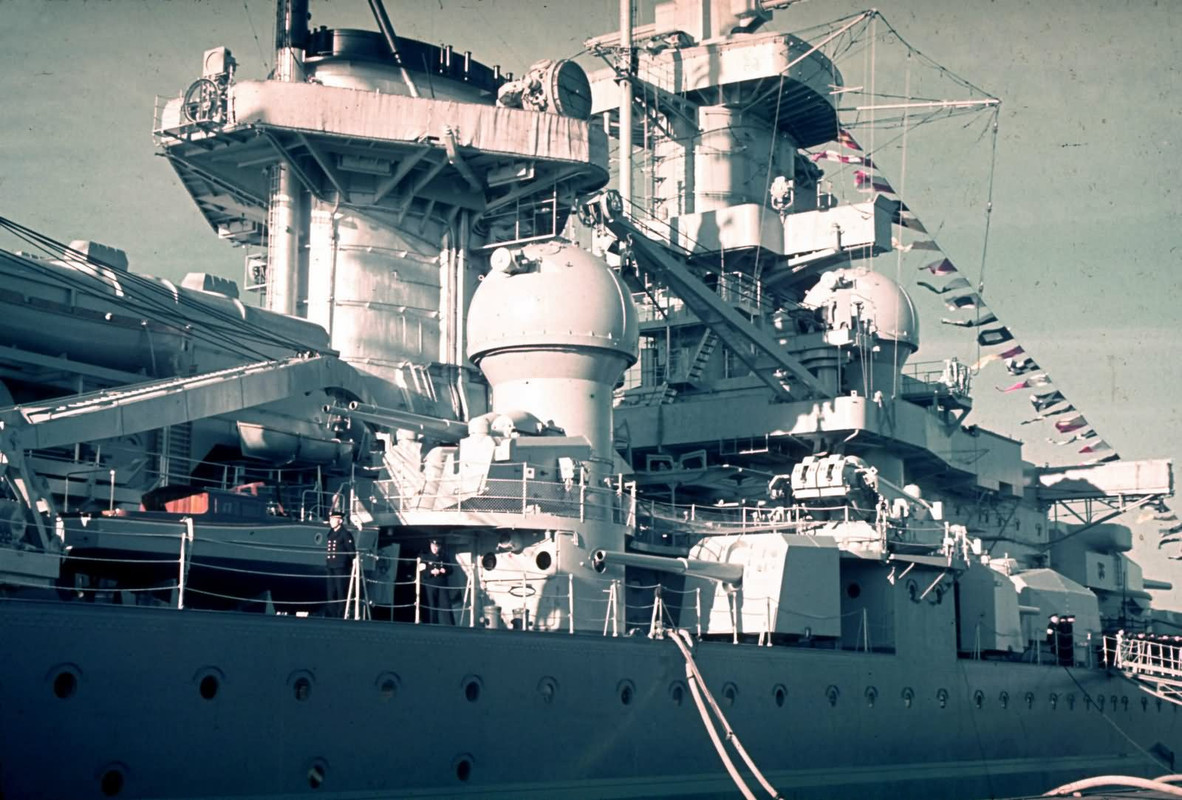

I have had some time to myself for a change and working to get it to pay off.I had to pull up three sets of Binoculars and reposition two of them further down the observation station and position two compasses.The book is becoming more and more a guide on the build this is the layout from March/43.I also cut off all the globes of plastic on top of the radar/rangefinder and replaced them with resin bits and made two features not present but so in 43.The 20mm Flak guns are really sasweeet but so fragile had to order three more sets just to be sure I have enough still more painting there.The rangefinder station is still not glued down yet and neither the tower to be built behind it sure/slow is the game plan.The book is awesome piece of reference material for this build a must.I have seen weras on other build people complaining about the fit of the rear SS to the deck?as you see I have left the moulded spruces in place from the factory giving it more rigidity across the deck.The rear SS will need a finger and 1/2 lbs of pressure till the glue sets slightly bowed upward  it is. ;)

A slight dilemma ............a picture is worth a thousand words they say ......and a few curse words also.What you see portrayed by Trumpter is the deck of the Gneisenau!! They produced that kit first if not mistaken and just went willy nellie here :wallbash: I have the book from Kagero on the Gneisenau and that's her layout.The wood chip is stained now you see why she will not be stained at all.;)

Thanks Harv just to late .I was looking at how another builder got pass it and he missed it at first but lucky for him nothing glued together in that part of the build.his method was some good cutting coming about at the bottom of the page.  https://www.laroyale-modelisme.net/t27110p245-croiseur-de-bataille-dkm-scharnhorst-trumpeter-1-200-de-dyphrologue
