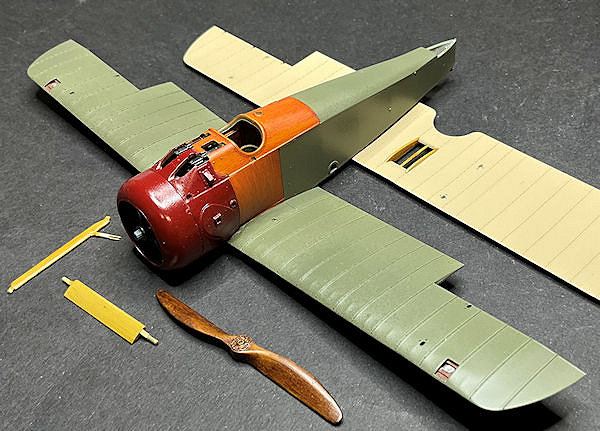

sandbagger Posted November 16, 2024 Posted November 16, 2024 Hi all, As I specifically build 1:32nd scale aircraft, I wanted to see how a smaller scale model would be to build. So I've started on an 'Eduard' Sopwith F.1 Camel (Bentley) (kit 8485). Suffice to say it's much smaller than I thought it would be. So it presents it's own challenges, not least trying to get half decent photographs!!. I've used the 'Barracuda Studios' resin seat. I've also added bracing and control rigging as well as additional pipework etc. I don't know why as obviously it's virtually impossible to see. Mike 7 1

sandbagger Posted November 24, 2024 Author Posted November 24, 2024 Hi all, Just a quick update as I was away last week. Wood effects have been applied. I used 'Windsor & Newton' Alkyd oil paints. Raw Umber, Raw Sienna and Burnt Sienna, Mike 8
belugawhaleman Posted November 24, 2024 Posted November 24, 2024 Nice! I like the wood effects. Got to try that some day. 2
KevinM Posted November 25, 2024 Posted November 25, 2024 You know Mike looking closer that red nose looks real and such a nice shade. 3
sandbagger Posted November 25, 2024 Author Posted November 25, 2024 On 11/25/2024 at 1:10 AM, KevinM said: You know Mike looking closer that red nose looks real and such a nice shade. Expand Hi Kevin, Just 'Tamiya' Red (XF7) with Rubber Black (XF85) added to darken it, Mike 3 1
BlrwestSiR Posted November 26, 2024 Posted November 26, 2024 I can't believe that's 1/48. It looks stunning. I keep coming back to the wicker seat for some reason. Plus the fuselage wood graining is impressive too. Carl 3
