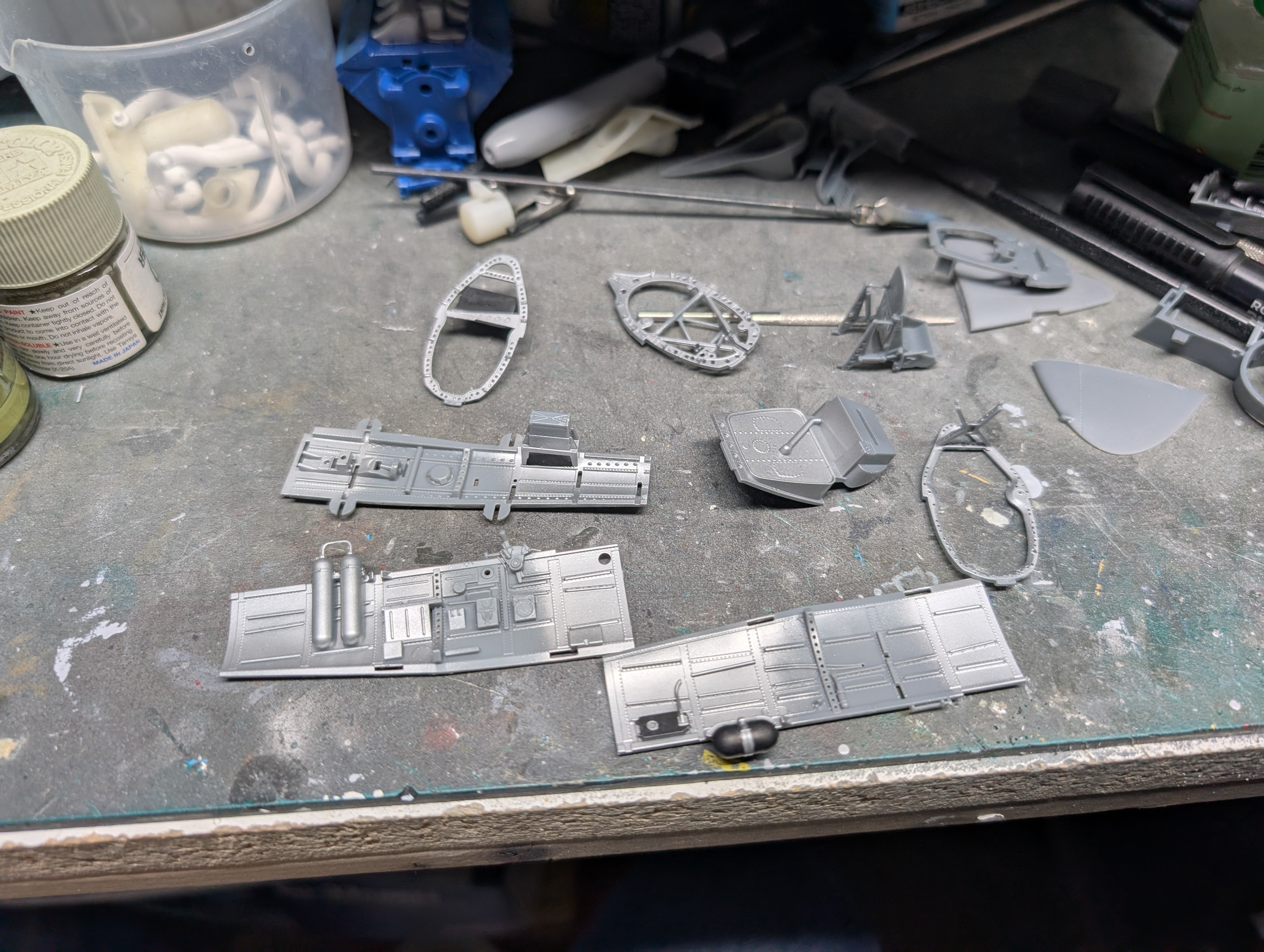

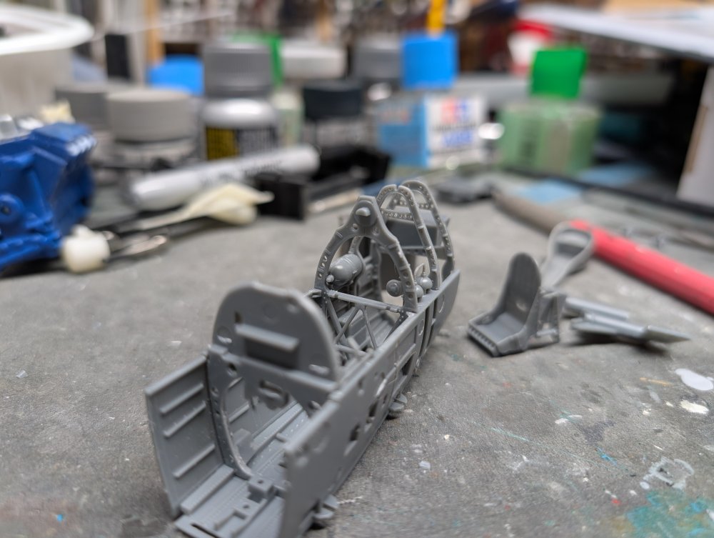

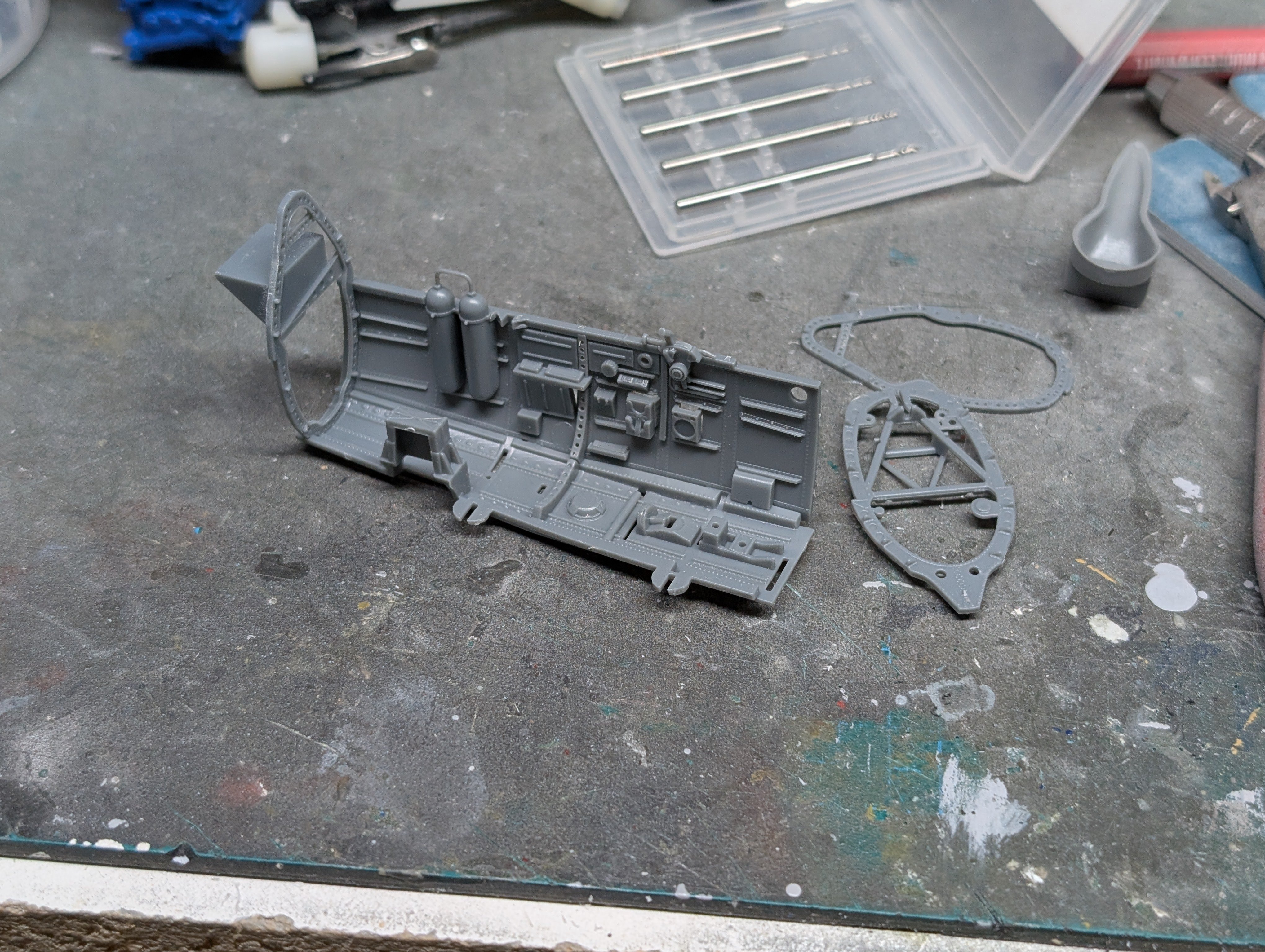

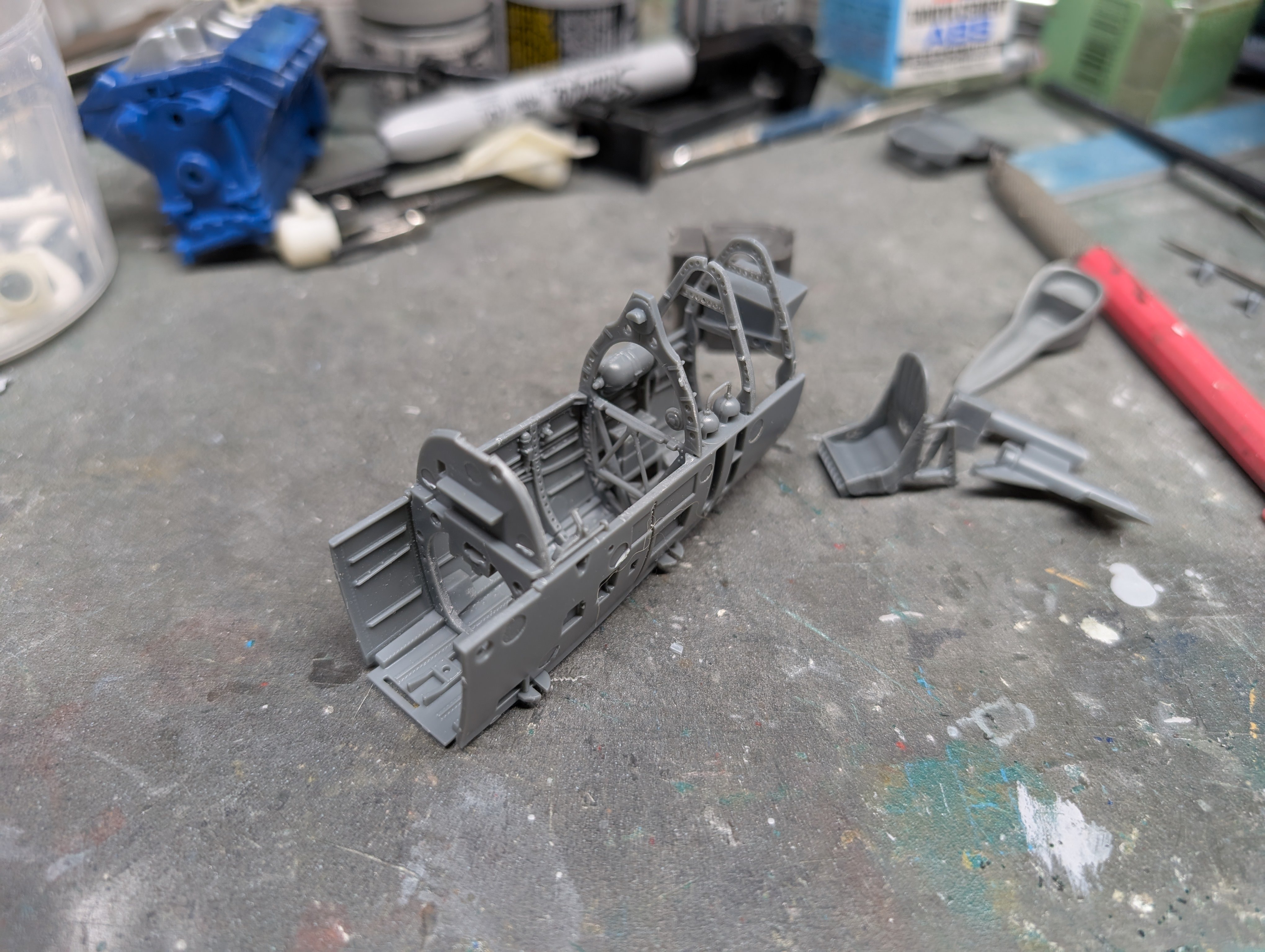

BlrwestSiR Posted May 13, 2025 Author Posted May 13, 2025 First up, the cockpit. I did a test fit of the major components to see what needed modification, if any. At the same time, I drilled out all the lightening holes in the frames. Then the relevant areas were painted in silver. 4

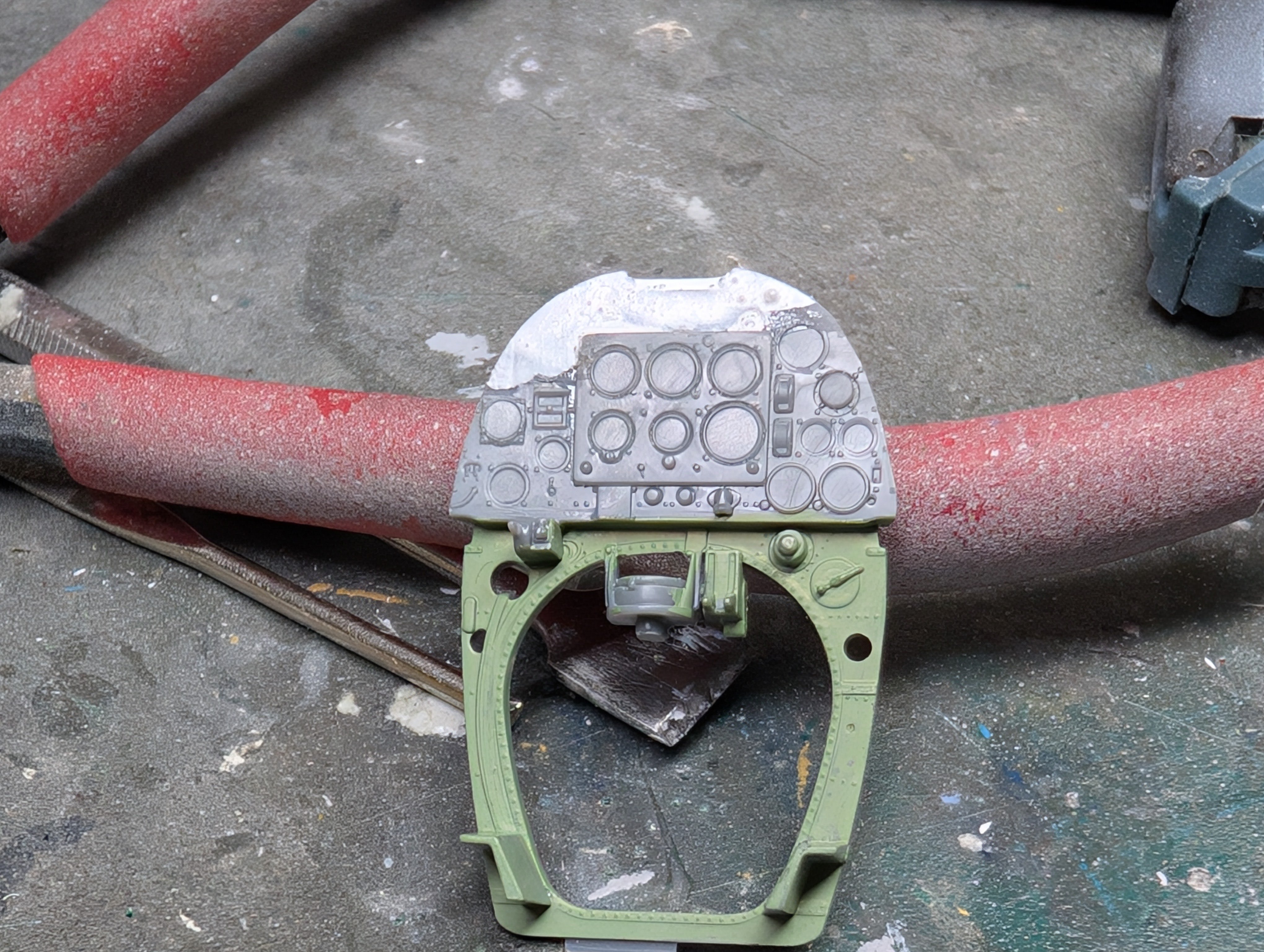

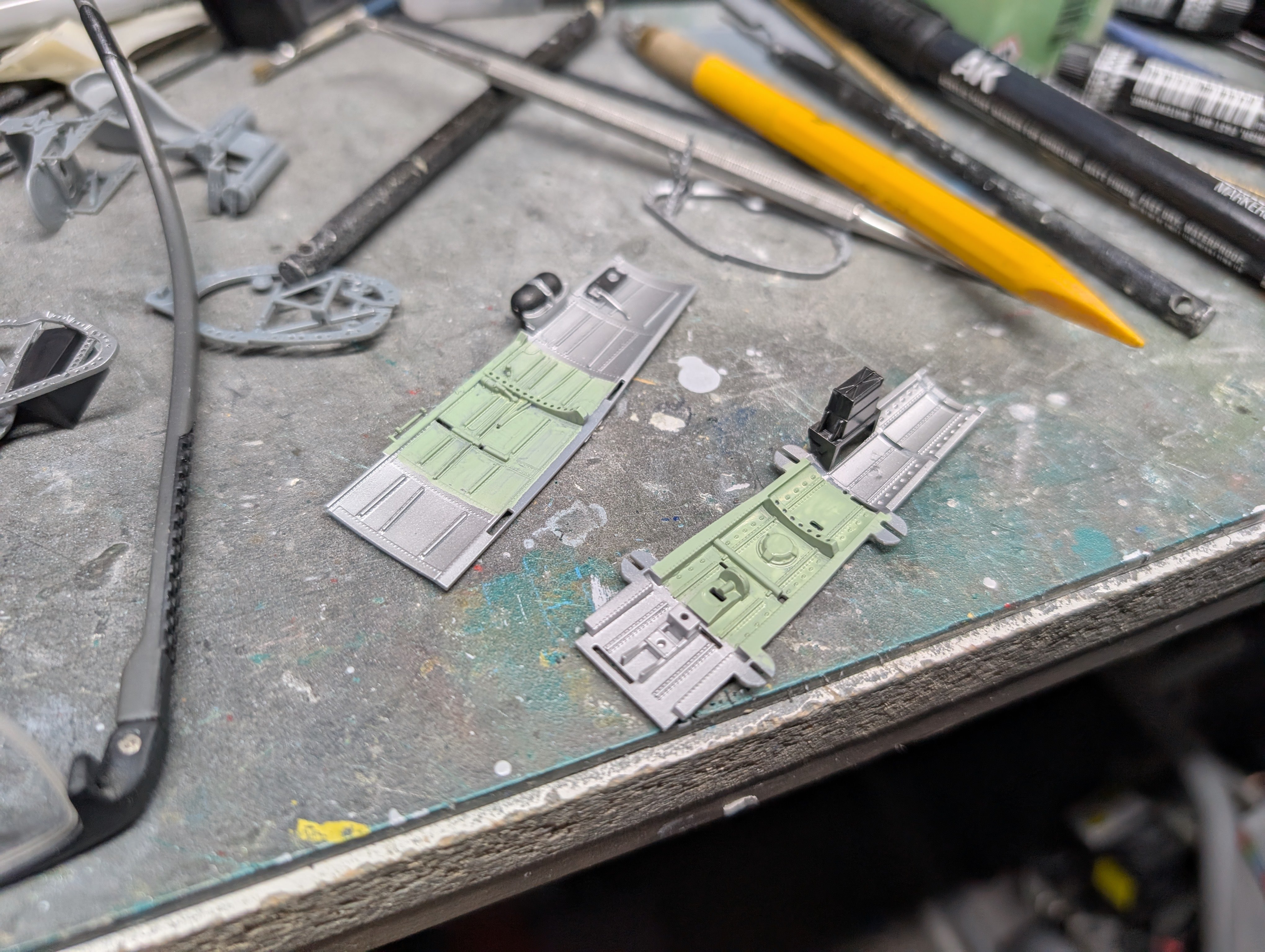

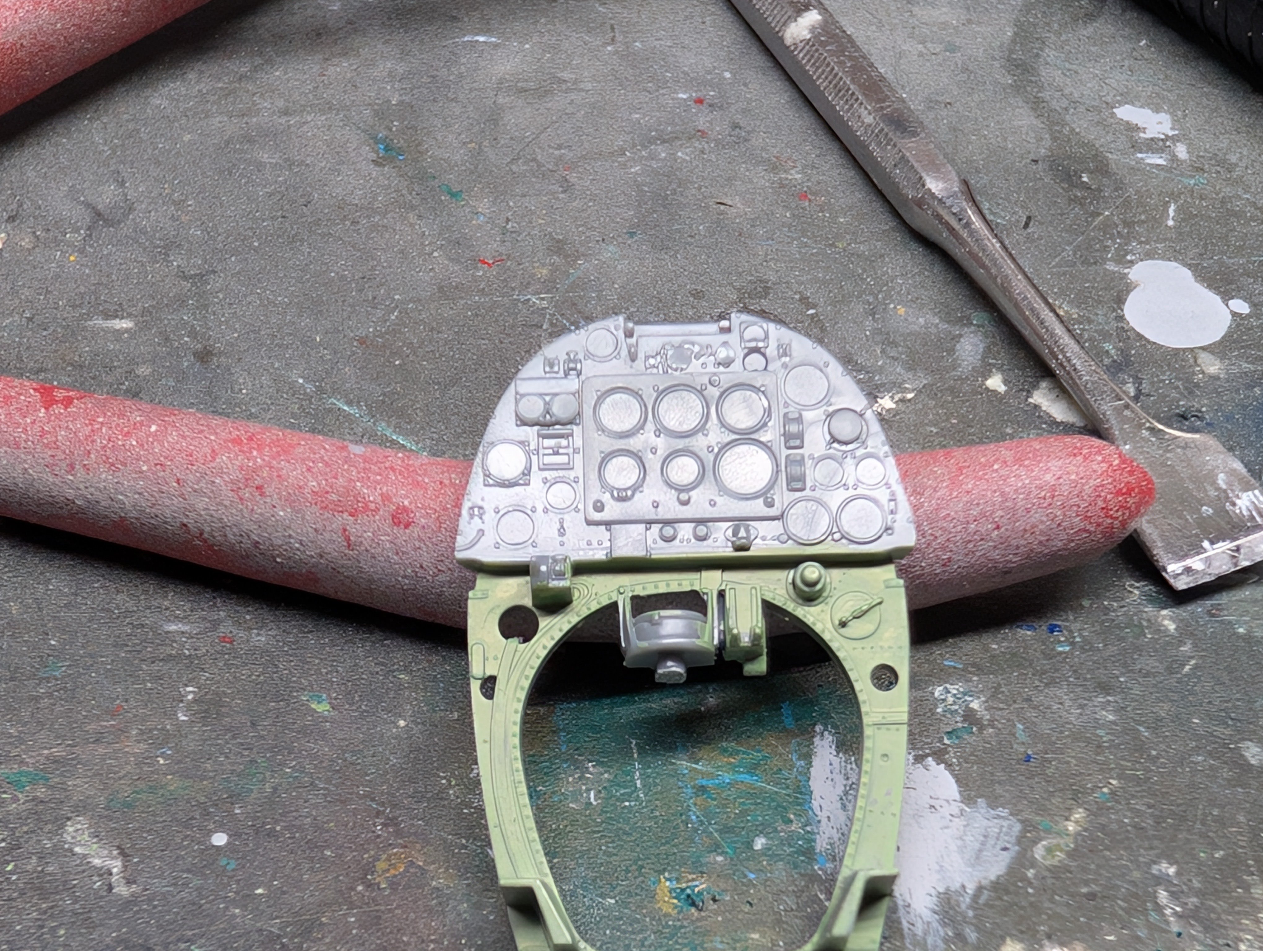

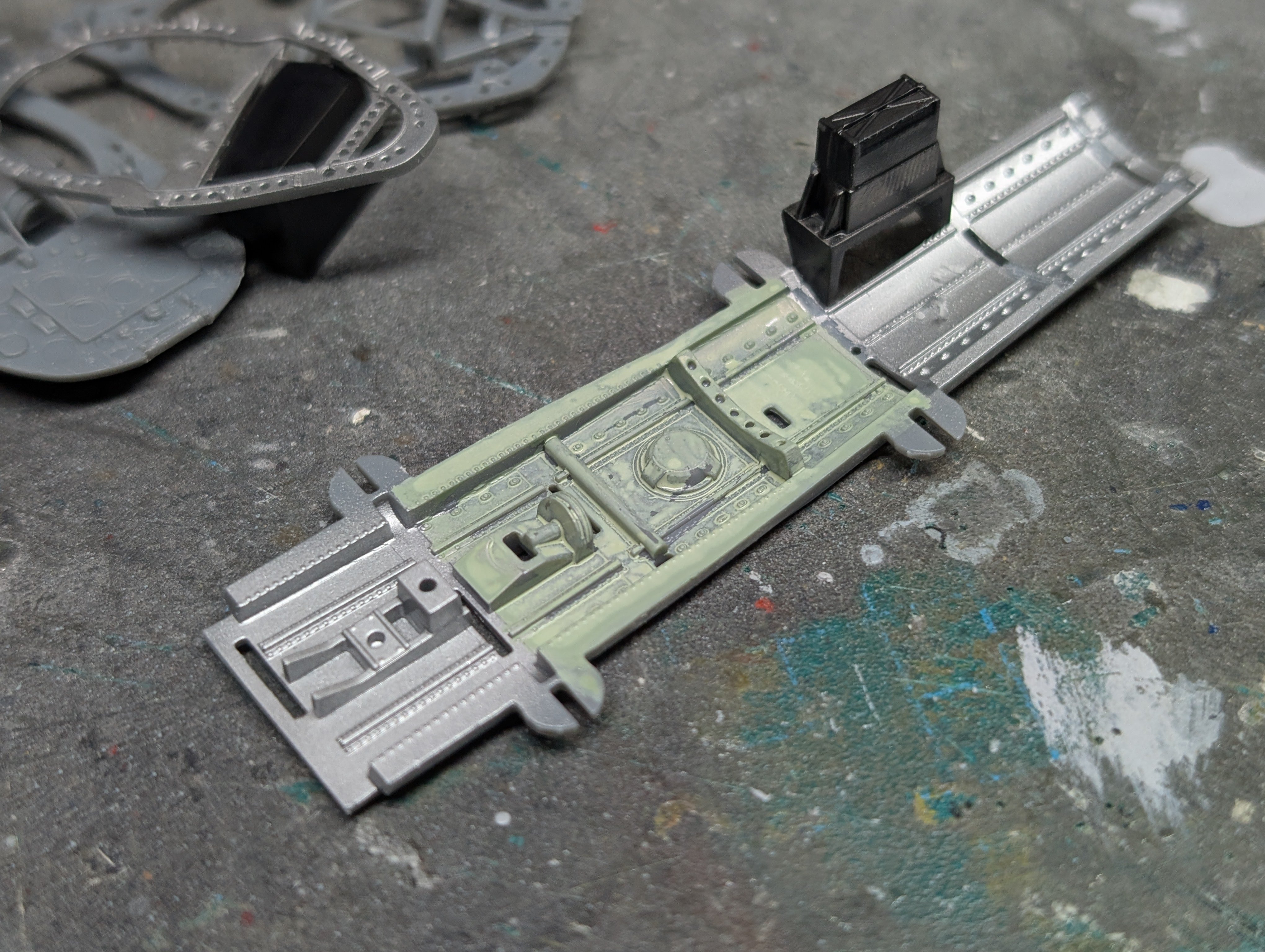

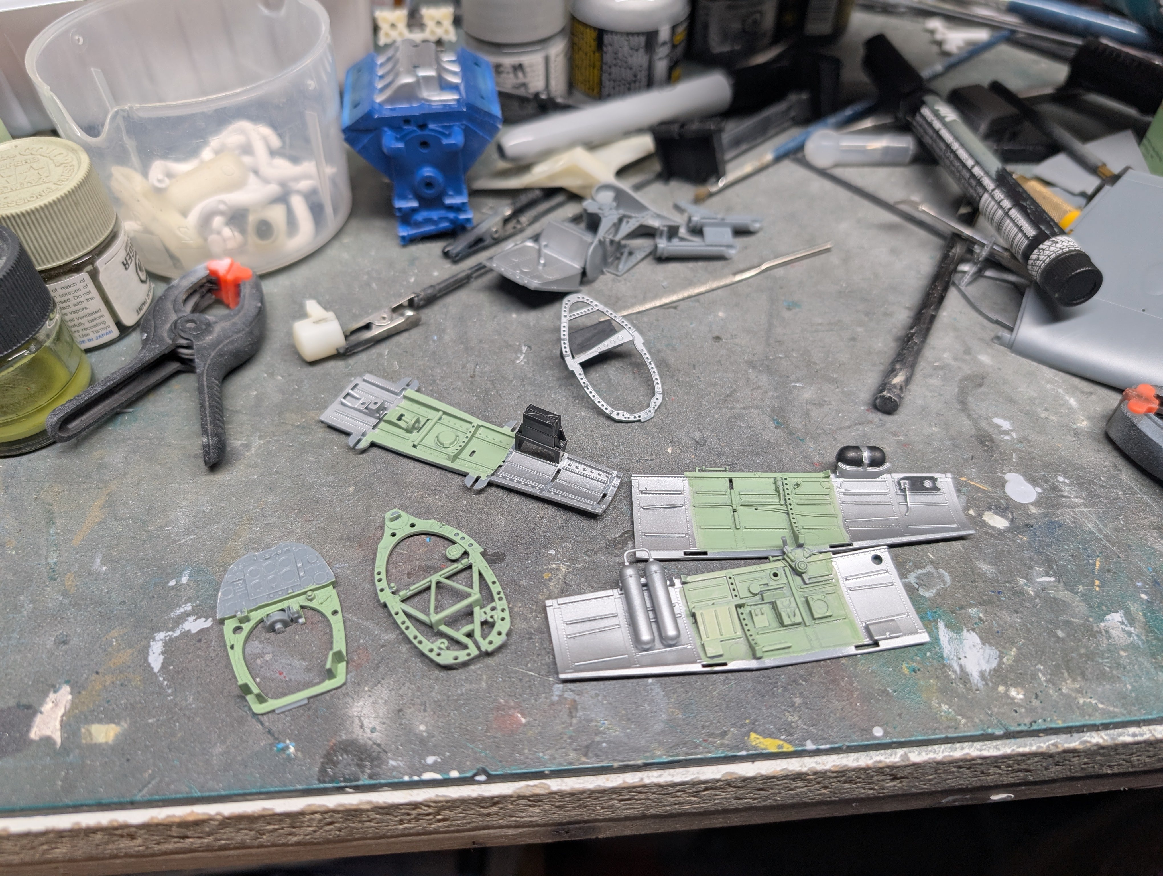

BlrwestSiR Posted May 13, 2025 Author Posted May 13, 2025 Trying a different approach, I used the new AK Real Color markers for the RAF Grey-Green areas. This was much faster than masking them off. First coat looks a bit meh: Much better after a second one: The IP needs a couple instruments removed from the upper side. After scraping them off, I did a bit of touch-up with some Mr Surfacer. 6

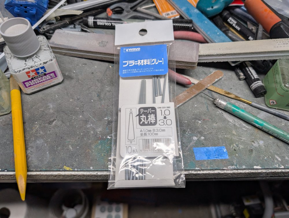

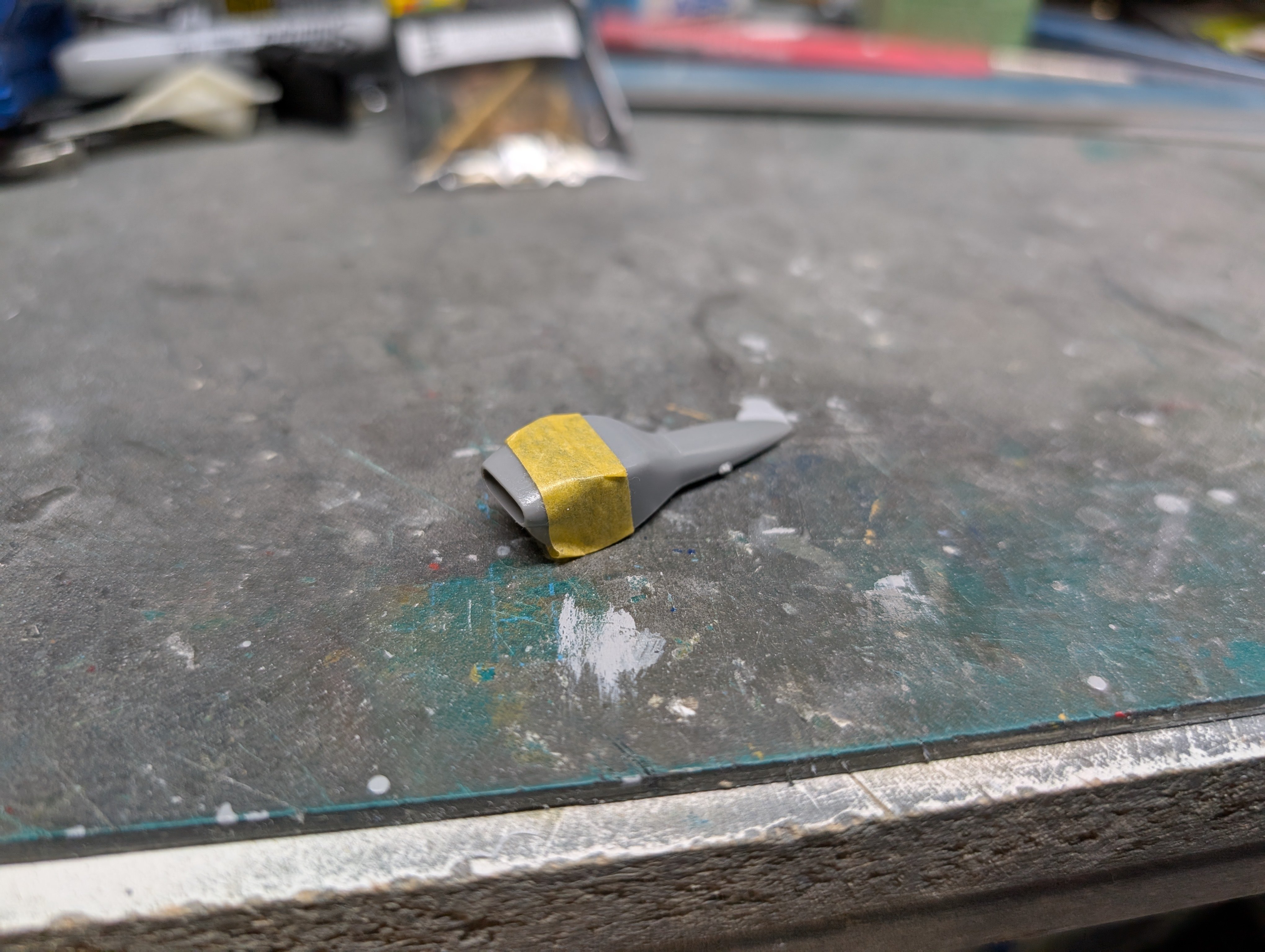

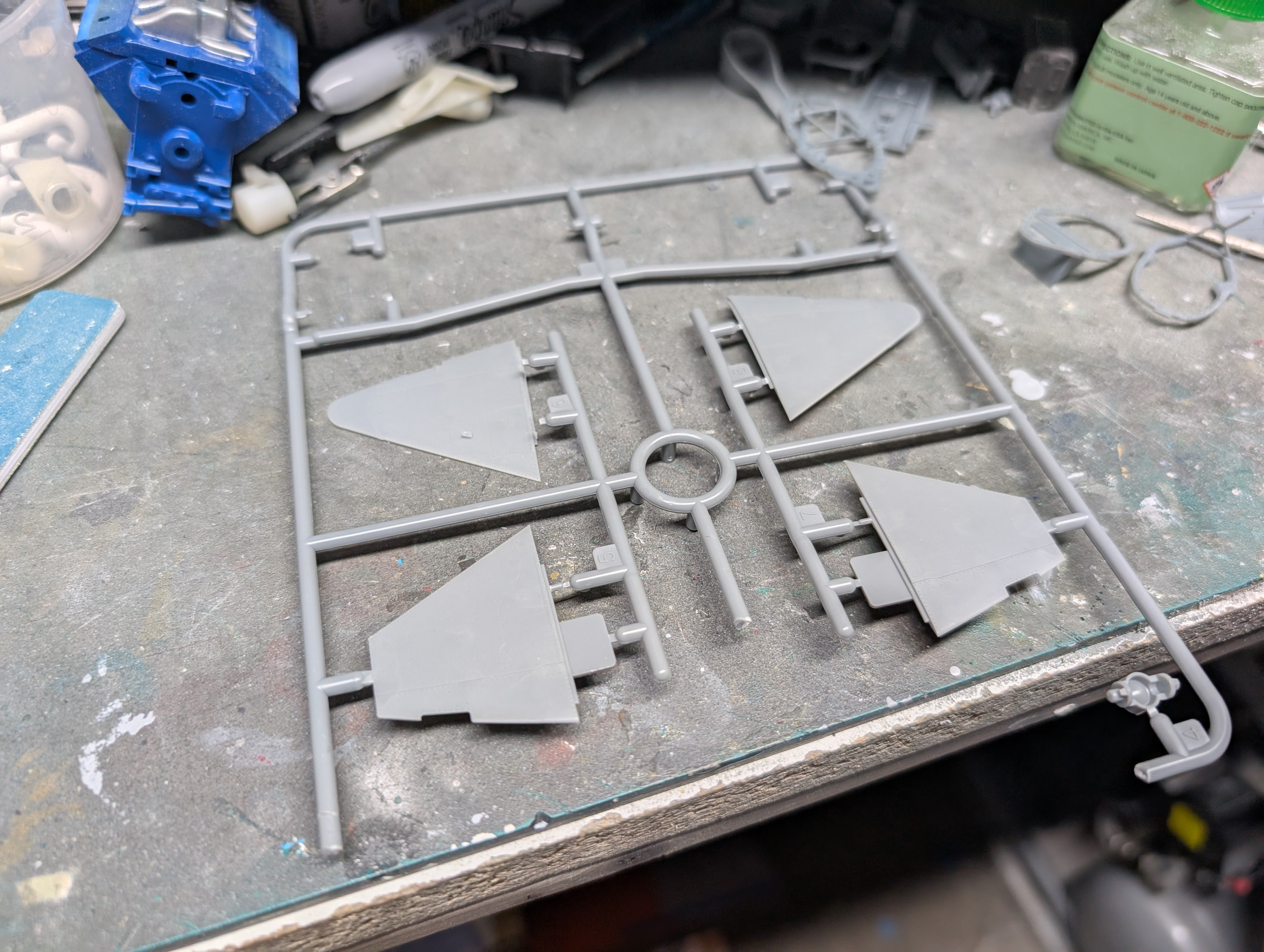

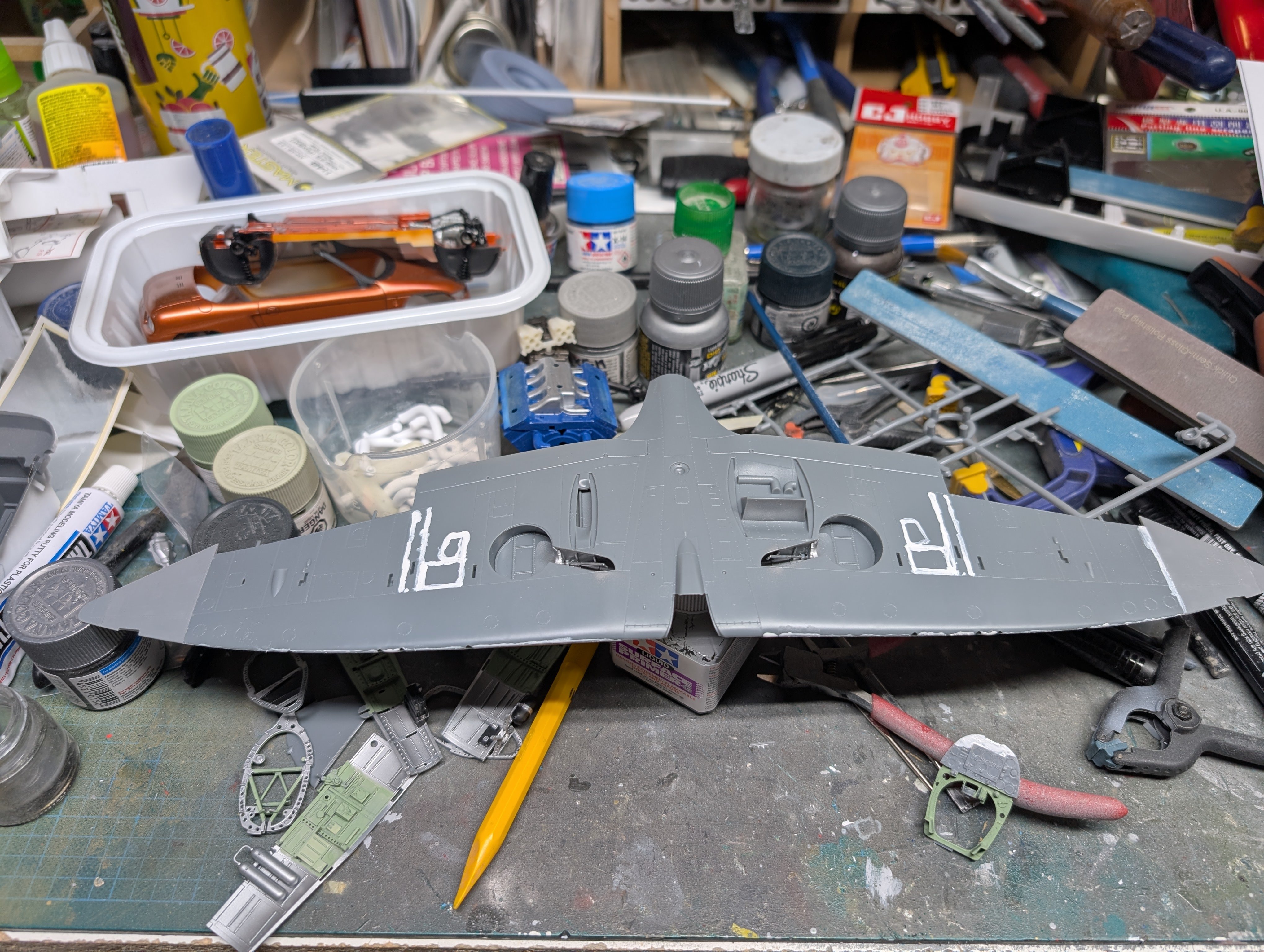

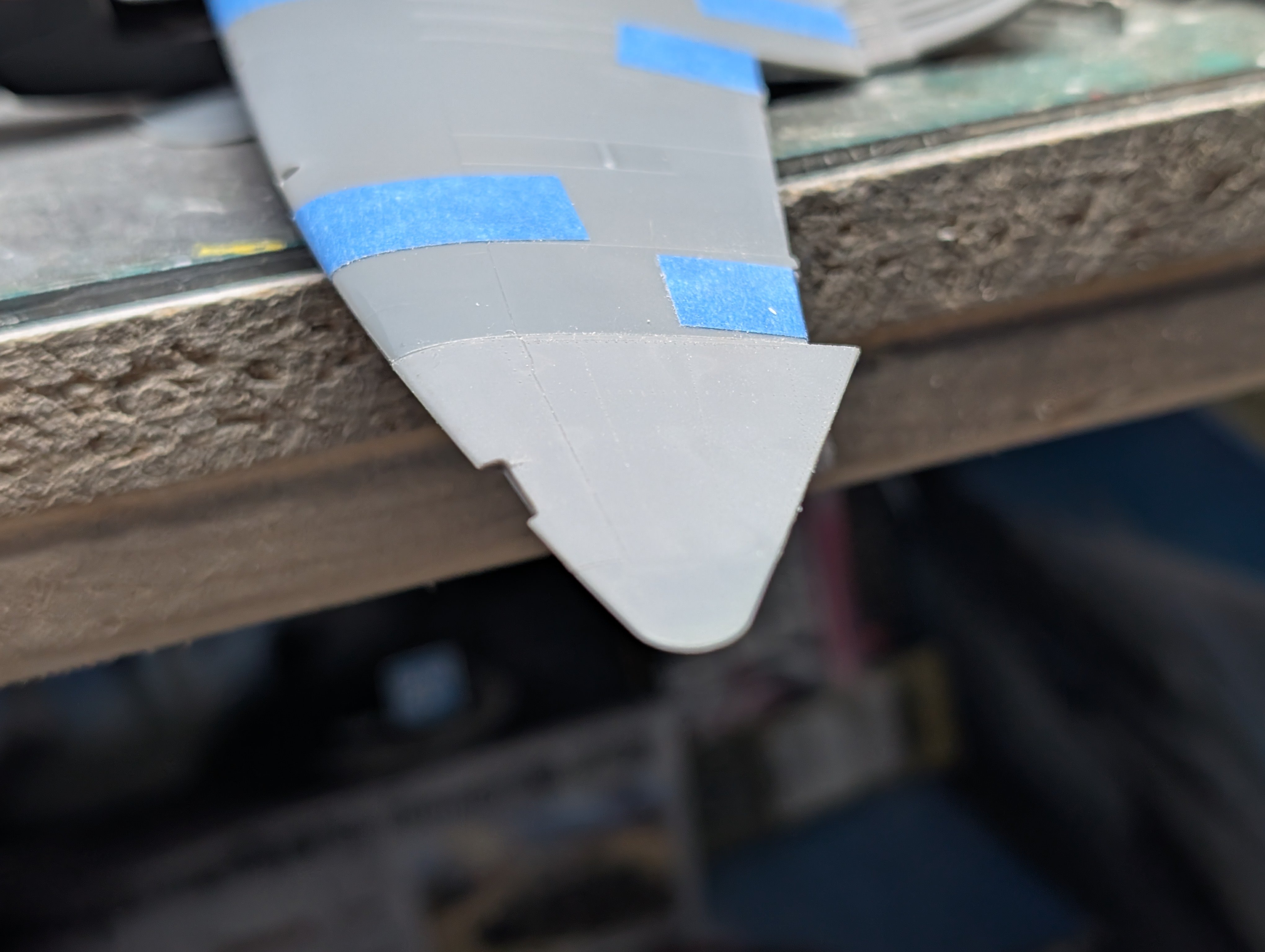

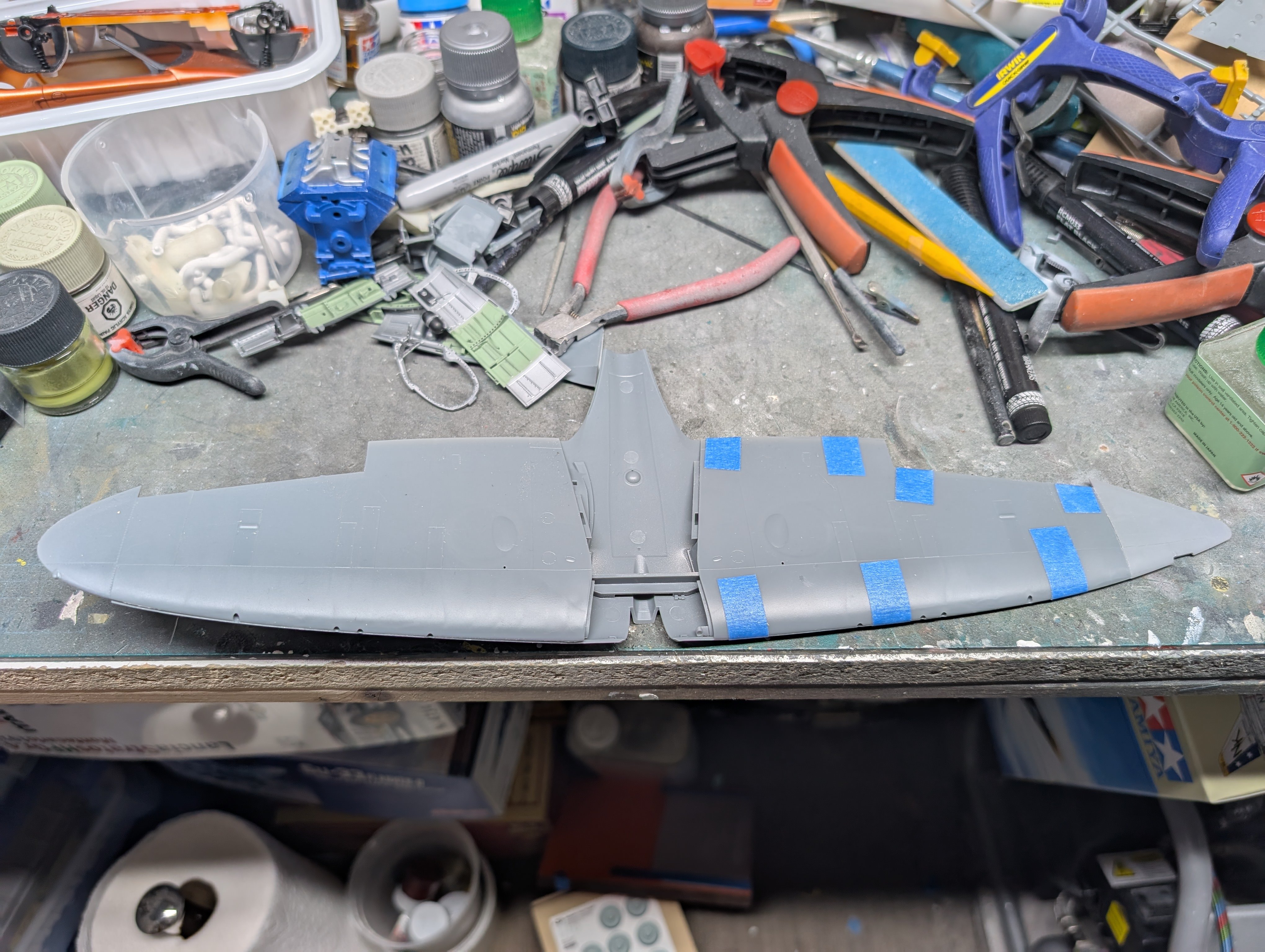

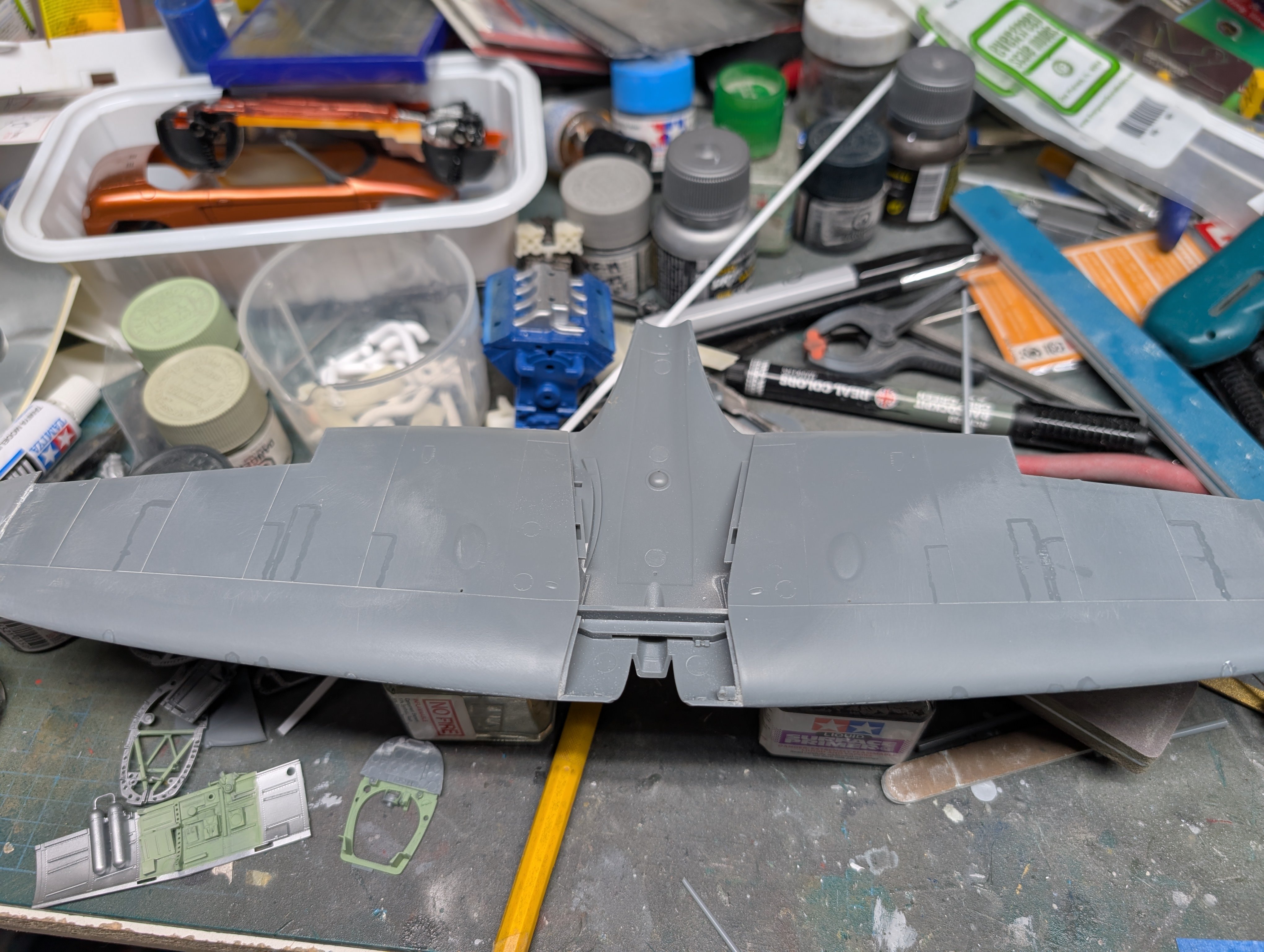

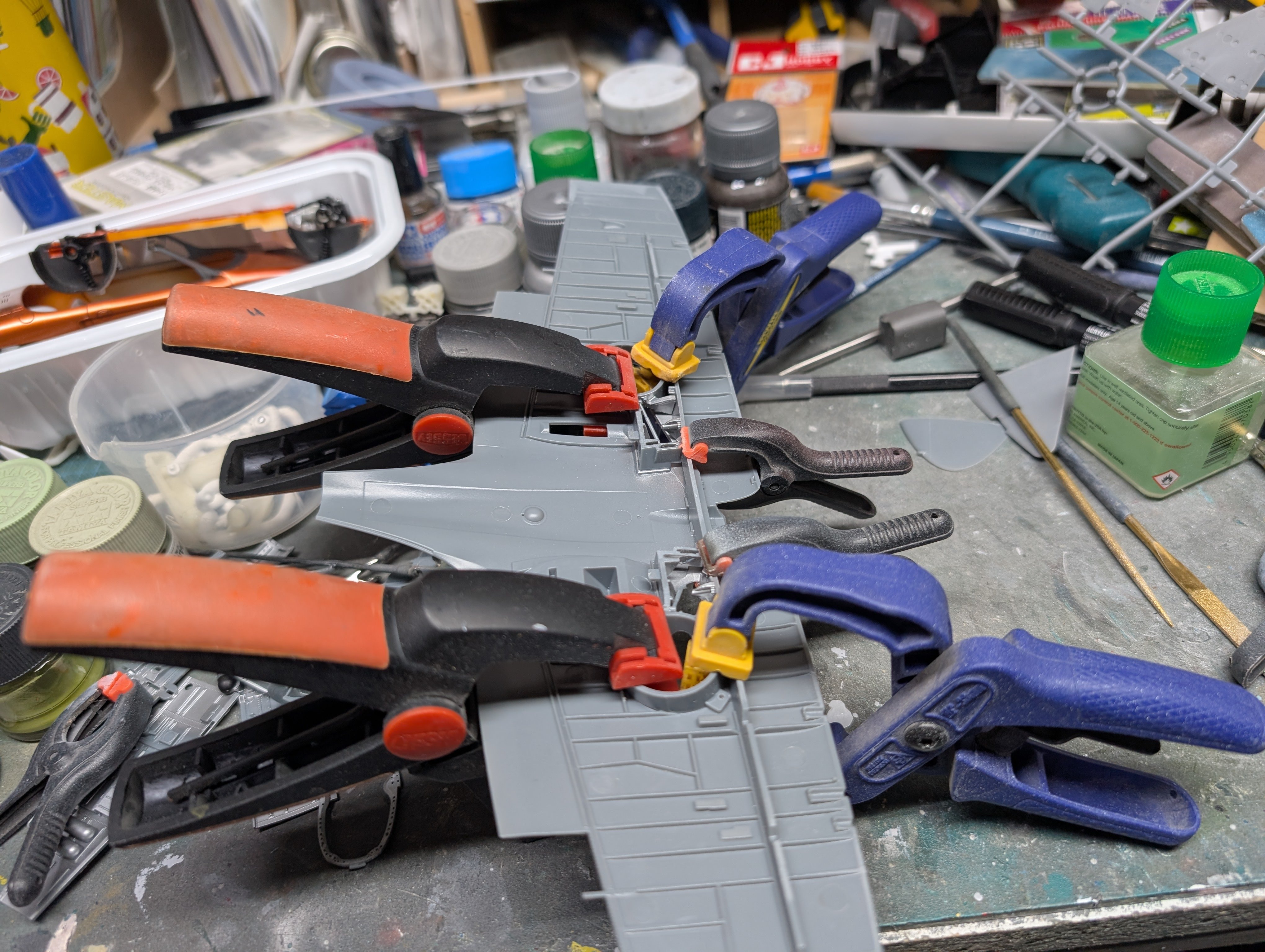

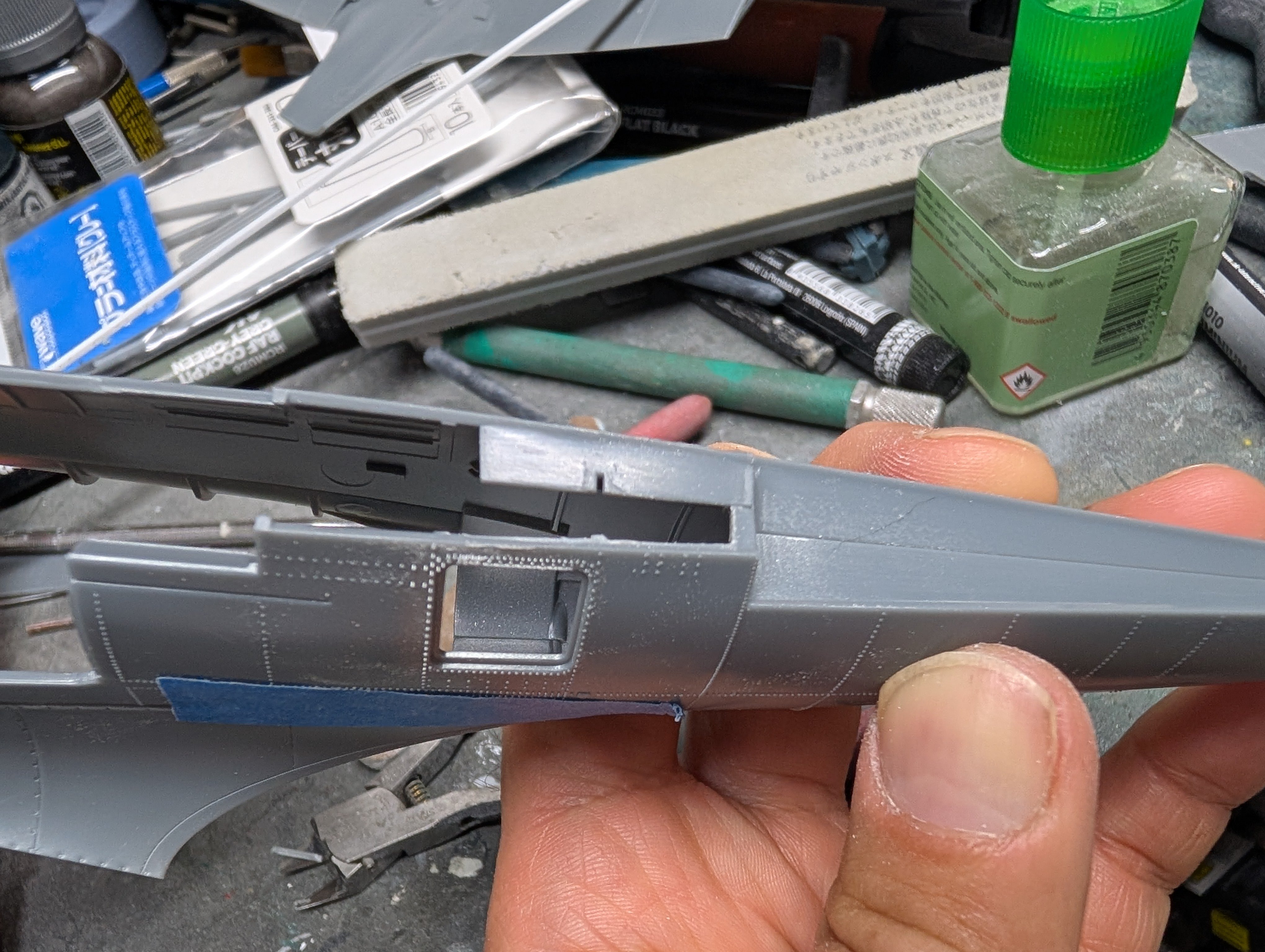

BlrwestSiR Posted May 13, 2025 Author Posted May 13, 2025 While that was drying, I started on the wings. The main spar and wheel wells were glued in. I then added the upper wings. I trimmed off the outer wingtips. Here's one side done. The Tamiya wingtip is just about a perfect fit. I then filled in the MG access panels on the lower side. I initially started with Mr Surfacer but switched to CA as it dried faster. I did the same on the upper side as well as filling in the MG barrel openings. For this I used some Wave tapered plastic rod. It fills the holes perfectly. 9

Count0 Posted May 14, 2025 Posted May 14, 2025 8 hours ago, BlrwestSiR said: Wave tapered plastic rod You can do the same thing with the cast off ends of stretched sprue. For free. 👍👍 4

DocRob Posted May 14, 2025 Posted May 14, 2025 Nice work on the Spitfire, Carl. She will be a beauty in white and blue. Thanks about mentioning how the AK markers work. I have some on the way right now, including GB interior green for my Kotare Spitfire. Cheers Rob 1
BlrwestSiR Posted May 16, 2025 Author Posted May 16, 2025 @DocRob, the markers seem to work best over a matte or satin coat. They're okay on bare plastic but it's a bit too smooth so it has a harder time with coverage. Same with over gloss paint. 1 1

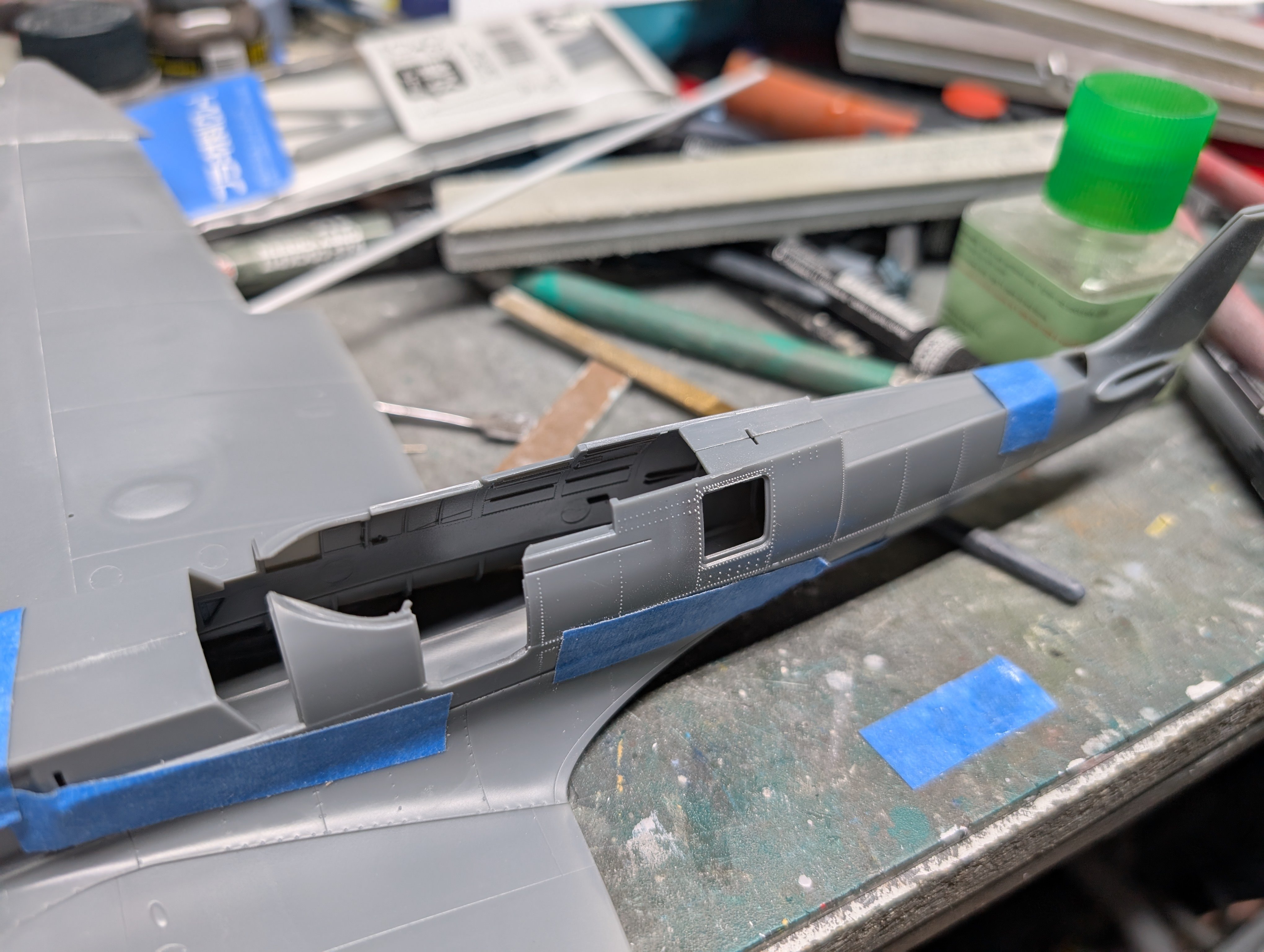

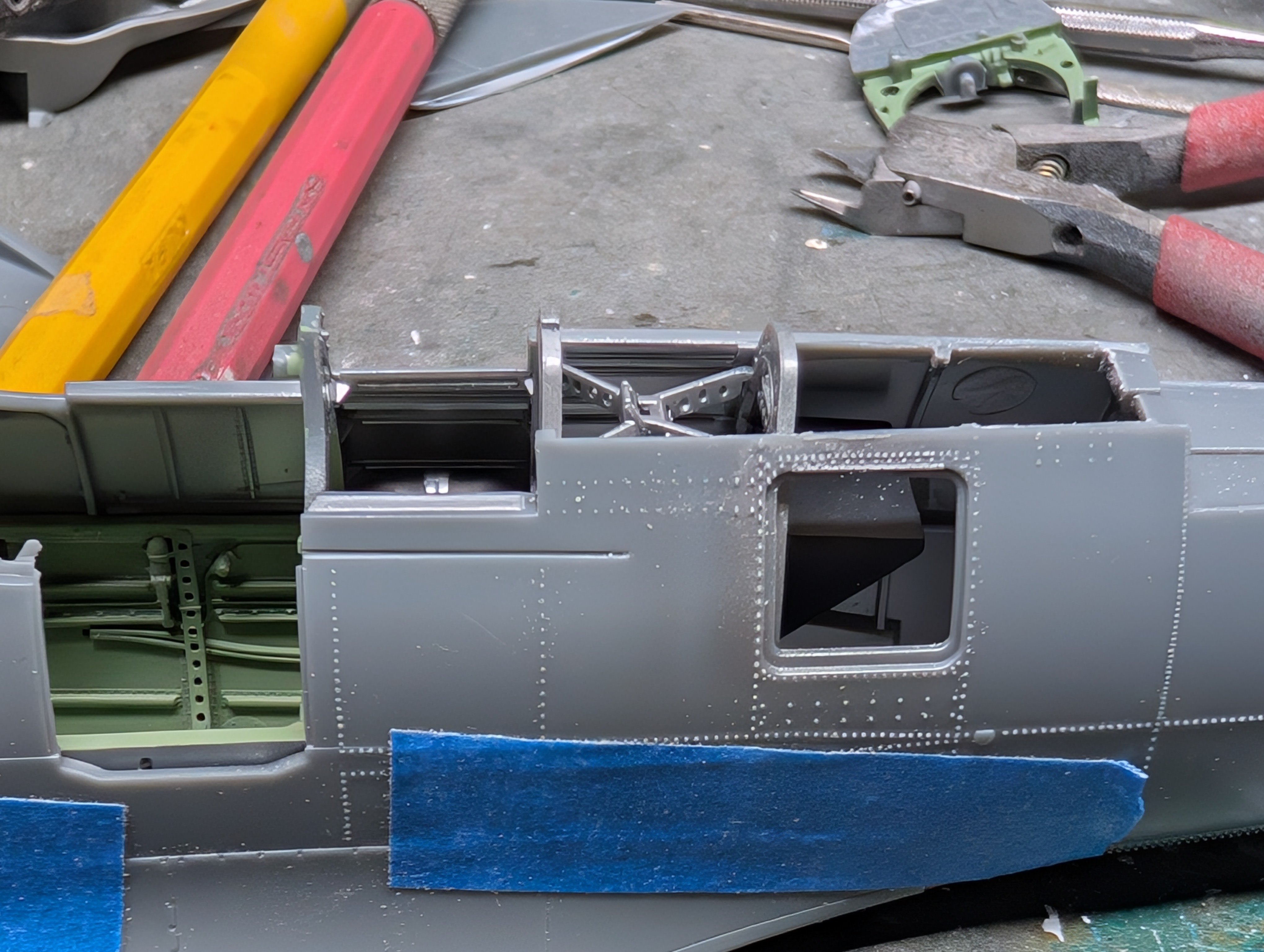

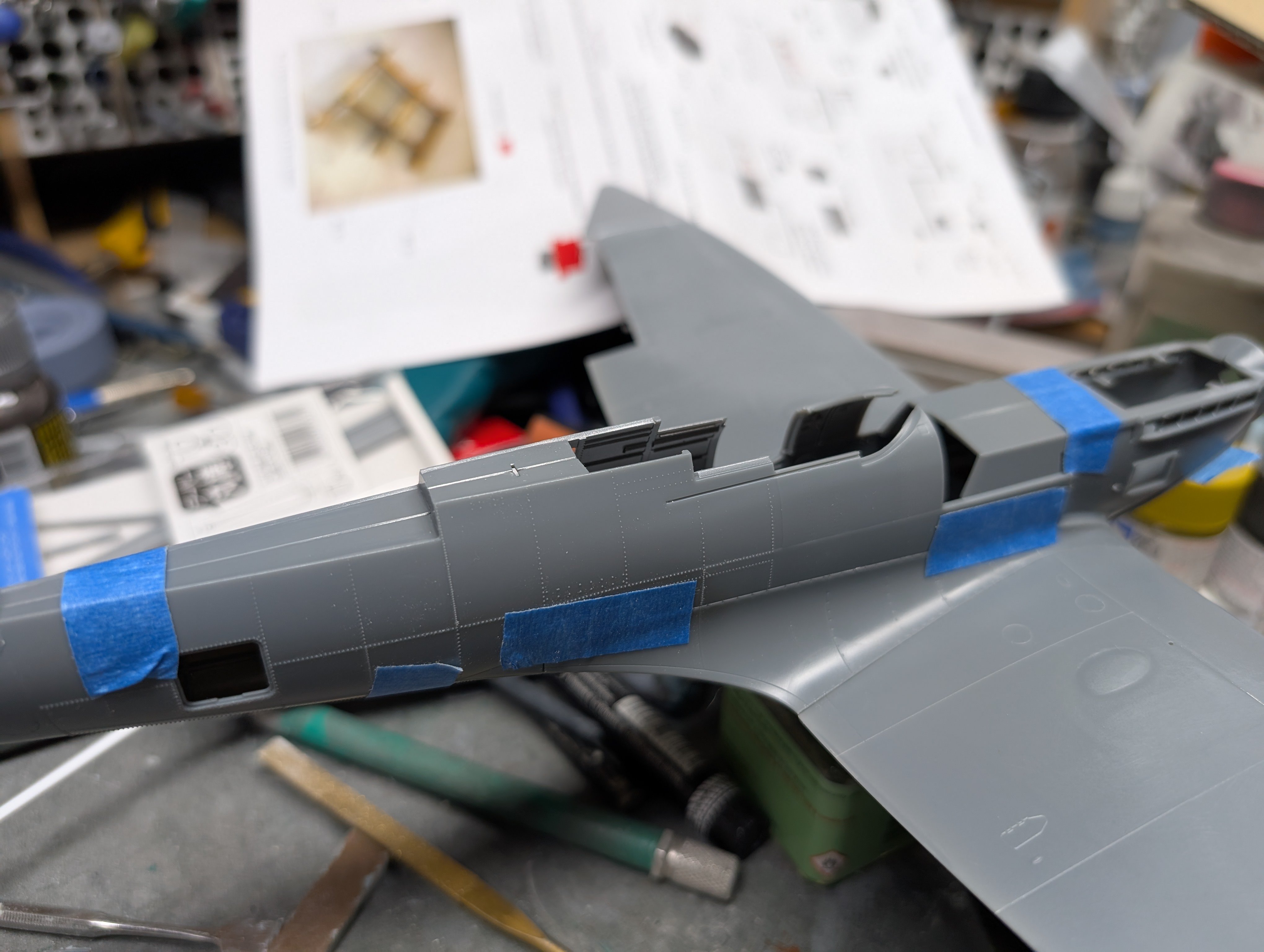

BlrwestSiR Posted May 16, 2025 Author Posted May 16, 2025 Time to start on the fuselage mods. First up, I trimmed and test fit the two fuselage halves together. With the way that Kotare designed the fuselage, the upper flat bit above the hatch will need to be removed. One side done. Followed by the second. Then test fitting the cockpit parts, the shelf will also need to go. 7

BlrwestSiR Posted May 19, 2025 Author Posted May 19, 2025 Ugh, I found more wing mods that needed to be done. The PR IV used the later style round oil cooler found on the Spitfire V series and not the semicircular ones on the MkI and II. First thing that came to mind was getting a Kotare Va kit and swapping out the oil cooler from it. Checking the instructions on Scalemates, the lower wing doesn't change between the two kits, just the oil cooler. So that was the expensive option plus having to wait for the kit to arrive. I then decided to look into Plan B. This was to take one from the intended base kit, the Revell MkII. That kit kit has a MkV circular oil cooler instead of the semicircular one that it should have. Having a Revell kit in the stash, plus a Barracudacast correction set, I pulled it out to see if it could work. All glued together. After some tweaking, I got a decent enough fit. I also finally filled in the shell ejection ports. 5
