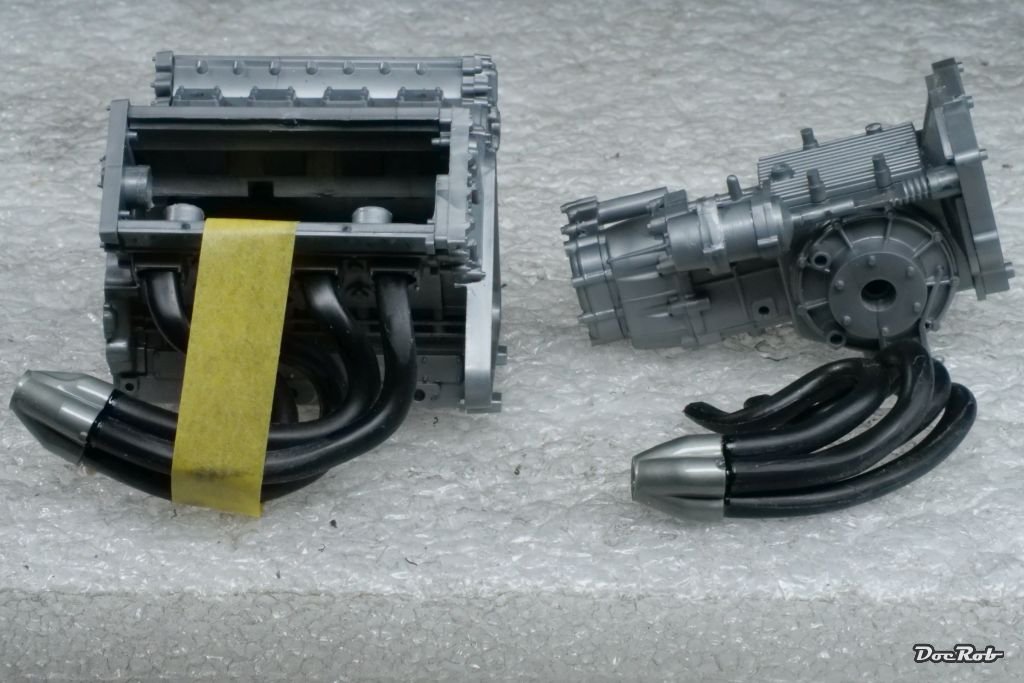

I started to prepare the engine and transmission for painting. Assembly is straight forward, albeit there´s a lot of clean up necessary. The exhausts are always a bit complicated to assemble, therefore, I decided to finish this task before painting. I glued the exhaust pipes with a tiny bit of glue into the silver four in one piece and then fiddled the other ends of the pipes into their holes in the engine block, before the glue cured. Fixed wit a strip of adhesive tape, I added more glue to the four in one piece and let dry.

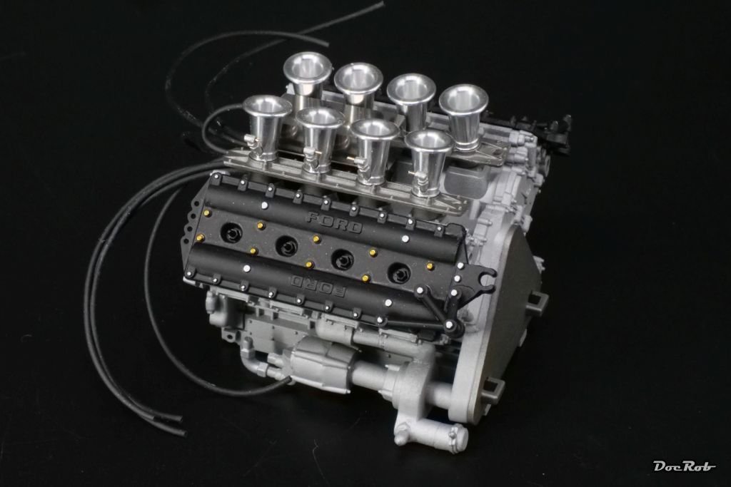

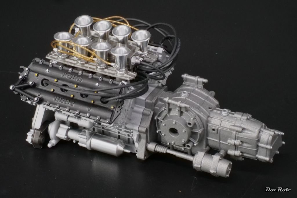

Engine and gearbox are halfway done. I used the MFH air funnel and distributor set, which is a big advantage against the kit plastic parts, specially the aluminum funnels. I also used black tubing from the spare box, the Tamiya material is too thick. I now own a silver pencil, but pictures show, that the Ford branding wasn´t silver with the 72d. All paints are from the Tamiya LP range and the screwheads were picked out with markers.

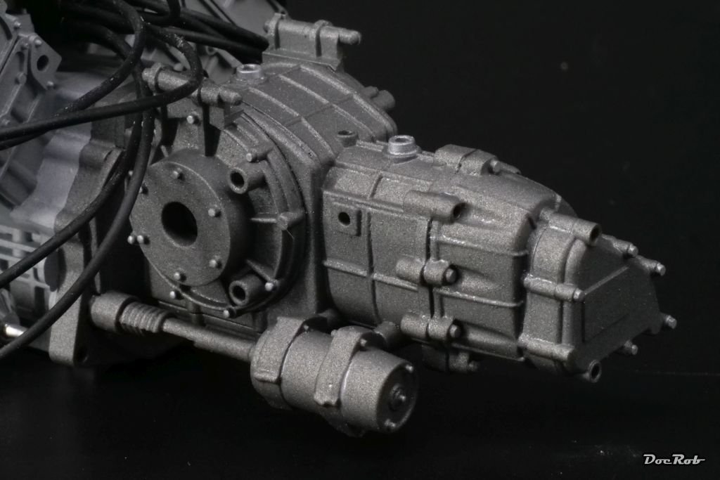

The gearbox was painted with Zero Paints texturized color for Hewland gearboxes.

Thank you Carl, it´s sad to hear, there is no way to get Zero paints to Canada. I really like the texturized paint. Sprayed with a 0,4 mm nozzle and a bit higher air pressure, it gives a convincing finish, at least for 1/12 parts. I didn´t use it for my 1/20 builds lately, it would have looked out of scale.
2 hours ago, KevinM said:
Looking good Rob and yes it looks like cast Al!:unworthy:
Thanks Kevin, I used the texturized color only for the gearbox, for the engine housing, I found it too coarse.

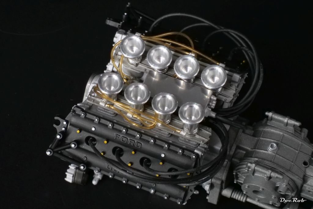

Today, I finished the engine and connected all the tubing. The yellow clear fuel lines were part of the MFH set, the black ignition cables were from the spare box, because the Tamiya supplied ones looked way too thick and out of scale. The MFH set fits the Tamiya plastic without the need for tweaking, great.

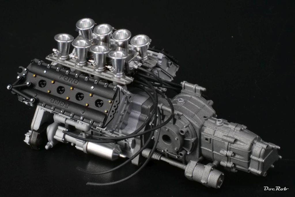

Finally, I married the engine to the gearbox and then to the body. Sounds easy, but isn´t. There are so many fragile parts intersecting, that you have to work out a good sequence. To make the rear suspension workable, it needs a higher skilled builder than me. I early skipped the idea of function and glued everything in place, specially after some of the snap fit connectors broke (old brittle plastic?).
I added some braided lines from Top Studio instead of using the thick rubber hoses, Tamiya provides. I also added coil springs as air intake fasteners, which I found in the spare box.
