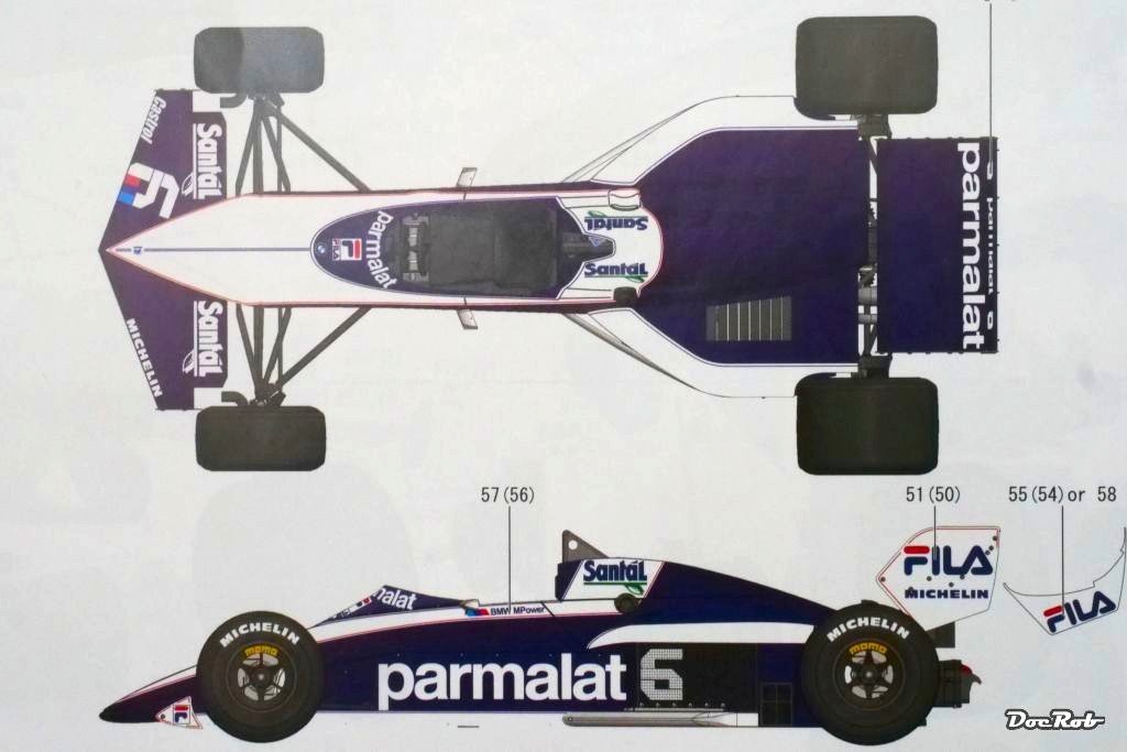

DocRob Posted February 13 Posted February 13 The BT52b will be my next project. It will be straight out of the box, as MFH kits doesn´t need any aftermarket items, except some paint to match the decals, whjch in my case are produced by Number Five paints. The Brabham BT52 was a very radical development with minimal bodywork and maximum power, in fact, it was the most powerful Formula One car ever and could generate up to 1400 horsepower in qualifying setup. With only four cylinders and 1,5 liter displacement, the BT52 was not easy to drive with it´s huge turbo push. In 1983 the BT52 and BT52b had some success with Nelson Piquet and Ricardo Patrese in the Cockpit and Piquet winning the driver championship in the last race in South Africa. The minimalistic missile like design, the blue and white livery and the relative low price for a MFH kit attracted me. It´s not one of their newer releases and I found some white metal parts bent and some resin parts a bit ill fitting. The metal is soft and can be easily bent back and the resin can be filed and sanded to fit, but I didn´t had these issues with my other MFH kits. One example is shown here and if you build this kit, check it out early, as it will be hard to fix later. The cockpit tub receives two side fairings (shown below). You need to remove about 1mm, where the blue arrows point. There is a PE part to be added later, which is the perfect template, to show how much and where the resin needs to be removed. Other than that, the prep time, before you really start a MFH kit can be a bit patience testing. Checking if all the parts are there, cleaning the white metal parts in the tumble cleaner, spread them out to dry and sort them according to the parts list and manual into sorting boxes. The first steps of this kit include some equally tedious tasks. There are dozens of holes to be drilled, to accept rivets, which have to be pushed through the carbon fiber decals. I hope this will work. The CF-decals need to be cut to fit from a supplied decal sheet using an also supplied paper template. Like with all kits, test fitting is essential, specially with MFH kits. You have to understand, how everything fits and intersects, to get it right. Here are the main body components, which show a good fit, at least after the above mentioned adjustments. The cockpit cover on the left (picture above) is a little warped, but I think it can be glued down with some clamps without heat treatment. Cheers Rob 9

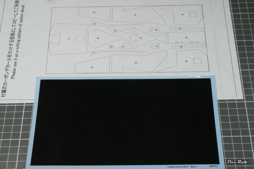

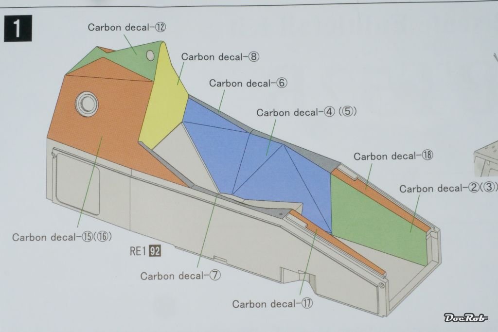

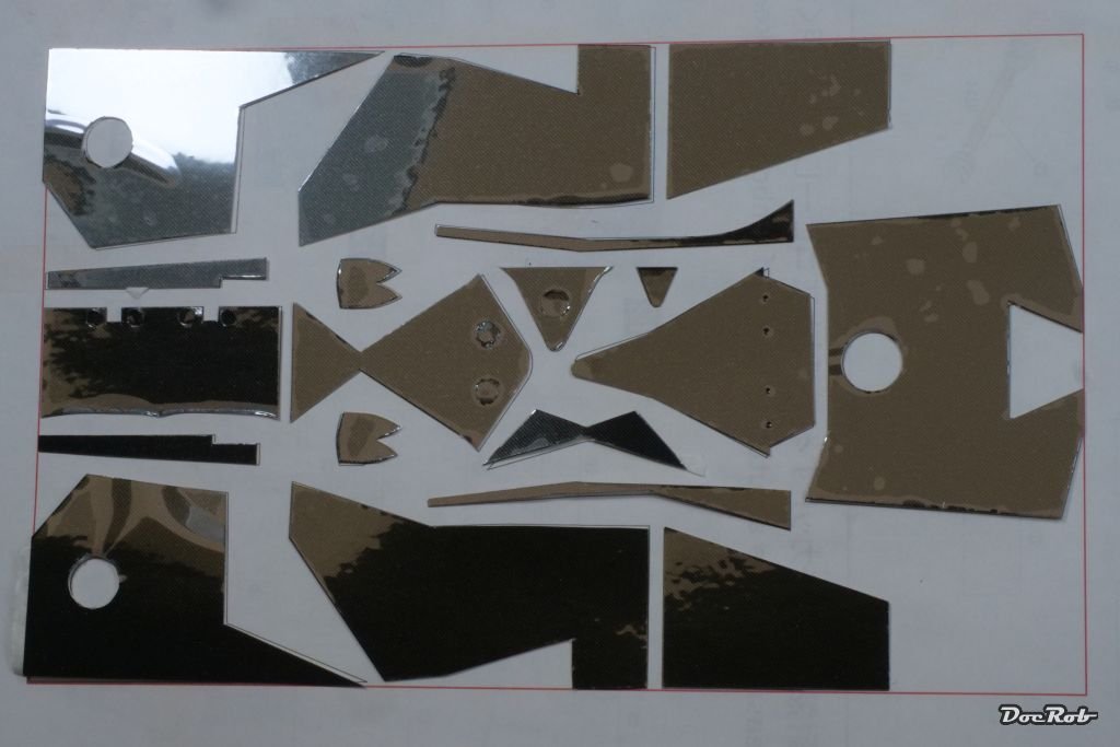

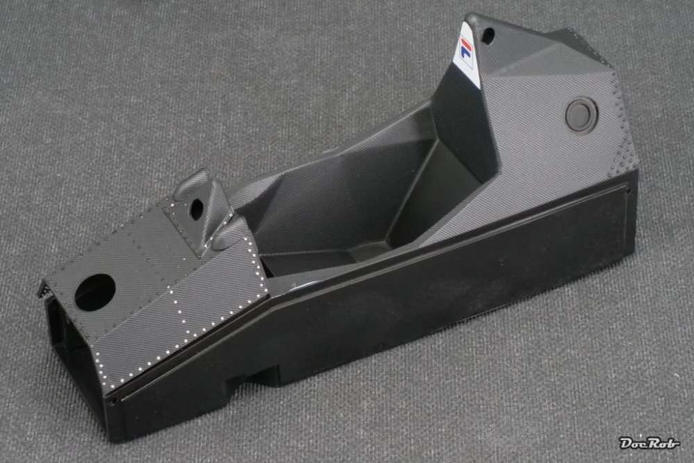

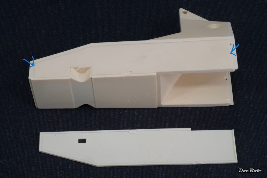

DocRob Posted February 16 Author Posted February 16 I want to have some of the daring steps out of the way and therefore started with the monocoque. After drilling all the holes for the rivets and necessary clean up, slight sanding, I washed the parts in soapy water and finally sprayed them with my trusty Tamiya LP-1 gloss black, to have a good base for the carbon fiber decals. One sheet of CF-decal is supplied along with a paper sheet as a template. I cut the copied paper sheet to the same size as the decal sheet and fixated them together with kabuki tape, to have no movement while cutting. Some hours later, I had all the pieces cut out with a fresh blade and a 3mm punch for the four small holes. The larger holes were cut by hand MFH kits from the pre Cartograph era have a protective clear foil over the decals, that´s why they are so reflective And this is, how they should be applied. I have to say, I really love pre cut CF-decals a lot. Cheers Rob 8

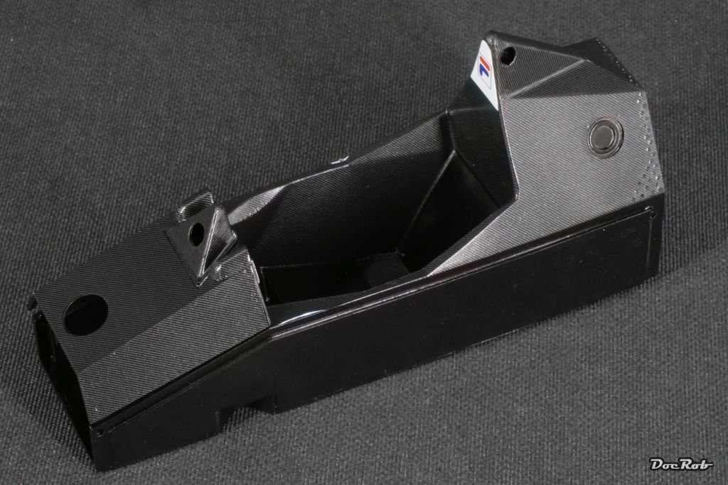

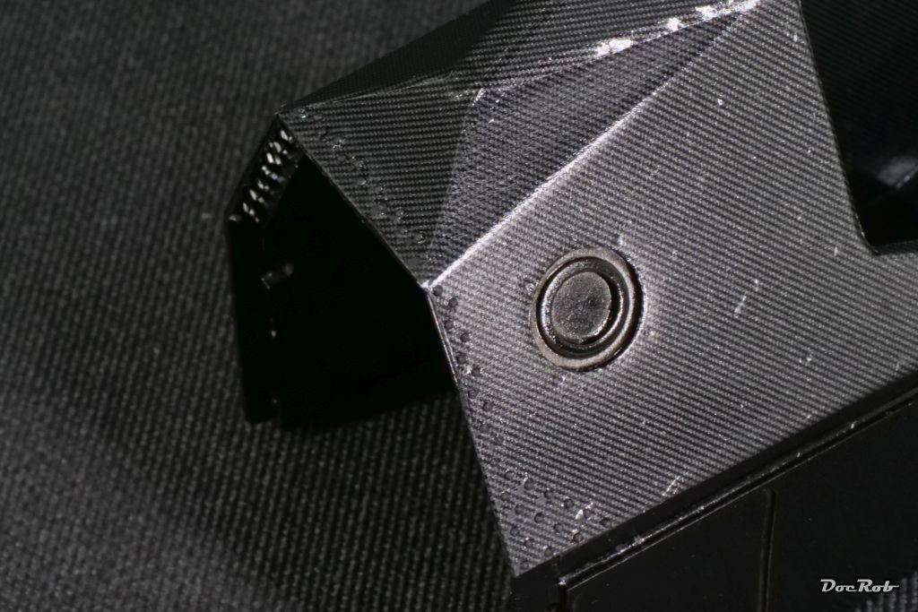

DocRob Posted February 19 Author Posted February 19 I finished with the carbon fiber decals, which I cut in the former step along the supplied template. The carbon fiber decals are titled silver carbon, type 1, which interestingly is used for 1/20 or 1/24 scale. To me the fiber pattern looks very good and the templates were very exact luckily. Despite the decals behaving very well with just a bit of soapy water under, I have some tiny blemishes, but these will be less visible after a matte coat of varnish. I also applied the first set of dozens of rivets into the backside of the monocoque. The heads of the rivets were painted black beforehand according to my reference. Cheers Rob 8 1

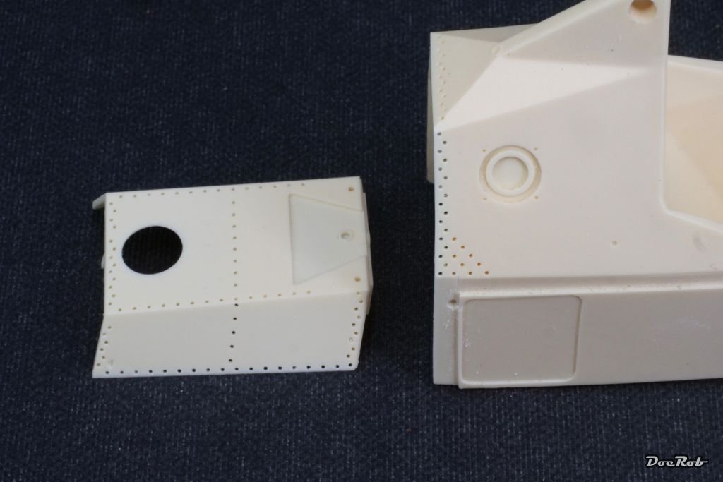

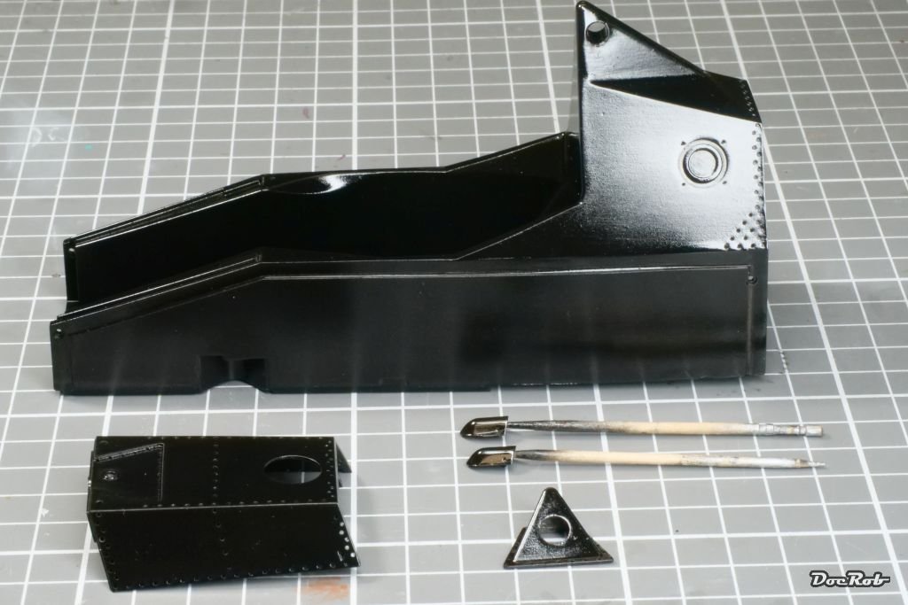

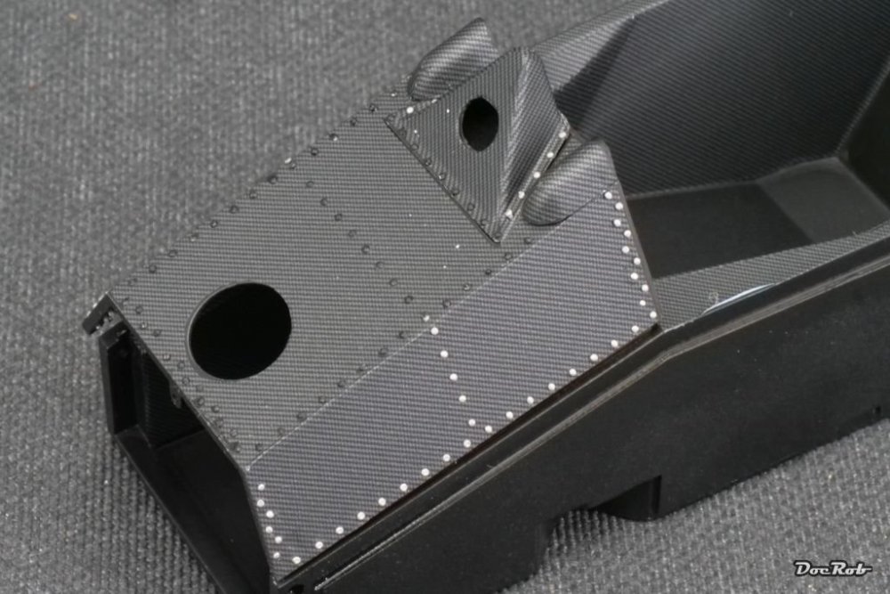

DocRob Posted February 21 Author Posted February 21 I can´t see rivets anymore, phew. I managed to add all the rivets for the monocoque. Strangely the supplied ones were short by ten or so, but I had spares left from my Cobra Coupe. I painted some of the rivet heads black and left others in metal, according to my Komaki reference book. Before adding the rivets, I used a steel needle to punch through the decal, which worked without issues. There seems to be something with every step of the build and here it was the matte coat, which left some strange white residues in some spots. I can only assume, these were drops, unseen and translucent when sprayed and visible after drying. I may lay another layer of thinned matte coat on top, but try first with a tiny brush. Speaking about matte coats, I always have trouble to find them working properly. In this case, I used Tamiya LP flat clear, but tried AK Real Color flat clear before, which worked well on other projects, but not this time. I also tried Winsor and Newton matte varnish, which also wasn´t up to the task. Cheers Rob 8
BlrwestSiR Posted February 21 Posted February 21 I wonder if the matter finish is being affected by temperature and/humidity. I've had matte get a frosty look when it's too humid out. 2
DocRob Posted February 21 Author Posted February 21 3 hours ago, BlrwestSiR said: I wonder if the matter finish is being affected by temperature and/humidity. I've had matte get a frosty look when it's too humid out. Thanks for that Carl, it was my suspicion for a long time, that humidity has something to do with my matte coat issues, as well as some clear coats like GX 100. We had a crazy day today, temperatures in the night about 10 degrees Celsius in the day varying between 15 and 25 degrees Celsius, but the real crazy thing was the humidity, which was about 90% in the morning, about 15% on midday and back to 85% in the afternoon. We have a climate change from the usual 80-95% humidity to Calima caused dryness of 15%-20% humidity. Calima is a (often) a storm from the deserts of Sahara, but this time there was no wind. Cheers Rob 4

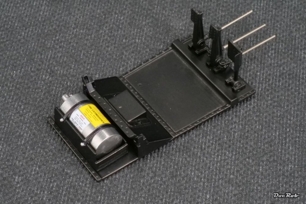

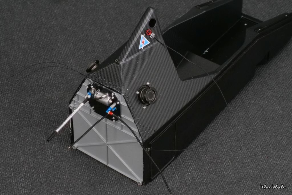

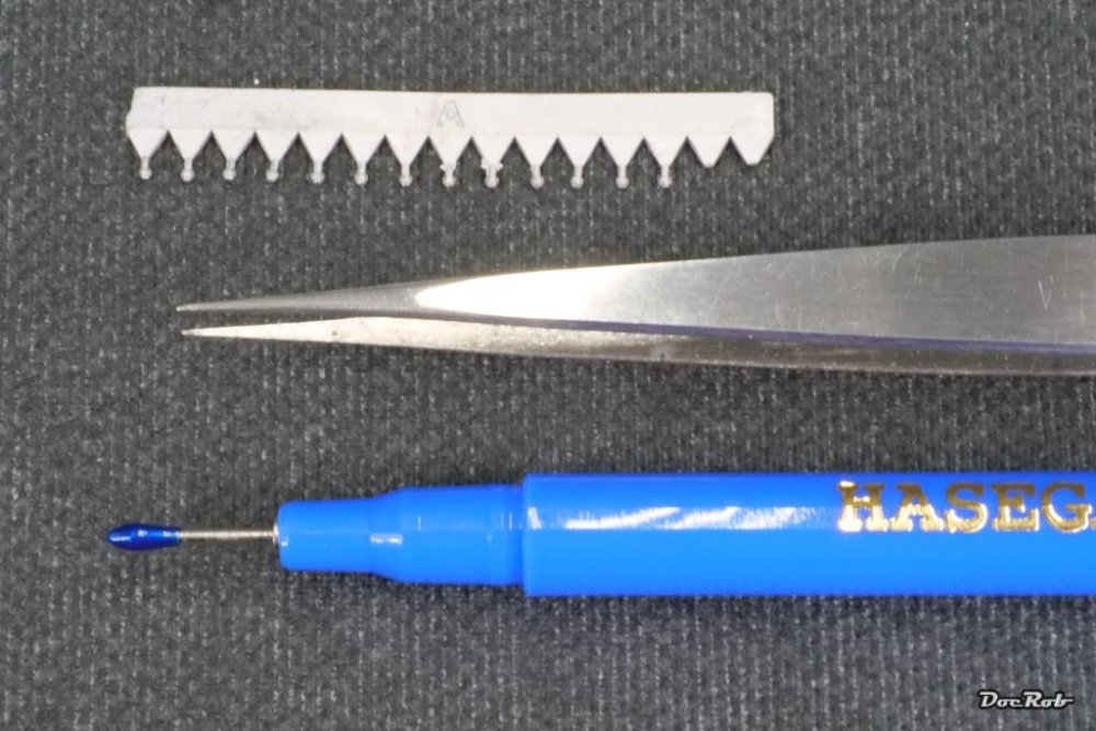

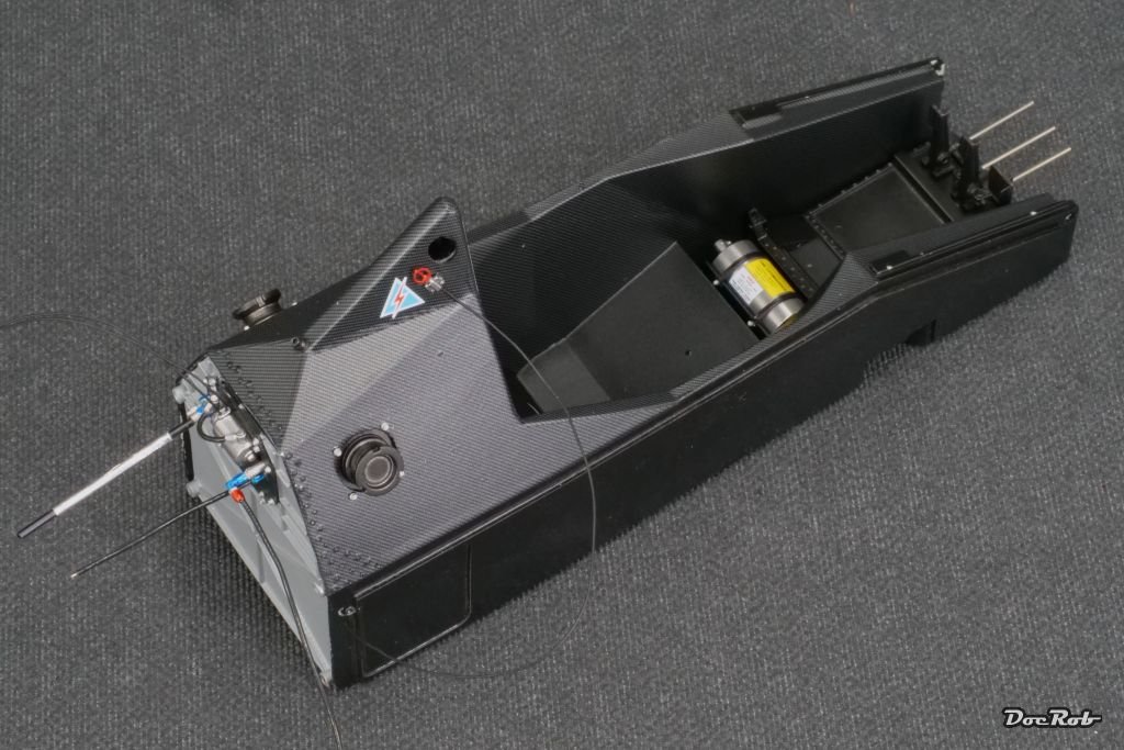

DocRob Posted February 28 Author Posted February 28 After loads of prep work, I have finally some progress to show. I usually prepare all the parts needed for the next three or four steps in the manual, to get a grip of how everything fits together and which order is best. Preparation means, drilling a LOT of holes, sanding and filing parts smoot and to fit, TEST FIT and then priming and airbrushing. As there is a lot of blackness in the monocoque, I used an airbrushing technique on top of the brushed on clear metal primer, to slightly break up the dull blackness. I spray the semi gloss black Tamiya LP5 highly thinned at about 50% with leveling thinner. After application, everything is black, but during the curing period the protruding parts slightly get a hint of metallic sheen looking through. The floorboard with the fire extinguisher looks simple, but wasn´t, due to the extremely fragile belts around, fitted with super tiny rivets, not an easy task. The firewall got detailed and again, getting the tiny rivets in place was an eye straining task. They are about 1,5 mm long in total and you need good tweezers to place them correctly. I added all the hoses and wires, which will be connected in later stages. The monocoque in it´s actual state. Cheers Rob 5 1

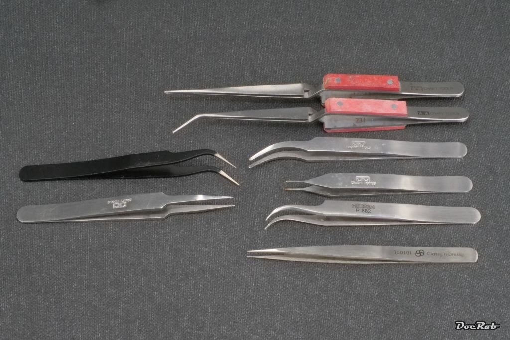

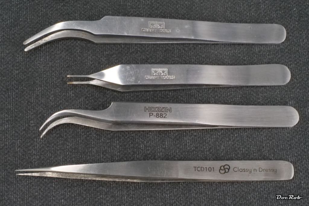

KevinM Posted February 28 Posted February 28 3 hours ago, DocRob said: They are about 1,5 mm long in total and you need good tweezers to place them correctly. I added all the hoses and wires, which will be connected in later stages. What qualifies as good tweezers in your world Rob in mine they all suck.... 4
BlrwestSiR Posted February 28 Posted February 28 Most of my tweezers are probably best called twangers for the sound they make as parts go twang flying off then. 3 1
Count0 Posted February 28 Posted February 28 19 minutes ago, KevinM said: What qualifies as good tweezers in your world Rob in mine they all suck I can't (won't) answer for Docrob but for me these are the best I've tried. https://www.hlj.com/non-slip-stainless-steel-tweezers-with-round-tip-goose-neck-type-mne217-h I liked them so much I ordered a set of the straight tip as well. The little laser cut grips really work. And they feel nice in my hand. 1 1
DocRob Posted March 1 Author Posted March 1 12 hours ago, PanzerWomble said: Your patience far exceeds mine , and pays off in results !🙂 9 hours ago, belugawhaleman said: Nice work Rob😀 Thank you PW and Paul, most parts of the MFH kits are not overly difficult to build, but as you mentioned PW, patience is necessary. The kits seem to be overwhelming at the beginning, but with some discipline and a good building process, all is manageable. I´ve built plastic models with higher swear factors, but the MFH kits are definitely more rewarding than these. Cheers Rob 2
DocRob Posted March 1 Author Posted March 1 11 hours ago, KevinM said: What qualifies as good tweezers in your world Rob in mine they all suck.... 11 hours ago, BlrwestSiR said: Most of my tweezers are probably best called twangers for the sound they make as parts go twang flying off then. 11 hours ago, Count0 said: I can't (won't) answer for Docrob but for me these are the best I've tried. https://www.hlj.com/non-slip-stainless-steel-tweezers-with-round-tip-goose-neck-type-mne217-h I liked them so much I ordered a set of the straight tip as well. The little laser cut grips really work. And they feel nice in my hand. Well hombres, I had to laugh about the twanger thing , but it´s part of the tweezer reality. I have lots of tweezers and use them permantely for different type of builds. There are wooden ships with rigging, WWI biplanes with rigging and of course the MFH kits with tons of rivets to set. Strangely some well made tweezers are worse than others, which were much cheaper, there is no way, other than testing. On the right side are my good tweezers for different causes, the lower you get, the more useful they are. The ones on the left are twangers, and the lower one from Tamiya looks good and is well made, there is no obvious reason for not trusting it, but it´s a fail. These, I use permanently, with the second from above being especially helpful with turnbuckle tubes for WWI planes and for bending tiny PE parts. My relatively new kid in town is the one on the bottom, where despite the sharpness of the tip, the twang factor is relatively low. Here is where I bought it: Classy 'n Dressy Tenir Tweezers (Standard) Here is a picture, showing some of the tiny whit cast rivets of the kit. You can imagine, how hard it is to grip these, apply CA glue and let them slide into their tiny hole. BTW: I frequently hone the inside of my tweezers tips with a fine sandstone, after freeing it of CA residues with a blade. Dirty, ragged tips are the number one culprit, making tweezers to twangers to my eye. The Hasegawa small parts applicator with it´s sticky tip is not tested yet, but will soon, lets see, how that compares. Cheers Rob 1 1 1
