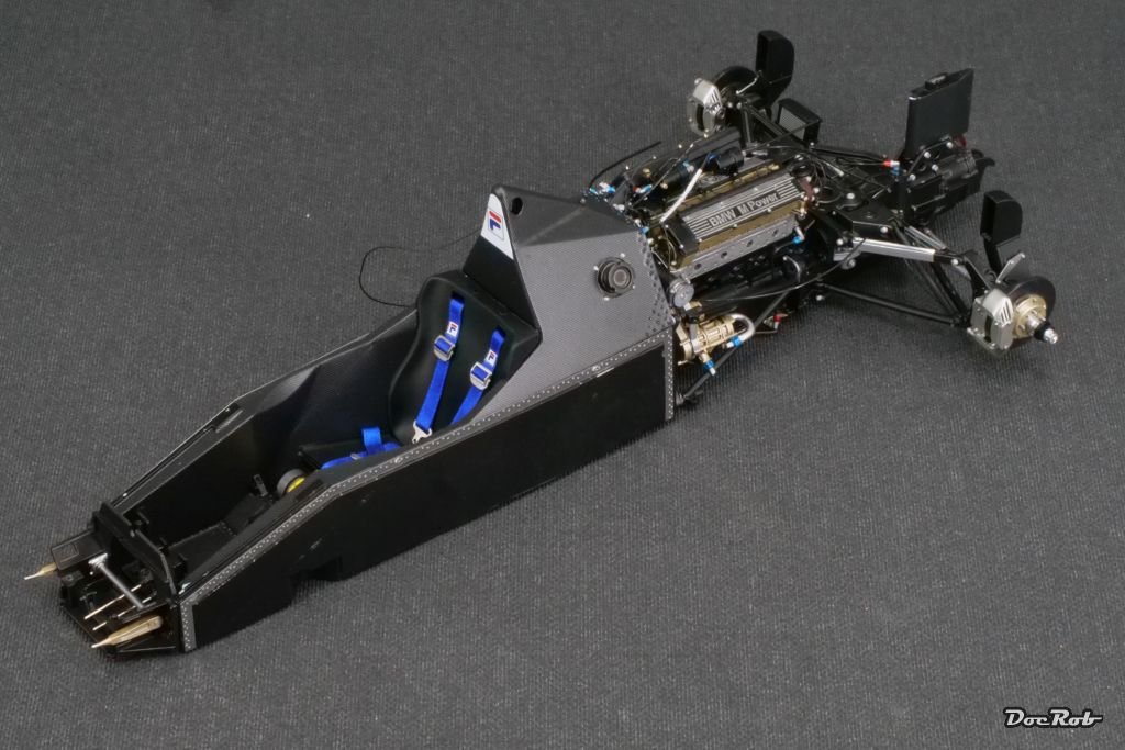

Starting to get into a kind of building flow, big decisions block my progress, but nonetheless, some steps were finished. I added the first front part of the suspension housing, seat and seatbelts. The latter are a joy to assemble, compared to lets say HGW belts. MFH supplies double sided adhesive type for assembly and placing the belts, easily done. The seat parts are made from black rubber and there is no need for painting.
I also added some PE frames for the sideskirts, which can hardly be seen on the picture.
The next step would be adding the prepared front suspension, but wait, one of the arms needs to be fiddled through the sideskirts, which needs to be painted in bodycolor. I want to prepare and airbrush all body parts together, to prevent color variations and I´m not up to do that now, which means, I will start with the 1500 horsepower heart of the missile soon, plan changed.

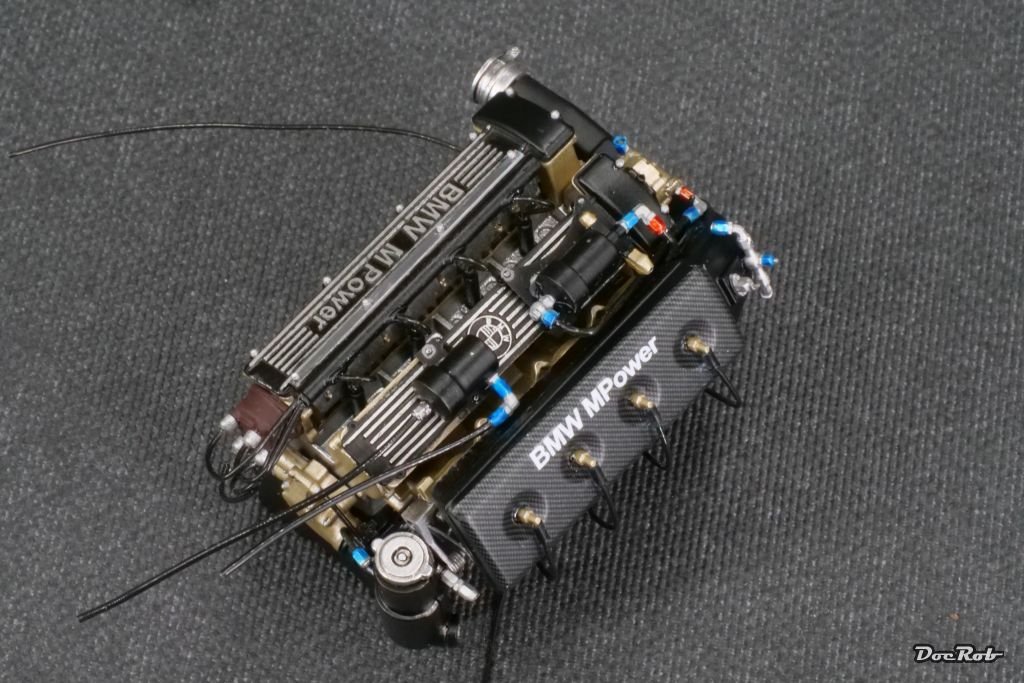

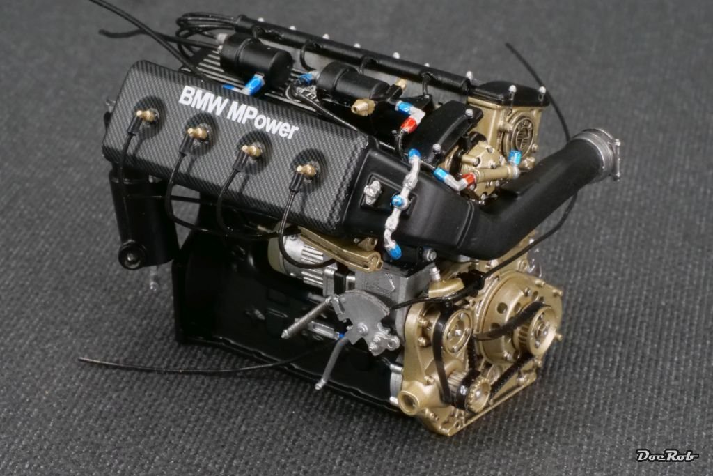

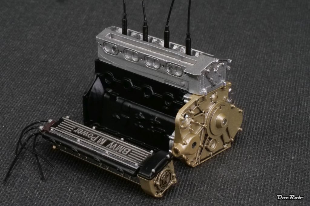

With the recent flood of car builds here, I have to swim with, showing a little progress. In fact, I´ve been working hard to clean up, drill, prime and paint or decal all engine parts. There are a lot of parts and the assembly will be delicate. There are some drawbacks though, e.G. the black tube for the ignition harness should be fixed to the BMW MPower part with what MFH calls UV band. These are like 3D-decals, extremely brittle and nearly impossible to get them around the part and riveted into place with super tiny rivets. I will fake this later with some wine cap foil, as I broke the bands.
Second obstacle id drilling numerous tiny wire connectors to accept 0,8 mm wire. They are so small and sometimes not so well cast, that it is nearly impossible to drill them without causing damage.
But now, all this is done for the engine, I start to assemble it
Colors are AK Extreme Metals aluminum for the silver parts, Tamiya LP titanium gold and Tamiya LP-5 semi gloss black. The lettered parts were scraped with a tiny sharp chisel, to remove the black paint on top. Tamiya black panel liner was used for accentuation and nuts and bolts were painted with a silver marker.

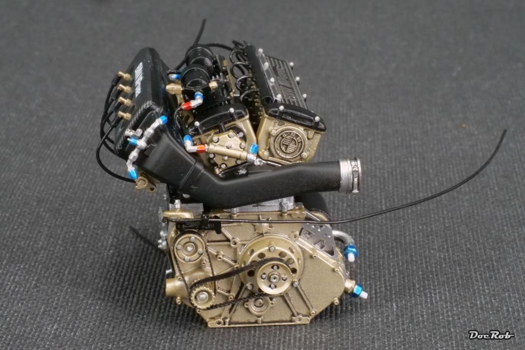

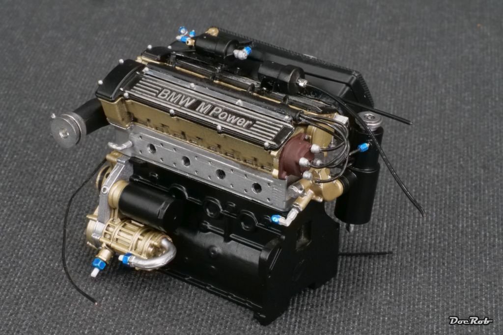

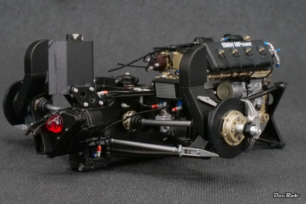

The engine is nearly done, missing only some details and some wires and tubes, which I will add later. Speaking of wiring, the manual is terrible, showing, where a wire starts, but often not, where it leads. This means permanent page turning in the manual, and often, I can´t find the receiving end. Another complain is the 0,8 mm wire which is very rigid and therefore difficult to fit. Some other aspects of the kit are a bit annoying as well, like the suggestion to butt glue 0,6 mm ignition wiring onto the 0,6 mm end of the spark plugs, impossible. I made tiny connectors from vinyl tube from my spare box.
With a rest of the supplied carbon fiber decal, I applied the CF onto the airbox (?), because my reference shows it belongs there instead of being painted black.
In this state, the engine is very fragile and I permanently broke some parts or wires loose.

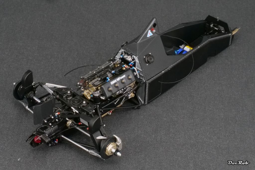

A mock up pic with the monocoque laid in front:

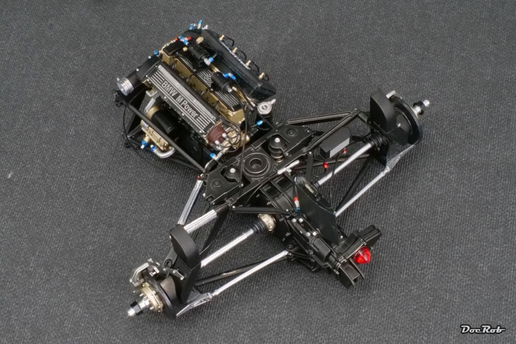

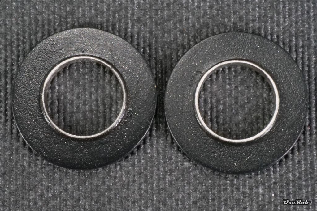

Only to show, why it takes some time for the next bigger update. These are the parts for the gearbox and rear suspension cleaned up, drilled (the most time consuming part) and ready for primer and paint.

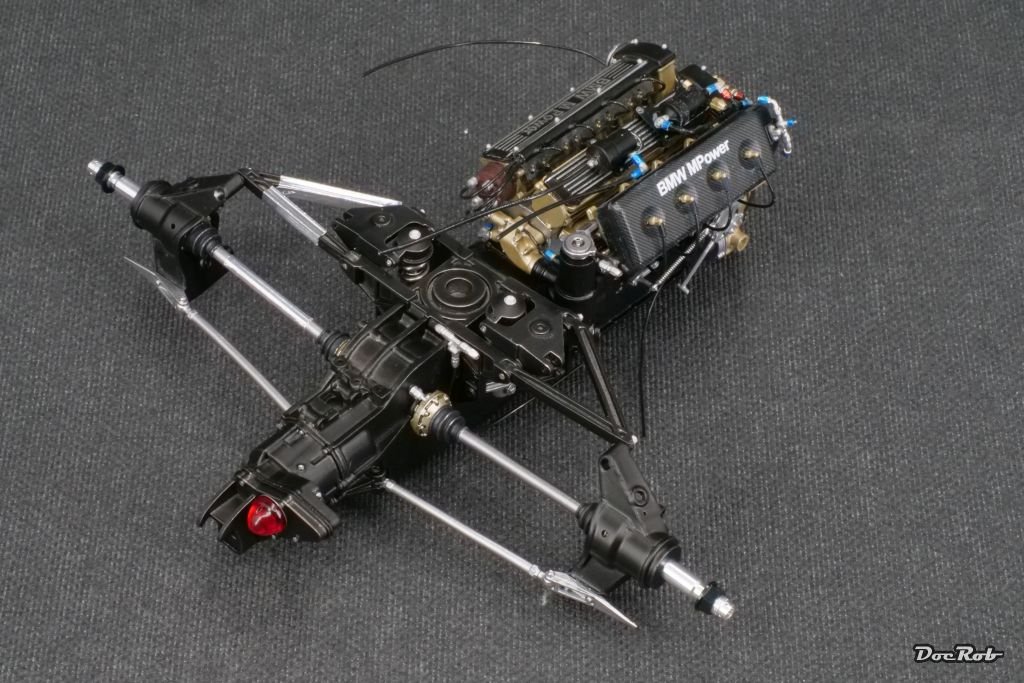

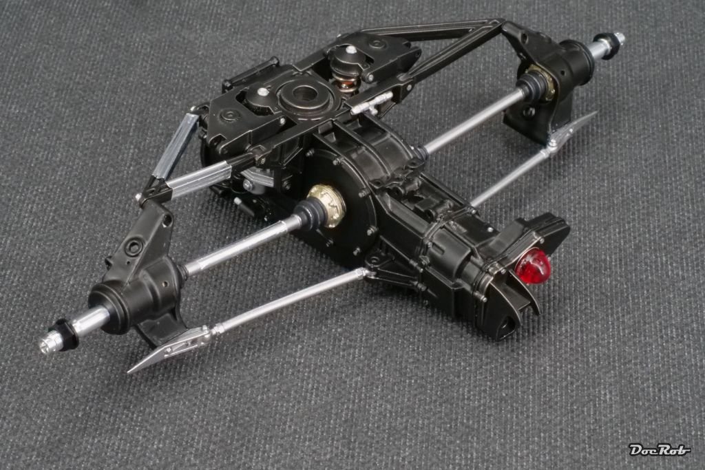

Again it is cash in time, my favorite part of MFH builds, when all the necessary parts for a section are prepared, drilled and painted and ready to assemble.

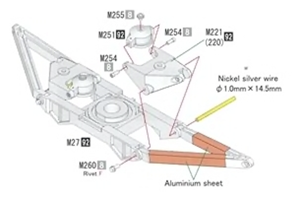

The gearbox received lots of the suspension parts, absolutely trouble free and relatively sturdy and good to handle. The aluminum foil on the suspension arms and axle on one side is provided with the kit as self adhesive foil.
Here you can also see, how I work with semi transparent black color over metal or silver priming, to let the parts look more interesting and scale wise more correct than deep black, which to the eye nearly never exists.

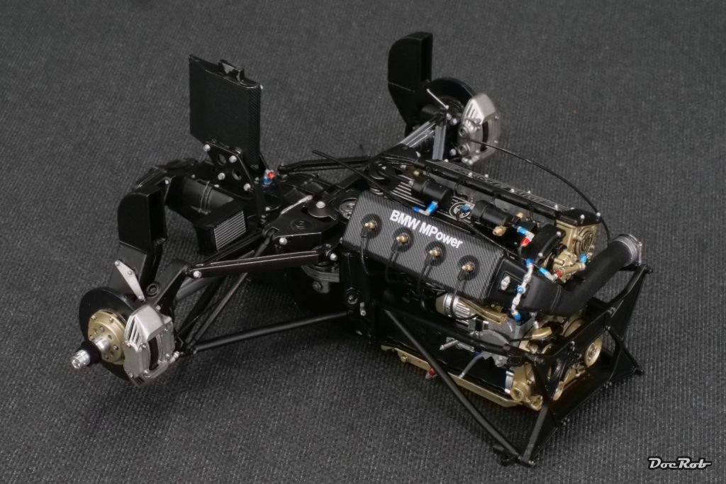

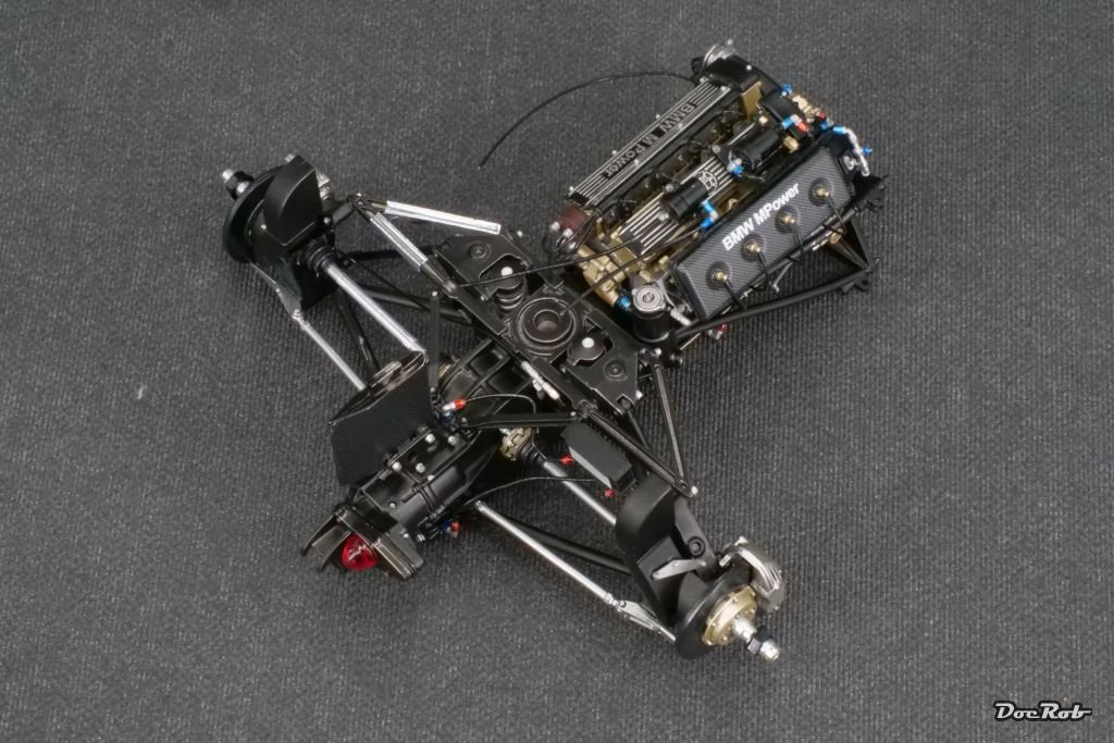

A mock up shot with the engine:

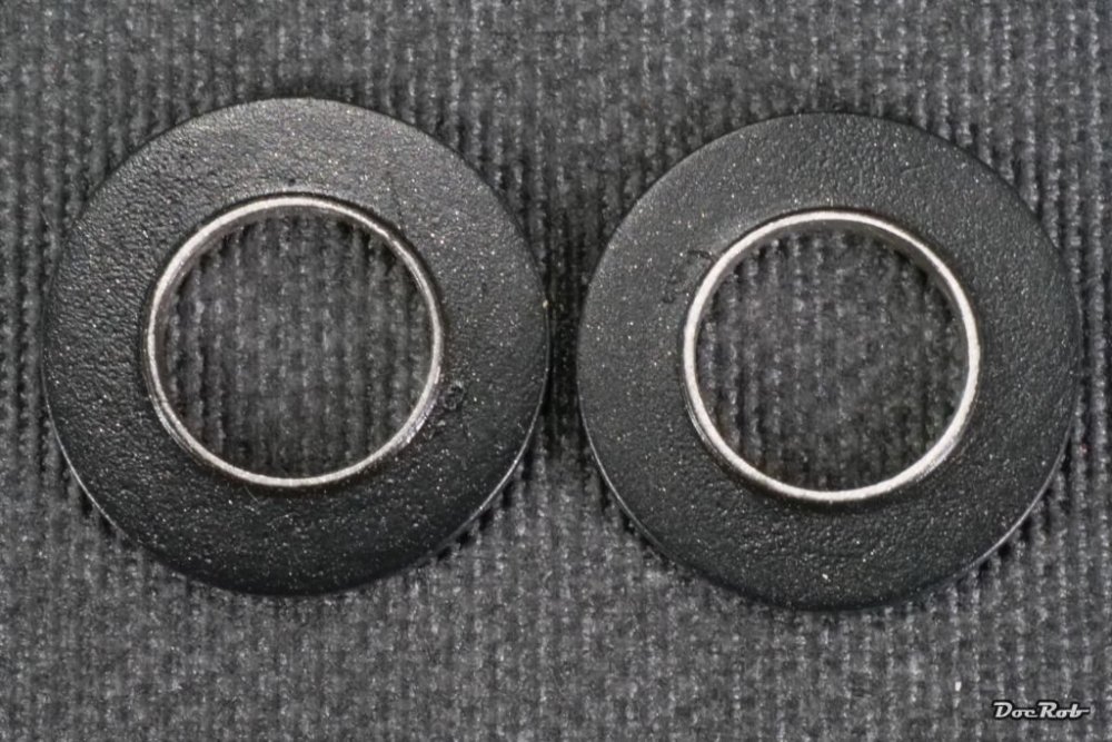

For the first time, I used Zero Paints carbon ceramic grey paint for the brake discs and I really like the effect:
Are they Carbon this early? I guess I could ask the internet, but I'm lazy.
Can´t tell for sure, which type of brake discs were used, the race, I plan to build the BT52b for. They were using carbon disc brakes for testing, maybe for races as well and I was eager to test the carbon paint. Both types of brake discs are included in the kit.

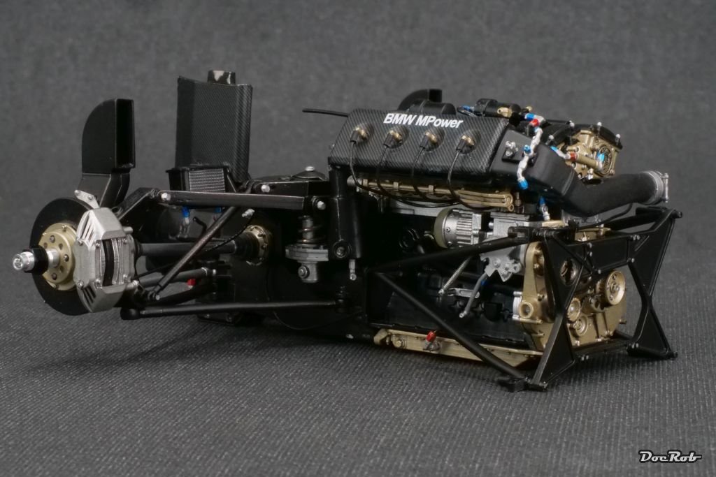

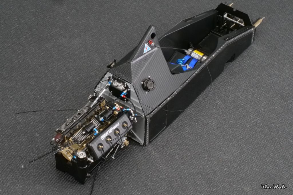

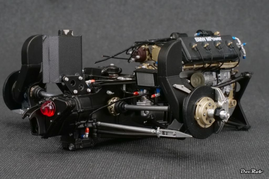

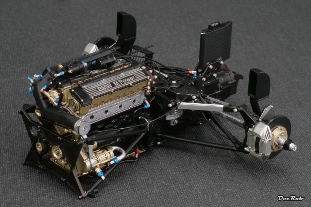

I got some more steps completed. I finished the brakes and suspension, added a radiator, the tailwing post and some engine framing, along wiring and tubing.
If you ever build this kit, be aware, that the nickel silver wires are pushed deep enough into the holes and don´t end flush, because a peg from part M74 and M75 in a later step will be fitted into the hole. I´ve overseen it and had to do some surgery.
Finally the gearbox was glued and screwed to the engine block and now the rear section lacks only the turbo, the exhausts, some electronics and lastly the huge coolers. A spell of really ugly weather with storm and flooding rain acts as a building booster, always hoping, nothing flies away or goes submarine.

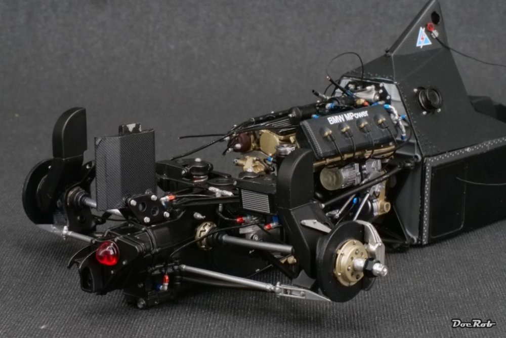

Some mock up pictures with the monocoque loosely added:
