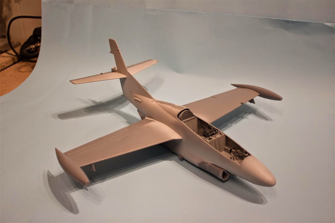

JaseGill Posted November 11, 2014 Posted November 11, 2014 Hi all, Just started this. Going to do it as a Greek one I hope, just love the scheme and the fact the Greeks seem to never wash their aircraft. I do like em dirty There is a lot of filler, a lot of sanding and quite a bit of undercoat, sand and re-coat on this. Could be a long build though I hope not, I don't want it to stall and have me put it away for a while. I just love the look of the Buckeye. I've got 2 more in 1/48 for Navy schemes but this one has to be Greek J. 6

JaseGill Posted November 12, 2014 Author Posted November 12, 2014 Final result could be a way off. Work nuts at the moment so spare time is limited right now. Hope to get some more done this weekend. Next challenge is cockpit transparencies and ejector seats J.

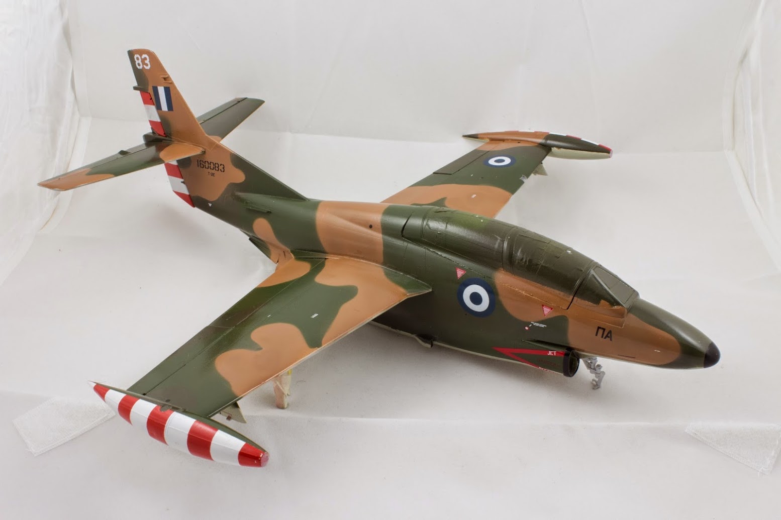

JaseGill Posted January 18, 2015 Author Posted January 18, 2015 An update at last. Paint is on, decals are on and its clear coated. Now for the fun bit, weathering. I had some issues with the decals which were a bit flimsy and some paint lifting with tape when masked, it seems to happen with me now and then with Vallejo. The clear coat is from Alclad and its amazing, hard wearing, goes down really easy and a couple light coats leaves it bulletproof. The only AM is metal undercarriage (love it and its a heavy kit too so needs it). Hope to get weathering during the evenings after work this week, though a big busy week at Heathrow Tower coming up which may get in the way a bit... J.
Administrators James H Posted January 18, 2015 Administrators Posted January 18, 2015 That looks great Jase. I wish you'd shown some steps in between too What a great looking machine. Those tip tanks are a work of masking art.
wackyracer Posted January 18, 2015 Posted January 18, 2015 Top work Jase. Lot of work in that paint job
JaseGill Posted January 18, 2015 Author Posted January 18, 2015 Thanks guys.I wanted to get a few pictures as I went but as usual the desire to get doing took over from photographing.It was masked by White Tack worms and then filled the gaps with plenty Tamiya tape. It lifted some paint and needed some touch up. Will take a few more pictures as I weather it and as I get on with it.Still working out how Im going to get it to look dirty Greek enough though. Too clean at the moment J.
