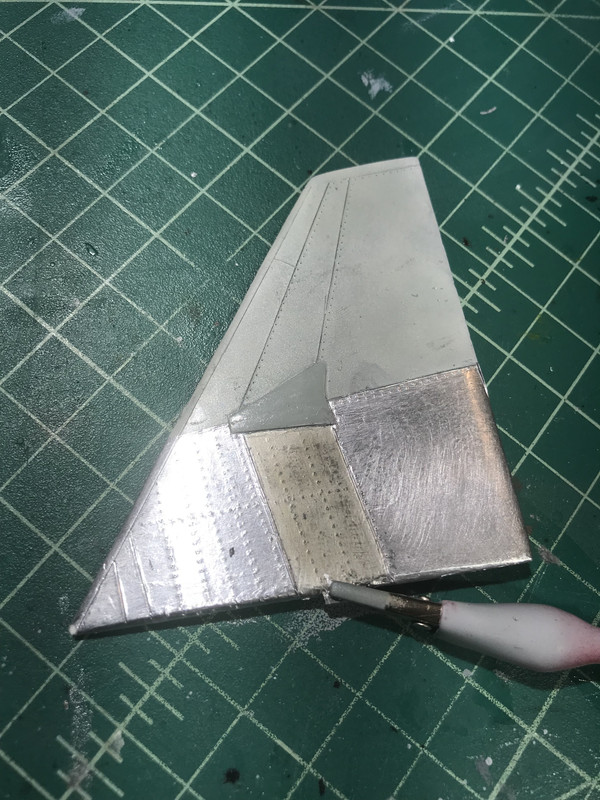

SapperSix Posted May 17, 2019 Author Posted May 17, 2019 10 hours ago, GazzaS said: I spent a little bit of time with VMFP-3 at El Toro. I can tell you that the area you've been detailing gets very sooty. Some black washes will hide your CA blobs, or you can try black and dark gray pigments, too. Gaz We are of the same mind here after my redux of the tail....Just finished the black gloss coat. I will be working some of the NMF today and have already made the black wash. I also bought some of the alclad jet exhaust. Also found some MM Jet exhaust and graphite metallic in my collection. I am going to try some coats on the test plane. I am finding NMF is its own thing..... 2

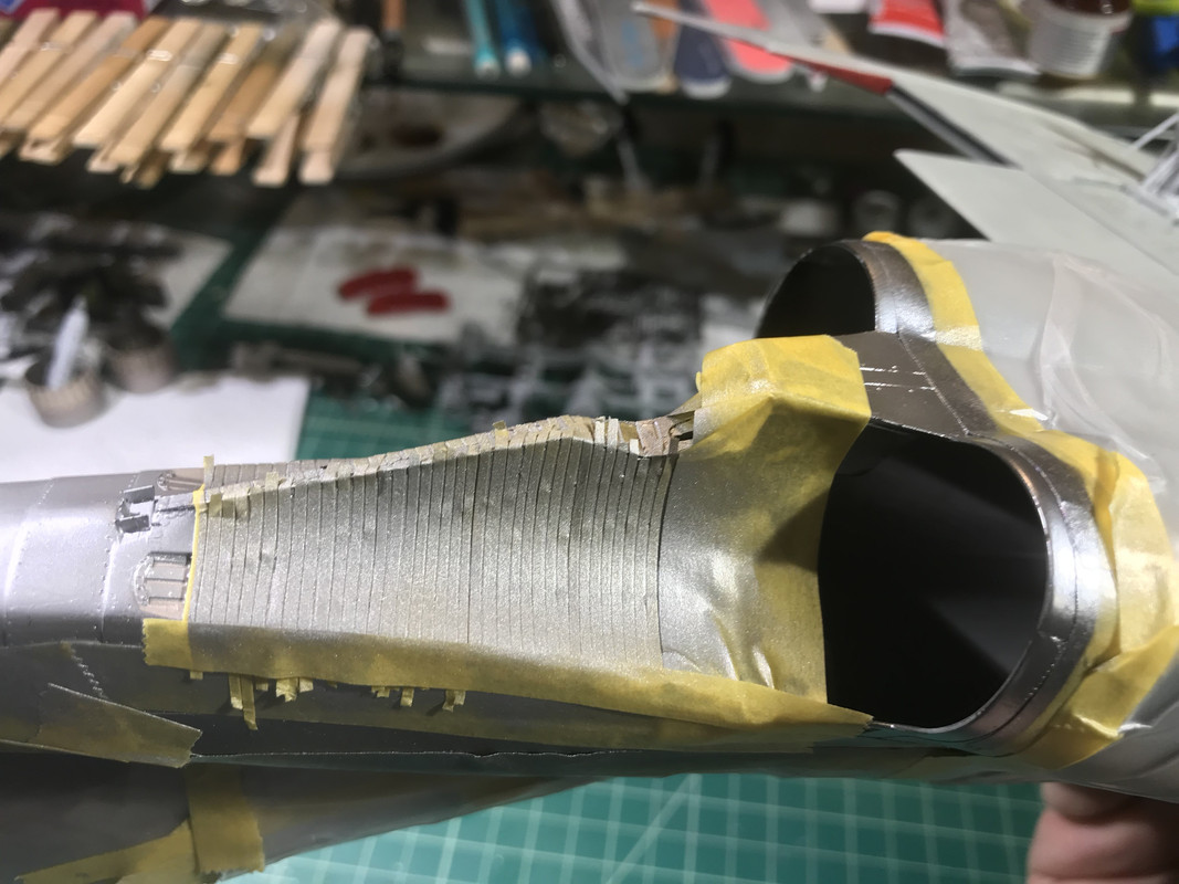

SapperSix Posted May 21, 2019 Author Posted May 21, 2019 Adding the panel lines to the tail. This is such a rivet counter moment. The more I learn and observe on this tail section, the more I realize it needs to be 100% rebuilt. I am going to do what I can without going backwards. I am short panel lines per section.....but that is just another issue with the lack and incorrect detail in this section of the plane. I learned a lot about creating consistent cuts and large amounts of patience. 3

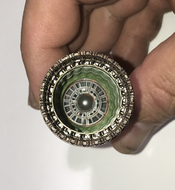

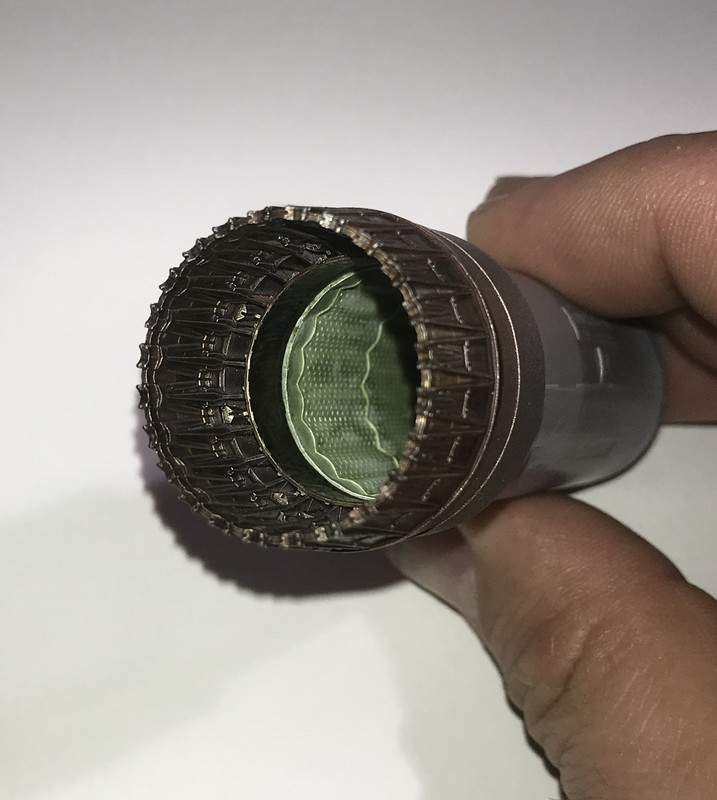

SapperSix Posted May 29, 2019 Author Posted May 29, 2019 The exhaust and the cans have been a learning curve for me. I can not emphasize enough how much I have learned while making this model. My tool and product purchases have also been undergoing a considerable increase. All equaling a joy for the hobby as never before. I do want very much to make clear that I appreciate the many people, all over the world, that have have offered advice and knowledge both publicly and through PM's. Below is an example of the general reference I have been using for inside exhaust coloring. My book from Reid Air, The Modern Phantom Guide, has been providing and enormous amount of detail. Below is the Phantom GT Resin kit that I have spent the last week detailing, messing up, starting over and having another go. In the references the green goes from a darker green to lighter as the distance from the burner increases. This picture tries to capture that variation. It was lots of patience during the dry brush process. The detail in this resin product is very well done. A light black/green wash will fill in the secondary air holes. I did it a small section with black only and the contrast didn't appeal to the eye. A bit of dry brushing to the cans and some pastels will finalize this effort. 3
GazzaS Posted May 29, 2019 Posted May 29, 2019 Wow...That looks great, Frank! Awesome piece of resin, too. Gaz 3
SapperSix Posted June 1, 2019 Author Posted June 1, 2019 On 5/28/2019 at 10:01 PM, GazzaS said: Wow...That looks great, Frank! Awesome piece of resin, too. Gaz Thanks Gaz, Its been real fun and a real challenge. 2

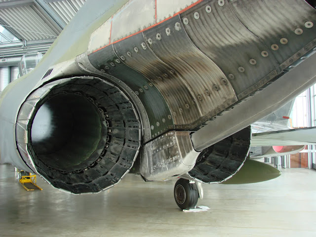

SapperSix Posted June 1, 2019 Author Posted June 1, 2019 4 hours ago, Martinnfb said: Martin, I really appreciate the pictures. There is a lot of nuance in there that I am going to use. The Revell has neither the right rivets nor does it have the reinforcement strips at the panel joints. While I see that many reference pictures dont have the reinforcement strips I think it will add some character. So thin plastic stock has been ordered along with a good punch set up.... From other references I have found, the color has not looked as titanium as it does in the above picture. Although, my reading clearly states is is a titanium metal aft. I had thought about going with the below coloring and weathering to which I found pictures at some forgotten location. In comparison, it seems pretty drastic to what little I have been able to find. Most aft sections I have found appear to be super clean museum pieces. 2

Martinnfb Posted June 2, 2019 Posted June 2, 2019 You are most welcome Frank, titanium alloy looks almost like regular steel alloy when new, it's surface changes dramatically with time. Punch set is a great tool, however I would use a beading tool. More suitable due its consistency and versatility. Also if I may suggest, the reinforcement stripes can be easily scribed, instead of applying thick stripes of plastic. 2

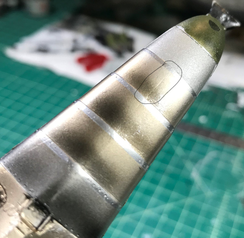

SapperSix Posted June 2, 2019 Author Posted June 2, 2019 Ordered the new beading tool a few days ago. As I figured I would need a few plans of attack. And with Gaz, and now you, saying they are worth the purchase I feel good about the move. As for the reinforcement strips, I happen to be scribing the main seem as it had grown shallow from other sanding. So if I had to scribe the actual seem, the reinforcement ones might as well get done as well. And hell, might as well do the rivets correctly. During my shade testing and color experimentation I noticed when I squeeze the Phantom ever so, the previously filled fuselage half seem came apart (Noted by the black penciled circle in the below photo). So this area is going to get a reset and fixed when all my assets are in place. I do very much appreciate your input and suggestions. Please mention any item you see that might need to be corrected or enhanced. I am here to learn. Input from knowledgeable people such as yourself is how I will get better and more accurate. Thank you. 3

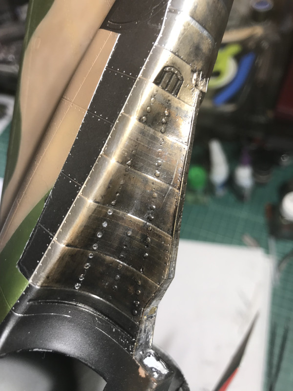

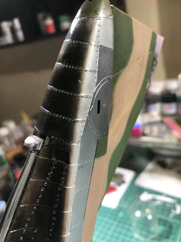

SapperSix Posted June 8, 2019 Author Posted June 8, 2019 Progress has been slow but productive. I finally figured out a path to the weathering for the war weary tail. Using Oils (burnt sienna, burnt umber, cadmium red, ivory black) a black and red brown wash, and Tamiya smoke. I re drilled the rivets and plugged them with a small piece of lead as noted in prior postings. After I sealed the base, post initial weathering, I went back with a bead tool to shape the lead plug. While I am sure there is a better way to do this, my initial push in to this lead down this path. In the end the initial shaping with the bead tool doesn't look too bad. My only complaint would be that the newly created rivet looks a little big compared to the washer. This picture shows the first lead plugs being shaped compared to the others that have yet to be shaped. Once shaped it will expose the lead color of the rivet making it easier to detail after a little clean up. Right side complete prior to detail and clean up. left side complete prior to detail and clean up. There is much still to do here. lots of clean up and detail. The aft section, past the tail hook, needs to be done up with rivets. Maybe I can figure a way to make the rivet smaller compared to the washer. In the end it will be blended with pastels to make sure its blended and given a much more flat look. 2

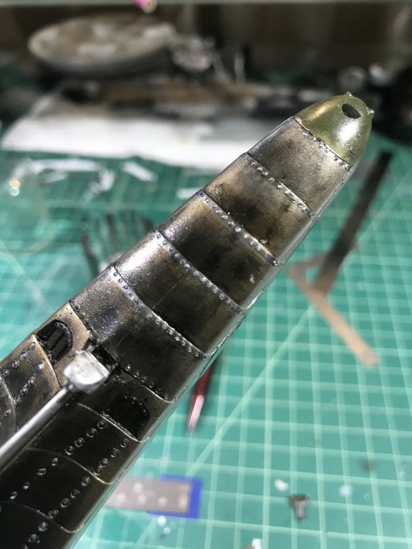

SapperSix Posted June 8, 2019 Author Posted June 8, 2019 Aft Section....The pressure of the beading tool spit the seem again...(sigh) 2
