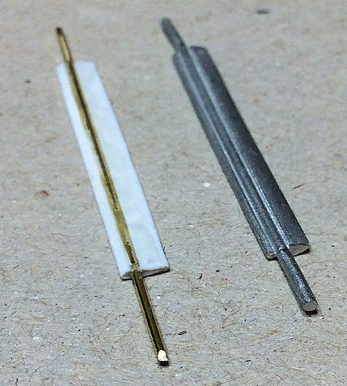

The landing gear and wing struts supplied in the kit are molded in white metal.
Consequently the landing gear in particular bends extremely easily and I suspect may not even take the weight of the model.
Therefore I recreated the landing gear struts and axle using brass tube, rod and styrene sheet.
The struts are 2.0 mm tube formed around 1.mm rod and soft soldered then filed and sanded to shape.
The axle is 2.0 mm tube crushed flat on one aide around 0.8 mm rod.
Styrene strips off 0.5 mm thickness were glued to the front and rear of the rod, then sanded to an aerofoil shape.
I'm not sure yet whether I'll replace the wing struts - we'll see,
Mike
5 minutes ago, Peterpools said:
Good decision on re4placing the white metal interplane struts - surely will pay big dividends down the line.
I second that, you can never have enough stability with these fragile airframes. Nice work with the brass as always, Mike.
