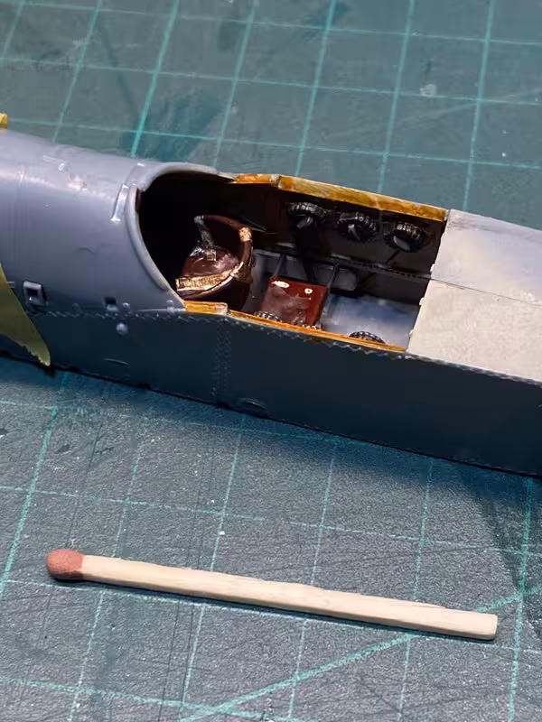

PanzerWomble Posted September 5 Author Share Posted September 5 Those that know from the Southwest , can pronounce Bristol as Brizzol..... Fits good , details good , that'll be Eduard then Not getting too carried away , when it's zipped up 99% of this won't be seen 10 Link to comment Share on other sites More sharing options...

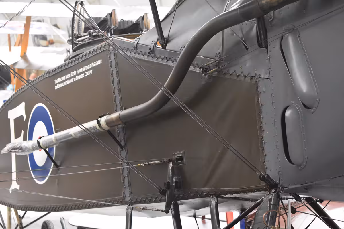

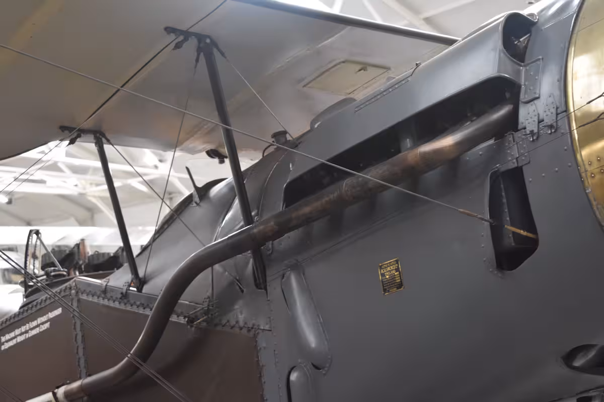

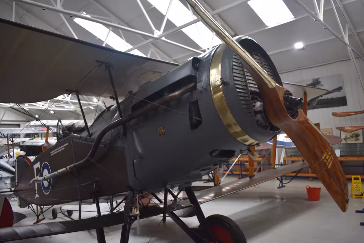

PanzerWomble Posted September 5 Author Share Posted September 5 Do love the Brisfit ...some pix I took at Shuttleworth in the summer . This one still flies ! 9 Link to comment Share on other sites More sharing options...

KevinM Posted September 8 Share Posted September 8 On 9/5/2024 at 3:38 PM, PanzerWomble said: Do love the Brisfit ...some pix I took at Shuttleworth in the summer . This one still flies ! Nice machine and some Nice work Guy! 5 Link to comment Share on other sites More sharing options...
