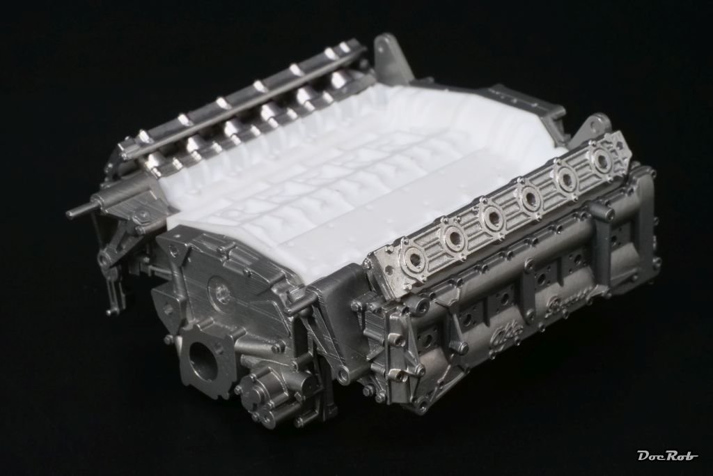

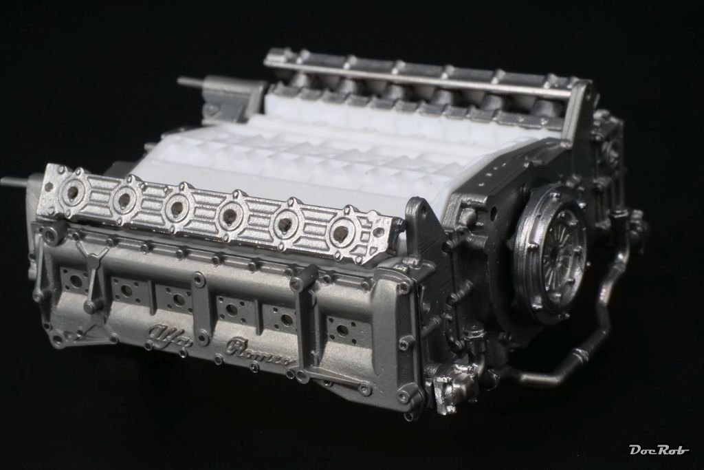

After about 150 or more holes drilled, most of the Alfa flat twelve engine is prepared for painting. Shown parts are only dry fitted, nothing is glued as of yet. There will be a ton of rivets been inserted into their holes after airbrushing.

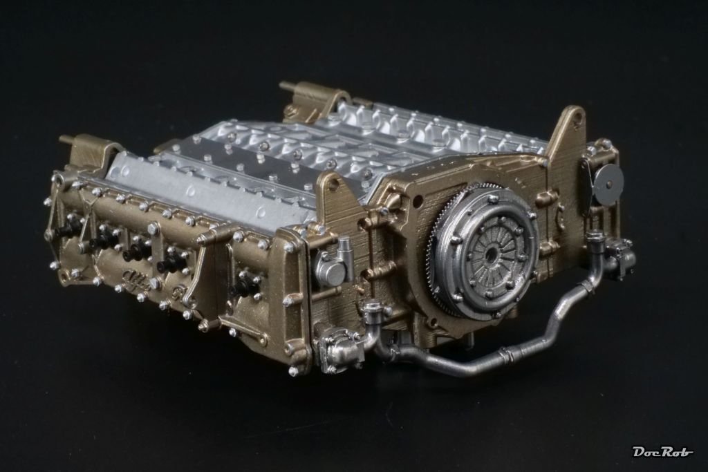

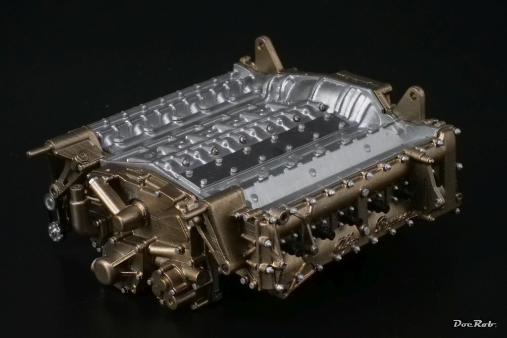

One bank of cylinders is prepared, still six to go on the other side. You have to love to apply tiny white metal rivets with this kit, as there are hundreds. The engine was sprayed with AK Extreme Metals dark aluminum, the covers, front and rear, were a bit more complicated. The manual calls for a mix of copper and gold and my first try was with AK´s jet exhaust, which felt to dark and to bronze, followed by pale jet exhaust, which lacked the slightly reddish tone. Finally, I choose Ak´s pale brass, which looks good to my, compared with photos.
Afterwards, I painted all the casted nuts and boltheads silver and applied all the necessary rivets with fine tweezers into their pre drilled holes, always expecting the "ping" sound of a flying rivet.
Finally, I accentuated white metal with black panel liner and brass colored parts with brown panel liner.
Cylinder bank number two is ready, again lots of riveting, always hoping that no rivets ping out of the tweezers. The rubber spark plug connectors got glued in and were drilled to accept the wiring.
This time, I used Tamiya metal primer for the first time, brushed onto the parts and it seems, that the metallic paint adheres well on the white metal.
BTW: Tamiya should use the MFH method for replicating belts. There are single cast belt wheels, the belt itself is made from self adhesive black tape.
One thing, I learned with MFH kits is the addition of springs. It´s always better to add the spring to the unmounted parts and glue these into place then.

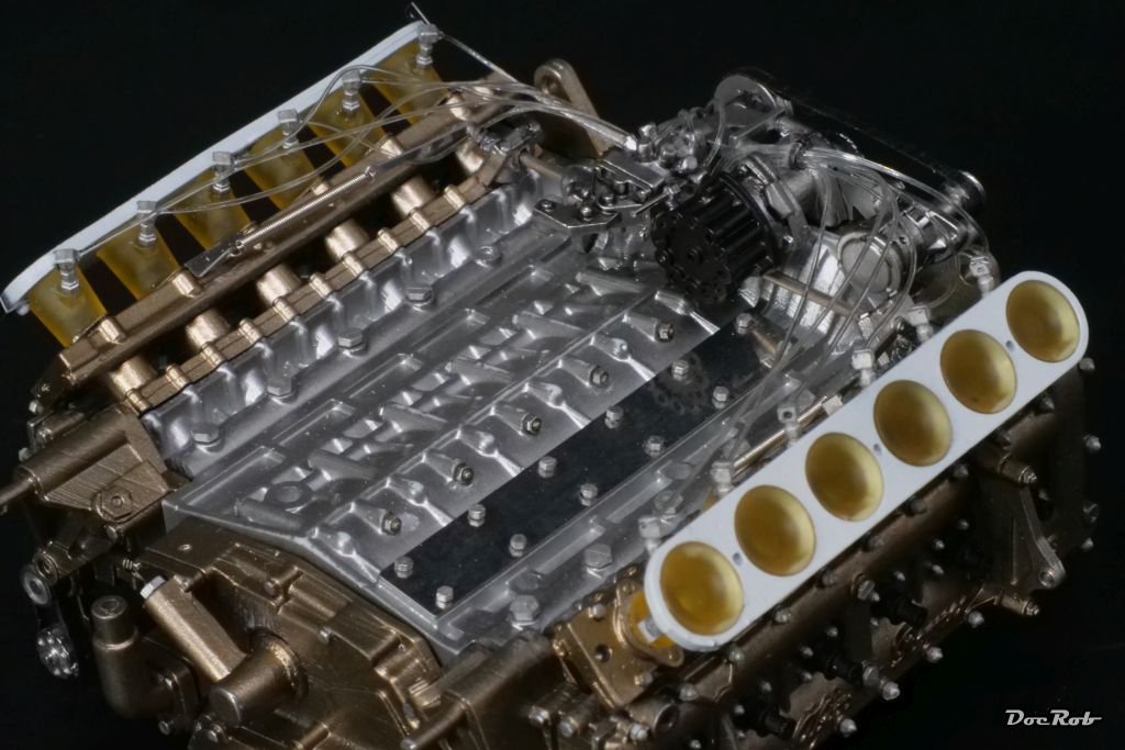

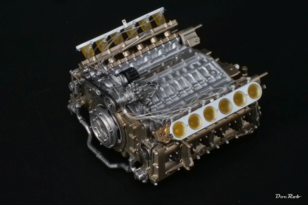

After checking all my MFH 1/12 kits about completeness, which is an exhausting task, I managed to continue with the Brabham. The clear yellow air funnels got installed, along with the clear fuel lines and accessories. This was a fiddly task, because it was difficult to determine the correct length of the fuel tubing.
I also installed the belts on the frontend, which were replicated by black self adhesive tape.
The white painted bracket parts on top of the funnels have angular PE parts glued on, to accept the fairings later. It was definitely a mistake to install them now, as figured in the manual, as I managed to break some.
