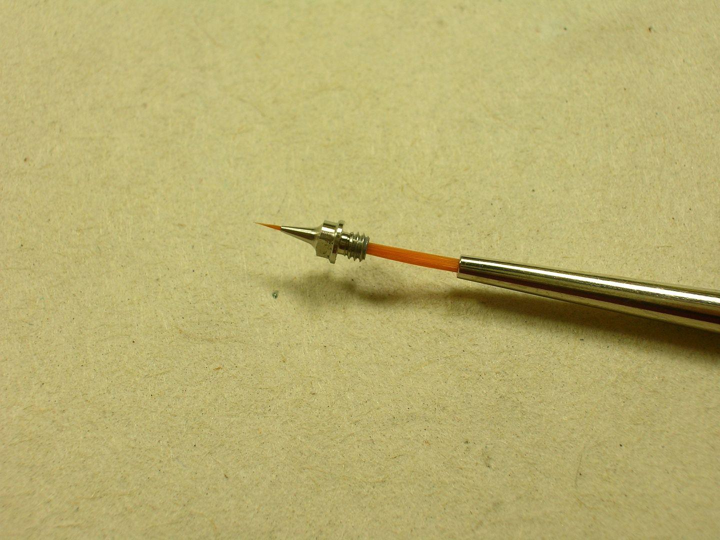

CANicoll Posted Sunday at 02:17 AM Posted Sunday at 02:17 AM This is soo embarrassing. My usually trusty GREX Tritium airbrush was barely putting any paint out. Spitting and sputtering. I ran cleaner through it, lacquer thinner, etc. That seemed to work so started back painting and back to the spitting and sputtering. Even back flushing didn't do much. I thought there must be a clog. Little did I know... Took the needle out and saw that it was kind of gunky. Then took the nozzle protector off and realized I would have to take the nozzle off - something I have done thousands of times with my HP-CS. However, I had never taken the tool out of the GREX case to take off the nozzle. I figured back washing and using lacquer thinner probably took care of the mess in the nozzle. Not so much. This is what I cleaned out behind the nozzle. That is a standard toothpick which I used to help dig out the mess. How it the world so much paint built-up behind the nozzle is beyond me. Clearly I was not cleaning very well at all. Ugh. I figured I'd share to remind especially the Grex users that the nozzle needs to be removed periodically to facilitate proper cleaning. 5 1

belugawhaleman Posted Sunday at 02:55 PM Posted Sunday at 02:55 PM I've found that those little disposable dental brushes work well in combination with Tamiya airbrush cleaner. A small, pointed, liner paint brush inserted from the rear will clean Iwata nozzle tips. Push it through until the brush hairs come through again using the tamiya airbrush cleaner. 3

dodgem37 Posted Monday at 10:34 AM Posted Monday at 10:34 AM Better than a toothpick. Sincerely, Mark 4
DocRob Posted Monday at 12:20 PM Posted Monday at 12:20 PM I clean my airbrushes (H&S infinity / Rotring) very thoroughly after use, taking out the nozzle and clean it with a steel needle, which is flattened on one side. I also clean the innards of the AB with round brushes. Between colors, I usually spray some cleaner through, backflush (closing the nozzle with my fingers and spray and clean the cup. With chrome or similar finishes or high gloss clear coats, I clean more thoroughly, even between colors. It doesn´t take that much time and became a habit. Cheers Rob 3
