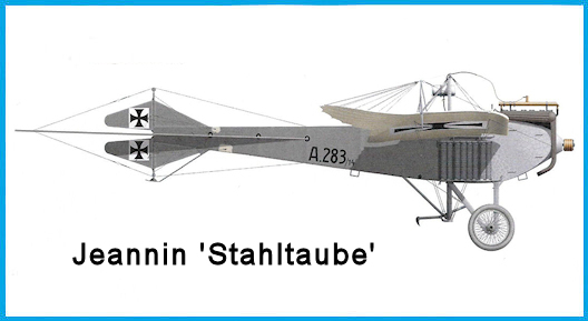

sandbagger Posted January 17 Posted January 17 Hi all, As the Sopwith 1.B2 model is close to being complete, I thought I'd start on the next model. The 'Wingnut Wings' Jeannin Stahltaube, Serial No: A.283/14 at Aldershof-Johannisthal aerodrome during 1915. This aircraft was normally doped with German Field Grey. However, it seems this aircraft had not yet had its wings doped, so were still Clear Doped Lined (CDL), Mike 10

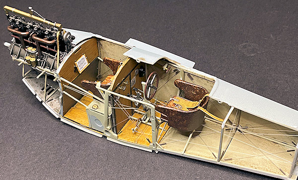

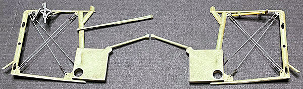

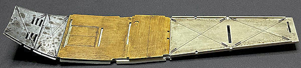

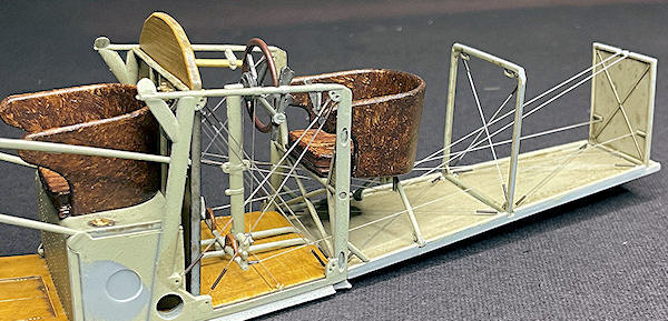

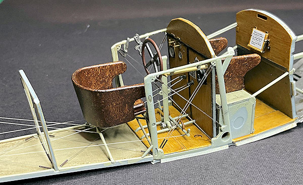

sandbagger Posted January 26 Author Posted January 26 Hi all, Some progress on the model. General painting was done using 'Tamiya' acrylic paints thinned with Mr. Hobby self-levelling thinners (MLT). The weathering is Flory Models Dark Dirt fine clay wash. The wood effect was done using brushed Windsor and Newton Griffin Alkyd oil paint (Raw Sienna). The rigging is 0.08 and 0.12 mm diameter mono-filament with blackened 0.4 and 0.5 mm diameter Brass tube (Albion Alloy's). The rigging includes fuselage crossed bracing wires, wing warp control cables and tail warp control cables. Next is to complete the pilot and observers lap belts and the engine, so that the fuselage can be closed up, Mike 7 1
DocRob Posted January 26 Posted January 26 Great detail painting and weathering as usual, Mike with one tiny exception this time, if you don´t mind. The (I guess) Flory wash on the sidewalls has a strange appearance, like oil drops on plastic. Flory washes distribute better with an added drop of detergent mixed in. If it´s an effect you intended to do, then I´m sorry for my remark. Cheers Rob 2
sandbagger Posted January 26 Author Posted January 26 6 hours ago, DocRob said: Great detail painting and weathering as usual, Mike with one tiny exception this time, if you don´t mind. The (I guess) Flory wash on the sidewalls has a strange appearance, like oil drops on plastic. Flory washes distribute better with an added drop of detergent mixed in. If it´s an effect you intended to do, then I´m sorry for my remark. Cheers Rob Hi Doc, Yeah I know 🤭- I was a bit lazy and normally add a drop of detergent. However little will be seen of the fuselage sides once the fuselage is closed up, Mike 2

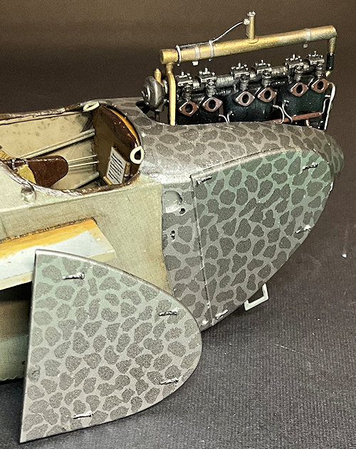

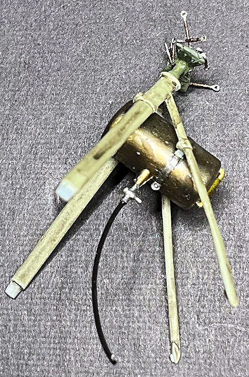

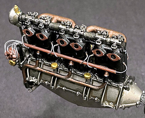

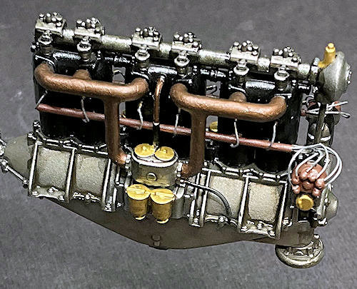

sandbagger Posted January 26 Author Posted January 26 Hi all, Here's the basic engine completed. I've added spark plugs from blackened 0.5 mm diameter Brass tube. The ignition leads are 0.2 mm diameter lead wire from PlusModel. Weathering is Flory Models Dark Dirt wash and AK Interactive Kerosene wash, Mike 6 1

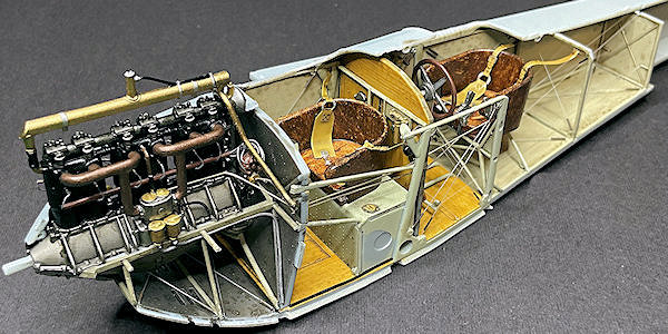

sandbagger Posted January 27 Author Posted January 27 Hi all, The fuselage is ready to be closed up. This when most of the work done will no longer be visible - hey ho. I've added the kit supplied photo-etch seat belts and basic engine fuel supply pipes from 0.5 mm diameter lead wire. Also basic spark advance and throttle controls from 0.3 mm diameter Nickel-Silver tube. These are from the pilot's cockpit to the engine carburettor and left magneto (right will not be seen). Once I've cleaned up the fuselage seam joints, I'll final rig the crossed bracing wires at the sides of the engine bay. These were left loose as the frames are flexible and fragile, so can easily be damaged. They are more rigid once the fuselage halves have been joined. Mike 7

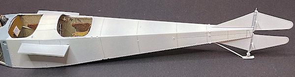

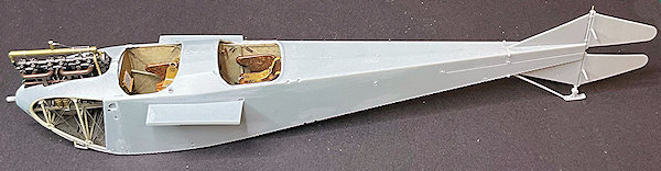

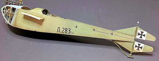

sandbagger Posted January 28 Author Posted January 28 Hi all, The fuselage is now closed up. Next is to prepare the wings, tail and associated pylons, before I can prepare for their rigging, Mike 4
BlrwestSiR Posted January 29 Posted January 29 Sublime work. That engine looks like you could just add some gas and it would fire right up. Carl 1

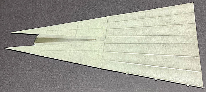

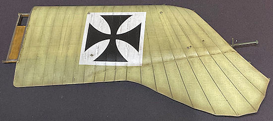

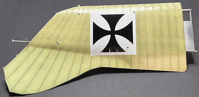

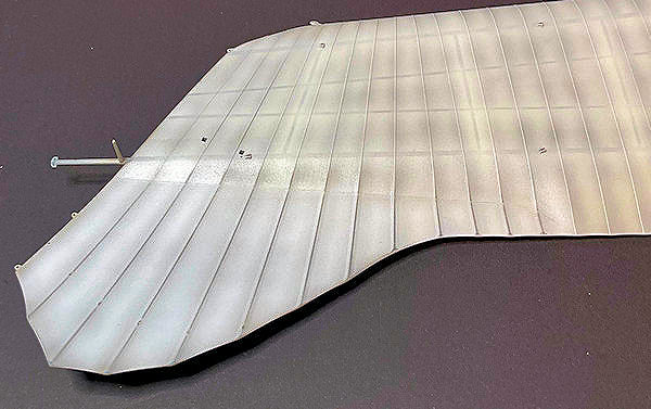

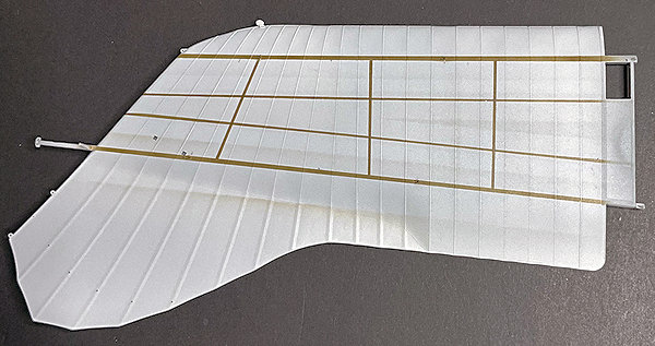

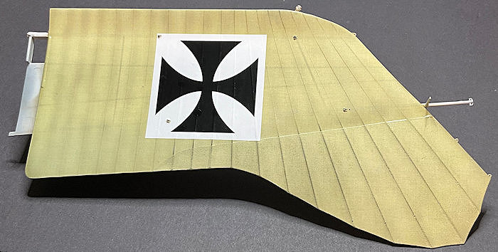

sandbagger Posted Saturday at 11:07 PM Author Posted Saturday at 11:07 PM Hi all, Some progress on the wings. 1. Airbrushed both wings with Mr. Surfacer Grey (1500) thinned 50/50% with Self Levelling Thinners (400). 2. Airbrushed with MRP Clear Doped Linen (MRP-256). 3. Primary and intermediate spars masked then airbrush with MRP Khaki Green 3/G3 (MRP-333). 4. Masking removed and three interconnecting spars masked. 5. Three intermediate spars airbrushed with MRP Khaki Green 3/G3 (MRP-333). 6. Masking removed. 7. Airbrushed with MRP Clear Doped Linen (MRP-256) to fade and blend pre-shading. 8. 'Tamiya' sanding paper 300 used to sand away the paint from the wing war Bamboo extensions to make them more prominent. 9. Finally, temporary pieces of Aviattic Clear Doped Linen (CDL) aged varnished clear backed (ATT32094) decal applied to check effect. So now it's a similar process on the fuselage and tail unit, which will be covered with Aviattic German Feldgrau Medium Grey/Green clear backed (ATT32228) decal. Mike 7

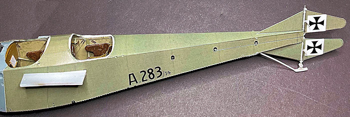

sandbagger Posted yesterday at 12:52 AM Author Posted yesterday at 12:52 AM Hi all, The fuselage and tail unit have been pre-shaded. They were prepared using the same process for the wings. Next step is to apply the decals. Fuselage and tail unit - ‘Aviattic’ German ‘Feldgrau’ Medium Grey/Green clear backed (ATT32228), Wings - ‘Aviattic’ Clear Doped Linen aged varnished clear backed (ATT32094). Mike 5
