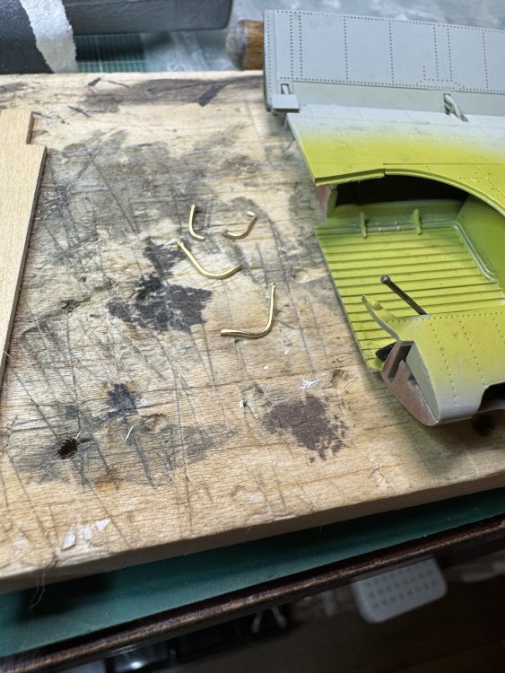

The guns in the open bay are installed, and I’m relatively happy with them. Fit was a bit fiddly because the chutes for dumping the ammo belt links after firing have zero wriggle room, but everything fit with only a minimal amount of cursing. The fun part was wriggling the charging handle cables through their tiny holes in the back of the bay, but again, not too bad - I only screwed up two of them, and fortunately Eduard included spares 🤣 Next up are the ammo feed trays and belts, along with some more PE framing to tie it all together. This is also decision time about the clutter at the front of the bay. There’s a metal rod that appears to be a part of the lock-down mechanism for the bay cover and a couple of hydraulic lines that route who-knows-where from the front of the bay, under the gun barrels and out *somewhere* I’m using the kit vinyl ammo belts, which should be interesting. It will take some judicious use of hot water to get them into proper shape to drape over the ammo bay partitions and squeeze them into the Eduard feed chutes. Then I’ll find out if I have the proper paints for the bloody things 🤣 According to ChatGPT, the paints I have on-hand will work, so I’m at least somewhat confident 😎 (not least because finding model paints here in Phnom Penh is a bit…challenging 😂🤷♂️🤦♂️) Should be fun! -

Thank you! With a bit of work, I’m hoping to blend them in a bit better 🙏 now I’m working on the open side. The challenge there is that the inboard gun has to go in first, because of the PE chutes for the ammo belt links. I wouldn’t be at all worried except it will only align with the right amount of material added back on. this should be fun! -

No pics just yet, as I’m still working through a couple of finicky fit issues But another hint for anyone else following along this path… if you want to use the Eduard PE panels to close one of the bays… for the panel over the ammo compartment, *first* glue in the kit plastic part, then glue just the top layer of the PE part on top of that. The kit part sits *exactly* low enough that one layer of the Eduard PE panel brings it exactly flush with the wing surface. This also helps to get the airfoil curve set properly on the PE part both the Eduard and Kit parts by themselves sit too low inside the wing when building a closed gun bay, but combined, they come out exactly right the alternative is getting creative with filler or other supports underneath everything, which is kinda hard to get just right (again, ask me how I know! 😂🤣) -

Quick note to anyone who wants to do this kit in the future, with the Eduard Gun Bay set… do *not* follow the Eduard instructions in step one about removing the rear mounting/alignment pin on the inboard gun. you'll regret it later, when you need to add the same amount of material *back*, to get the guns to align properly during the installation ask me how I know 🤣🤦♂️🤣 -
