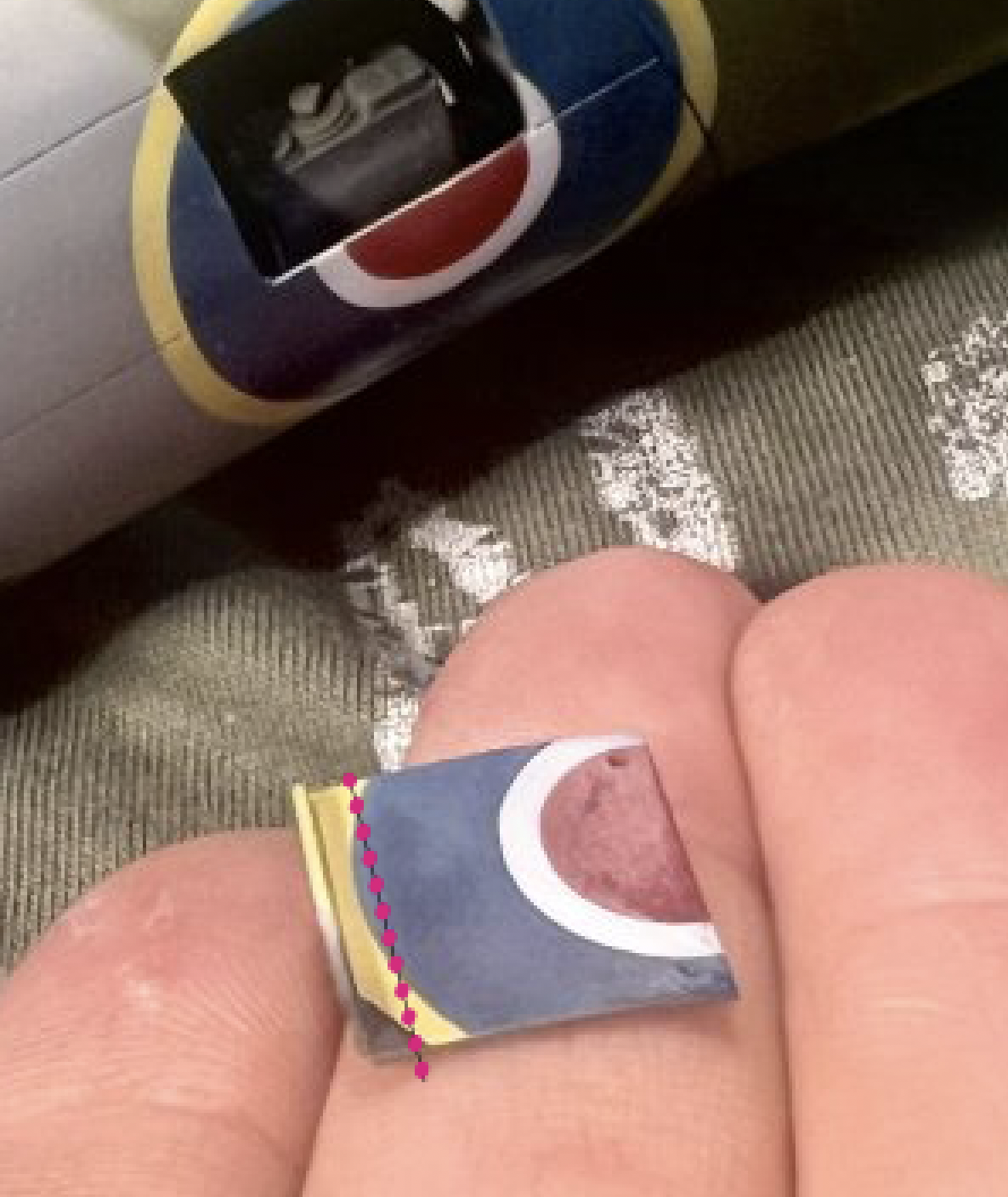

The MH Models masks for the fuselage roundels, underside wing roundels and tail flash are designed for the earlier versions. Not the P7111 I am making. This means a different Thickness of the various elements.
I will cut my masks myself on the Cricut Maker 3.
  • Confused 1
  • Sad 2
  • Administrators
Started drawing my own masks to cut them on my Cricut Maker 3.
I'm cutting Tamiya masking paper. The blade cuts right through these, but with some masking tape I can keep it all together.

I’m big fan of the Kabuki paper as a better option to vinyl, but to figure out the cutting depth and power adjustment could be a painful process. Looking good Jeroen.
7 hours ago, BlrwestSiR said:
Printing the masks on a grid must make it much easier to align things.
It does. Although I have found that Kabuki COULD stretch when lifted and repositioned many times …
