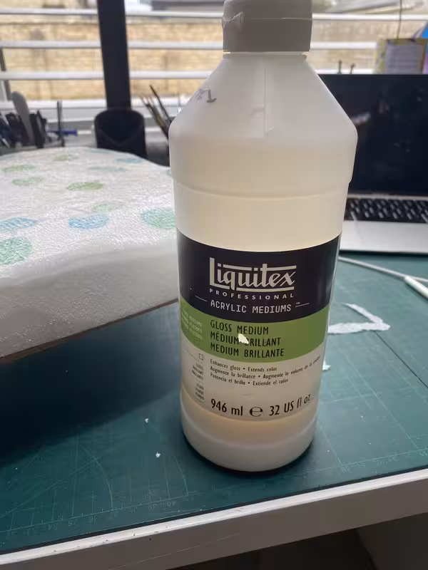

PanzerWomble Posted February 28, 2024 Author Posted February 28, 2024 Ok squirrelling sideways .... Foam is cut with a hot wire cutter, sanded smoother by a DA sander to get some swells into it . Then the fun starts. For this you need Liquitex gloss medium And also for some micro texture , use it to glue some kitchen roll over the surface, this sounds nutz but trust me , oh and you can obviously mix paint into the medium , I'm just covering with colour at this point See that mostly flat but rippled ? Thats where we are headed And so we reach here - all the white is hidden under a layer of unfeasably blue . Now I need to paint the surface colours appropriately , and fix correct waves ...then about 10 layers of medium to build up the sea gloss. If you get brush marks ....sponge them out , as any straight line is clearly a no no . Zats all for now folks ...... 6
