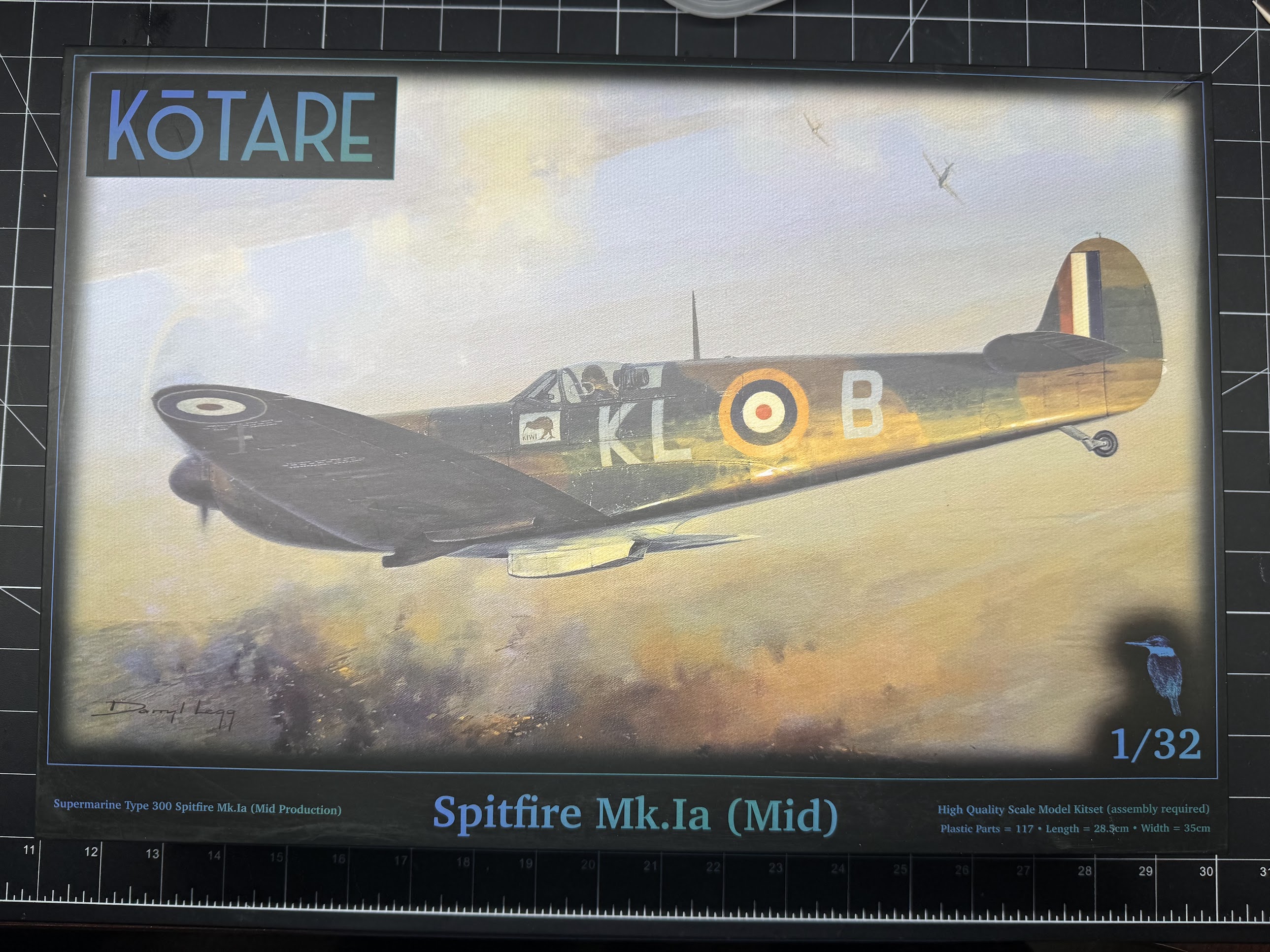

This build has been in progress since March, but stalled for a while.  It's my first large scale build since returning to the hobby and I went all in on the aftermarket.
